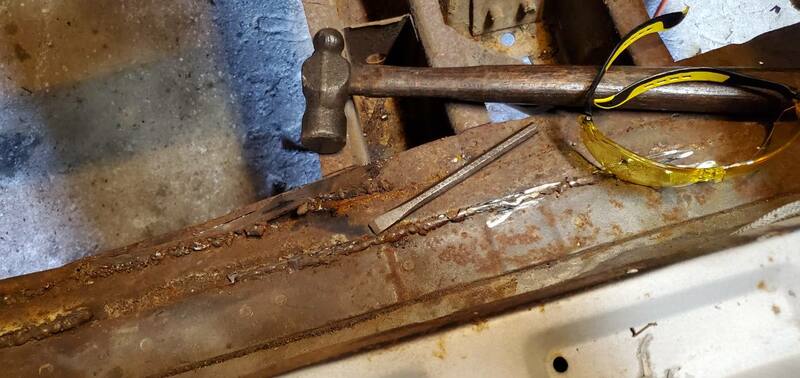

Started a little clean-up.
Most welds are of this calibre.
What's more worrying is that this is a semi-stressed panel and that's a partially structural weld.
Took the rest of the nonsense panels out. Rusty but better.

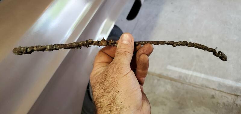

I started knocking at the welds to clean them up.
Quite a lot came away like this.

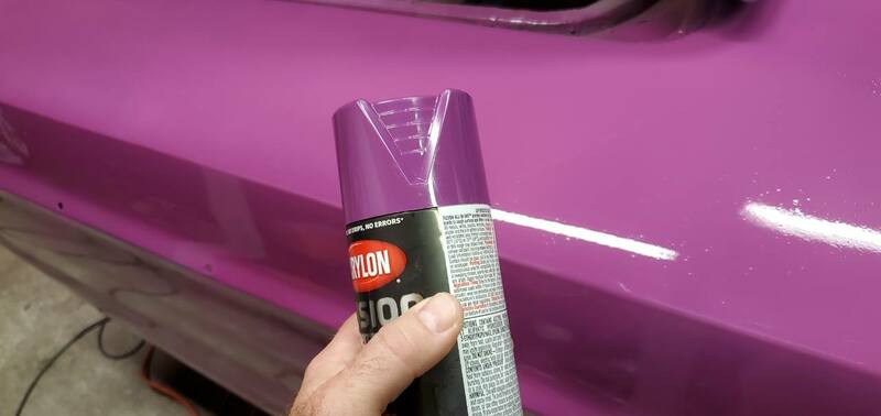

They didn't have any so I came back with paint. Let's see how that dries.

Sweet jesus, that is a colour and a half
Go big or go home!
13 minutes ago, cort1977 said:
That colour is Plum Crazy.
Truth. But it's bold. I think I'd prefer a purple with a bit more blue in it, but that picture the paint was still wet and it does appear to dry darker. I'll take a photo when it's light and we'll see just how magenta it is, compared to purple.
It's definitely the right colour for this car!

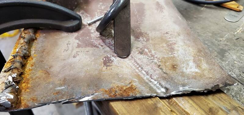

Some CAD this afternoon.
There's just enough metal left in the back to be able to press thin cardboard into the grooves and make a record of their location.
That then cut out so it can be transferred to metal with a sharpie.
I had a go at making a die and dolly and manually bashing a bead into the same steel I plan on using.
Hard work and hard to make tidy. Tempted to buy a bead roller, because I need to make a couple of these.
Phil
