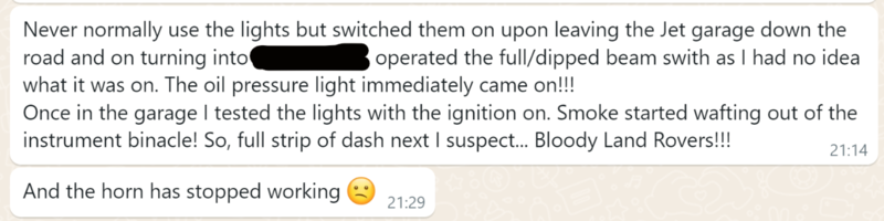

A few weeks ago he was asked to ferry a friend's son to his school prom, so before I left for Germany we did a little bit of tinkering to make sure everything's OK after a few months laid up due to the now-resolved running issue. All seemed OK, except for a boss on the steering column has broken, which means the choke cable won't return - fix TBD.
Day after the event, I got this message:
Oh dear... that sounds like a tasty short somewhere in the dash. Oops.
Solihull Spaghetti, reveal yourself!
Yes, a perfect* match** to the wiring diagram. Good. Time to call a Sparkie :o Good thing it's easy to remove the doors for better access.
Didn't take the electrician long to find the culprit:
Yep, that's toast. Looks like the choke cable has chafed through the insulation on the main group of wires coming up to the binnacle. Unsure whether this is related to the issue with the choke cable pictured below:

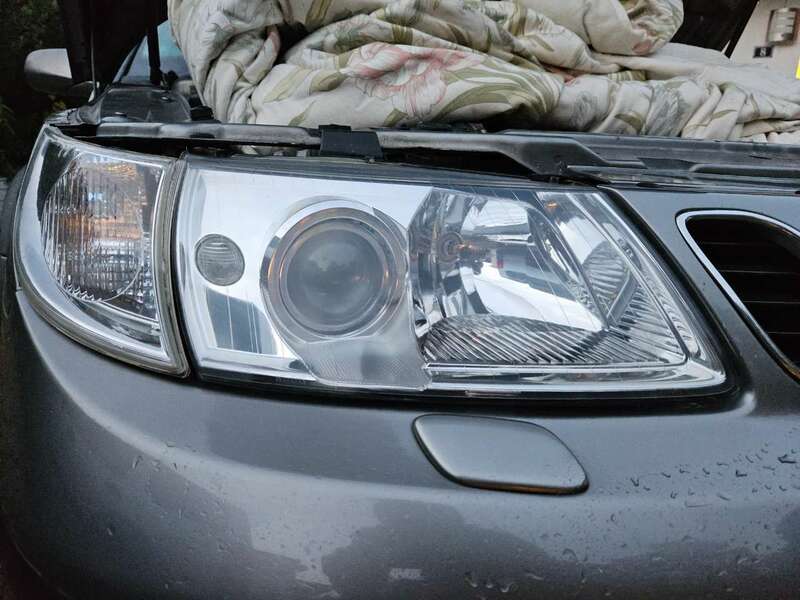

Another job done: Cataract Surgery
The headlights had developed some pretty bad yellowing since I bought it, so based on a recommendation from a thread on here I attacked them with a Holts restoration kit.
The results speak for themselves, it looks years younger.
