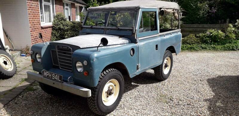

Happy Anniversary! A year ago today I bought this handsome beast.
Do I regret it?
Yeah, I do. But also no I don't. Make of that what you will.

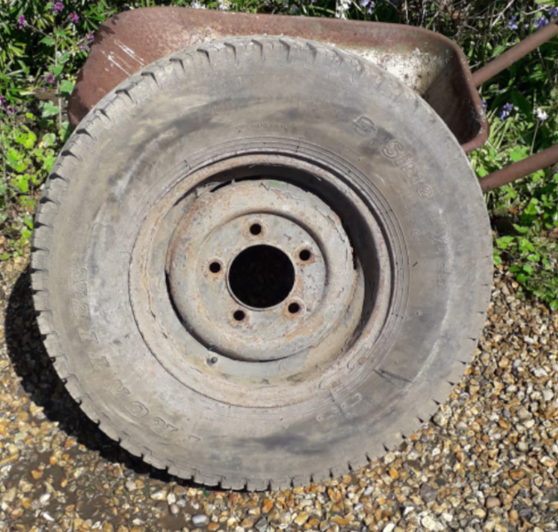

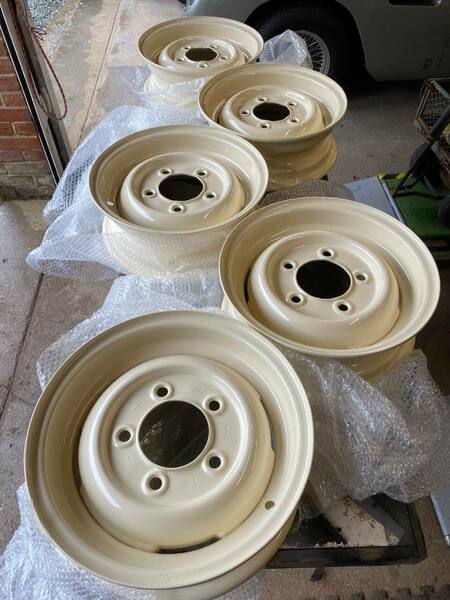

An unexciting post, but relevant to some of the comments above ref gearing, tyres and overdrive.
A full set of wheels from a 109" has been acquired with fairly chunky looking 7.50 tyres. Dad's spoken to the previous owner of the Series, who confirmed that it did have an overdrive in his ownership, but it was so noisy he had no choice but to remove it.
The 7.50s should make cruising slightly more tolerable and will give it a bit more of a meaty look. The wheels will be refurbished at some point as they are tired (pun not intended. Not one bit).
In other news, it emptied all its brake fluid on the floor the other day (easy fix - hose gave up), so I hope some of you kept the receipts for your comments about the P6's brake reservoir! 😉

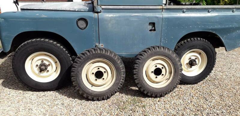

Before/After:
image.thumb.png.00b091457f2b53c081d1b70725e68af1.png Wheels.thumb.jpg.72d31c97ae4779226de0527ad83a8d0a.jpg
Almost unrecognisable!
The pristine finish will need toning down a bit as they're far too shiny for the car they're going on, but that can be sorted in time and they will naturally weather in with use. The main thing is they've been done properly, and for not a huge amount more money than an equivalent DIY job.
Next job is to get a set of tyres fitted (we're thinking Avon Rangemasters, but having experienced Avons perishing very quickly, I don't really want him to spend a load of cash on something that won't last.)
General Super All-Grips or Michelin XZLs are other contenders but are significantly more expensive and probably not worth it. We've looked at budget options but there's not really that much more money to be saved, unless he finds some at the Beaulieu autojumble this weekend.

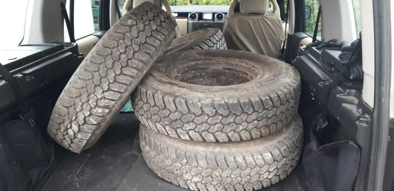

Looks like some tyres have been decided upon at last. Ebay wasn't turning up any decent options for any less money than new tyres, everything on there was either 20 year old tyres or brand new ones at retail prices.
We'd dismissed Dad's local tyre place out of hand initially, as they don't stock any 4x4 tyres and they generally just cater for normal cars. However, by complete chance, it turns out they can supply and fit General "Super All Grip" radials at £20-a-corner less than anywhere else we've managed to find, which is good - so it looks like that's what he's going for; just need to buy some decent inner tubes now. Crossply Super All Grips were standard fitment on Land Rovers sold in South Africa, for a time.
Great service as usual from the chaps at Merityre Frimley. The place has been going for longer than I've been around and every time I've used them they've been brilliant - prices and service are top notch. Subject to a couple more maintenance jobs and an oil change, it looks like the FOD trip over the Jubilee weekend is a goer!

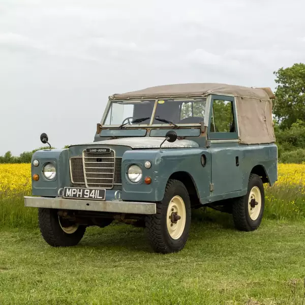

More preparation for the June FOD - new tyres fitted on the refurbed rims this week. General Super-All-Grips, a modernised version of a period tyre. Noice.
522064195_WhatsAppImage2022-05-19at7_43_06PM.thumb.jpeg.c5784ef824c3430d2e62f160aa97960a.jpeg
The difference in size compared to the 6.50s is quite noticeable and has definitely improved its stance.
394101484_WhatsAppImage2022-05-19at7_41_09PM.thumb.jpeg.3053a0b2db13e10d6632f76483b2fb39.jpeg
On the 6.50s, about 53 felt like you were pushing on, with the steering becoming quite unpleasant and the engine feeling a bit too revvy. On the same stretch of road he's now had 60mph out of it (still pulling, but ran out of space), reporting much improved steering behaviour as well as less bleeding ears.
I'll do an oil change on it next weekend and there's a couple of hoses needing changing. Then we should be all set for FODding.

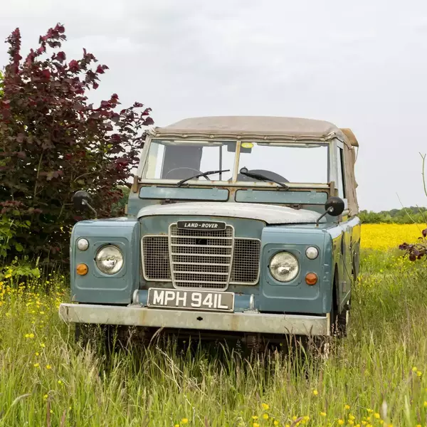

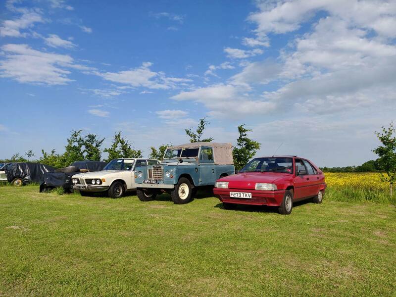

So... The FOD mini-road trip was a success!
The Land Rover put in a stellar performance over the weekend. I avoided motorways but a did do a few bits of dual carriageway at a 55mph cruise which was OK. I tried 60 briefly but it didn't really like it, so 55 is good enough for me.
Mostly drove around at 50mph on single carriageways as going any faster just means more braking and acceleration around bends - waste of fuel.
Due to the Sunday weather forecast I ditched early and drove home last night which was great fun. The dip beams are woeful, but the main beams are much better and are good enough to drive on dark roads at a decent speed.
The route home took me down all manner of winding lanes and b-roads, which was fantastic fun keeping the momentum up around bends and over hills. It definitely got a good Italian tune up with a damn good thrashing all the way back, and seemed to be grateful for it.
I doubt it's ever been driven as hard as that, but it did well and with the new 7.50x16 tyres the cornering is much improved and once you're up to speed, it carries its momentum very well - you really get into a rhythm with it.
Didn't consume a drop of oil or water, nothing fell off, and bar a couple of minor random wiring faults it all went brilliantly well. If I didn't trust it before, I sure do now.
Scores on the doors are roughly 16.5 MPG which seems to be about right for one of these and not bad at all given most of it was driven at race pace.
I suppose that pretty much sums up the trip and all that's left is to share a few photos from the evening.

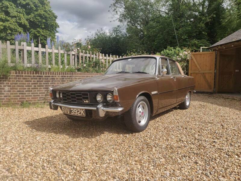

It's a bit dusty like, but it's alive!
Started on the first attempt - what a machine.
Battery still had 12.5 volts left after 7 months in storage, so that was handy. Had plenty of juice to crank it over for a while to spread the oil around before reconnecting the coil.
First start video coming later. I can confirm it still sounds absolutely bloody brilliant.
