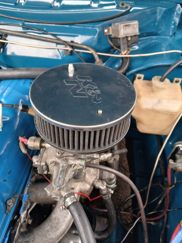

The only casualty was a nut off the K&N, so far as I could see.

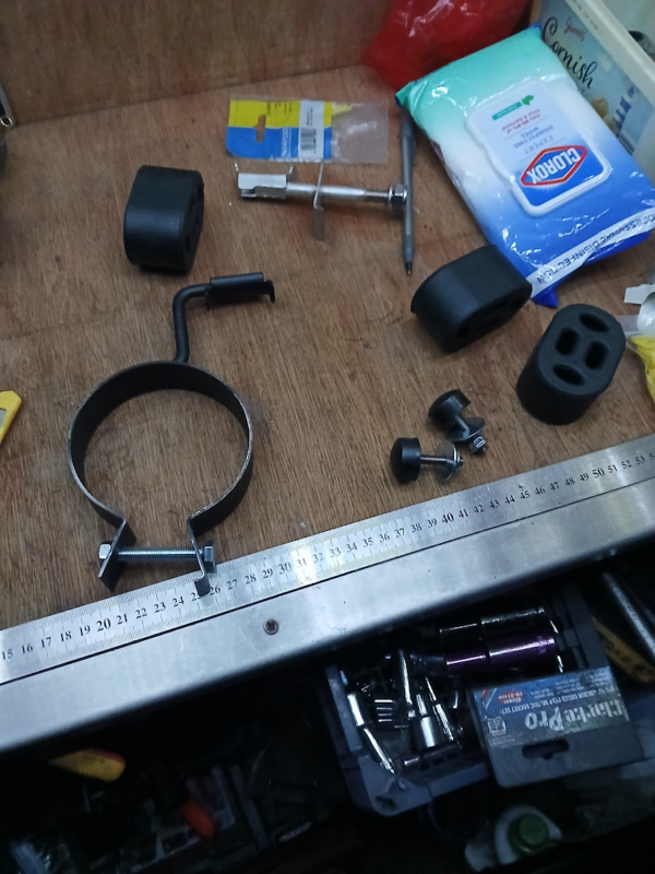

Back at my lockup I unboxed the most recent parcel. Exhaust mounts, mainly.
Will fit these tomorrow and that'll *hopefully* be the exhaust nice and secure (it did scrape a couple of times when going over bumpy roads). The bits in the centre are bonnet spacers which I need to re-fit.

K&N Dome nuts coming adrift .... 🤔

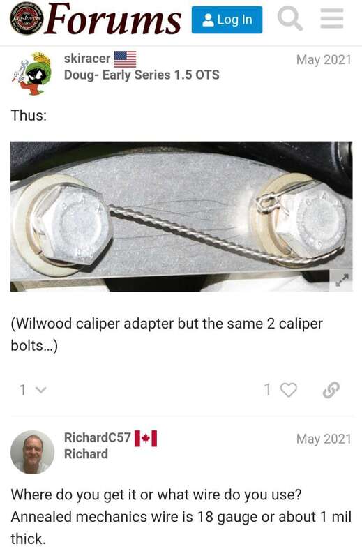

Go '30's Le Mans'... Drill a hole across the upper of the dome [above stud end] and then wizz some stiff wire through.
Twin & earth copper good enough 👍

The exhaust hanger rear and rubbers had arrived, I warmed up one of the rubbers and used a vice to ease it on.

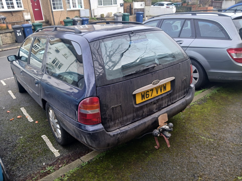

The Mondeo performed mostly faultlessly on a round trip to the north, ticking over 190,000 miles which takes it to 30,000 miles in my ownership (almost 5 years). Not too shabby at all - spot the road grime. It'll need two new rear tyres soon, and will probably be due an oil change actually. The heated seats and drivers electric seat adjustment have also stopped working which hopefully is just a blown fuse.
