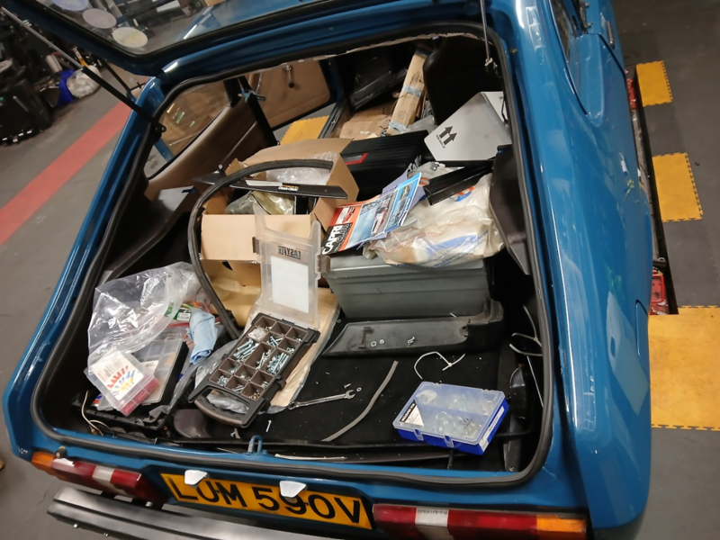

The postman brought a few finishing touches today. Rear numberplate lights, boot seal, and battery clamp. Old plates still on, am going to have a look for the plastic surround which seems to be bonded to the rear plate. Boot doesn't shut properly with the seal in place so may need a bit of adjustment to the latch.

I was going to ask how your boot lid closes with that new seal… mines exactly the same. I think it’s the new rubber being thicker and stiffer. My door seals were the same. But after a while they do soften and settle. My doors are ok now but the boot lid is still a bit iffy! I’m periodically rubbing on a bit of gummy phledge to help soften them up.
40 minutes ago, danthecapriman said:
You can get the old raised pressed ally plates and raised separate plastic figures plates from Framptons. No idea what they cost though, I’ve not ordered any for ages.
Yeah, seems a bit tight for now - going to have a look from the inside and see how far out we are...
I’m pretty sure actually my tailgate did need adjustment. Mine closed down against the seal in completely the wrong place. I’m sure the tailgate has a specific shape where the seal sits, the metal is lower there if memory serves.
Even after adjusting it, it was still tight though. I could close it fully but it took some effort! I’m pretty sure the latch is adjustable too if you still get trouble at the back end of the tailgate.
I was planning on looking from the inside, seeing how far out it was, potentially packing it out with a couple of washers if needed.

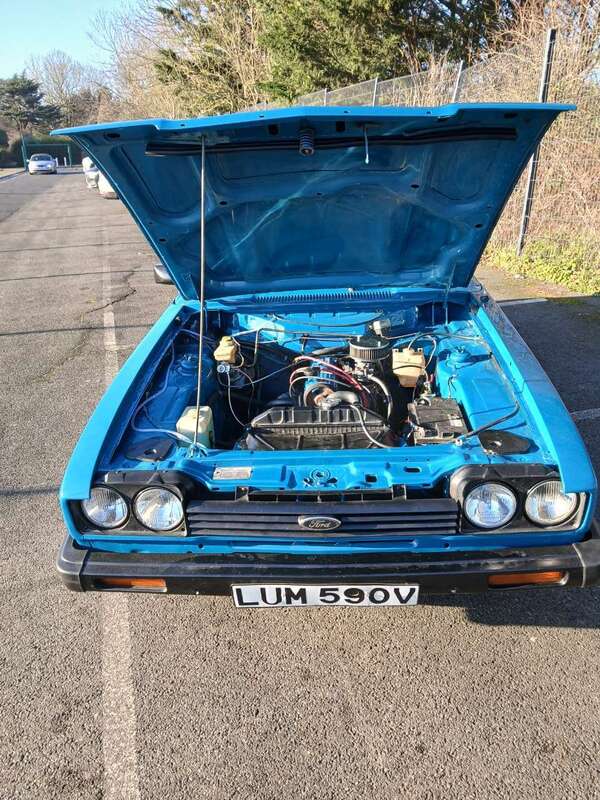

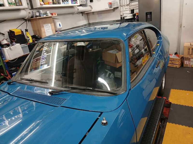

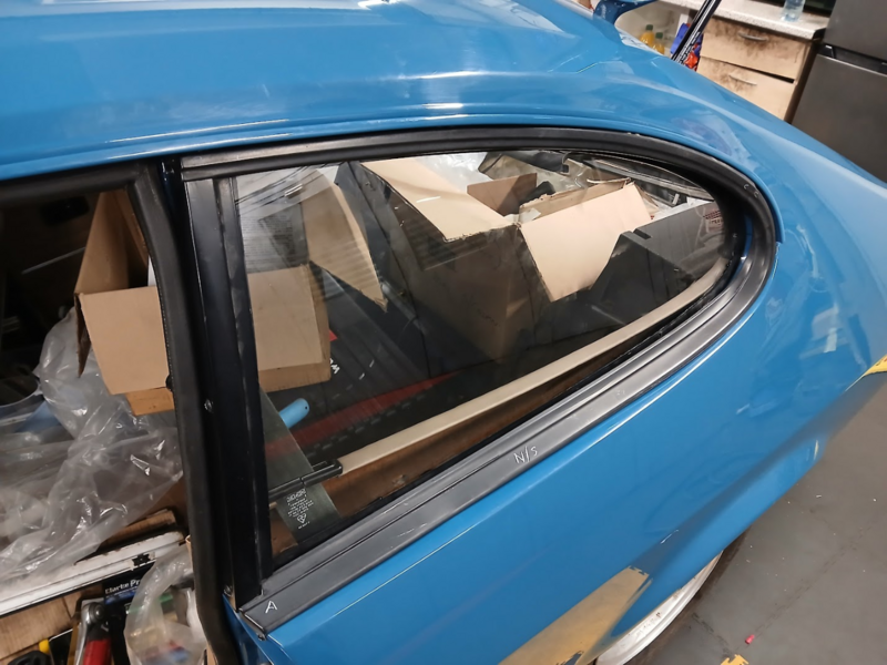

The garage got the windscreen refitted today. The side quarterlights are in and bonding. I'll fit the trim at the weekend.
Reinstated the wipers, but one of the wiper arms seems to not "bite" the toothed spindle. This results in the wiper not moving at all. It's definitely (and fortunately) the arm, not the spindle, as swopping the arm moves the problem.
So that's one part to order up tomorrow.
Tried to start it, no joy. Is the fuel pump playing up yet again? One thing I did wonder is that I am yet to re fit the inline filter between pump and carb. Although this is an addition rather than an original fitment, perhaps it could help if it stores enough fuel to run the engine and allow the pump to draw fuel through. I may yet order a(nother) new fuel pump just to be on the safe side.
Very very close to being able to do some proper test runs.

Current list before test running can commence...
  • investigate fuelling issue - add filter/non return valve - check pump operation - try running off a jerry can?
  • fit NS + OS window trim, inside & out
  • fit NSR + OSR bumper corners
  • NS wiper not functional, swap over wiper arm (if not in and the only thing stopping a test - do a temporary repair using some packing... plumbers tape?)
  • check speedo cable as it seems to have stopped speedo-ing
  • adjust tailgate catch so that it catches
  • replace bellhousing bolts - ones with (I hope) the correct pitch arrived this evening
  • fit exhaust rubbers
  • do a final check of brakes, engine, exhaust security, lighting, tyres
Not much on the list really👍

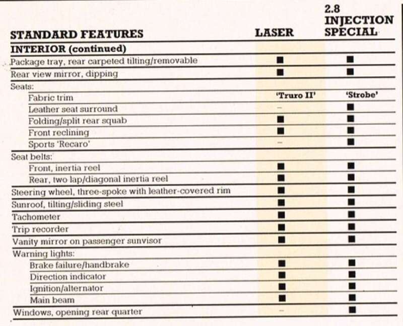

3 hours ago, Bmwdumptruck said:
Ah I guess (almost) poverty spec didn’t get opening quarter lights?  Really looking good though👍
Opening rear quarter lights were standard on Ghia only at this time, optional extra on all other trim levels.
They never did become standard across the range.
Interesting - did this include Laser as well? I had thought that they were standard by that point.
Yes, this is the November 1986 brochure, right near the end of production.
Full brochure

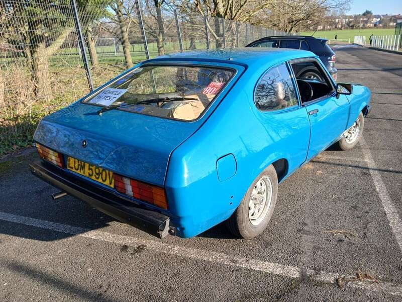

Floppy wiper replaced with a spare - had to resort to ebay as nobody seemed to have them in stock. Front wipers now in full working order.
Side trim sorta-but-not-properly-in.
Fixings I'm told are from the inside, so I'll sort that in the morning. An added complication is that some bits have warped slightly during storage.
Boot seal fully in,
Boot wouldn't close and latch, so I took the catch off and packed it with a washer, which gave it just enough to latch.
One minor modification that I have gone with, is to fit ball type boot struts.
The original screw-through type aren't easily available, you have to swop the fixings over, but often these don't fit perfectly. This should make life a bit easier. The fixings I bought are a bit long, have now been cut down.
Still no fuel coming through. Bloody thing. Too cold and tired to look tonight, so that's a job for the morning now.

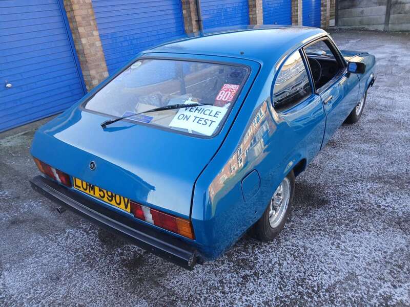

Final checks on lights, brakes, exhaust security etc were done and, gingerly, took to the road.
i kept local for a few reasons, i want to do a good number of short local trips as fault finding runs. Worst case if problems occur i can at least limp home or else call for help or walk home. There's also been frost lately and some roads were gritted so I kept to main roads where it'd all been washed away, and washed the car down on return.
There's an extensive list of issues and things to be addressed, but WE HAVE RUN ON THE ROAD and this makes me so unbelievably happy you wouldn't imagine.
