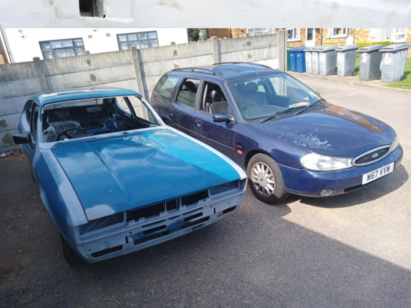

Capri returns!
Now fully solid and just in need of paint.
Feels very odd without the windscreen. But it's a great feeling to drive her, even if that's just manoeuvreing around the yard.

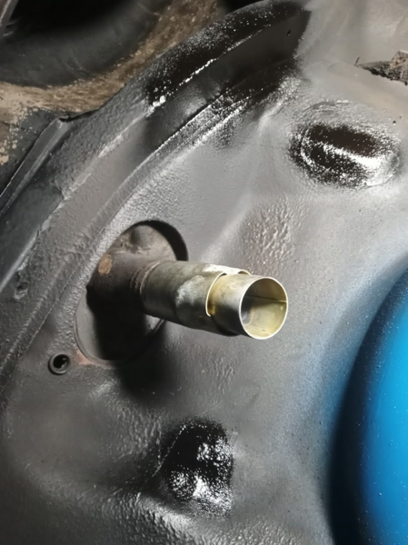

The rear washer hasn't worked in the time that I've had the car, so now's the ideal time to give it all a clean.
Time to pick up some cleaning agent...
I've flushed the line through with it, and left the nozzle sitting in a little pot overnight. I'll get the pump out over the weekend and try shooting it through.
A few rear end jobs today, so I turned the car around in the garage. Getting out was fun* especially given that the black parcel on the passenger side is the windscreen and rear quarterlight glass!
The trusty off-brand cola was deployed. Everything runs through fine, except when the washer jet is attached.

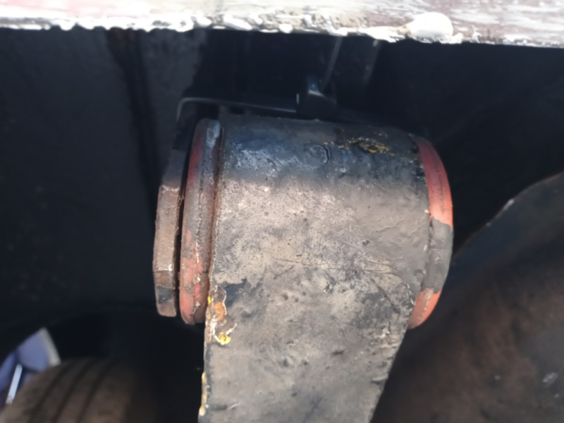

Rear spring shackle had sheared off. Replacements have been ordered, so in the meantime, better get the old ones off.
Easier said than done! They are a bit of a pain. When the two parts are separated, I jacked up the rear body so the chassis rail sat higher than the spring, to give a bit more room for manouvre. One half popped out after some careful prising.
The other half remains in there, seemingly held in purely through being stuck fast in the bush?
Bit worried that I'll have a right game getting everything back into position on the car. I've never worked with spring bushes, so I don't know whether this is practical or if I'll end up taking the springs off to do it on the ground!
EDIT: Although, now I think about it, the bit that's in there now is perfectly sound - it's the bottom section (the part that's out) which has sheared off. I could save myself some hassle by just replacing the broken one (and copperslipping it!).

A lot of swearing, levering, grumbling, prising and coaxing later and...
Oh what's that,
Only forgot to move the bushes over to the new shackles, small thing.
Bollocks.
  • Sad 2
The bushes are entirely seized onto the old shackles and not for coming off. A bit of measuring, in which I almost felt like I knew what I was doing...
Ordered up some new ones which, I hope, will go on and then everything can go back together for one last time. Hey, I suppose it's all part of the fun* of a project!

Capri is going away for paint on Monday or Tuesday of next week. The bushes ordered above came in the post earlier in the week ,so time to get them fitted. Getting the inner metal bush into the poly bush was a pain in the absolute arse. I went with a very long nut, bolt and some washers in the end. Assembly instructions strictly demand that you do not over tighten these to avoid shearing the stud on the other side. I'm always left with slight paranoia in these cases!
I've got three weeks off* during August, if things go properly I may have it back by then which would be fantastic as I could spend a good few solid days working on it, but the best laid plans...
Long nut and bolt on the other side and the bush was in. All tightened up and back on the ground now.

Rear washer - to pin the cause definitely on the nozzle, I bought a generic one online (£1.99 delivered). Fitted and a good flow.
Will try blasting the genuine one with compressed air at some point over the coming weeks.

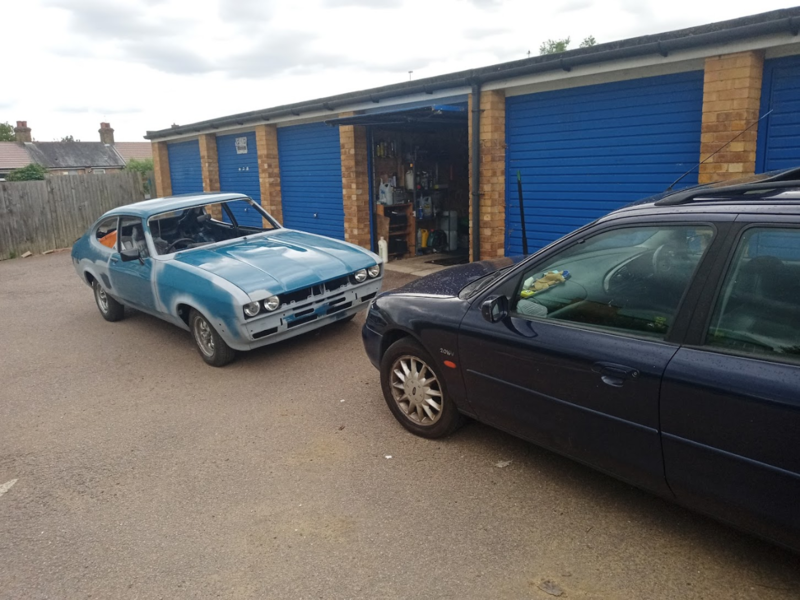

The Capri wait continues.
A day of odd jobs today, popped up to Watford, passed @Andrew353w on the way, came home, decided to whip the starter motor off the Capri. Going to drop it off at the rewinders tomorrow so they can give it a look over and check if anything needs done, clean it out etc - it works perfectly fine, but they're 10 minutes away and will give something a once over and a clean up in return for a contribution to their tea fund, so it's another thing done and fresh. The whole area under there needs a thorough clean too, so I think it'll be a tin of degreaser and some rags tomorrow.
Oh, and I washed the Focus - it hides dirt well, it looked alright-ish, but looks shiny and lovely again after a quick once-over.

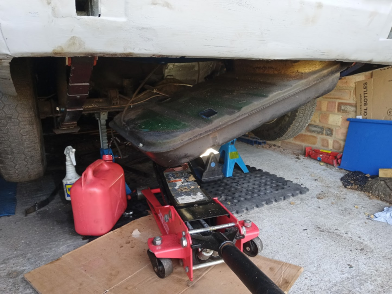

On my to do list was to remove the fuel tank, check it and the area above it for corrosion, and fit new straps.
image.thumb.png.1077386540104dd7c66c661821968a32.png7
innovative use of trolley jack to control the drain flow.
I took a couple of gallons of fuel off (chucked into the Mondeo - it's probably a bit stale but will mix fine with the full tank of fresh) before removing the tank and pouring the remnants out. I didn't get a picture of this, but it was very yellow and there was a fair amount of crap floating around in it. That I'm going to get rid of, much as it feels wasteful it's probably too risky to chuck it in the Mondeo - if I had the Bluebird I'd have had no hesitation, it would run on anything! You can take it to the tip if it's mixed with engine oil... I'm just going to chuck it down the interceptor at the petrol station, call it a test...
Tank itself is battered in places but no leaks, I'm going to see about costs for blasting/powdercoating vs replacing with a new one.
The area underneath the tank will need some rust treatment, but other than one hole isn't too bad. I daren't start it for a few days as I'm paranoid about the amount of petrol in the air!

Tank ordered last week, hopefully will arrive soon.
The old one has been rinsed out as I'm a little paranoid about a metal tank of vapour being an explosion risk...
Existing, perfectly working, fuel sender has been recovered for fitting in to the new tank
Whilst the tank was off, I took the opportunity to clean up the bottom of the spare wheel well and a couple of patches above it.
Much easier with the tank removed, so when the new one arrives it can go back on to be forgotten about for another 40 years.
