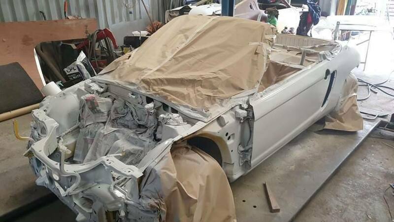

Next up, things were masked off:
Prepped:
Primed:
And given a fresh coat of paint:

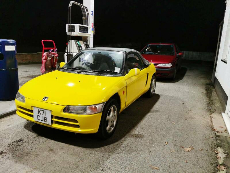

On Thursday, Tony took the Beat for its first drive on the road for over 7 years.
A man in overalls put it in the air and tapped it with a hammer:
And it PASSED!
We had planned for me to collect the Beat this coming Sunday, but I got too excited. With insurance sorted (at EIGHT pounds a month FC!) and tax paid, we went 75 miles up the line, said our thanks, and collected the Beat.
My boy has been absolutely obsessed with the Beat ever since we got it, so it only seemed right for him to be my  co-pilot for our first drive.
He smiles weird.
We set off and OH MY WORD, this little car is a frantic little buzzy thing. I'd never driven it before so I wasn't sure what to expect, but a rainy, dark drive through unfamiliar roads was a baptism by fire. Did I like it?
I bloody loved it. The sense of occasion you get from a hard 2nd gear pull is wonderful. The idler pulley noise is noticeable though and needs rectifying. It's also extremely loud in the cabin, so I'll be looking at dynamat on the panels to take the edge off.
But the steering, oh, the steering. It's so bloody fast that it only needs the tiniest of movements to change direction. It's not power assisted, and it really doesn't need it either.
