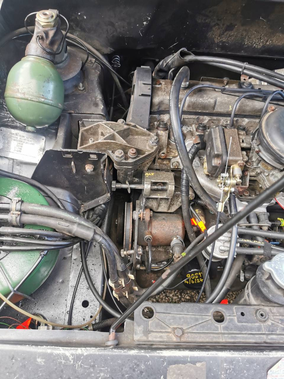

With that done, I still wasn't happy with the BX's idle. Did some more carb fiddling and eventually found the culprit:
This lever isn't returning to the fully relaxed position when the choke is off. I've lubricated everything throughly and will keep an eye out for a strong return spring to help things along!

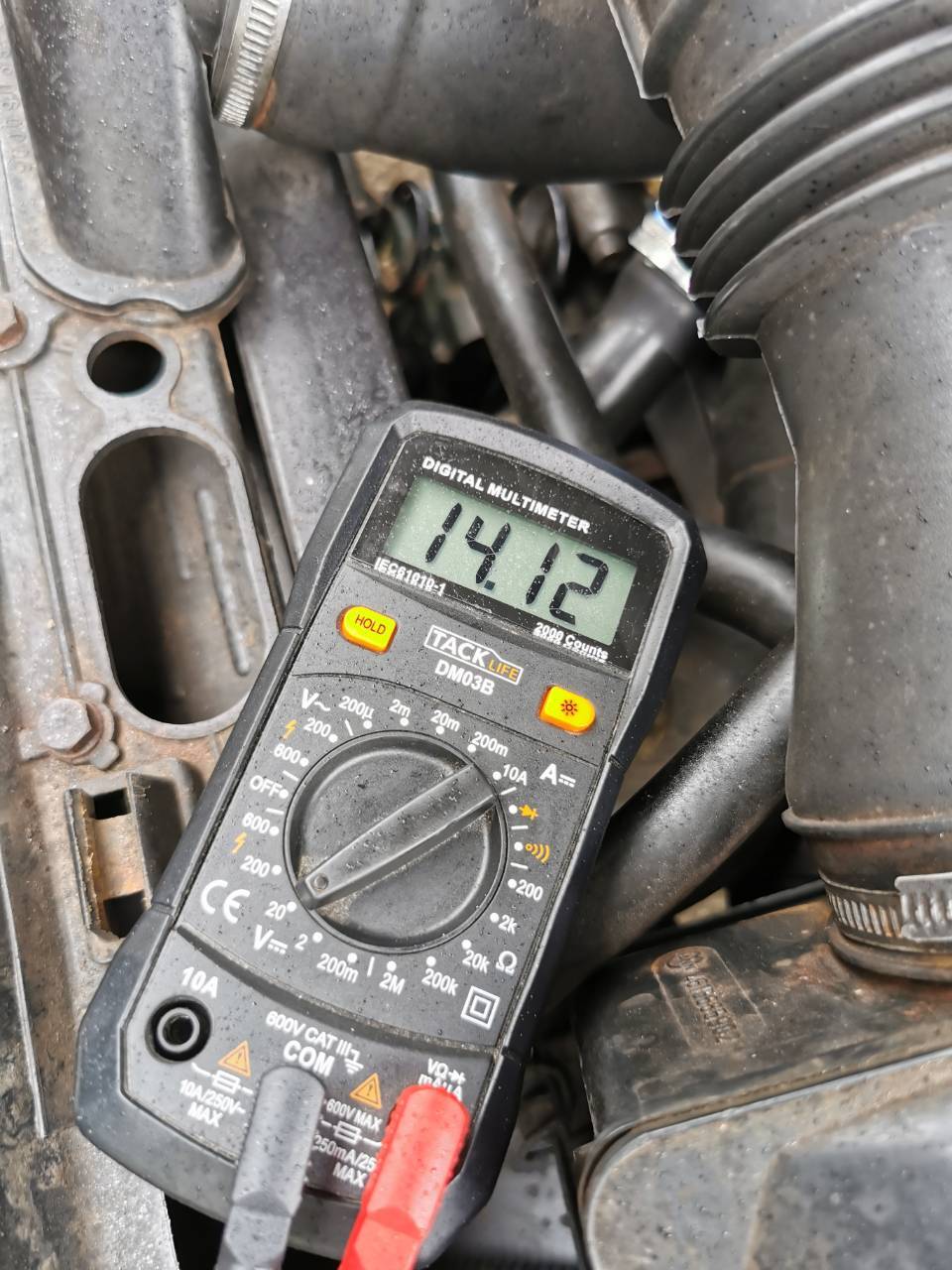

And then - disaster. The battery light wasn't coming on with the ignition, and the alternator wasn't charging the battery. Thank fuck I was home!
To be honest, I was floundering a bit on this one - the initial thought was the alternator was still charging the battery but at a reduced output - pulling the negative lead off whilst the engine was running confirmed no output at all as the engine died immediately.
Next was checking the battery light bulb in the dashboard - this was serviceable, and nothing suddenly worked when I swapped it with another bulb and holder within the instrument panel.
Some multimeter probing revealed there was battery voltage present on both sides of the light holder with the ignition on, when it should have only been on one side.
The small alternator lead was checked with a test light, which was rather dim.
Messenger_creation_5f278d7e-9837-4bef-9dc9-dfdfcbb0765b.png.1bb242878fe37f223a25209c598d3c53.png
This test was repeated on the rear of the instrument cluster, and it was even dimmer still - it was a very dim orange.
I've leant on Phill very heavily for advice in this fault (thanks mate) and think this has been narrowed down to a connector block above the gearbox that was minging. A quick clean with some IPA and a nail brush brought back some results.
Messenger_creation_75034b23-82ea-44b9-a6cd-df9a8ef20b35.jpeg.2738df111f156c0748f4b3d65f95300d.jpeg
The light was back, and cleared when the engine ran, but it was flickering dimly when applying electrical loads and the battery still wasn't being charged. Think it would benefit from being stripped and cleaned, or even reterminated.

We're back.
Cleaned up this grotty connector and that seems to have resolved the issue.
Think I'll just take it to Plymouth tomorrow and let my mates Accord estate take the long trip.
As a bonus, drowning the choke mechanism in lubricant seems to have helped, and the idle has settled down - hopefully that's the end of that niggle too.

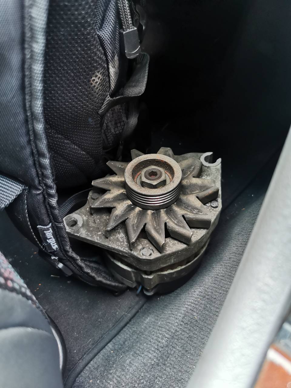

The fault is back, and it appears to be changing in nature - it now varies by revs, even when I bypass the exciter line and connect the small alternator terminal directly to the positive terminal with my test lamp. It will sometimes put out 13.7v but only when the engine is screaming at 4000rpm.
I think the alternator is fucked.
I think alternator is where I'd be looking too.

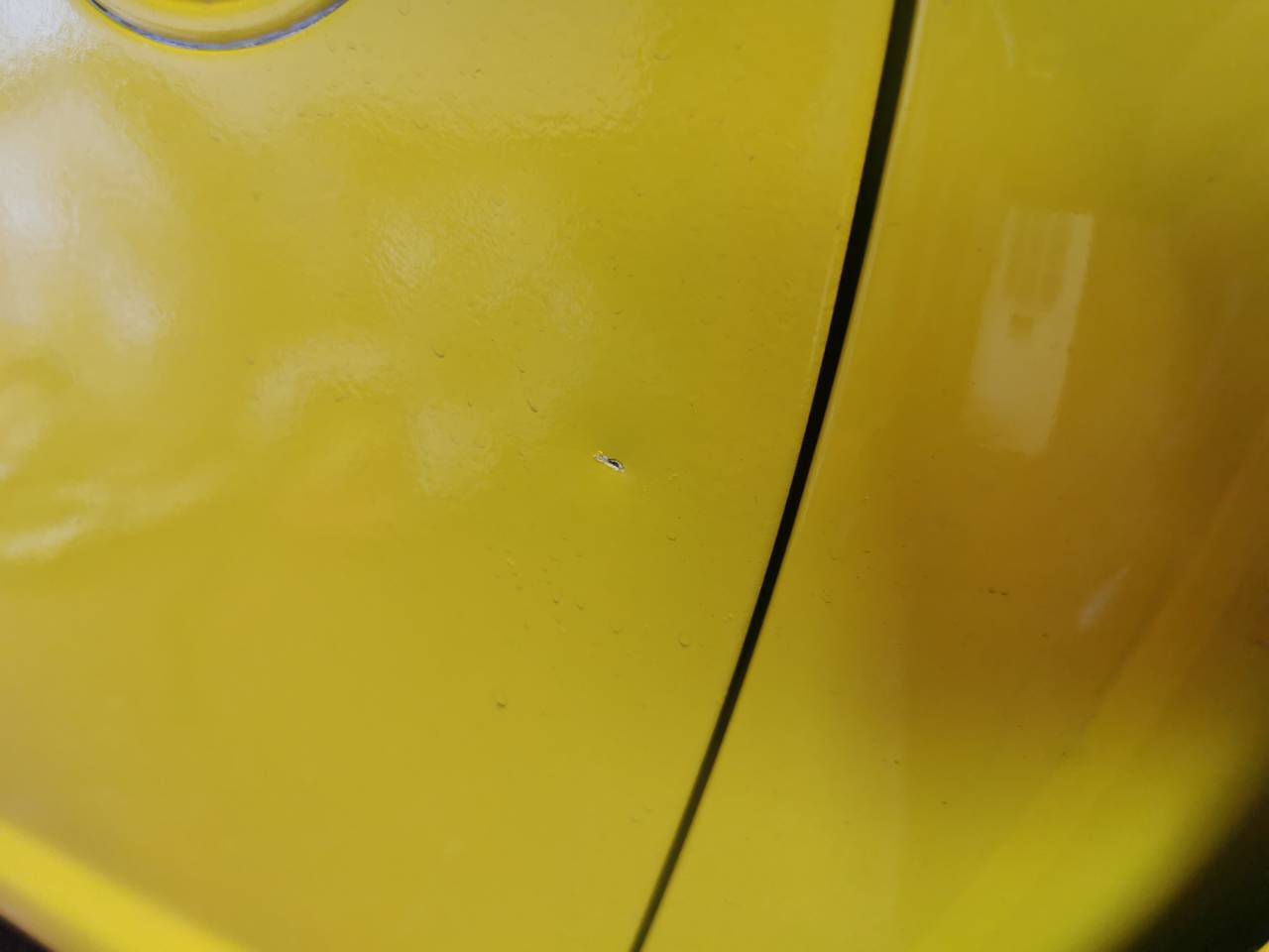

Looking for my beret for work and I realised it was in the Beat. Gave it a bit too much juice when opening the door and slammed it straight into the fucking engine crane.
That's a very prominent pinhole dent and the paint has chipped so I've given it a little touch up on the paint.
MrsH dropped the alternator off for fault diagnosis and told me a package had arrived at home:
Yep, that's pretty much everything needed for the next work package which will be happening soon - the Laguna is coming off the road for some TLC.
The alternator bloke then call me, told me the regulator was fried, he had one in stock and it'll be ready the following day for only £45. Result!
Feeling confident, I finally took the kids seats out of the BX to look for the socket causing the rattle in the back round bends. Found it!
With Shitefest in my mind, and a glaring reminder that last week's deluge of rain proved my tent wasn't watertight in the slightest, I planned ahead and folded the back seats to see how the BX would fare as a sleeping option with the blow up mattress in the back (kudos to MrsH for being my test model!)
It /would/ be workable, but the thought of moving everything from the boot to the front seats was a bit unpalatable, so I've set the tent up in the garden for the evening to waterproof it and let it dry naturally. Fingers crossed!
A mate then came round with a pile of surplus BX bits he's had for years. Some of it is scrap, some isn't applicable to me, such as the turbo and manifold - check out this retro wrapper I found wedged in the turbo - expired 2002!
This morning, I got the call to say the alternator was ready for collection, so I rushed over to pick it up.
Luckily it's a very quick install, and less than fifteen minutes later, we were ready to find out if it worked.
Success! (Kind of). The battery light is sometimes a bit slow to illuminate during the ignition before engine start, but it does charge when running and then light up when the engine is shut down.
I've just received my cigarette USB charger with built in voltmeter so I'm going to commute in it tomorrow and keep a beady eye on everything so fingers crossed!
