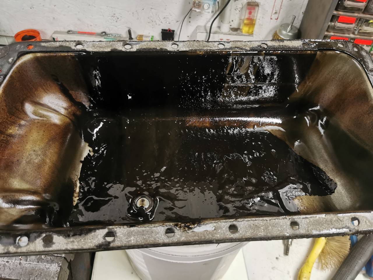

A late tea meant there wasn't much done to the engine today. I whipped the sump off:
And immediately turned the engine back upright to allow the residual pooled oil to drain out of the block.
The sump had an bit of sludge at the bottom, but nothing concerning and nothing sparkly thankfully!
I decided I didn't want to strip the engine any further as I wanted my son to see the internals of an engine for himself - good learning opportunity for him!
Anyway, I cracked on instead with cleaning the sludge out of the sump which cleaned up nicely:

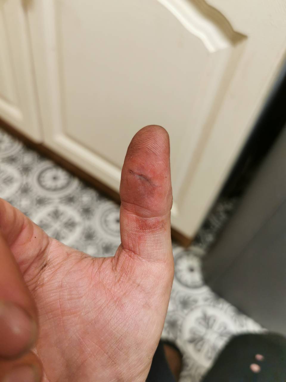

Yep, the back of the Stanley blade went straight into the thumb, resulting in a tsunami of claret everywhere.
Thankfully, it sorted of sealed itself enough to stop bleeding, when MrsH descended on it with steri-strips and tape.
Popped back to the garage to lock up and saw the dirt line on the blade, indicating how far it went into my thumb.
It's currently rather sore, unsurprisingly.

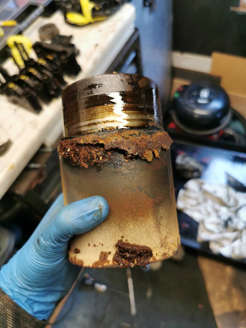

And eventually, 4 hefty pistons were removed.
The rings were inspected and there wasn't any obvious signs of wear. I'll be looking a lot closer at everything over the coming days.

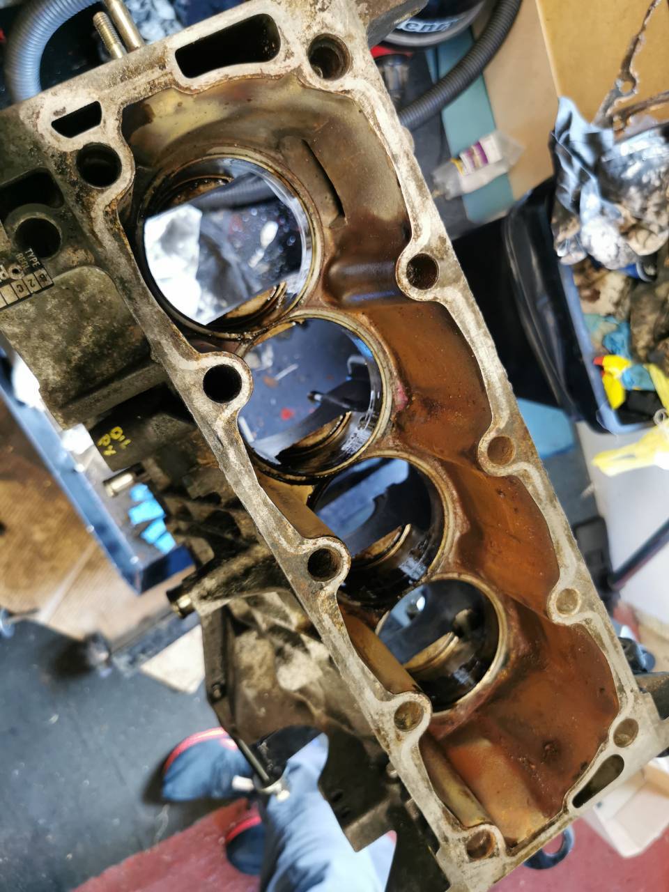

Decided to crack on with the block again, stripping the last few bits off before it goes away for repair.
Timing belt tensioner spring is the original! Suppose it's just a spring, the pulley itself is grumbling so that'll be changed.
All the various mounting brackets etc were removed and I decided against the original plan of leaving the cylinder liners - as I had it pointed out to me, I've gone this far with it, so why stop there?
Glad I did, as more evidence of mingebaggery by the previous owners became evident - clearly this has been run on water for ages.
Thankfully it cleaned up pretty nicely.

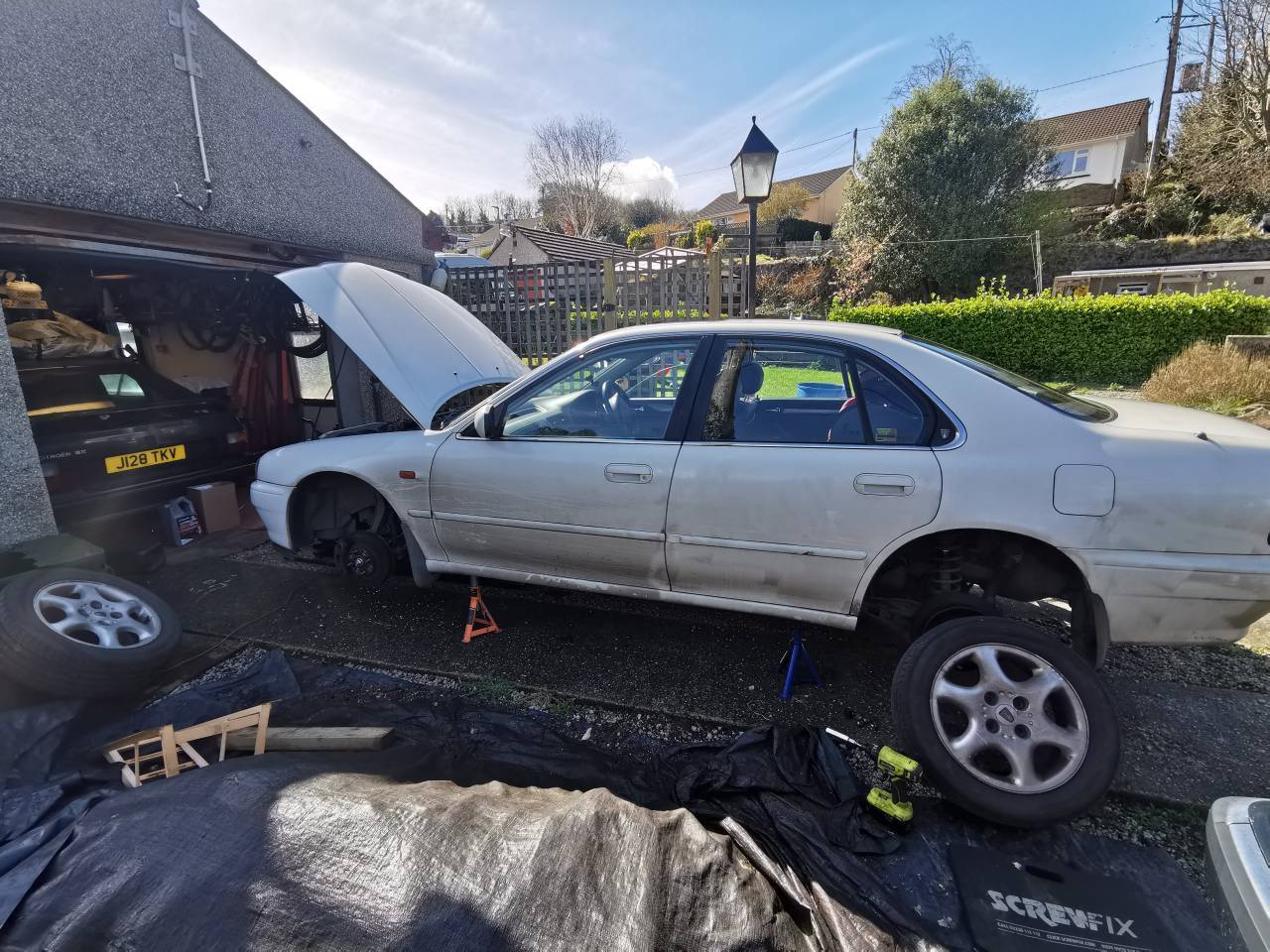

Time for a change of subject today.
The Rover is the preferred vehicle for the upcoming family trip to NL on Sunday, so it was time for a few jobs to be bashed out.
First job, swap the front and rear wheels round - the fronts were exhibiting wearing on the outer edges.

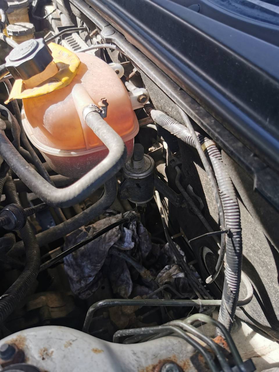

Whilst working in the engine bay, I noticed there was a weep of coolant coming from these two bungs - the only aftermarket radiators available for 620ti's are also fitted to the diesels. These bungs are for the diesel sensors.
As a compulsive tight-arse, I hopped onto the Rover groups and was delighted to be told that a solution was available, for literal pence.
Apparently the old school trick was to remove the plastic bung, leave the seal in place, and add a slightly-filed down 2p piece in its place.
Decided to test either one for effectiveness - the 2p piece, or the bung, having been removed and cleaned along with the seal.
(I have been for a 10 mile test drive, and so far, both have remained dry. Going to pack the bung and another prepared 2p piece just in case)

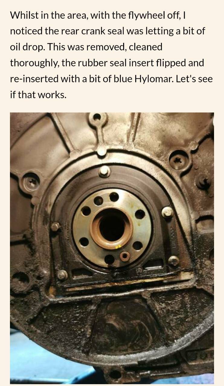

Remember this utter tightwadded bodge I did when I had the flywheel off in November?
Well, it's been four months and I have finally checked underneath the car - it's bone dry underneath there, so it actually bloody worked, £25 saved 😅

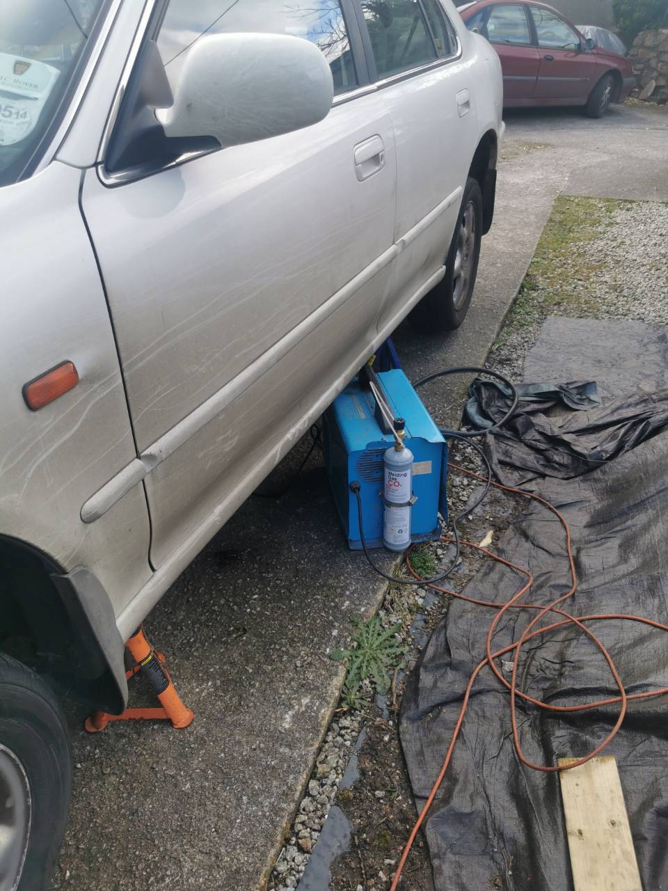

This pipe moved a bit when the exhaust was moved up and down. Mindful of the arseache we went through when the Laguna's exhaust welding completely failed, I decided to act now whilst it was on axle stands.
Safety first on the other side.
Didn't bother getting any pictures of it, but I didn't want to fully re-weld it back up, especially if there is still any sort of blockage in there. Instead, I elected to weld the joint back up at various intervals to ensure the exhaust remains attached to the rest of the car.

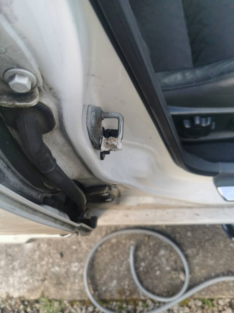

Another quick job was adjusting the door and door catch, as it was catching slightly on closing.
The strip of making tape highlighted the contacting area when closed, and I adjusted accordingly. Not too happy with the shutline gap, so I'll get the front wing off at some point to access the hinge bolts to allow for better adjustment.

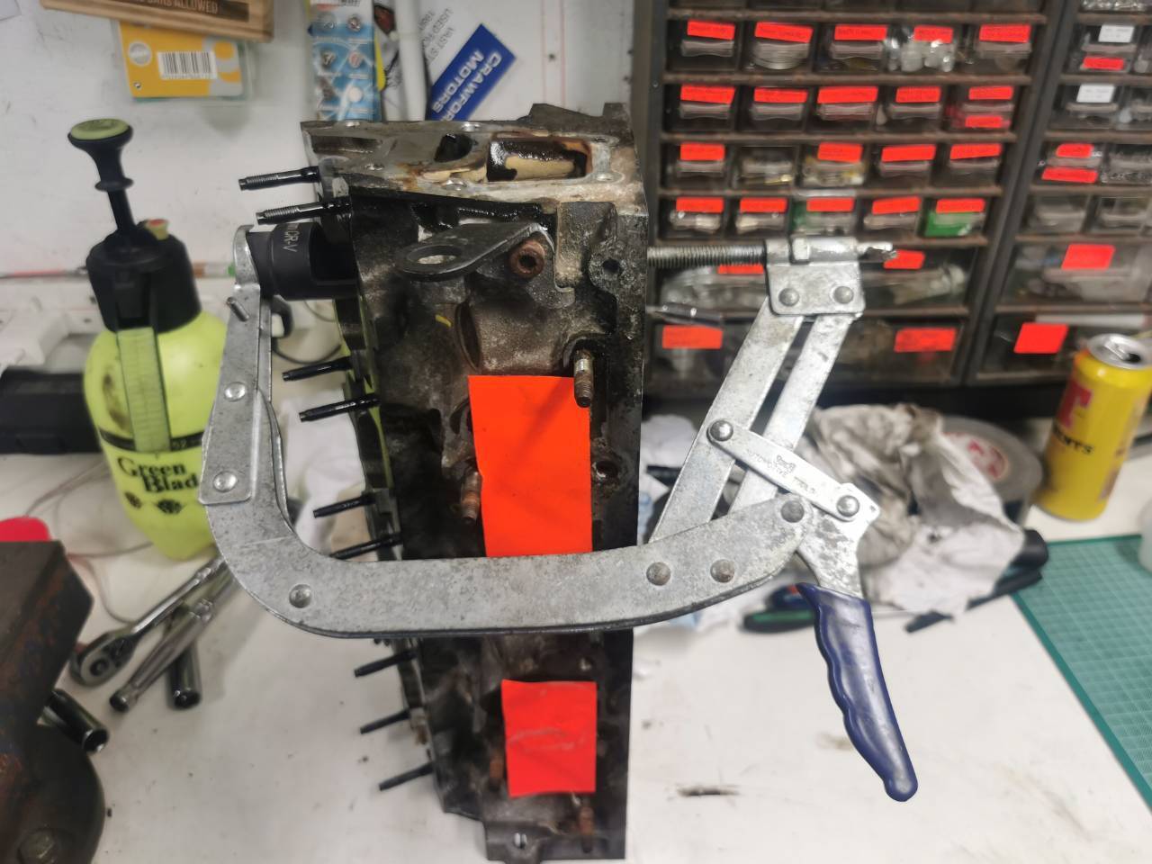

Ah well, the block and head were dropped off for the required work, the garage was re-tidied ready for another day's graft, and I've got an overnight shift at work so there'll be no work happening on the cars tomorrow.

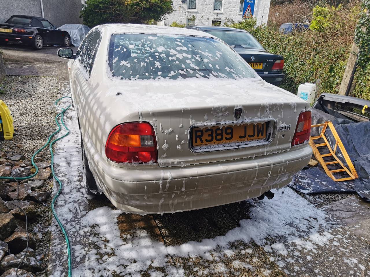

It was finally time to wash the Rover after a winter spent as the daily, in preparation for the long journey on Sunday.
Took a LOT of scrubbing but eventually, it came up alright.
Even took the time to fit the bits needed for European travel:
