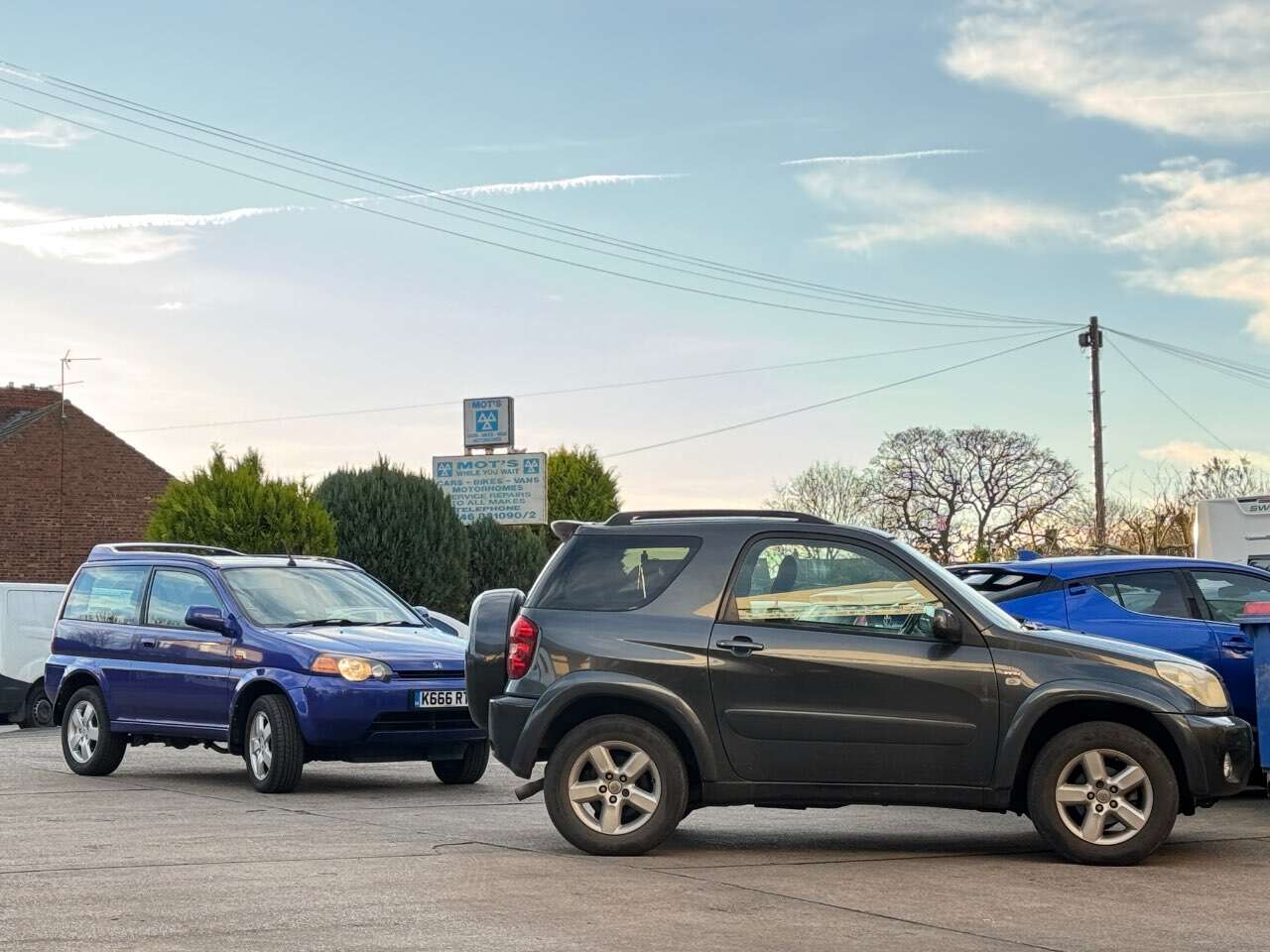

Most of the day had a lot of running around but I thought I'd see if the garage had time to MOT the purple joy machine as well. I had it in my mind it had a week or so of test left.
Do need to get busy with the rustproofer - it looks good under there, but vulnerable, so the rear of the sills will get a wheels off, on ramps tackle this time.
This unexpected "it's okay and now tested to 2026" with a full 13 month MOT (by fluke) means for a simple life... I'm going to roffle the Focus. Yes, I like it, but I need work, not more tax, tyres and insurance... I thought the Honda would throw me more curveballs at MOT time and cause stress.
