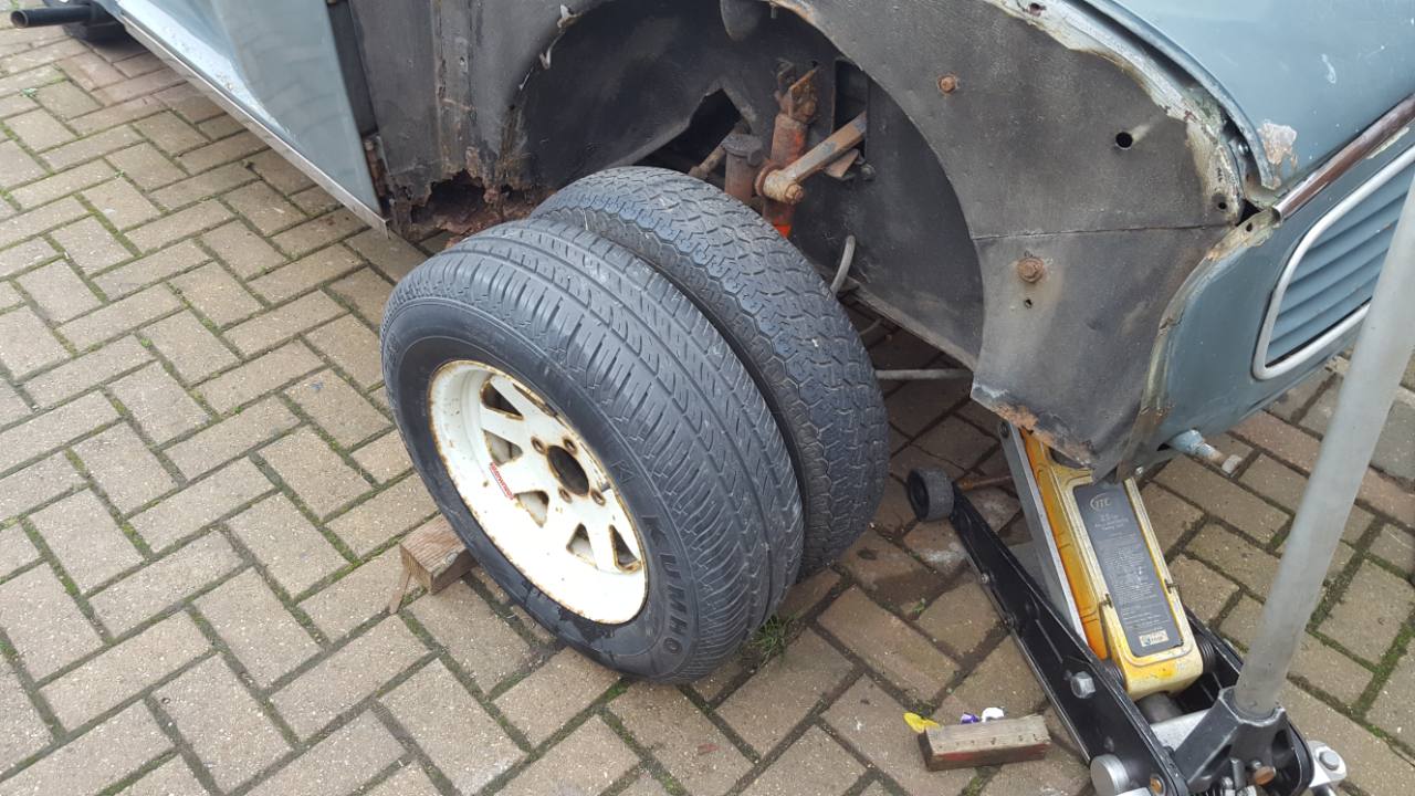

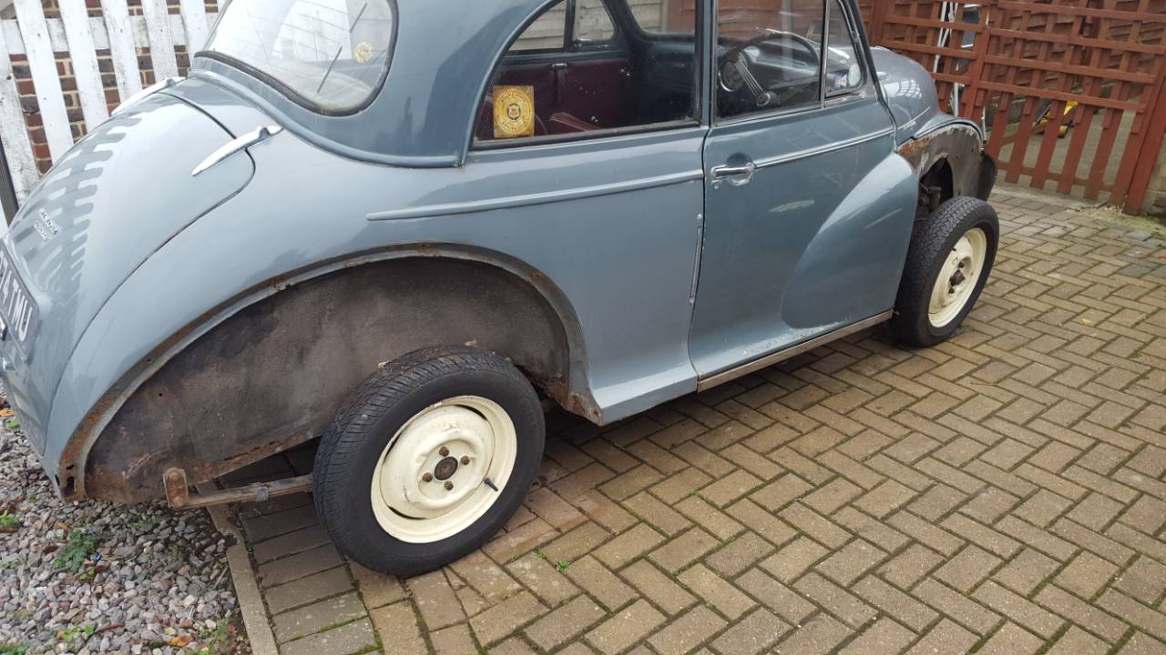

Joey spud Posted November 1, 2020 Author Posted November 1, 2020 One half timbered Moggy with skinny wheels. Is now on stands and wearing two of my Weller's. I need around 59.5 inches to squeeze though the narrowest point of the side access,lets see what the tape says... That's more like it. If the rain holds off like the forecast predicts then later in the week Boris should be safely installed up the end of the garden. catsinthewelder, LightBulbFun, BeEP and 9 others 12

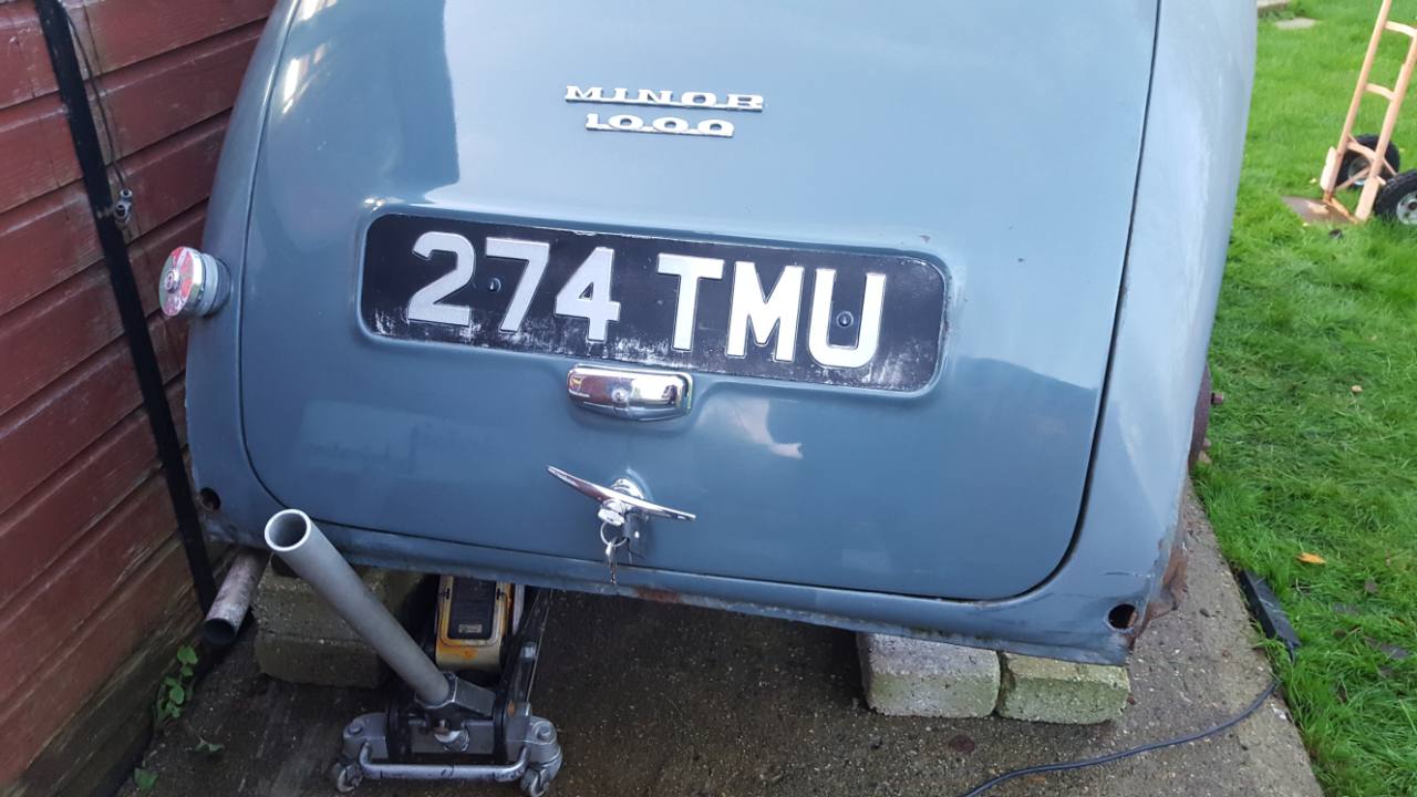

Joey spud Posted November 7, 2020 Author Posted November 7, 2020 Boris has finally made it up to the top of the garden,Boggy the Wonder Dog was well impressed (to be fair though he's easily pleased). With the narrow wheels on it was going ok until the very last fence post when the front edge of the passenger door hit so i had to back up and go slightly to the right and sacrifice the drivers door against the wall. It was quite rusty anyway but will repair if i can't find a better replacement. Up on the hard standing i have lifted him up on to blocks and axle stands taking care to get him sitting as square as possible. The car's nether regions are really rotten and the structural rigidity of the shell is a bit suspect so any wayward jacking is altering the door gaps. Still all the panels are available at reasonable prices so if i do one side at a time all should be ok,i wanted to leave the door on while replacing the floor,sill structure and A panel but i think i would be better off removing it and welding in some bracing across the opening instead. With my rose tinted specs on i thought i could have Boris welded up and on the road again by late Summer '21 but looking again at him on a damp November afternoon maybe it'll be more like Summer '22. It's not all doom and gloom though i polished the boot and it shined up ok with just enough scabs and blemishes to create the look i want. Now he is up the garden out of sight i can put the Subaru back where it was and hopefully finish the last bit of rear arch welding before the weather really goes tits up on me. Oh and also retrieve the Daihatsu from the sister in laws front garden,mot it and move it on to free up funds for purchasing the many Morris panels i need. danthecapriman, Vince70, RayMK and 9 others 12
egg Posted November 7, 2020 Posted November 7, 2020 Well done, but how will you get it back out again without scratching it! Banger Kenny and Matty 2
captain_70s Posted November 8, 2020 Posted November 8, 2020 3 hours ago, egg said: Well done, but how will you get it back out again without scratching it! Glad I wasn't the only person who was wondering this! Banger Kenny and Joey spud 2

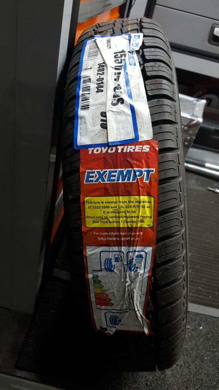

Joey spud Posted November 14, 2020 Author Posted November 14, 2020 I picked up a spare wheel yesterday from a chap in Knockholt for the princely sum of £7.10 (Ebay works shocker). Japanese tyre for a Morris what would Alec Issigonis say. I had a couple of hours free today so have done a bit more filling and sanding of the n/s wing and it's coming on ok but it's a bit floppy and wont stay still so i will get it near enough then do the final fettle once it's bolted back on the car. Both the front wings need a bit of help on their rear edges. It's a pants design as rain water and crap get sprayed into the folded seam of the outter wing and its inner flange where it sits and rots though both panels. I sliced off the section of rotten inner flange and remade the worst of it before welding it back on again. But i am clean out of suitably thin steel to make a patch for the front of the wing and while prodding i made more holes further up the panel. But it's a bit of progress while i save up for all the floor,sill and crossmember panels i need. SiC, juular, bunglebus and 11 others 14
beko1987 Posted November 14, 2020 Posted November 14, 2020 Offer to take his wife for a spin when it's done Then see if her and him want to pootle up the road in it for old times sake if you could just borrow his garden for half a day etc Or keep the scratch on the door as a victory scar after a winter of working nicely out in the garden locked away in peace and rain! Joey spud 1
artdjones Posted November 15, 2020 Posted November 15, 2020 1 hour ago, bunglebus said: What's the tyre exempt from? It's exempt from certain EU regulations as it's for cars registered before October 1990. bunglebus 1
Joey spud Posted November 15, 2020 Author Posted November 15, 2020 10 hours ago, bunglebus said: What's the tyre exempt from? Fuel economy and wet grip tests i'm guessing. The tyre is date stamped 47/2017 so isn't ancient. Banger Kenny 1
artdjones Posted November 15, 2020 Posted November 15, 2020 They're probably a lot better than the ones it had when it was new. MJK 24 1

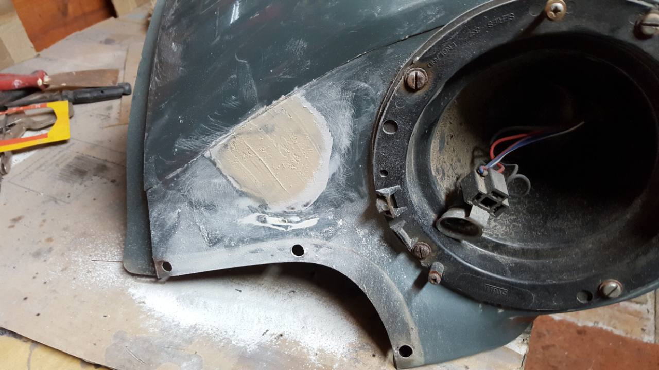

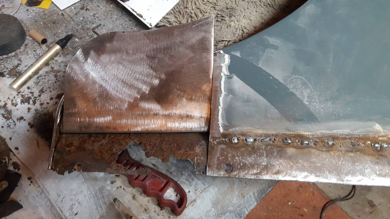

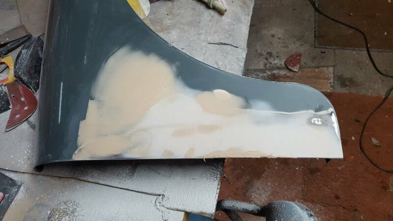

Joey spud Posted November 17, 2020 Author Posted November 17, 2020 I found a scrap of steel to patch the wing then promptly cut it too small. But made it fit. I am not a body work person but usually muddle through and was happy enough with the above until i discovered my welding had somehow made the wing pop in and out (area where the scratch is) when i lightly pushed against so i had to set it where it should be and weld a little strap behind it and the inner flange to hold it still. Much filler later and it looked about ready for a bit of primer. Which reacted with the existing paint. I have no idea what the wings which obviously aren't the originals have been painted with but i don't normally have any trouble using acrylic primers.+ I have removed the big ugly indicator/side light lamps and blanked the hole and will probably use 80's Land Rover ones instead. egg, bunglebus, LightBulbFun and 7 others 10

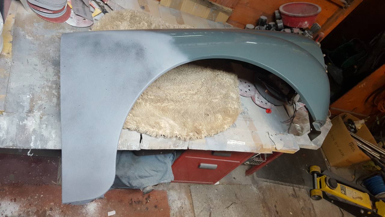

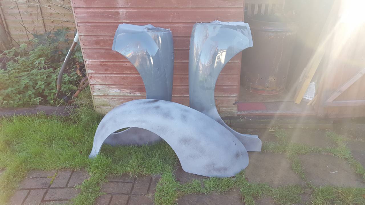

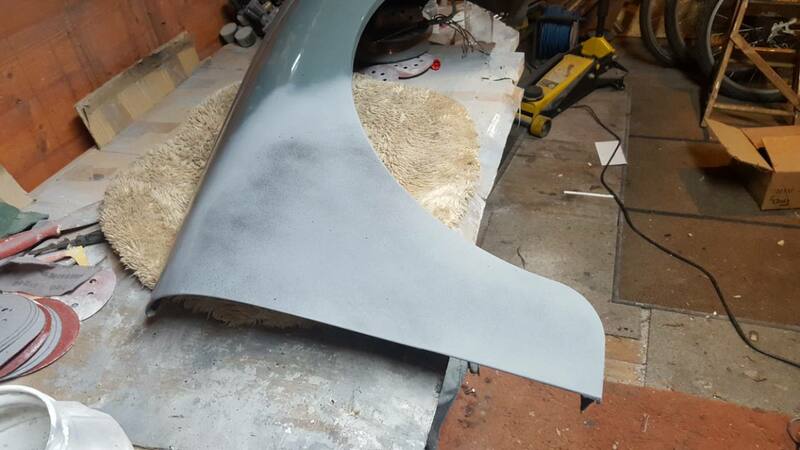

Joey spud Posted November 28, 2020 Author Posted November 28, 2020 I've done a bit more Boris. The pickling that occurred on the drivers wing seems ok now i sanded it all back and this time slowly built the primer up with a few dusty dry coats first instead of the wet ones i did last time and everything is good again. That said i will still use an isolator primer before top coating. I don't want to paint the whole car i just want to make good the repairs and keep Boris looking scruffy and honest like he has driven out of a barn after sitting since 1985 so i need to have a good think about how i go about it. Anyway the o/s front wing and n/s rear wing are ok to bolt back on in the future. I do need a o/s rear wing as mine was really grim so i just removed it with a cutting disc,i have joined various Morris Minor bothering groups and am confident a replacement will turn up locally soon enough. GingerNuttz, Vince70, Banger Kenny and 11 others 14
Joey spud Posted November 28, 2020 Author Posted November 28, 2020 So on to the far more grotty passenger side wing. I don't possess the patience (or the skills) to make bespoke panels to produce invisible as new repairs but will always give it a go. I have ordered up some 0.8mm zintec sheet but had the urge to play so used some scuffy 1.2mm stuff instead and to be fair it buzzed in ok and didn't twist and distort like the other wing did. Once the outter panel was back in place i was able to cut away this rusty inner skin and make it good again. It's a bit Frankenstein but despite my laid back,can't be asked approach it has actually turned out quite good. The_Equalizer, angle, Skizzer and 17 others 20

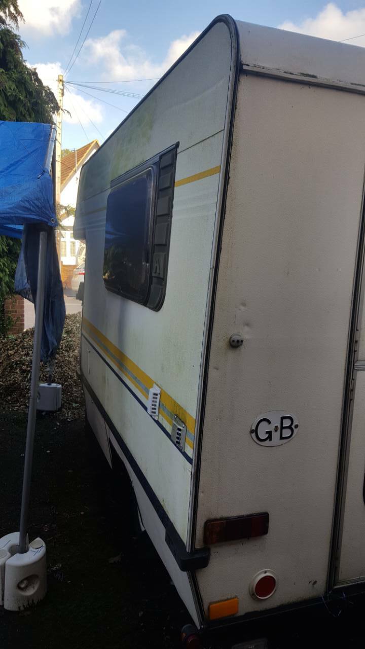

Joey spud Posted December 26, 2020 Author Posted December 26, 2020 Update of sorts. The borrowed skinny wheels are now back on Alberts Traveller but i took a pic of its front brake upgrade it's Fiesta mk3 based and was done by East Sussex Minors a few years back for a four figure fee !! Sharing the Morris's drive is this work in progress Bedford Sooty van. Back at mine i have finished the three wings to a good enough standard for paint to be applied when the warm weather returns. I have zinc primed and tiger sealed the void that fills up with crud and rots out the wings rear edge. These are stored up in the shed rafters for now. Boris has come to me with a complete set of new window rubbers which he does urgently need and also fresh coolant hoses to replace his perished and brittle ones. He also rocked up with few new bits of tin. There's a full n/s chassis leg that to be honest he doesn't need but he does definitely need the new A post/door hinge panels and n/s rear sping hanger section. In a scruffy box i found a new Newton Commercial supplied head lining. Boris has a small tear in his by the interior light that doesn't bother me in the slightest (character ?) so i bunged it on Ebay and got £70 for it which has since been spent on more zinc rich paint and welding gas. neil1971, Rusty_Rocket, Vantman and 11 others 14
bunglebus Posted December 26, 2020 Posted December 26, 2020 51 minutes ago, Joey spud said: Sharing the Morris's drive is this work in progress Bedford Sooty van. I've never experience one of those campers, but I imagine they're a) cosy and 2) mildly terrifying in side winds

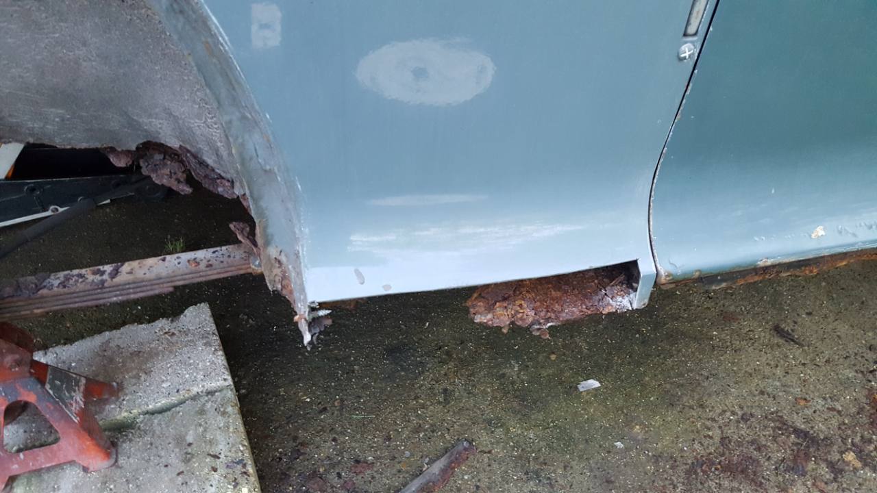

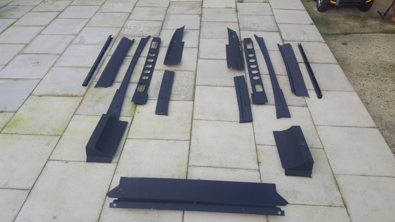

Joey spud Posted December 26, 2020 Author Posted December 26, 2020 Christmas and my birthday are a couple of weeks apart so all my nearest and dearest clubbed together and got me a ''Moggy starter bundle''. I now have repair panels for the boot floor and lower rear quarters along with all the sill,floor and step panels to get me started. I'm still going to need a few more panels but it's moving forward. Twiggy, neil1971, BlankFrank and 12 others 15
SiC Posted December 26, 2020 Posted December 26, 2020 After the hell welding up the Dolomite and hunting for expensive rare panels, I quite fancy doing a Moggy. Not only are the panels all available but most of them seem to be straight edges. I like the idea of the starter bundle. How much does one of them set you back?
Joey spud Posted December 26, 2020 Author Posted December 26, 2020 Boot floor repair patch £30. Lower Rear quarter £16 x2. Door step and finishing rail £20 x2. Sill/floor (4 piece) £64 x2. So about £230 so far. I still need centre cross member and jacking point repair panels £20 x2. Rear spring/floor mounting panel £22 x2. O/S Rear spring hanger/chassis panel £28 x1. There is also an inner sill panel for £28 a side i may need but this is a simple L section and i can make these out of 1.2mm zintec. Banger Kenny and SiC 2
SiC Posted December 26, 2020 Posted December 26, 2020 So a full set of panels on a Moggie for about what I paid for two old stock aftermarket arch repair panels for the Dolomite 😔 This is why I quite fancy doing a car next where there is a ready supply of panels! Admittedly my MGB is needing bodywork soon and they're just as well supplied for panels too. The cheapness and availability of the Moggie panels also mean it makes it plausible to use one as a daily driver in all weathers. If you're prepared for the welding work every few years... LightBulbFun and Joey spud 2
