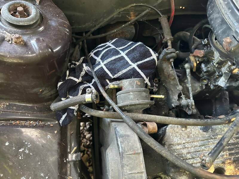

More fuel sloshed in, and still no dice. Will run fine with easy start or fuel put directly in the the carb. So will remove the fuel pump as a suspect next. Wouldn’t surprise me if that’s packed up after so long stood. It’s a long way from the tank too! Potentially it could have caused a restricted flow of fuel which would answer the poor running before potentially. One can hope!
Fuel pumps are easy to source and cheap so I’ll get ordering!

If an electric pump check you have actual amps as well as volts at the pump while you are at it, the wiring on old Vauxhalls can get a bit dodgy. A mate who was heavily into Mk2 Astras has had it happen with 2 different cars which stopped running. A temporary feed from a rear light got him home on both occasions.
It’s a good old mechanical pump.
Looks like the fuel pump is knackered.
Removed the pump and turned it manually, no fuel pumped, so I connected the input end to a jerry can of fuel and replaced the pump on the engine and span it… nothing.
Final check, is the line clear of blockages, connect syphon pump to the fuel line and the fuel flows perfectly fine.
New fuel pump time.

Fitted the fuel pump and a new coil (Lucas… eeek!) to the Nova and…. Nothing. Still no fuel reaching the carb. I tried of an external tank and still no dice.
Walked away for a few minutes to gather my thoughts and wondered if the new pump may need priming. Google said generally no, but I did it anyway and it worked! Ran it off the external first, and then connected it all up and it ran! Not only did it run, but it ran on less choke then ever before which was a big bit of progress. I was soaked through by now, and the radiator started emitting a fair bit of steam, so decided that water clearly wasn’t getting round well enough, so time to switch it off!

Re fuel my mate's 1.2 exhibited that trouble and it was that cloth covered U section before the pump had cracked under the cloth and the pump was sucking air.
Thanks, good tip. I replaced that as part of the new pump process in case.
