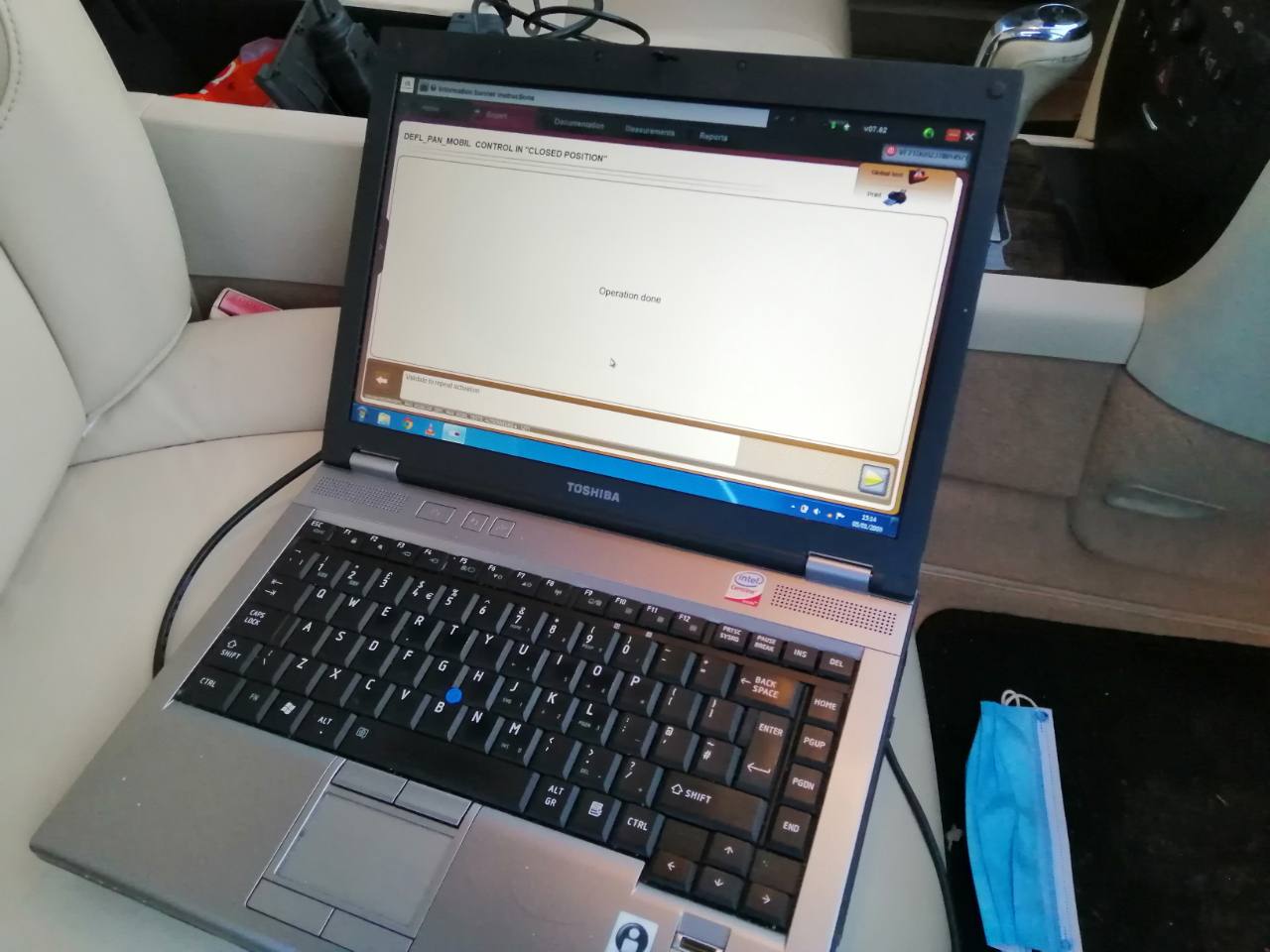

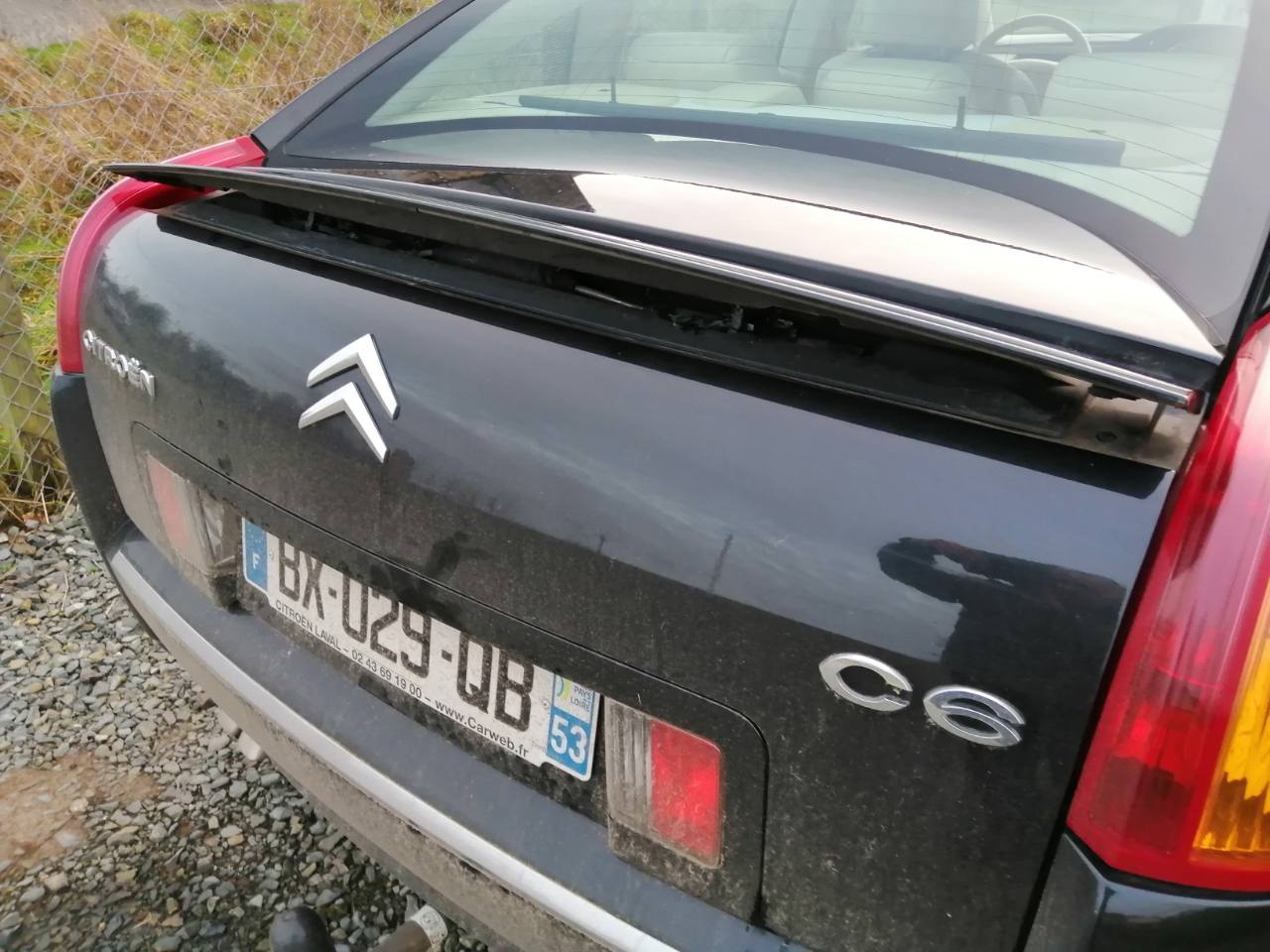

One minor issue was the spoiler sticking up.
A bloody good talking to with the laptop and some grease sloshed on...
And it's working again.

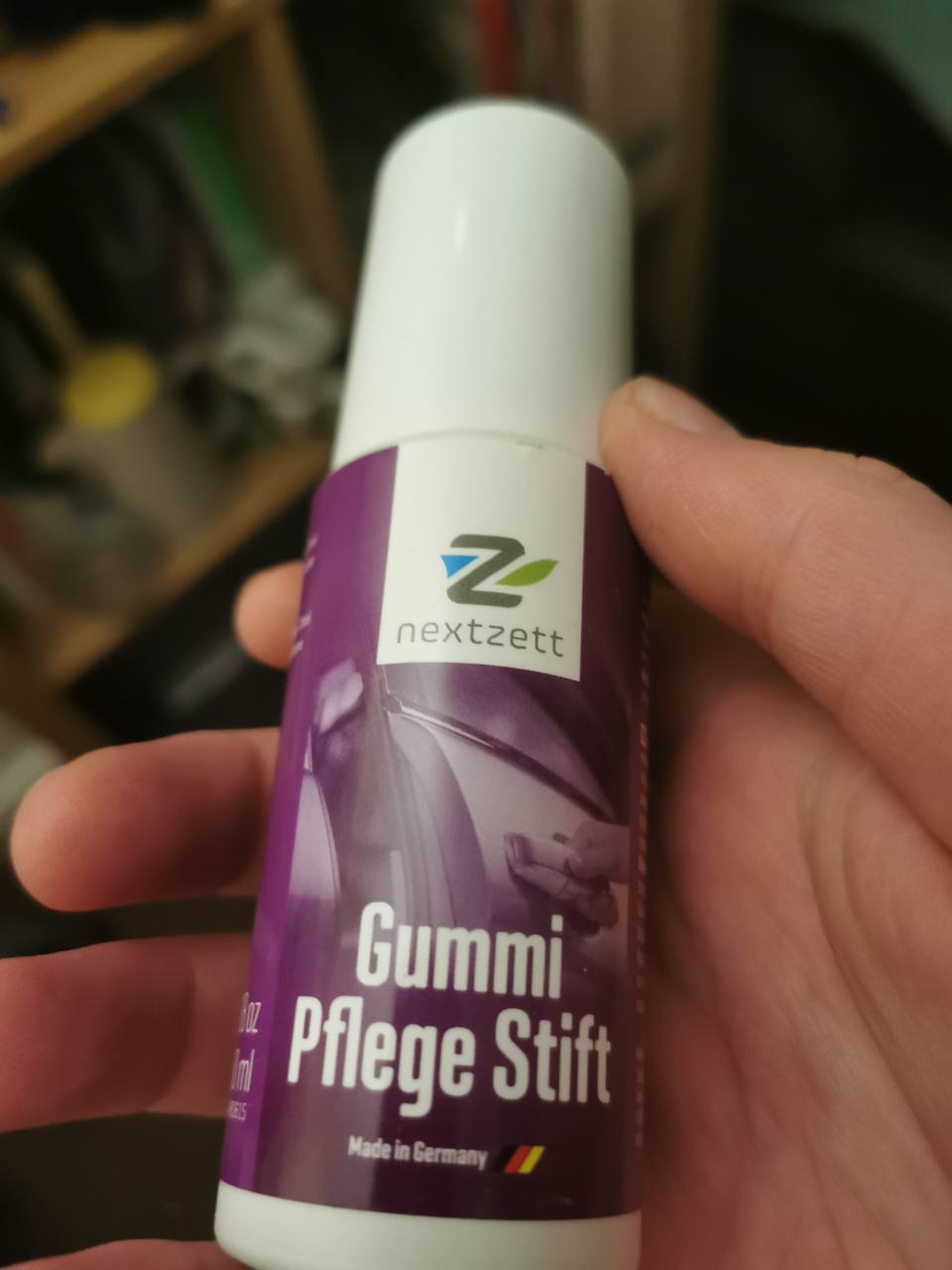

Whats gummy pfledge? Sick of wiping silicon grease onto door seals....
It’s great stuff, brings rubber back to new if it’s not falling apart.
I used to use Krytox but it’s very expensive, this stuff is much cheaper but protects and softens rubber and stops door seals etcs freezing.
Will be ebaying it. Many thanks 👍👐
It's gummi pflege. Not picking up on spelling other than to help maximise your search results. 👍
Farecla UV wax does the job.
It's a Wurth product, although no doubt there's a similar thing available from other vendors.
I love that people drive these - I have no wish to own or drive one but I'm just glad that some will be there for the future
Thank you for your service
is it still Wurth or have I been scammed on the evil bay?
German goo for rubber; try it and see. Ausgezeichnet. This is the Wurth stuff, but that's quite possibly the same stuff in an non-brand wrapper.
I believe Nextzett were original manufacturers and others have copied.
Gummi Pflege really just means rubber conditioner, it should definitely help with frozen to the seal doors!
