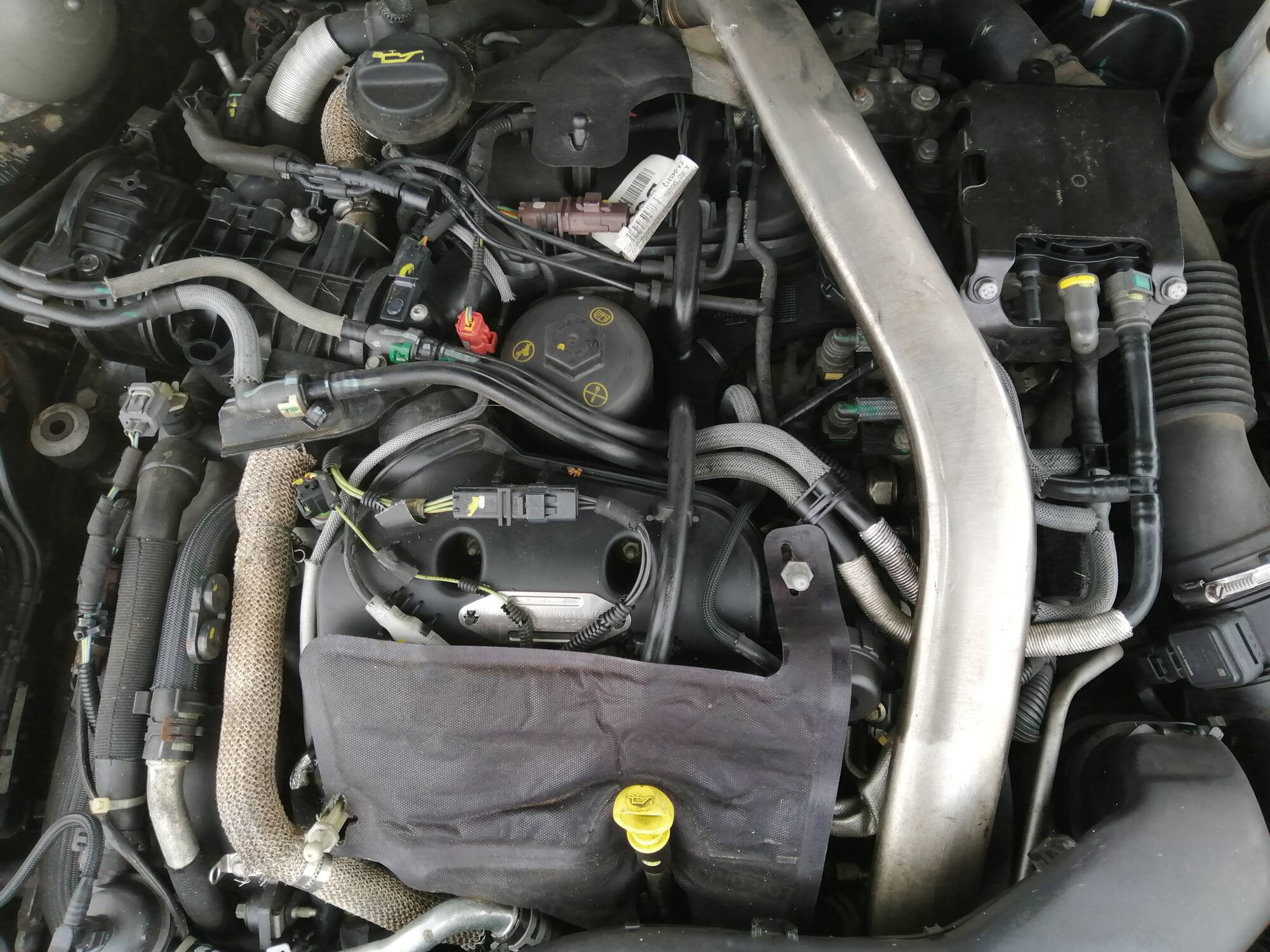

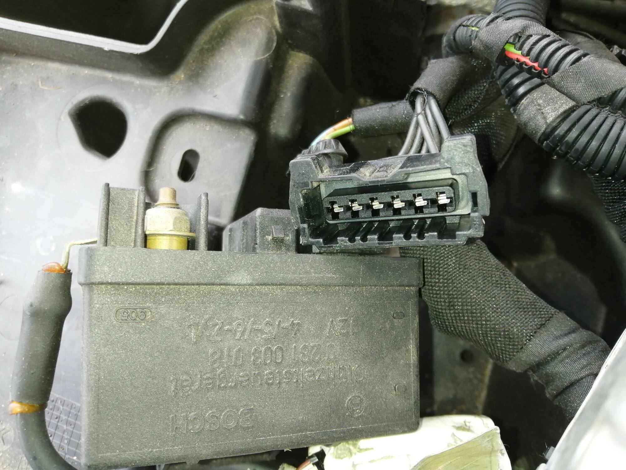

Glow plug resistance has been checked. They live deep in the Vee somewhere.
But you can get to the control box by simply shifting the engine and suspension Ecu's.
Looks like only one is healthy.
Checks out the same at the connection on top of each bank.
Probably worth a good dose of contact cleaner before you reassemble?
