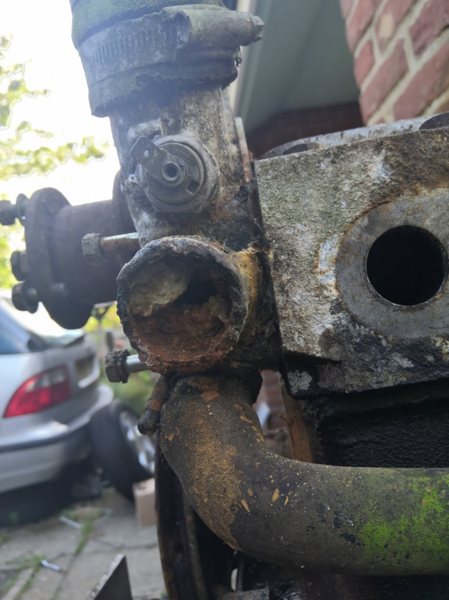

As you can see, the waterways are definitely gunged up, so I'm going to need to get busy with the pressure washer once I have some time for it. This makes me a little concerned that this was the state the engine was in before it stopped running, but hey ho - no point worrying about it now!  This was the waterpump inlet when the pump came off - so  clearly I'm going to have to clean the pump completely, or perhaps use Bob's original one if it's better.

Get a new water pump,they don't like sitting idle,and it will most likely leak when it's all back together.
IIRC the internals of Bob's original water pump were in much the same state as this inlet pipe, hence probably this:
