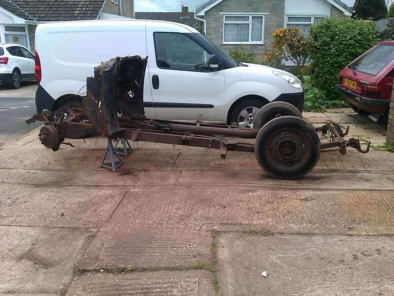

That means that the bodywork - apart from the bulkhead - is now off the chassis. It wasn't a difficult job since it was all quite rotten. For reasons of reference, I took both sills off whole since this will help me understand what shapes to make for ours when I do the considerably smaller repairs they need. Having both the sills off the donor gives me a rough sketch of how things should look and will mean I can make oversized panels and trim to suit easier on our car since I've got something that I can work with 'on the bench'. It also meant I could take the B pillars off at the same time without trying to remove them separately. The other item the sills have is the carpet edge trim weather seal pieces which our car is missing, these should also be easier to remove and retrim/remake when the time comes to doing it on our car.

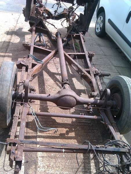

Shall we have a look at the chassis then? Overall, it's in pretty good shape at least as far as I can see at the moment. It's not perfect, understandably, and does have some localised issues. I was expecting a lot more rot and issues than there are. Obviously all the jacking points are knackered, and have had a variety of repairs over the years. I had hoped there'd be at least one whole jacking point I could use as reference but there isn't, I'll just have to figure it out from what's on our car and start from scratch with them.
On the rot front, there's some in the front of the chassis rails ahead of the crossmember, and a little bit in the side rail under the driver's seat. These do look repairable if you can work in suitable thickness steel and do seem very localised. The rest of the chassis has some pitting as you'd expect but it doesn't appear to have any particularly thin or frilly bits. We'll see how it goes as I remove the rest of the items still attached currently.
The body mounts appear to be in good shape, though the same could not be said for the bodyshell where it mounted to the chassis, in some places leaving behind good chunks of itself as the remains were lifted free.

Yesterday I hosed the chassis down to get the bulk of the dirt off and make it easier to strip the few remaining items of value to us.  It looks much the same as it did in the last photo.  This made stripping off the next few bits somewhat easier since I could see where the fixings, or what was left of them, were.  Most of the items I want off the bulkhead are now off, there's very little left to remove here.
That meant today's small haul is the wiper motor, some wiring harness P clips, the copper fuel lines, the fuel reserve cable and pull, and the bulkhead trim panel.  Somehow, against all logic, the bulkhead trim panel has survived with little more than some surface rust on the rivets and a bit of surface mould on one edge.  Given how this car was stored and how prone an area this is to getting wet, it should be little more than mush.
Still to remove is all the rear running gear including the leaf springs and lever shock dampers, the front suspension and hubs, the main battery cable, all of the brake mechanisms, and what's left of the wiring harness.  That should then leave us with a chassis and bulkhead awaiting its fate at the hands of the DVLA.

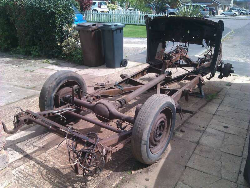

All of the front suspension has now been liberated, along with the main front-to-rear brake rod.  I had intended to then remove the rear axle but I was done with fighting rusty bolts and skinning my knuckles so changed tack.
With the front suspension removed it was very easy for Pat and I to pick up the front of the chassis and just move it to the new location.  The only thing that made that difficult is the rear wheels won't roll.  This could be a lack of weight so it's just easier for the ancient tyres to skid than roll.  It could be that because I've removed the handbrake cable and mechanism, and the front-to-back brake rod that the brakes are on, or it could be that this was the first time we'd tried to roll the car forwards and something is broken meaning the rear wheels only roll backwards.  I don't know.  It didn't matter anyway, because there was so little weight we could just drag the thing to the new spot to free up the garage and get the good Lanchester out.
The main reason I wanted to do this was some metal drip trays I'd been keeping on a stack of wheels had fallen off without any input from anything, apparently, and I couldn't get in to sort it out without getting the Lanchester out of the garage, which of course I couldn't do with the donor blocking the way.  Turns out some of my plastic storage boxes are collapsing, had shoved against the stack of tyres moving them far enough that the metal trays fell off.  I suppose I better spring clean the garage then.
Much better!  I've relocated the tyre stack, shuffled all my rubbish... er... valuable and rare spares.. about and gained a foot or so of extra width and length to the useable space in the tiny garage.  That's quite an achievement.  I even threw some things away!  What I didn't do was go through every single box and organise things because the boxes are fragile, I only had so much time, and I can't afford the racking I want to put in the garage to solve my storage issue.  The good Lanchester is way easier to get in and out of the garage now we've got that extra space to play with, and I can get to stuff easier too because there's room to walk down the side of the car at last.

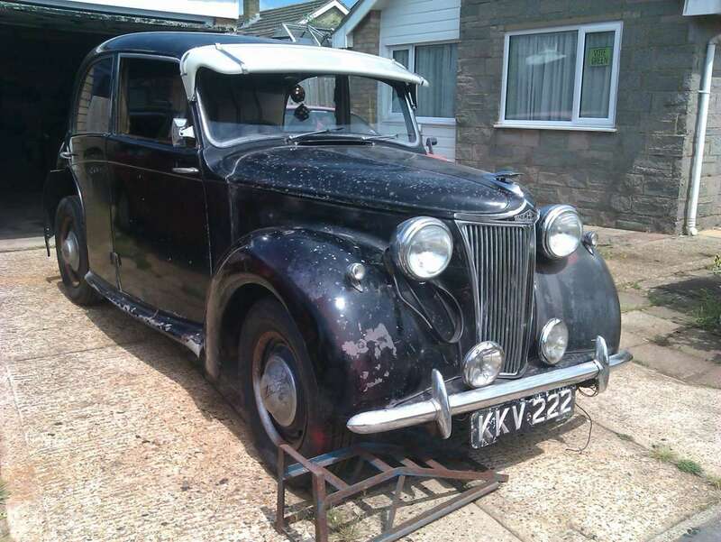

Good Lanchester out of the garage and I'm happy to report no signs of active woodworm, moths, or other pests.  Aside from some dust, all looks well.  As a little treat and to keep them from getting accidentally damaged, I boshed the three trim rings that came with the donor car on our car.  These rings will get the oxalic acid treatment followed by a coat of lacquer or similar to keep them from completely dissolving.  It would be nice to find a fourth scruffy one to match, for now these will do.
Looking forward to being able to dig into KKV again soon and get things moving once more now the donor car is properly out of the way.  Still more to remove from the donor of course, there's just less pressure now since we've got to wait up to another month before we can chase the DVLA about the V5.

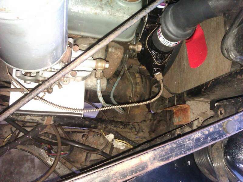

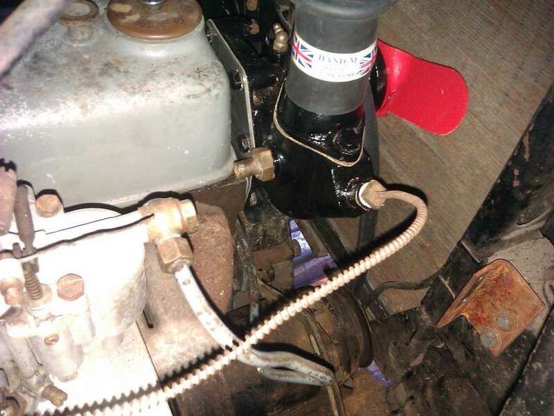

We are finally putting things back on the car instead of taking them off.  The main thing to reinstall was the waterpump, to do that it needed the engine mount to be replaced which until recently has been an issue.  Happily, the donor car came with what appears to be a NOS engine mount.  It isn't an easy job at all to replace the engine mount, the radiator had to come out, the water pump would have had to come out had it not already been removed, and it took Pat on one tool and me on another to get everything in.  You also have to jack the engine up under the sump - cast aluminium and not finned so it's strong enough for the job - so you can align everything.  The old engine mount came off in three pieces, which it shouldn't do.
The new one slotted in quite nicely and once installed we found the engine sat a good bit higher and now had some wiggle to it where before it was completely solid, which makes sense since the rubber part of the old engine mount wasn't really doing any damping of any sort.  After that, the water pump could be reinstalled, the top hose put in place so it's not floating about in a box, and the radiator slotted back into its hole.  The new fan belt was also dropped on.
Finally, the dynamo was reinstalled loosely.  The stuck nut that had caused an electrical connector to shear proved to not be stuck at all once the dynamo had a spanner taken to it and undid quite easily by hand. Not sure what that was about but since nothing else was wrong with the dynamo before it made sense to drop it in the hole today so it's another thing that's not just knocking about in the boot.  At this point I'm only interested in restoring and sprucing up parts if they need repairing, if they don't need repairing they can stay scruffy until further notice.  Access to fit the dynamo is appalling and I hated every minute of it, in case you were curious.
