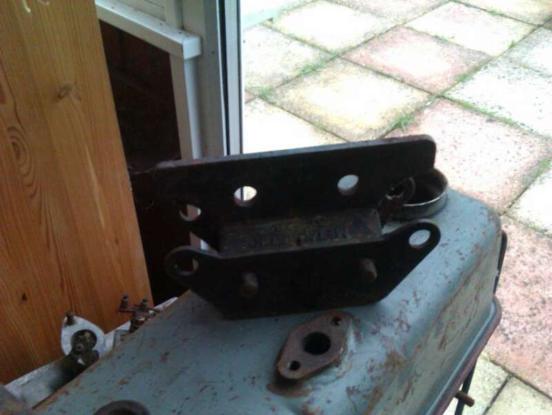

The best find for us was the NOS looking engine mount, a part that was basically unobtanium.  It was very nearly worth buying the whole car just for this part because now we have a spare in the form of the one on the car we can hopefully get the rubber part recast on as a back up, a good idea since apparently these cars like to go through these particular mounts every few years.

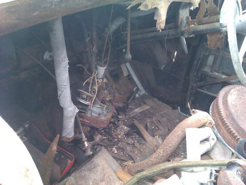

All of the plywood inside the car is riddled with woodworm, none of it is salvagable.  The bulk of the solid wood frame on the other hand appears to be unaffected so I might yet be able to liberate a donor sample from the rear corner to help ours out in the future.  We shall see.  It's a mess, it really is, and too far gone to realistically restore.  I mean, you could if you desperately wanted to but it would be a hell of a lot of work to do it and you'd likely need another donor car for some of the missing parts.
Originally the car was black with a green interior.  At some point it's had red seats fitted (which are themselves only fit as donors due to extensive woodworm and general rot) so the interior must have had a rather jolly and festive look at some point in its long life.
The odometer reads 75k-ish and I can believe it.  The sills, what's left of them, have some pop rivetted aluminium repairs.  There's filler flaking off the boot lid. The outriggers have been replaced with some BEEFY box section.
It's also got moss growing on a lot of it.
All that said, there's a wealth of really usable stuff on it for us.  Loads of fixings that are still in good shape that we need, the original wiring is still intact (except for the bits that attach to the engine) which will be a great reference point, and some of the sheet metal looks like it might even be better than some of ours.  All four tyres hold air, or rather, all four inner tubes hold air.  Managed to get 10psi in the front before the inner tubes started to prolaps out through the sidewalls, and 20psi in the rears which made it possible to roll the thing fully back on to the drive.

Worth seeing if that mob over in Poland that used to be able to reman the bonded rubber top strut assemblies for Xantias could help with the engine mount?  Can't remember their name now for the life of me though... though sure a search or ask on the French Car Forums would dig it up.

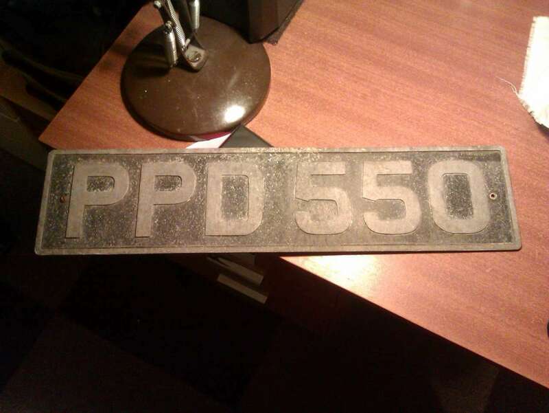

its a Surrey registration mark, no records still exist for that county council sadly
so your best bet here if there really is no paperwork like a buff logbook or old MOT certificate, is just send off a V62 and just hope to your preferred deity, that it managed to survive on the road into the mid-late 1970's-early 80's and get computerised, and thus so the DVLA have an archived record of it, as thats the only way your going to be able to get a V5 for it for its current ID, if it came off the road before managing to get computerised then sadly theres not going to be any way to get its registration mark back
however in theory you may be able to register anew, under an Age related mark if you can get a dating letter for it
speaking of registration etc, dont happen to have a nice close up shot of the number plate for us me to oggle at? :)

I've taken photos of the car and the ID tags at the point it's at now, from numerous angles and distances, as recommended elsewhere.  We've got to sort through all the stuff we took out from the inside of the car before we can start dismantling it so at least presently it does look like a whole car.  I wouldn't be surprised if it came off the road in the late 80s or early 90s, the packaging in it suggests that's when the engine was dismantled, so it might have survived into the digitisation of records.

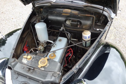

I also know what goes on the inner driver's side front wing in the engine bay.  What I don't know is what it's for.  Too small to hold a coil (and the wrong side of the engine bay anyway), too big to hold the wiring harness, and probably too flimsy to hold the jack or wheel brace.  I've no idea what's supposed to live here so hopefully someone else does.

Holder for an oilcan or a greasegun?
Hmm.. could be.  It's about the right diameter for my grease gun.

PPD550 was registered Surrey between Nov. 1950 and Oct 1951
There is a note "Allocated in blocks"
Many Licensing Authorities set aside blocks for allocation to a particular organisations eg McAlpines or Government Departments
or for allocation solely to tax classes (typically numbers 1 to 99 for Motor Cycles)
Well, that's my new Grindr username sorted.
Ah Homo number plates, always a right giggle :) (I appreciate the shots!)
