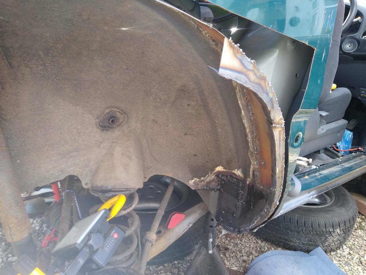

Day 3 finished. Note to self: check the wire speed! I think the welding has improved because the wire speed was knocked up high to weld upside down.

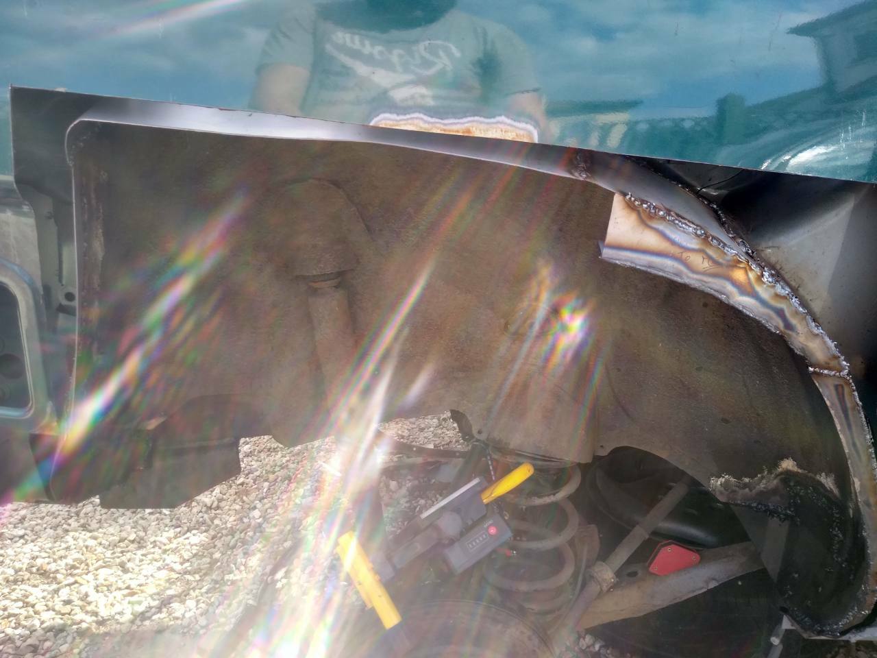

So I finished the bottom of the driver's side arch.

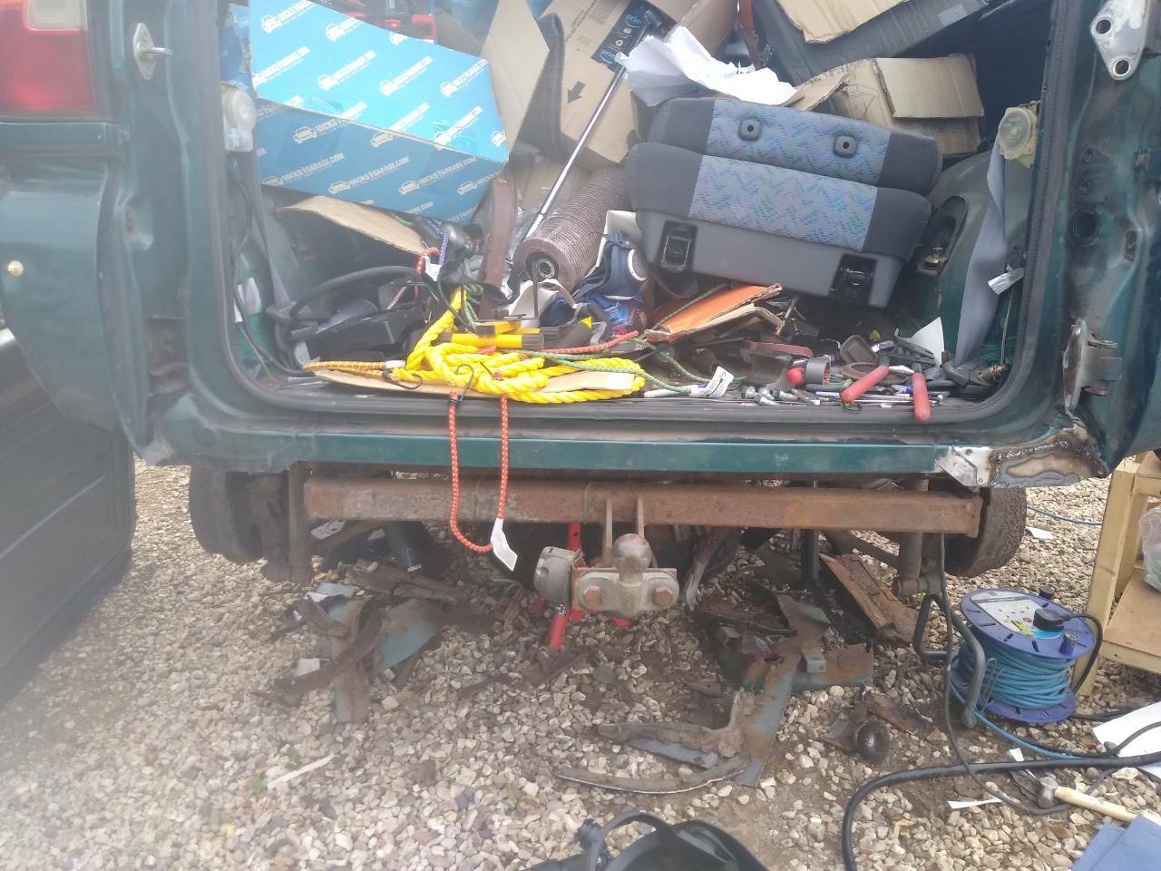

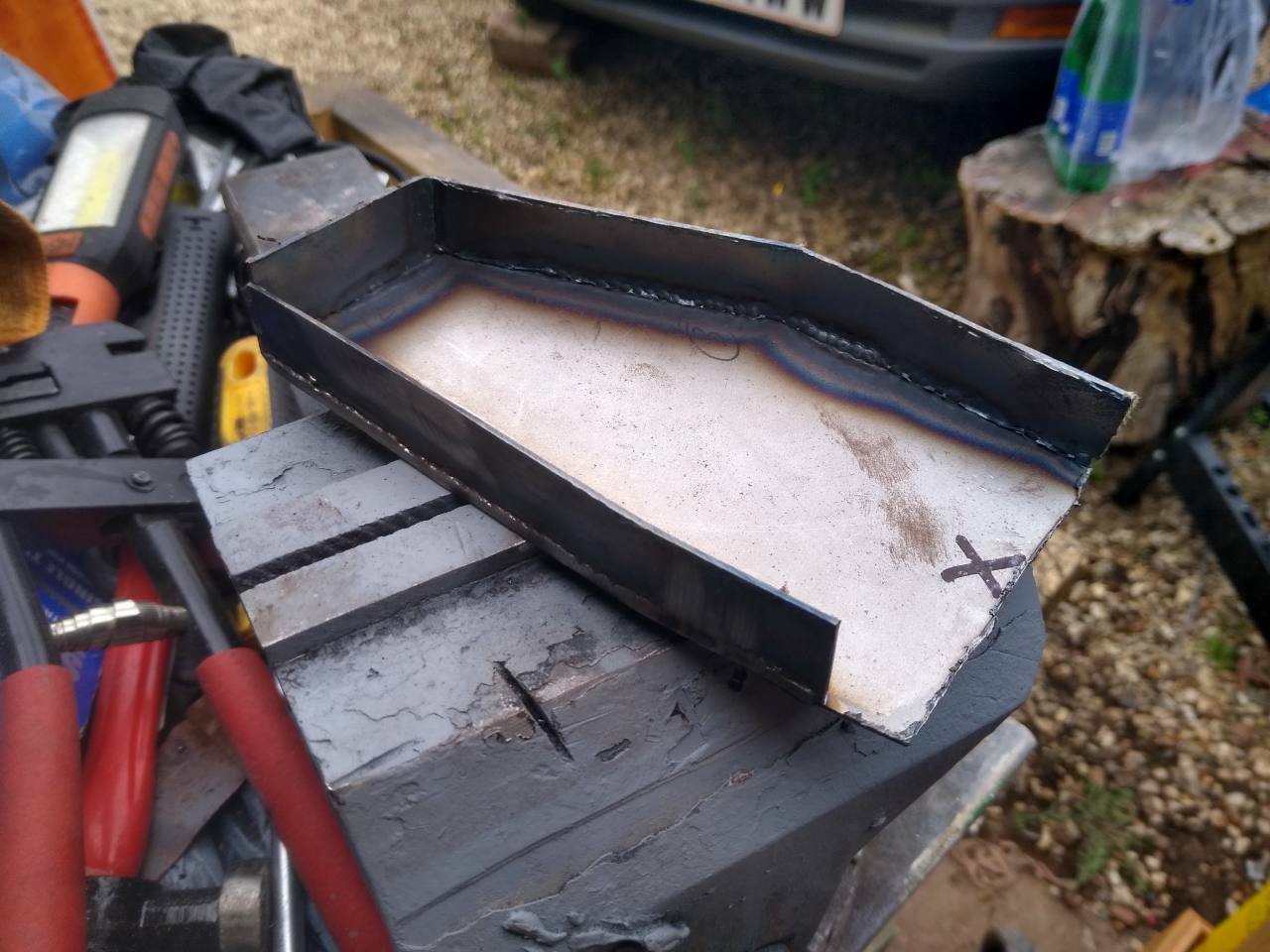

I then turned my attention to the rear, and there was a corner of rust by where the rear door hinges that looked dodge. It was dodge, so I took the door off. Not great to do when my knee is getting worse!
Cut out the rot, and started rebuilding it. Sort of did the same as the other side, with the exception of putting in a bit of reinforcement which was now missing as it was rotten.
It started raining, so I rushed the last bit.

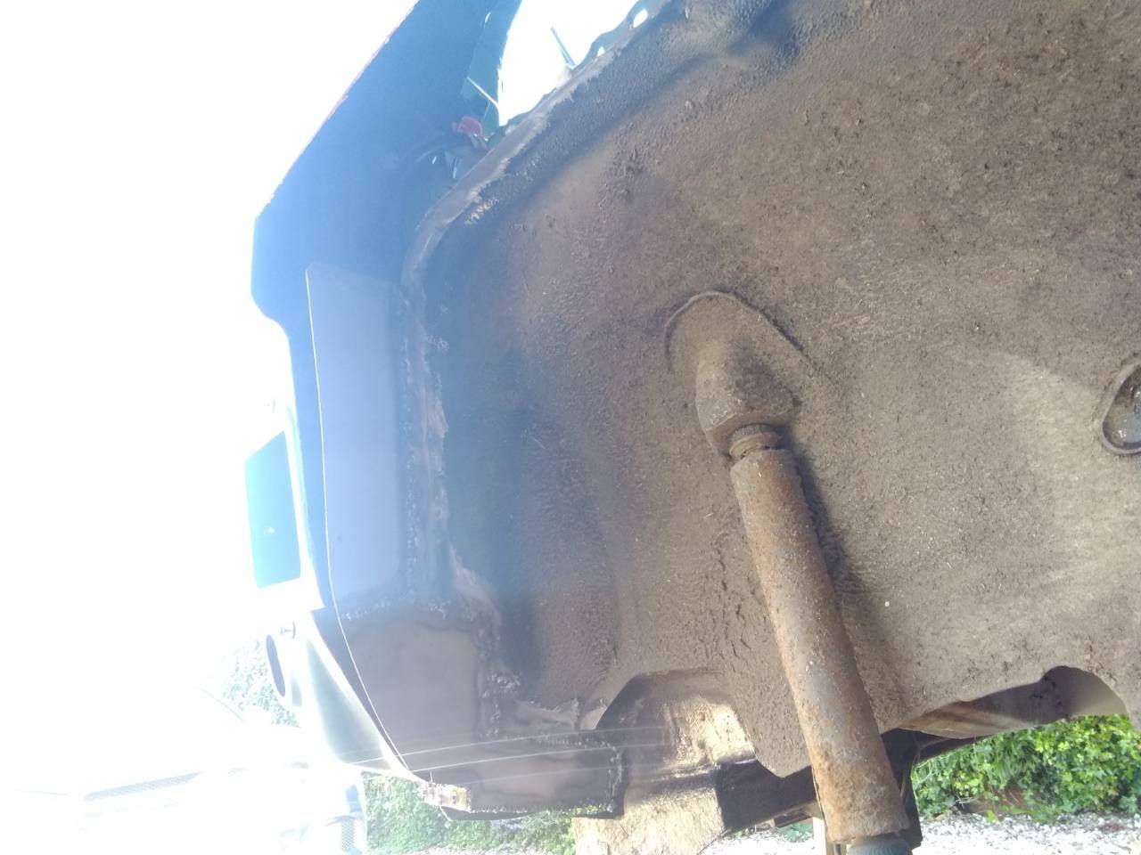

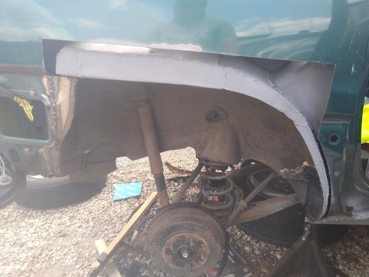

I've an arch! Nearly.
I've got to do the rear part, that shouldn't be a big issue. But tomorrow the new panel will be in place!
Can't begin to say how much easier it is when you don't have a fuel filler neck to account for, but there we are.

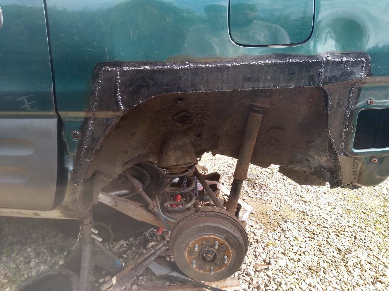

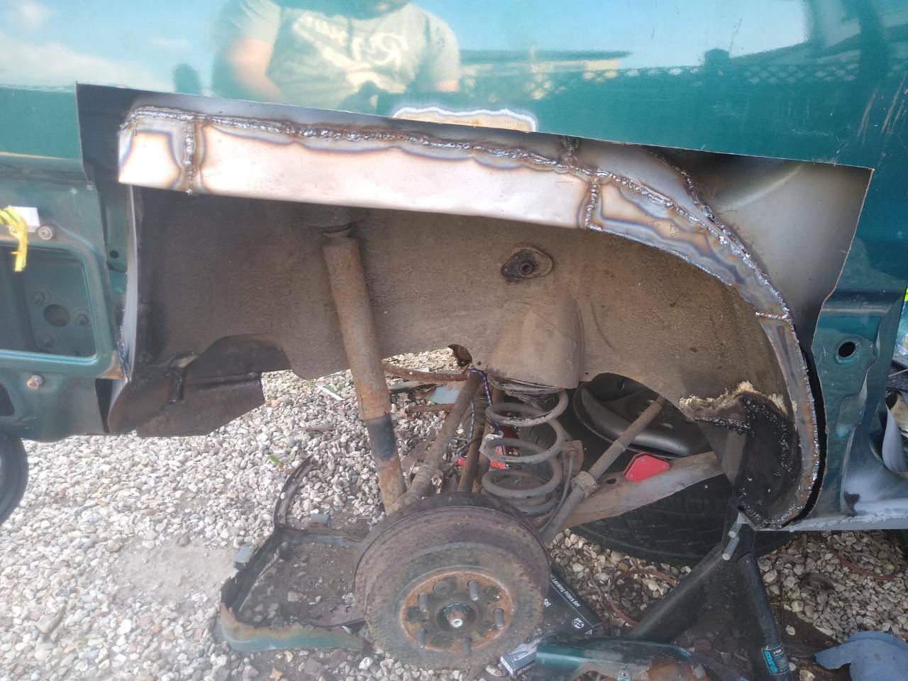

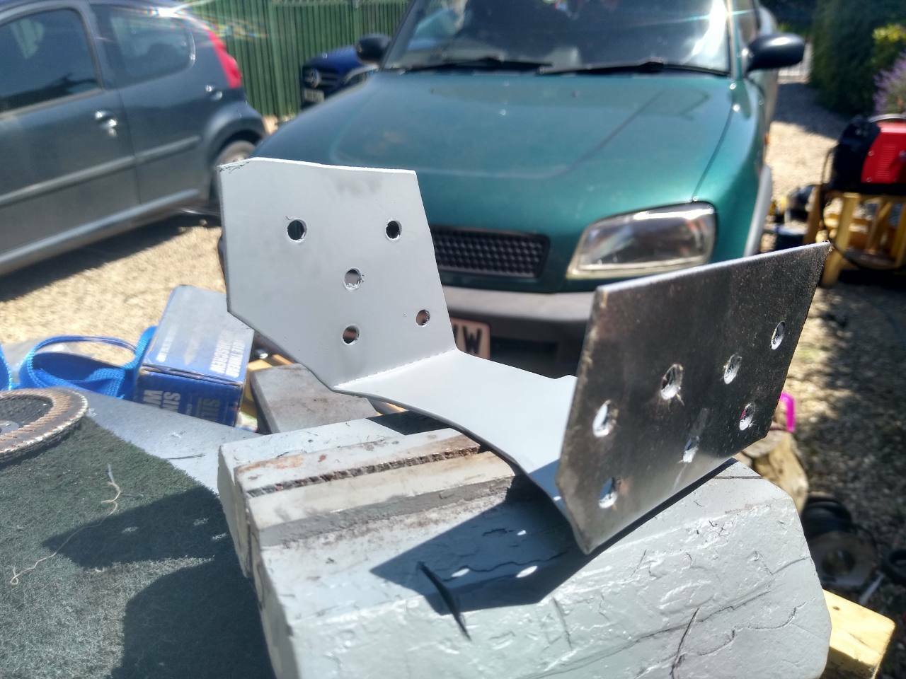

So, I've got an arch, and it's all welded!
As you can see, I tried my best but the original panel still distorted. Not as bad as the passenger side, but fairly annoying.
Not as annoying at what happened to my finger. Don't know how, but a bit of weld fell on to my ring and Christ it hurt. Took my ring off and revealed this boo boo.
That's my Dad's ring and it's been on that finger since the day he died practically and it's never been off. Not even for rugby, but a stray weld splatter means I've got to take it off for a bit.
Other than a slither of welding to do on the passenger side, and a bit of an amendment to some welding on the sill (all of which is about half an hour to an hour's worth of work) - ALLLLLLLL THE WELDING HAS BEEN DONE.
Tomorrow will be a day of going deaf with grinding down some of the welds, then cleaning the underside for a day of red oxide primer paint for Sunday. Hopefully!

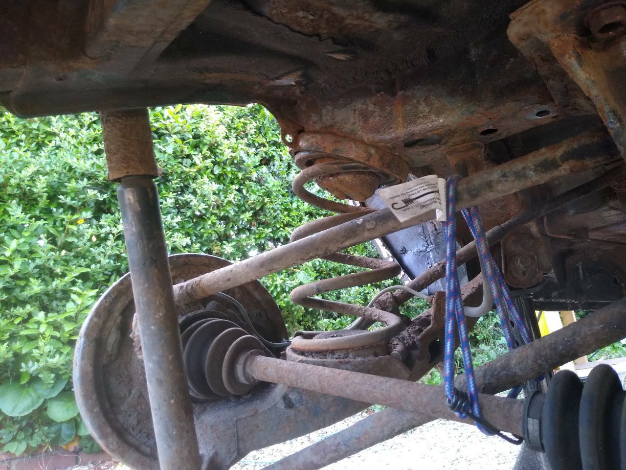

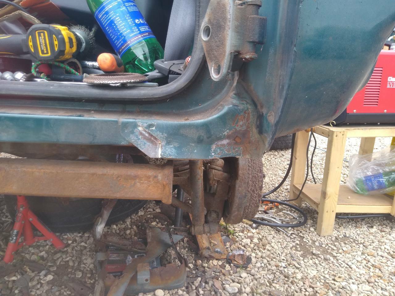

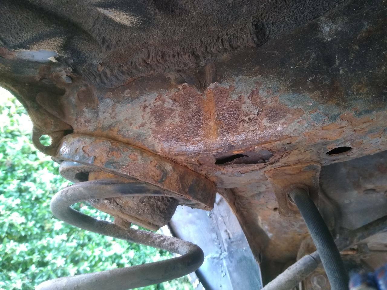

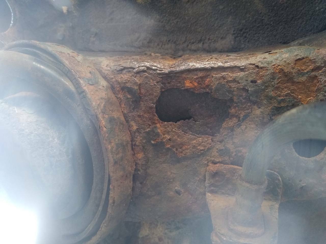

While underneath the car, with the wire brush and DeWalt (not Dettol this time), I discovered some cracks by the passenger side springs. I kept the wire wheel on it, more chunks of steel came off, exposing the inner skin, and a swift poke of the screwdriver....
Yeah. Not good. Not great. Not anything to be fucking happy about. The driver side is the same bar the inner skin, as it still feels ok but isn't as think as it once was.
So I'm here now, applying plusgas to the rear suspension which I didn't want to take apart. The wife is sorry for me, but also doing the wife thing of "scrap it m8" - and I'll be honest now more than ever I'm tempted.
I'm not 100% sure about how far the rust creep affects the spring seat. I think it might be ok, but then when the angry pixies get at it how long will it remain steel instead of disappearing like so much of the other steel has when it's been a bit thin?
Tomorrow then I'm dropping the trailing arm and associated bits and pieces, helpfully the brake line needs to be disconnected to allow the lot to come off. Also means jacking the car up and relocating the axle stand a bit more inboard which I don't like having happen on a car I'm going under.
Genuinely, this could be it for the car - at least under my stewardship.

Tried to remove the spring, wouldn't go without dropping the shock absorber. So that was nice.
Moved the axle stand to more inboard, and still managed to pick the most useless place for it as I couldn't get my fat head and fat mask in properly to weld the patch as you saw above.
But, eventually, with a lot of swearing, sweating, and a fairly low moment with the brake line, I got it there.
I wrapped the rubber brake line in my other welding gauntlet. If it's good enough for my hand it'll be good enough for the brake line. Welded for 2 seconds, let it cool down a lot, then went again. So no fire occured, quite proud of that. Not proud of the fact this is the most MOT bodge I've ever done on anything, but fuck it it's strong, does the job, and lets me move on.
I will say that I heard something from the wife that I'd never thought I'd hear. When I came in for a 5 minute break from the heat (had been out there since 10:30, this was about 1:30) I said I was half way through the welding. She asked what was left after that, and I said I had to clean the rust off the rest of the car. At which point she said "maybe don't clean too much or too hard this time". I will remind her of this when she moans about the kitchen again.
So I set about with the De Walt and wire brush, and it did most of the car before I thought something odd was happening to the drill. It kept flying off, like it was in top gear or something. Long story short, my 6 month old drill has a bust gearbox. De Walt with their De Wank quality eh? No matter, I had done enough.
This point I then got the Vactan out, with my W cup and brush, and started treating everything orange. It was at this point I could hear hissing - my welder was still out and I thought maybe the gas that was left in the regulator was escaping, but it turned out the gas was on and the regulator is toast! The rubber line from the regulator to the welder has a hole in it I think, as I moved it around and the hissing would stop or get worse. I did wonder why I was getting through so much bloody gas! Now we know.
