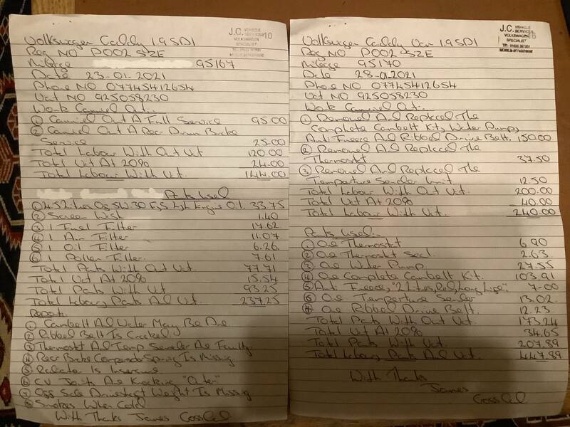

Marm Toastsmith Posted January 24, 2021 Author Posted January 24, 2021 Caddy has gone to the local VW specialist for a good service (including cam belt and water pump). It deserves it. He's a "fine tooth comb" sort of a guy so I'm relieved that he hasn't found all that much wrong with it, but it's going to be an impressive bill. Fuck it, I'll just have to keep it for a while. My last mechanic would typically have changed the oil and filters, checked the pads and fluid levels, and called it a day. If I'd really pushed he'd have a quick look at the cam belt, declare it as looking like "brand new" and send me off on my way. CR-V is soggy inside and has been for a while. It doesn't get used enough to properly dry out, and it's shaded from the sun for most of the day outside our house. Thinking about putting an electric heater in it for a day or two, what do you reckon?

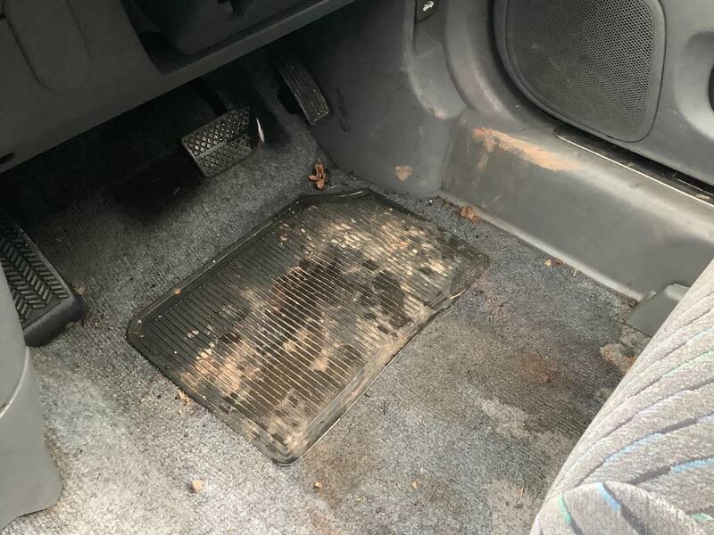

Marm Toastsmith Posted January 29, 2021 Author Posted January 29, 2021 Ouch. Oh well. While it was away getting ready to cost me money I managed to pretty much dry out the CR-V. Put an electric radiator in it for a couple of days and then drove it to work and back with the heating on full and the aircon on. The internet said this was a good idea. It made my eyes hurt and the aircon was making some funny noises by the time I got home (and even after I had turned it off) but it seemed to work. theshadow, Coprolalia and 00833827 2 1
Marm Toastsmith Posted January 29, 2021 Author Posted January 29, 2021 You get quite a lot of writing for £685.14 privatewire, louiepj, Tenmil Socket and 4 others 6 1
Marm Toastsmith Posted February 21, 2021 Author Posted February 21, 2021 The good news is that the Caddy has been improved immeasurably by the spends and TLC. Also I just had a check under the bonnet and there is lots of clean new stuff under there so I didn't only get writing. Tyres and ICE are always money well spent IMO, good audio and rubber is the main thing that you get in a new car and miss in an old one. Less pleasing but at least not all that unfamiliar is the puddle of rain water that greeted me in the CRV this morning. Having done zero research on the subject my plan is to remove the plastic scuttle cover and check for blocked drain holes. Unless anyone's got any better ideas?

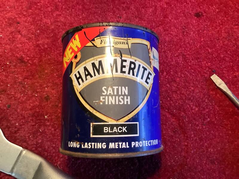

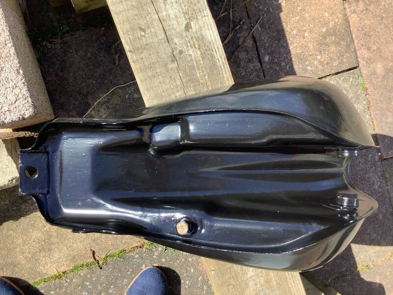

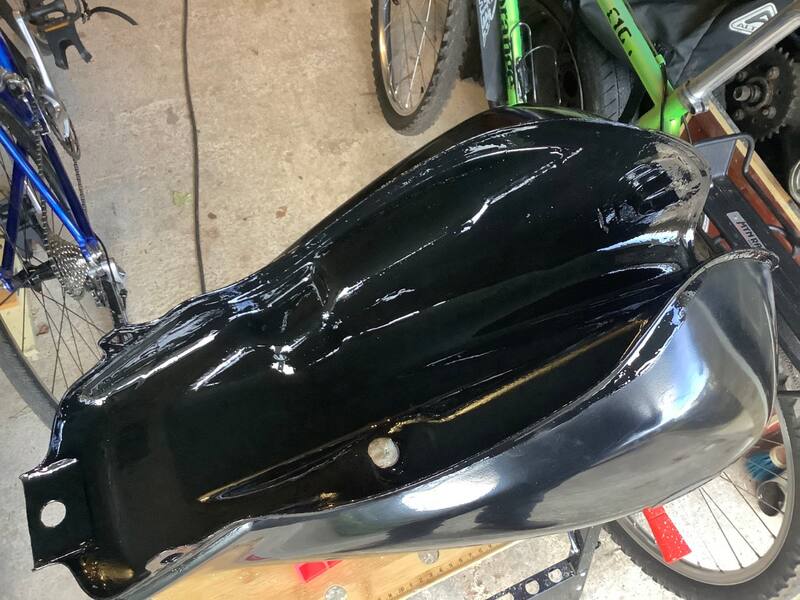

Marm Toastsmith Posted March 15, 2021 Author Posted March 15, 2021 Finally got around to painting the bottom of the CB250. Slapped it on thick but quite pleased with the result. I think this is "old hammerite" / the proper stuff. Went on nice. privatewire, mercedade, theshadow and 1 other 4

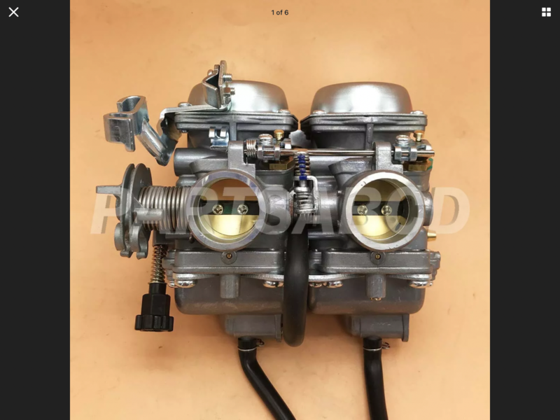

Marm Toastsmith Posted March 15, 2021 Author Posted March 15, 2021 15 minutes ago, Stanky said: Have you tried aliexpress for a Chinese clone? probably not as good as genuine brand new, but also likely to be no more expensive or worn out as a 2nd hand ebay one? Just a thought? I like that idea. eBay has turned up twin carbs for it which could be brilliant or a total pita. I looked into it briefly and I think in some markets (eastern?) they and equivalent bikes (Rebel) had a twin carb setup. https://www.ebay.co.uk/itm/222228042740 I think you can get the manifolds etc. too, but I don't know whether e.g. throttle cable is the same. Did find some mention of them on youtube vids but if memory serves mainly people who had decided against them. Stanky 1
Stanky Posted March 15, 2021 Posted March 15, 2021 46 minutes ago, marm said: https://www.ebay.co.uk/itm/222228042740 corresponding option from the PRC: https://www.aliexpress.com/item/4000642720308.html?spm=a2g0o.productlist.0.0.4bb441caJUKJBJ&algo_pvid=450a56dd-2346-476f-992f-6f3ddfe3fb46&algo_expid=450a56dd-2346-476f-992f-6f3ddfe3fb46-1&btsid=0b0a556716158329687282736eaeea&ws_ab_test=searchweb0_0,searchweb201602_,searchweb201603_ £22 vs £67 for the ebay one
Marm Toastsmith Posted March 15, 2021 Author Posted March 15, 2021 7 minutes ago, Stanky said: corresponding option from the PRC: https://www.aliexpress.com/item/4000642720308.html?spm=a2g0o.productlist.0.0.4bb441caJUKJBJ&algo_pvid=450a56dd-2346-476f-992f-6f3ddfe3fb46&algo_expid=450a56dd-2346-476f-992f-6f3ddfe3fb46-1&btsid=0b0a556716158329687282736eaeea&ws_ab_test=searchweb0_0,searchweb201602_,searchweb201603_ £22 vs £67 for the ebay one 'kin 'ell may as well at that price. Stanky 1

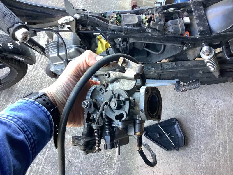

Marm Toastsmith Posted March 16, 2021 Author Posted March 16, 2021 Spent the morning fiddling with the CB while the painted tank dries in the sun. It's odd that although the previous owner had recently had a fairly major engine work (a "valve job") done, and apparently stripped the carb to cure a running issue he seems to have scrimped on basic servicing. I think it deserves a new air filter... Hopefully I can get it running reliably with some basic TLC. Would be nice to commute on it this spring/summer.

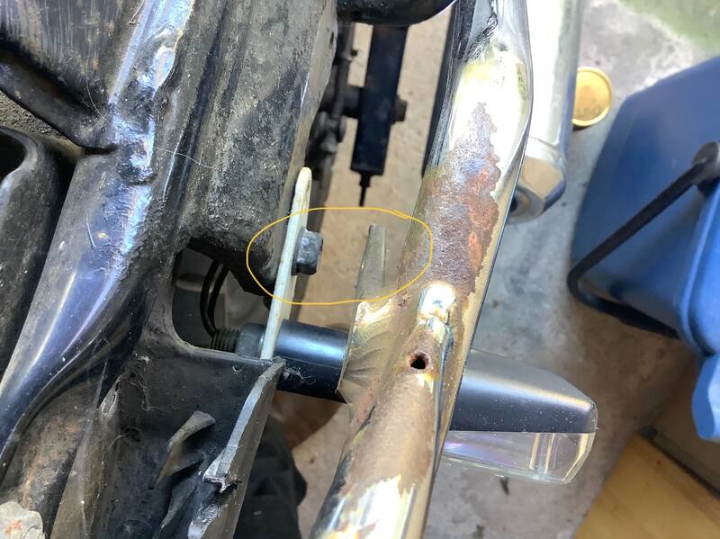

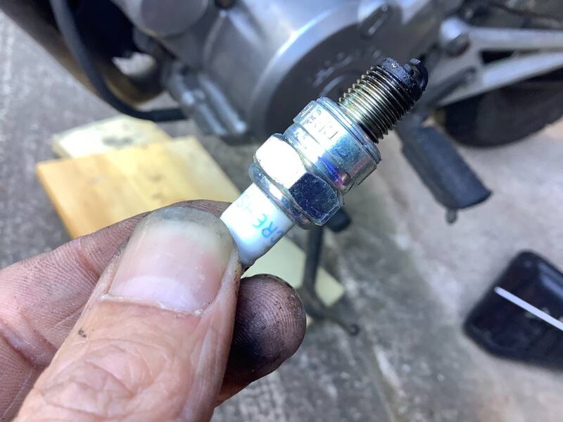

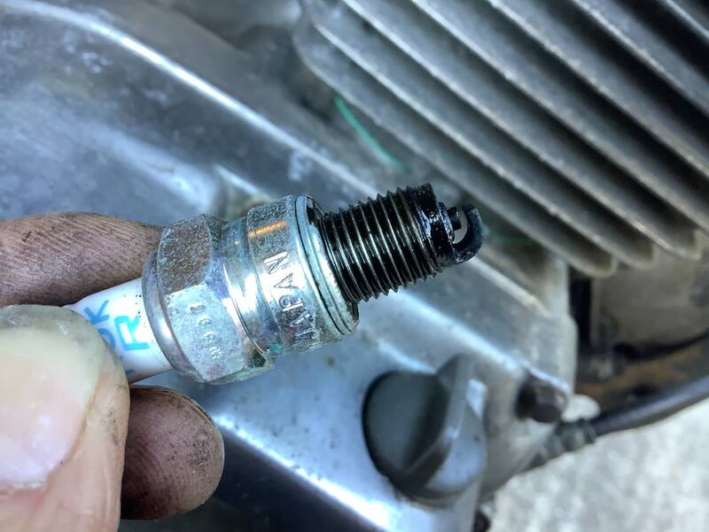

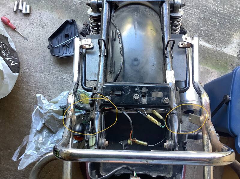

Marm Toastsmith Posted March 16, 2021 Author Posted March 16, 2021 Got a bit distracted... Plugs turned out to be predictably black (it's been running on choke most of the time etc.) but surprisingly new-looking compared to the air filter. Ebay purchase rear rack almost fits but is about an inch too wide each side at the back end. Hmmm... I reckon with some long long bolts and spacers I could probably make it fit. Where to find 'em?
Stanky Posted March 16, 2021 Posted March 16, 2021 Could you make a sleeve from a bit of pipe with washers at either end? Marm Toastsmith 1
Marm Toastsmith Posted March 16, 2021 Author Posted March 16, 2021 "remove all traces of the old gasket". What gasket? "Remove bracket". I won't be the first to have tried.

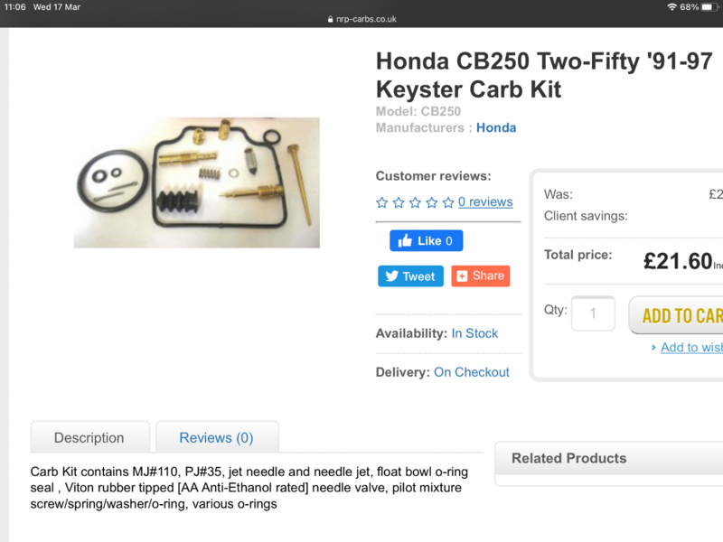

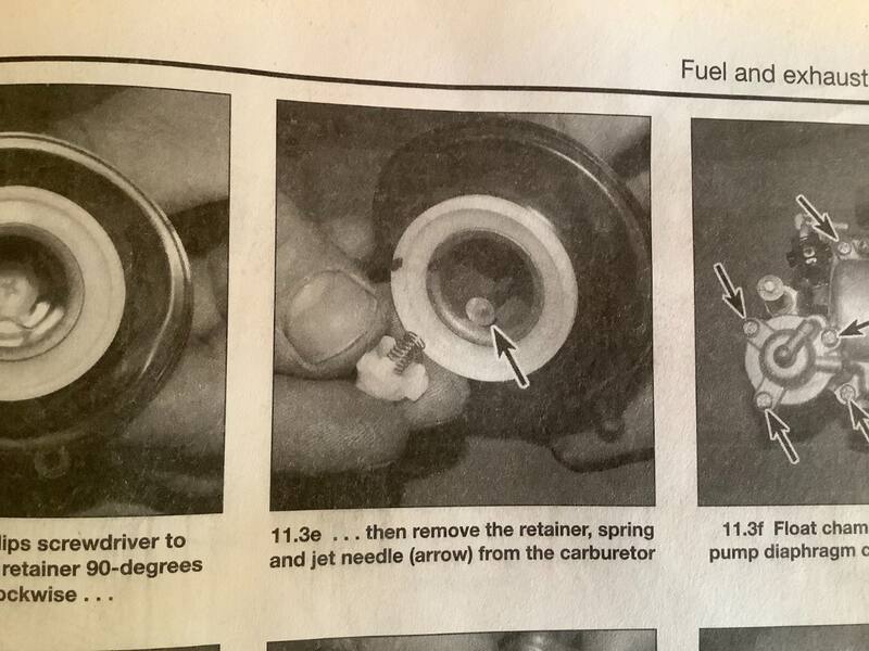

Marm Toastsmith Posted March 17, 2021 Author Posted March 17, 2021 Made a good start at dismantling the carb. There was some crap in the bowl and the accelerator pump shaft is corroded/gummed up at one end so was likely sticking. The float valve (described as needle valve in HBOL) itself seems ok so that's an odd one... I'm taking a break at this stage because I'm partially stuck - would welcome some advice here. As far as I can tell there's no needle jet in the carb. Am I being daft, is the haynes wrong, or is it possible that it's just missing?

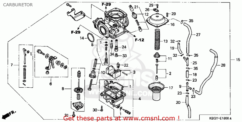

Marm Toastsmith Posted March 17, 2021 Author Posted March 17, 2021 The more I look at it the less convinced I am about the missing needle jet. I don't really see where it would fit anyway as the jet needle was pulled out of the other side (shown in pics below). Diagram shown (key at https://www.fowlersparts.co.uk/parts/4762509/cb250w-1998-e-mph/carburetor) hasn't shed any light on it for me... In any case I've got a repair kit on it's way which apparently includes needle jet and jet needle so I should hopefully be able to work it out. I've done some digging in the garden and had a decent lunch so I think I'll have that cuppa and continue stripping it down this afternoon. mercedade 1

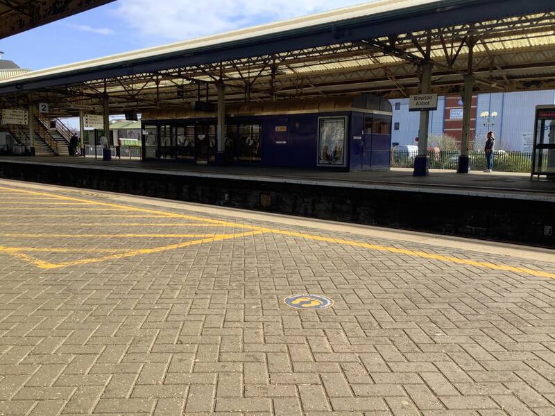

Marm Toastsmith Posted April 10, 2021 Author Posted April 10, 2021 At a station. 2 hours late already following Trainline booking on non-existent train. Oh well... wish me luck. Twiggy and Fabergé Greggs 2
Marm Toastsmith Posted April 10, 2021 Author Posted April 10, 2021 This train goes all the way to Aberdeen. Which potentially opens up some chod buying opportunities. privatewire 1

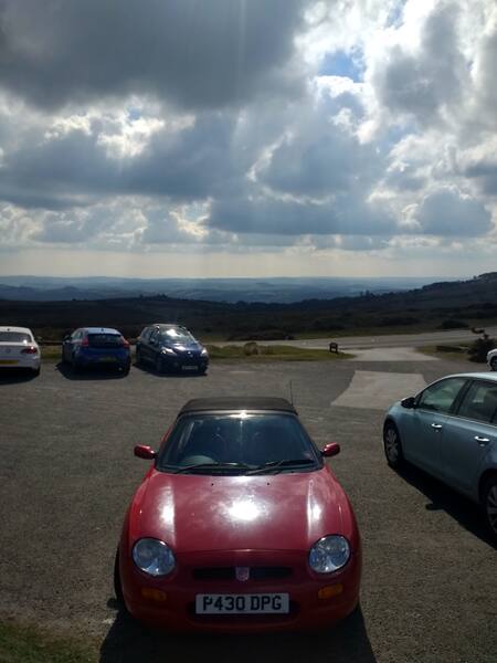

Marm Toastsmith Posted April 11, 2021 Author Posted April 11, 2021 Dartmoor. Needs a polish but Mrs M. has advised against it and I think she's right. It's already shiny and red enough. privatewire 1

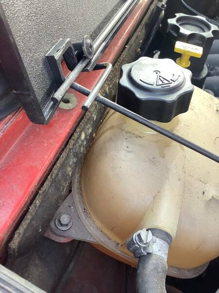

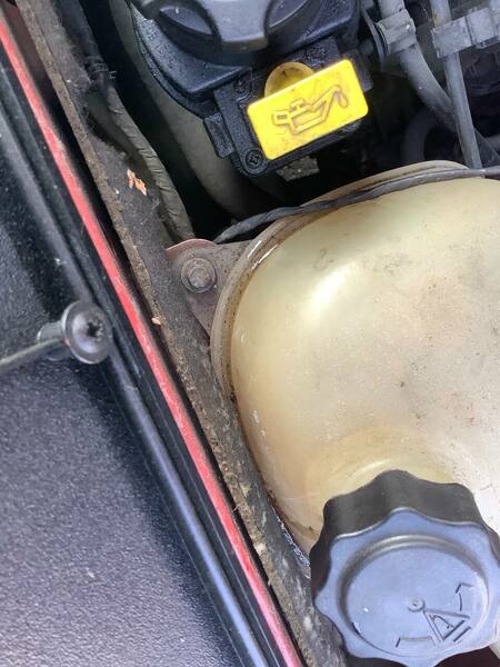

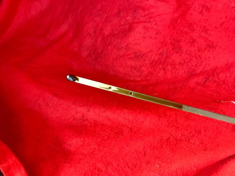

Marm Toastsmith Posted April 18, 2021 Author Posted April 18, 2021 I've been uneventfully, mindlessly, enjoying the MGF during easter break (I work in a school) and today decided to check the fluids as I had planned to drive it to work tomorrow. Got into a panic as there is some mayo on the end of the dipstick and OMGMGFHGF. Not loads but some. Water is clean, oil filler cap also clean and most of the oil on the dipstick looks OK. I have been doing a few short trips in it so I'm hoping it's just a bit of condensation. No issues with the cooling system - all seems fine. Water level is a teensy bit low (maybe 8mm below the mark?) also noticed a bit of water appears to have leaked out of the expansion tank from the cap. It might just have been a bit loose but I've ordered a spare to be safe... will replace and keep an eye on it. Shall I drive it to work tomorrow? Weather forecast says "yes". mercedade 1

tom13 Posted April 19, 2021 Posted April 19, 2021 I was always worried about the headgasket on mine but in the end it was fine. I would be surprised at the age of the car that it didn't already have a multilayer in there. I know what your going through. Their reputation makes you overly cautious. On a side note, I can't remember where the marker is on that dipstick. Is the level supposed to be between the two dots? Is your level really high?
