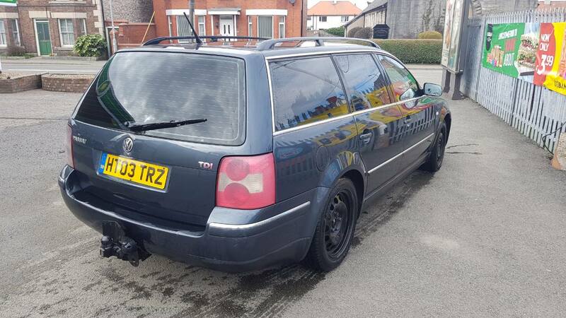

GrumpiusMaximus Posted March 6, 2021 Posted March 6, 2021 47 minutes ago, Tim_E said: I think it's the same thing. Our mk4 Polo had a similar, if a bit more functional wiper that was of a similar design. Pulling the fuse is not just a fix, it's a mod😁 It's a way of life with the stupid motor design. Unfortunately with a flat-backed estate car it's even worse and within ten minutes of cleaning the screen, it's caked with crap again. One day I will replace it and get it sorted but not until I get so terminally bored that eating my own teeth seems like a good idea. Even my unmapped Golf is apparently 310nm which is definitely enough to surprise people at the lights. Especially if it's not raining. You have to be careful not to kick in the traction control though so really launching it takes a little bit of practice. 400nm would be... highly entertaining. To say the least. Cord Fourteener 1
Cord Fourteener Posted March 6, 2021 Author Posted March 6, 2021 43 minutes ago, GrumpiusMaximus said: It's a way of life with the stupid motor design. Unfortunately with a flat-backed estate car it's even worse and within ten minutes of cleaning the screen, it's caked with crap again. One day I will replace it and get it sorted but not until I get so terminally bored that eating my own teeth seems like a good idea. Even my unmapped Golf is apparently 310nm which is definitely enough to surprise people at the lights. Especially if it's not raining. You have to be careful not to kick in the traction control though so really launching it takes a little bit of practice. 400nm would be... highly entertaining. To say the least. It is entertaining, certainly. I've had traction complain at me enough in the two days I've had it. It really wins because you can use gentle throttle and just get more and more power without having to faff around. 'You want more? I got more. ' GrumpiusMaximus 1

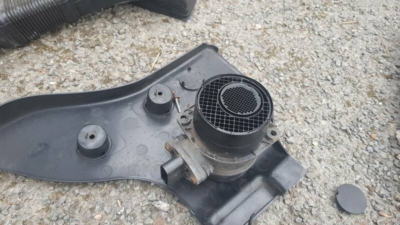

Cord Fourteener Posted March 8, 2021 Author Posted March 8, 2021 Further update: it occasionally suffers hesitation on full throttle. It is due a new fuel filter but reading up on these engines the main culprit appears to be the MAF. I'm told that one way to test for this, without knowing how to prod wires with a multimeter (I have a friend in the village who knows about these things) is to unplug it and see if the problem goes away. If so the MAF, I'm told, is at fault. Begs the question though, if it will run better without one, why do I need one?
bangernomics Posted March 8, 2021 Posted March 8, 2021 It’ll run a default throttle position map which will affect fuel economy and oil lifespan. Arguably if you’re not doing millions of miles probably not enough of an issue to care. How much is a MAF? 40-50 tops? May be worth giving it a clean I use brake cleaner but people like the dedicated stuff as it’s dearer and therefore better. Cord Fourteener 1
Cord Fourteener Posted March 8, 2021 Author Posted March 8, 2021 1 hour ago, bangernomics said: It’ll run a default throttle position map which will affect fuel economy and oil lifespan. Arguably if you’re not doing millions of miles probably not enough of an issue to care. How much is a MAF? 40-50 tops? May be worth giving it a clean I use brake cleaner but people like the dedicated stuff as it’s dearer and therefore better. I have carb cleaner that I bought specially for a MAF a while ago, I'll give it a clean of course. I'll try it unplugged and try to hoon it, see what happens. Thanks

Cord Fourteener Posted March 9, 2021 Author Posted March 9, 2021 Right, success, I got the maf off and squirted it. Well, I finished off my intake cleaner on it and the crap that dripped off of it was black, then started running clean. Letting it dry then I'm off for a hoon.
Cord Fourteener Posted March 9, 2021 Author Posted March 9, 2021 And... ffs. Limp mode with the maf plugged in, disconnect the maf and still in limp mode. @bangernomicsdoes disconnecting the maf normally make it run in limp mode? This is why I don't like diesels.
bangernomics Posted March 9, 2021 Posted March 9, 2021 Do you have a code reader? If so are you allowing it to complete a readiness cycle? Cord Fourteener 1
Lacquer Peel Posted March 9, 2021 Posted March 9, 2021 I have one of those cheapy orange VAG code readers if you want it. Cord Fourteener 1
