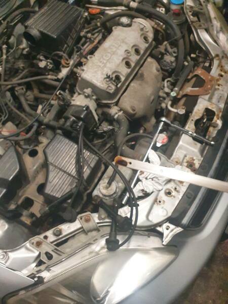

There's no oil - I did check the dipstick when I was down south and it read ok - but considering how tight the oil cap was I don't think it'd been off for a bit.
Strangely the tappets are silent.
Dad's merrily playing about with it - he had an identical one of these for five years and loved it.
He's already done a compression test - I'm floating in and out as I'm WFHing - there's nothing for me to actually do but I can't leave the computer idling as I'll get told off.
180/180/180/180,  but the spark plugs are all clagged up.
Bloody weird is this - need to look into sensors, PCV elbow, etc.
I'm still not convinced that the head gasket hasn't failed from an end cylinder into the water jacket (a compression test wouldn't always show that), but the o2 sensor and the injection system need sorting out first.

As suspected the o2 sensor is bad. More investigation required but we're wondering if the cat is blocked.

Is there oil in the plug towers?
No, don't think so. But there wasn't much oil to speak of.
Not entirely sure what my dad's been up to this morning, but with a new o2 sensor from the parts stash, the car seems to be running a bit better - the white smoke has subsided, and all the fault codes have cleared, but there's still a definite misfire. Takes a while to start sometimes too. Ruled out the plugs by putting a spare set of NGKs in it and taking out some Russian made Bosch ones (not OEM), the leads are ok too, but the dizzy cap and arm aren't original either and the cap was full of loose carbon. The arm seems to be seized on to the distributor which is odd. Wondering if a new cap and arm will help.
The one on my Starlet was rightly stuck when I changed it. Might be worth trying to pry it off with a long screwdriver.

Already tried, it's well on. I think it's the arm for a 1.6 that's been forced to fit - the 'right' part is a different shape.

New dizzy cap and a bodged o2 sensor, and it's back to driving as it should. For a new o2 sensor and a thermostat (stuck open like most D series ones are) it'll be spot on. Drives lovely, couple of small knocks but it does need a droplink.

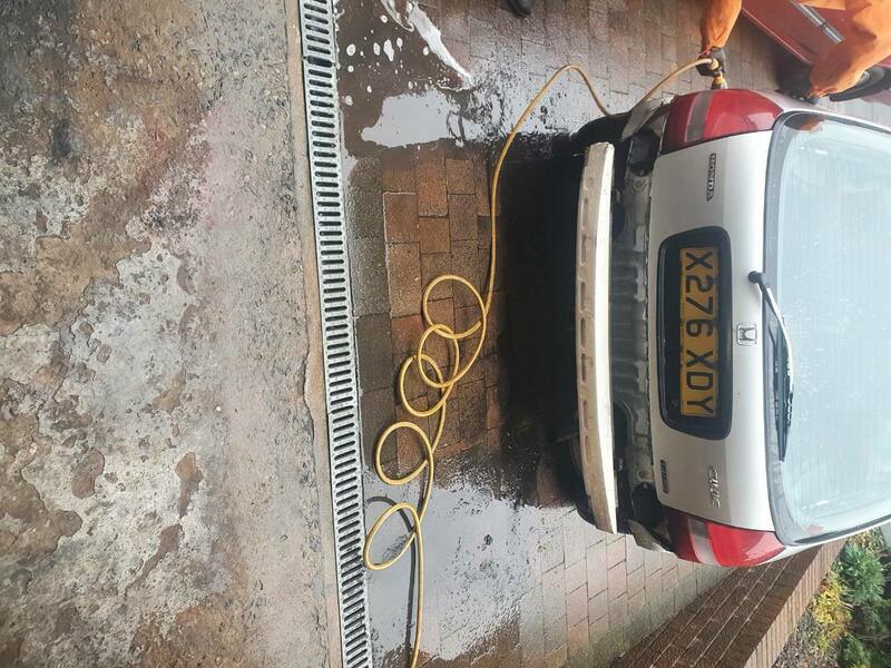

The bumper is cracked, hence the replacement. These are easy to change - a row of trim clips in the boot shut, two underneath, and a bolt on each side in the wheelarch.
It was a bit dirty:
New bumper on.
