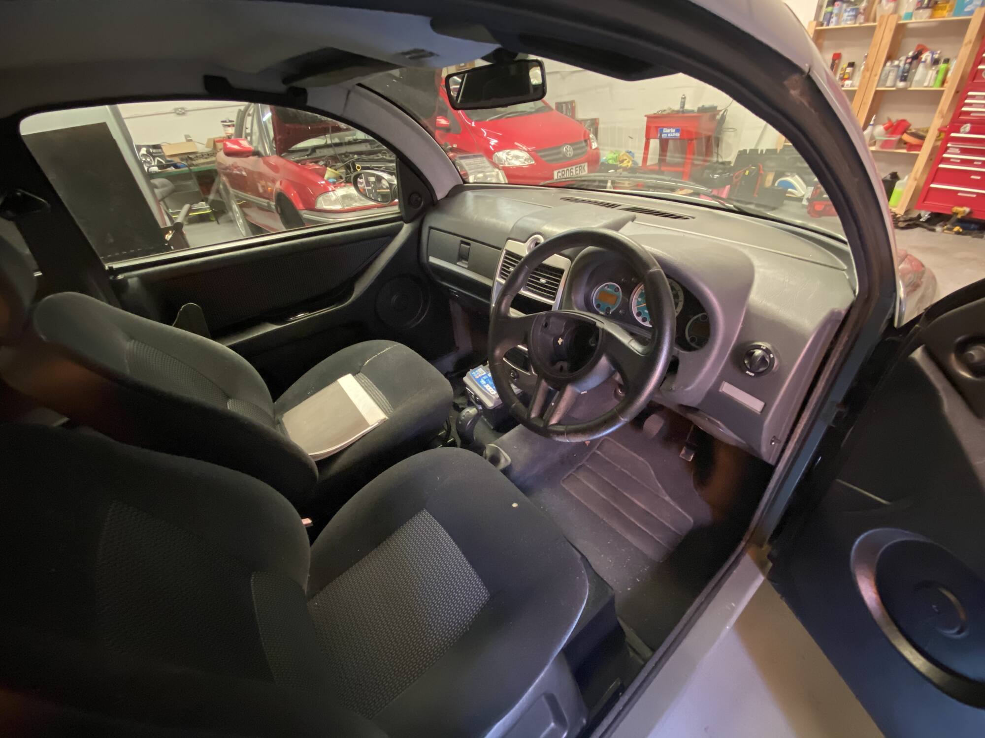

barefoot Posted May 29, 2020 Posted May 29, 2020 I don't want you to think I'm being funny or anything, but that looks really, really shit. Cavcraft, Ohdearme, busmansholiday and 6 others 3 1 5
somewhatfoolish Posted May 29, 2020 Posted May 29, 2020 7 hours ago, Kiltox said: Interior just oozes kwalitee It looks slightly better appointed inside than a Little Tikes Cosy Coupe. Do any of the gauges work or are they just dial-shaped pictures to fill up the dash? anonymous user, bunglebus, Snipes and 4 others 4 3

Kiltox Posted May 30, 2020 Author Posted May 30, 2020 13 hours ago, somewhatfoolish said: It looks slightly better appointed inside than a Little Tikes Cosy Coupe. Do any of the gauges work or are they just dial-shaped pictures to fill up the dash? At the moment, the latter. I have a feeling that may not be the intention though somewhatfoolish 1

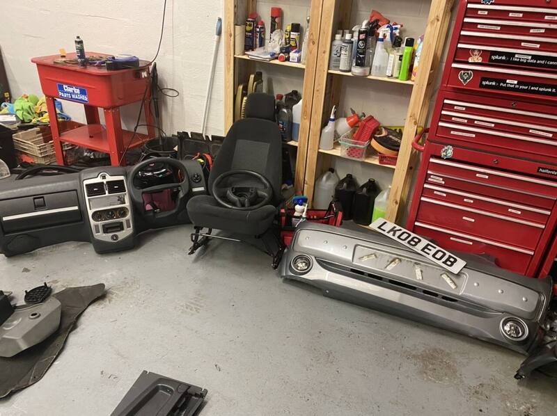

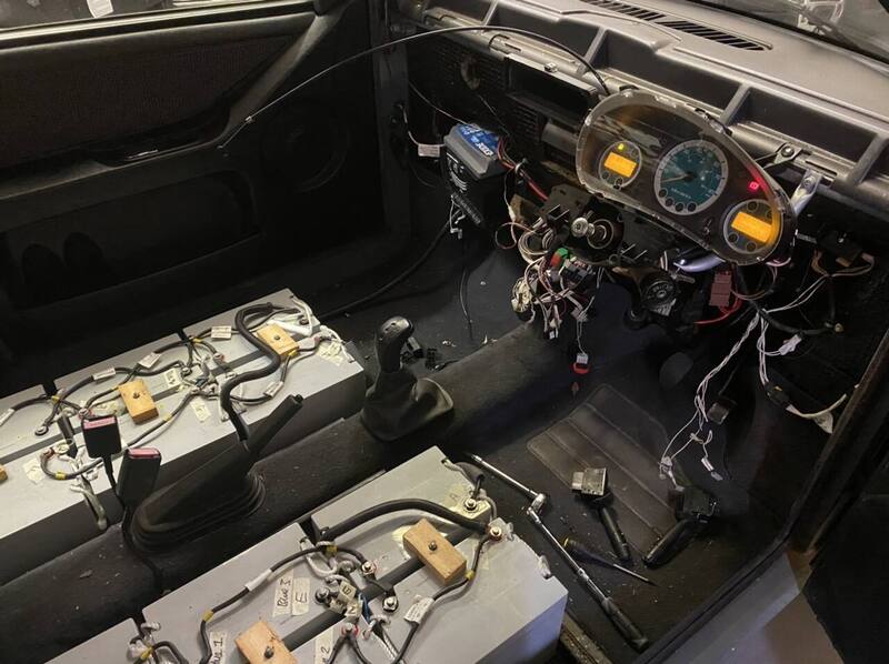

Kiltox Posted June 4, 2020 Author Posted June 4, 2020 Started having a look at this today, short on time/energy at the moment Strip down went well.... Getting the seats out was much easier than expected but I think that’s because they’ve been out recently. Tested all the battery voltages and they seem to be healthy enough - not sure we do have a dead one after all. Restored the charging circuitry to the default (fucked) Aixam charger which revived the clocks. Going to send the charger to @cobblers to see if he can work his magic on it, I think! Surprised to see it had new batteries in 2015 at a cost of £1200! Aston Martin, Mrs6C, theshadow and 10 others 13

hairnet Posted June 4, 2020 Posted June 4, 2020 daft question are the batts nothing special?? even at 50 quid a batt thats a lot of money - 83 seems nuts?
320touring Posted June 4, 2020 Posted June 4, 2020 They'll be deep cycle batteries (like leisure batteries for a caravan). Designed to be drained much lower than normal car batteries. £83 a battery isn't too steep for them
hairnet Posted June 4, 2020 Posted June 4, 2020 11 minutes ago, 320touring said: They'll be deep cycle batteries (like leisure batteries for a caravan). Designed to be drained much lower than normal car batteries. £83 a battery isn't too steep for them ahh ok @Kiltox is it a 13A plug into a wall to charge via the charger? have seen a place that does the 13A to type 2 charger as is common now (omg nearly a leef) but its ££ (not like the batteries tho) could you buy a type 2 charge head and arrange the rest via a rewire?
Tayne Posted June 5, 2020 Posted June 5, 2020 The charger in the car converts AC to DC and splits it’s output to all the batteries. I didn’t see any BMS (battery management system) kit on the cells so I’d like to think there’s some BMS functionality in the charger. However the car is a bit shit so who knows.
Kiltox Posted June 5, 2020 Author Posted June 5, 2020 3 hours ago, hairnet said: ahh ok @Kiltox is it a 13A plug into a wall to charge via the charger? have seen a place that does the 13A to type 2 charger as is common now (omg nearly a leef) but its ££ (not like the batteries tho) could you buy a type 2 charge head and arrange the rest via a rewire? It is, but the 230v goes straight to the charger unit via a mains cable that runs from the back of the car to the front - there’s no electronics in the charging connector or the cable from car to wall. Any battery balancing etc is therefore done by the charger under the bonnet which is what is suspect, so without fixing it or replacing it, you’re back at square one.

SiC Posted August 17, 2020 Posted August 17, 2020 On 6/5/2020 at 1:28 AM, Tayne said: I didn’t see any BMS (battery management system) kit on the cells so I’d like to think there’s some BMS functionality in the charger. Unless the charger had taps to each battery then it's unlikely. Given these are lead acids, balancing will be done by float charging. Basically over charging the charged cells until the under charged cells fully charge. If the charge current level isn't excessive, the gasses will recombine and not vent.
SiC Posted August 17, 2020 Posted August 17, 2020 Looks like the pack is wired for 48v as 3 batteries in parallel and 4 lots of them in series. So probably a series wound motor, pretty much out of a forklift?
