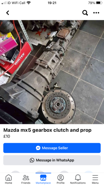

seems unusually cheap, i’ll message and see if it’s genuine. i already have a gearbox but you know me and spare parts :)

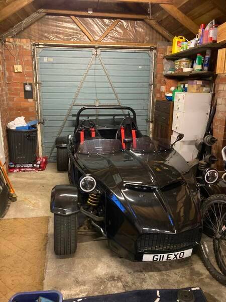

the Exo has been hibernating since the end of november so i thought it might be a good idea to check on the state of the battery
still showing 11.8v after 8 weeks tucked away in the garage round at me mams house - i’d better hook it up to the trickle charger :(
but, just in case, maybe i should see if it will start ?
damn thing fired up first turn of the key ! bloody impressive that :)
shame it’s not going anywhere for a while yet :(
i stuck it on charge anyway, won’t do any harm

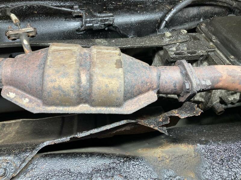

first off ditch that rattly old heat shield
then there’s this to attend to

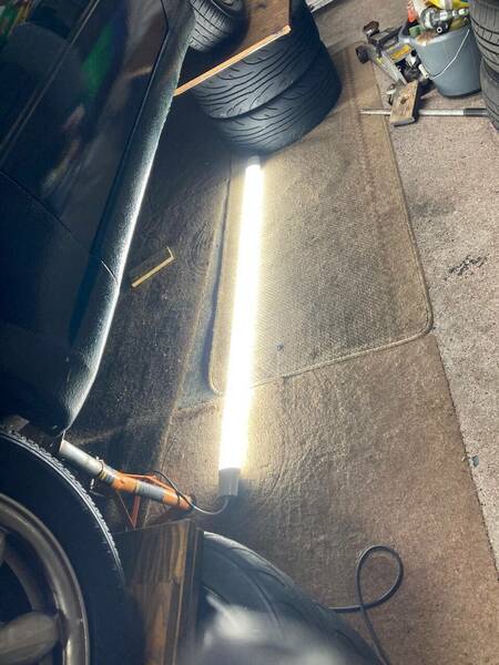

new work light proving very effective

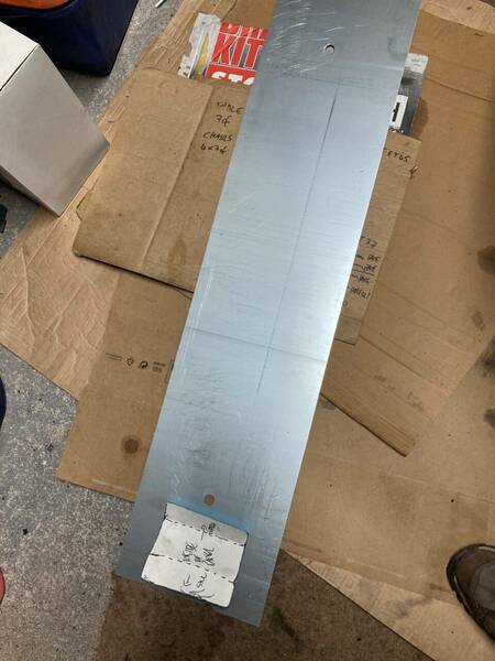

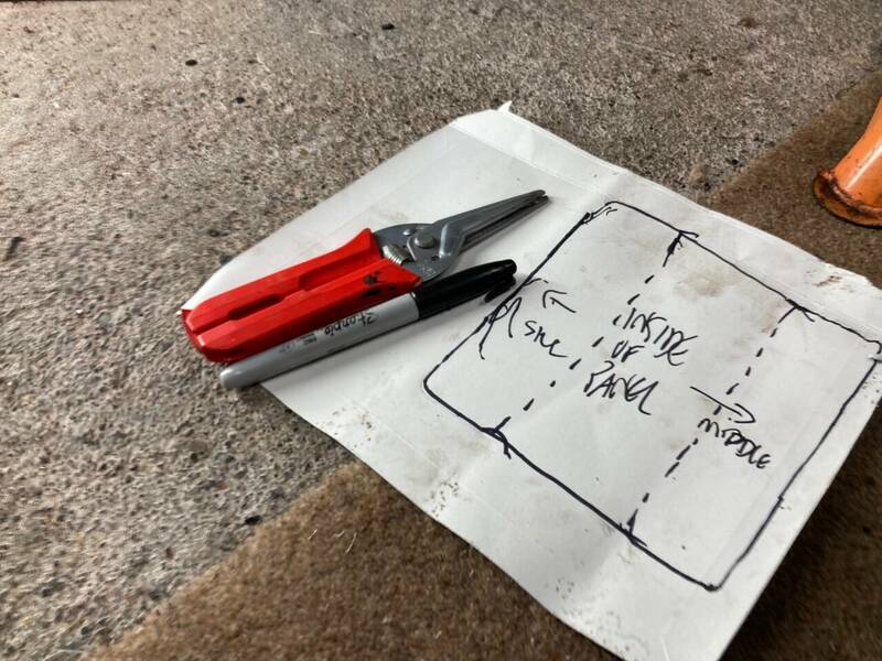

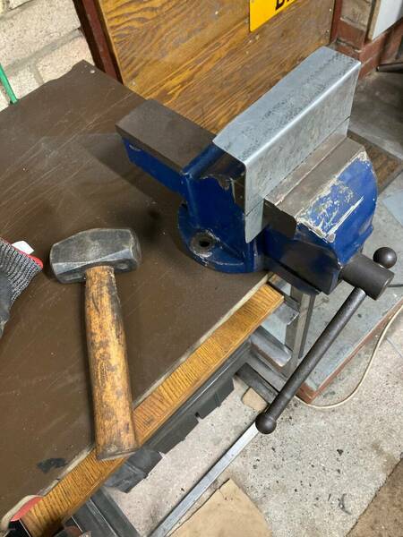

weetabix template made

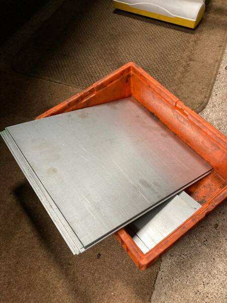

find a suitable sheet of tin and get cutting

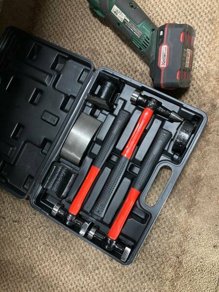

time to test out my christmas present body hammers
ha ! not a chance ! break out the big guns
bish bash bosh

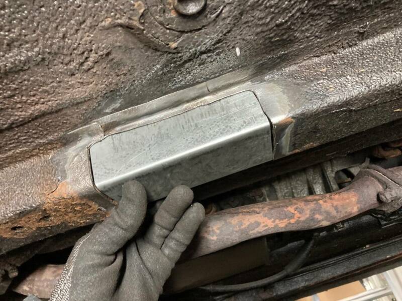

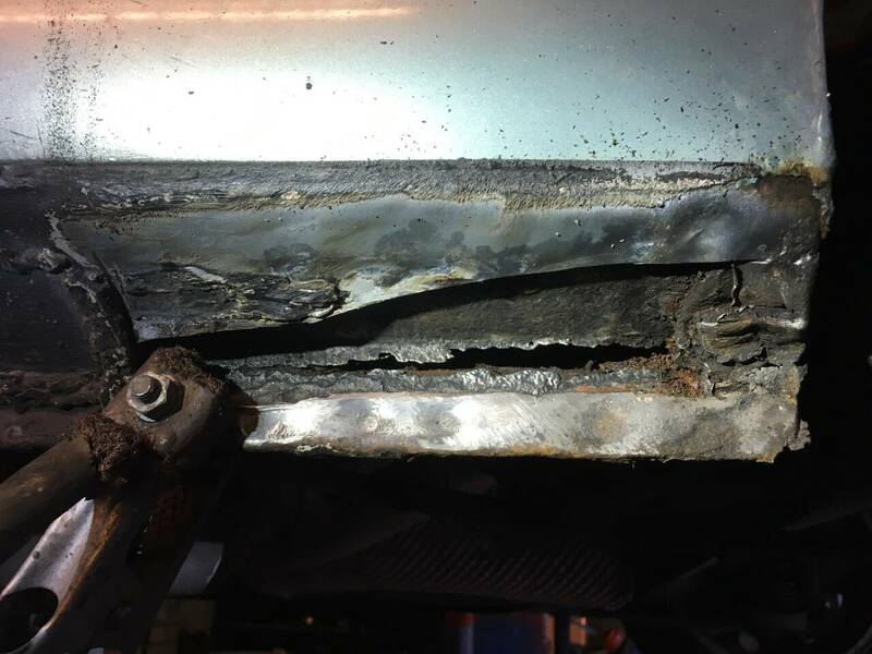

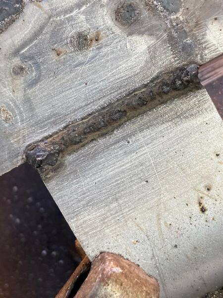

now the easy* bit

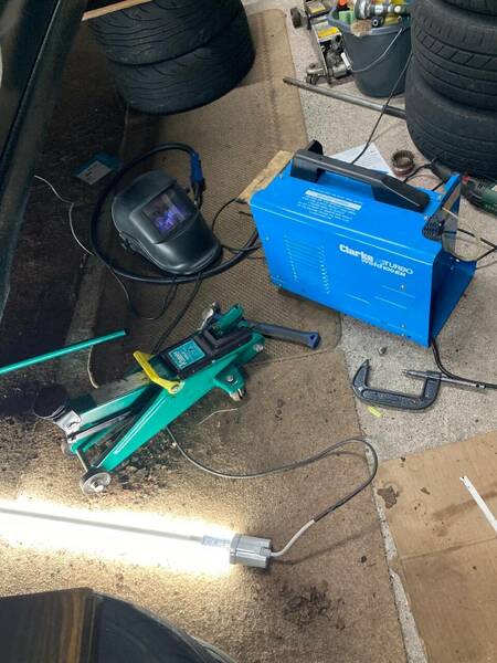

oh fuck, that’s terrible !
turns out i can’t weld for shit :(
…to be continued…
you know how get to carnegie hall, don't ya ?
practice !

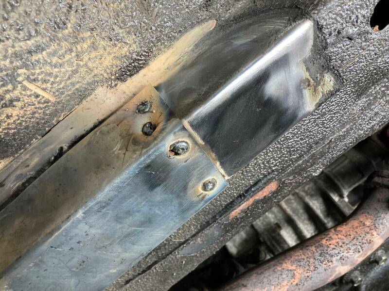

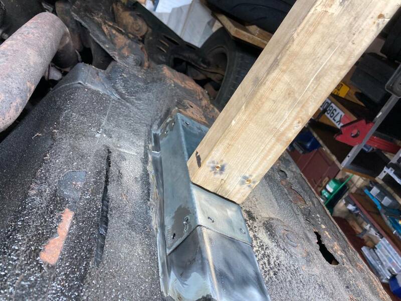

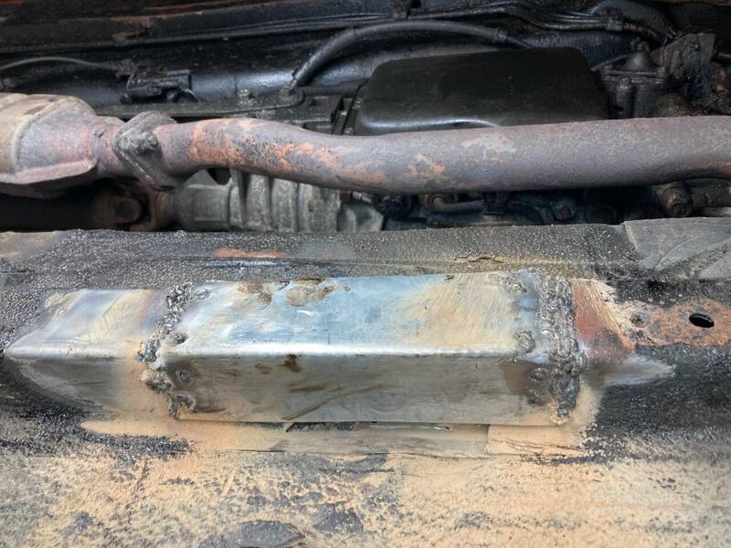

maybe if i use finer wire ?
yes, that’s more like it
chop, bend, etc
spot welds to hold in place
and slightly less shit pidgin shit round the edges
i’ll grind that back in a bit, but first there’s something else i need to look at…

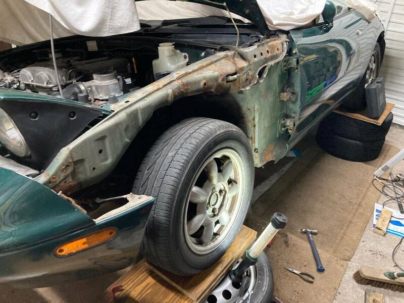

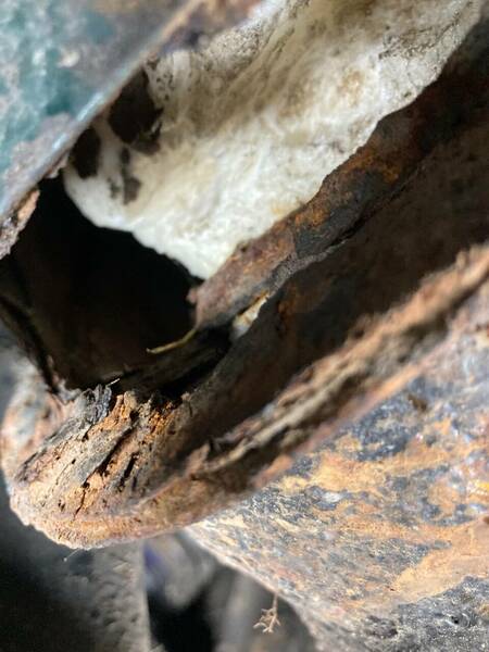

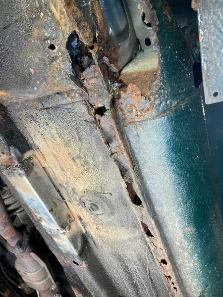

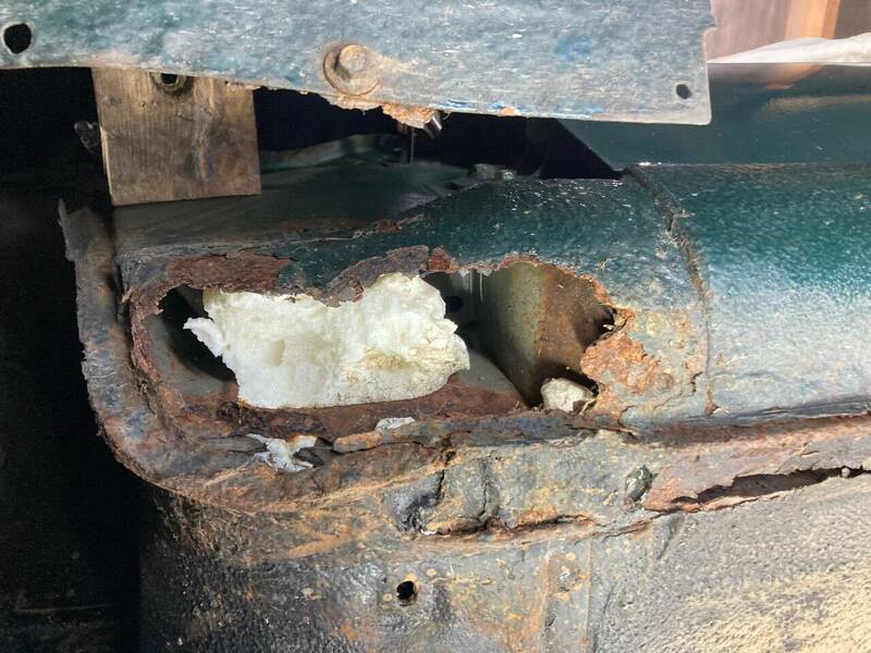

the front wing, whilst being in good condition, didn’t seem to be very secure.
perhaps that is because there’s not much there to secure it to :(

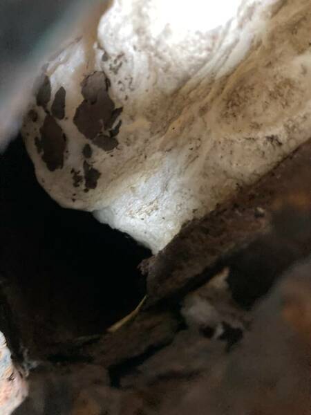

oh you dirty bastard
this is not what i signed up for.
(remember this is the car with a £2grand bill for sill restoration in november 2021)
i went inside and opened a beer :(

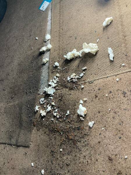

Expanding foam is obviously expensive!
I unbolt the bottom of the wing and clean / treat that area every service on ours, it's a terrible rust trap with all the leaves etc from scuttle being washed down there.
Looks terrible but it's only welding, doesen't need to be pretty down there , take it one bit at a time and you'l get there.
We've also done the same with the trim (and the better quality black mk2 carpets too), couldn't live with all the orange!

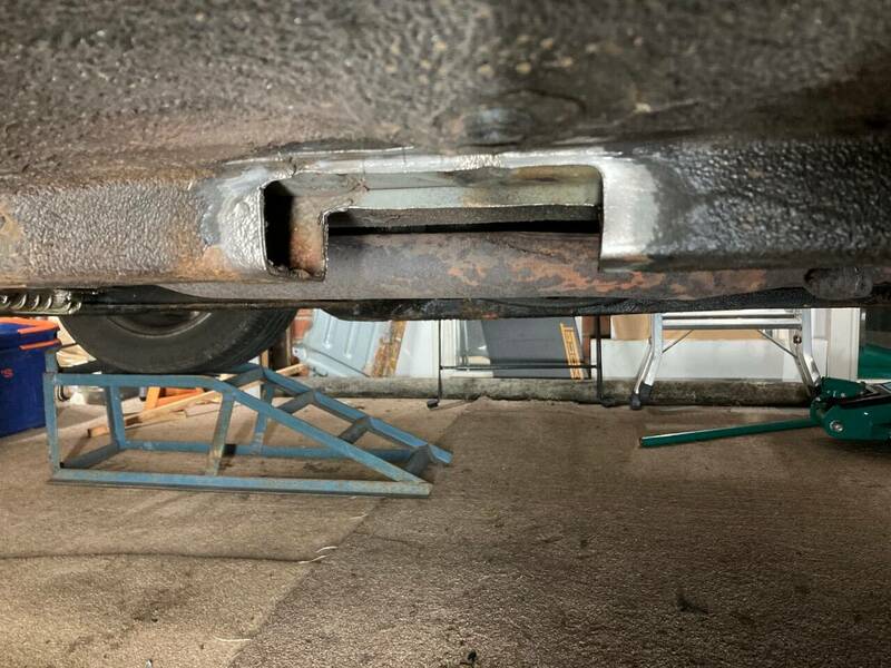

only one problem
i’ll have a good poke around the rest of the car before committing myself, unfortunately i’m into this for a good few quid so need it mot’d and on the road to have a chance of breaking even :(
it takes practice, unfortunately it looks like you've got plenty to practice on.
Seriously though get a few bits of metal and practice on a bench, you'll soon find out which settings work for you.  Welding upside down is probably the most difficult one to do try to master downwards first.
For thin metal its best to use a series of overlapping spots letting it cool for a second or so between each spot.
Also don't be scared to cut a lot out, cutting back to solid metal makes a quicker and easier repair.
If the outer sill is new and made of steel not foam it may be easier to work from the inside, cutting  away the inner sill and floor edge and working from the outer sill inwards.
Try welding fresh metal to the edges of the bit you have cut from the car, then you know if you need to cut further or not.

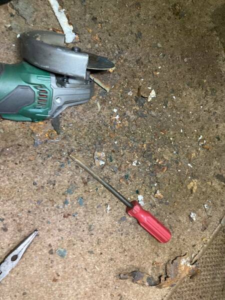

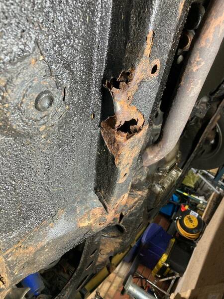

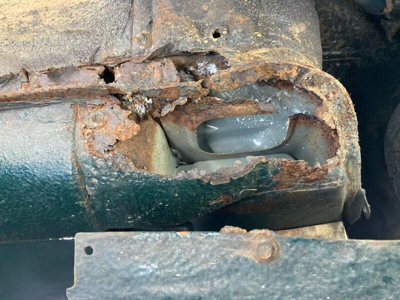

so i swept up the remains of my sill

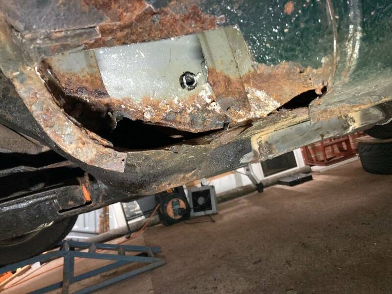

removed the outer wing for better access

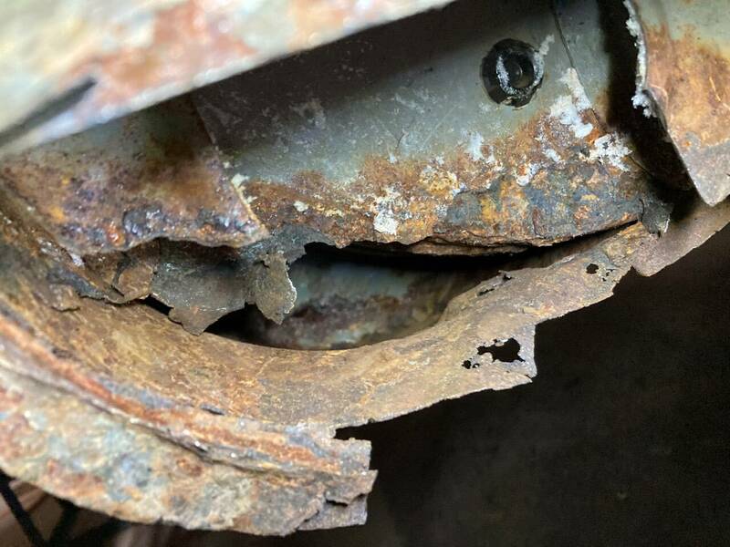

and had another poke around
not great :(
potentially fixable but not straight forward by any means.
i’ll have a go at the other side, if that is ok, i’ll make an effort at this one, if not, well, best not to think about that just yet.

If it makes you feel any better the sills in my 307 where made of fibre glass and blue towel.
This handily stopped water draining so the inner sills rotted out as well.
I was able to patch them back up and it provided faithful service for the next four years. Take your time and cut right back to good metal. Then just think of it as a big jigsaw puzzle where you have to make the pieces as you go along.
not great :(
the mot expires at the end of feb, the black one is due at the end of march - and that needs welding too.
bloody mazdas :(
Cool little fuckers though. Weldings no where near as hard as fabrication and you seem to have that down. Bon chance man.
Looks like you have the same welder as me. I'm having success with 0.6mm wire on setting 1 max with wire feed around 5.5 for thin stuff and 2 max with around 6.5 for thicker stuff. Using CO2. Need a reasonable gap between the two pieces (say thickness of metal) and I can't generate enough heat for a decent run so I join the dots using the heat of the previous weld. Method no good for visible bodywork though!
Sorry if Granny and eggs but hope it helps 👍🏻
 i’m pretty much playing it by ear with the welder settings so will give it a go - it’s frustrating getting it just right on nice clean metal on the bench then it going hopelessly wrong when doing it for real :(
i’ve got a few days off work and the forecast is shite for this week so i’ll get stuck in and report back
