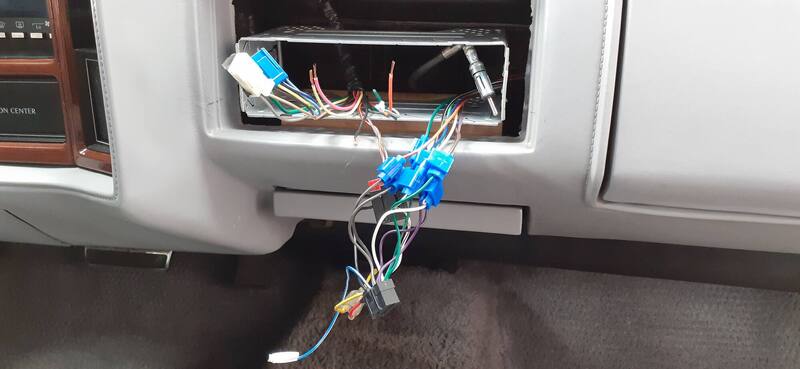

But today at least I swapped the radio for my much nicer aftermarket Sony DAB one and cleaned up the wiring behind the dash. I had a spare standard ISO harness so I soldered that in so in future any modern radio should fit. I can't go back to the original radio unfortunately as the wiring had been chopped so much.
Here's a before picture.
The plastic connectors on the left are from the original radio and are unused. They're for things like dimming the screen when the headlights are on. Also for the two tiny speakers in the dashboard, which are sadly unused but I may rewire them in at a later date to ride off the door speakers.
Previous owner had tied the yellow and pink wires together, yellow is ignition power and pink is the powered aerial. No wonder it was always coming up regardless of radio condition. Pet peev of mine. The orange wire roughly in the middle of the pic is constant power which I had to uncover, he had not used it. Explains the memory loss on the radio. It only had power when the ignition was on.

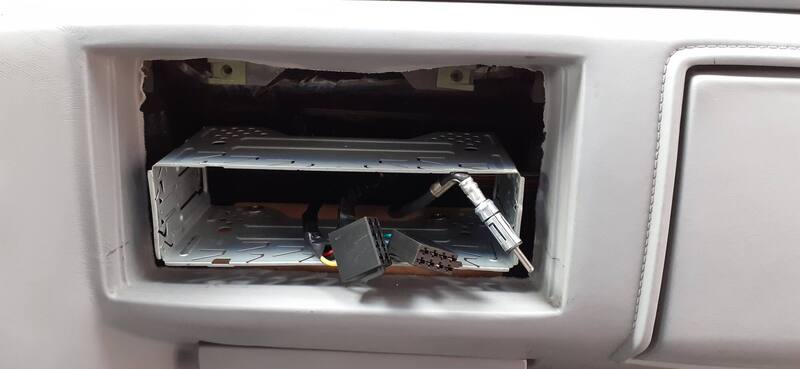

Here's an after picture with the new soldered ISO harness.
Much cleaner. The Sony connector simply attaches to this then to the radio.
I soldered the constant power and ignition power to the correct wires on the ISO harness so the radio retains a memory but powers on and off with the ignition as it should do. The powered aerial wire was also soldered to its own connector so the radio controls when that comes up and down. Radio off, it goes back down. Good.
I enjoy doing stuff like this. It takes a while to tag all the wires to find out what they are and where they go, but the end result is immensely satisfying.
The speakers are still shit but swapping them over is a job for tomorrow.
I decided not to install the under-seat subwoofer I removed from the Supra, one because it was too wide to fit under there but also because the boot is enormous so I want a boot sub instead.
EDIT: I forgot to mention, don't be horrified at the enormous hole the radio sits in. There's quite a nice surround that clips in around it to give it a factory fitted look. I just didn't take a picture of the radio installed.
