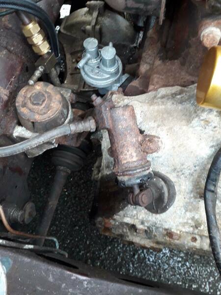

phil_lihp Posted November 21, 2020 Author Posted November 21, 2020 The new seal and ring combined with a splodge of hylomar seems to have done the trick, no more drips. This is good, as it means her royal brownness is back on the road. I celebrated by putting £20 of Asda's finest in it and then driving about running a few errands and apart from the alternator belt being a bit noisy, it behaved perfectly. It's running superbly now that the fuel isn't 50% sand. However, it is a Princess so to redress the balance, the clutch master (slave?) cylinder started leaking. Looking at it, I cant understand why. It looks immaculate and totally hasn't got mouse damage on the gaitor or any obvious corrosion. I'm hoping an MGB one will fit. Certainly looks similar but I'll try and find some part numbers first. https://www.ebay.co.uk/itm/MGB-1800-CLUTCH-SLAVE-CYLINDER-PUSH-ROD-CLEVICE-HOSE-KIT-AND-FIXING-BOLTS-a3a/311974887269 timolloyd, danthecapriman, LightBulbFun and 4 others 6 1
phil_lihp Posted November 21, 2020 Author Posted November 21, 2020 Even better, turns out you can still get seal kits for them. Problem solved. HMC and Shite Ron 2
Rusty_Rocket Posted November 21, 2020 Posted November 21, 2020 I'd get a cylinder if you possibly can. There's a very likely chance that original one is past re-sealing! phil_lihp 1
2flags Posted November 21, 2020 Posted November 21, 2020 This again could be used by multiple vehicles. Check the part number. If it's a standard unit it could be the same as the Mini or even the Landrover. They tended to use the same parts when they could. phil_lihp 1
phil_lihp Posted November 21, 2020 Author Posted November 21, 2020 I found via the owner's group that it is unique but I've found a chap who sells both cylinders and seal kits. I'm going to try a seal kit first, general consensus is they usually come around OK. It's only £11 so worth a shot and I'd quite like to have a go at rebuilding it. colino 1
High Jetter Posted November 21, 2020 Posted November 21, 2020 I would, not as critical as a brake cyl. Also satisfaction from rebuilding it, hopefully. phil_lihp and Joey spud 2
captain_70s Posted November 22, 2020 Posted November 22, 2020 If the new cylinders are anything like the ones available for Dolomites I'd definitely go down the rebuild route if it's possible - The repo ones have a fairly dire reputation for longevity... Joey spud and phil_lihp 2
