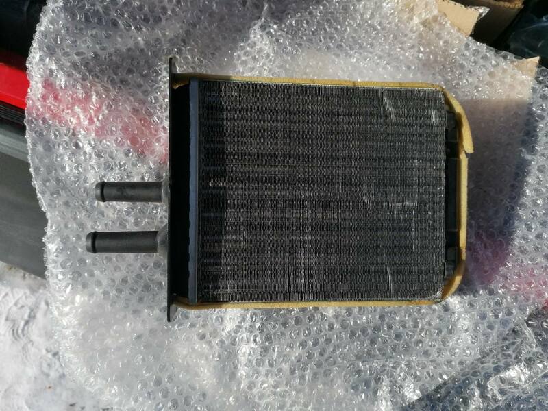

Is this a heater matrix and should I be worried that a previous owner thought to leave one in the car?
Still can't get the heater to blow warm. 😔
That's not the best situation for the current weather...
I fitted a heater matrix in one of those, never again, i have tried to block it out of my memory, but i remember taking the dashboard out and possibly the heater assembly, in summary good luck !
You need to feel the two hoses going through the bulkhead and check they are both hot, most* heater matrix's have the coolant flow going opposite way to radiator, so low point in and higher hose out for thermal efficiency. So lower hose will be hotter than upper hose.
Big difference in temps usually indicates blockage/flow restriction.
Back flushing can sometimes help but I am sure I was told years ago that radiators and heater matrix both naturally act similar to filters in the coolant system and catch all the crap and sediment, lowering their flow and efficiency.
Sometimes parking the car uphill or jacking the front of car up high can help with burping the air out of the coolant system as well.
Check the hoses to make sure the matrix hasn't been bypassed on the engine side of the bulkhead.
I did that on a MK3 golf when the heater matrix started leaking, donkeys years ago.
The part is well cheap but as @camryv6 says, it's a massive job to get at in most cars. It's one of the first things they fit to the shell on the production line iirc.
