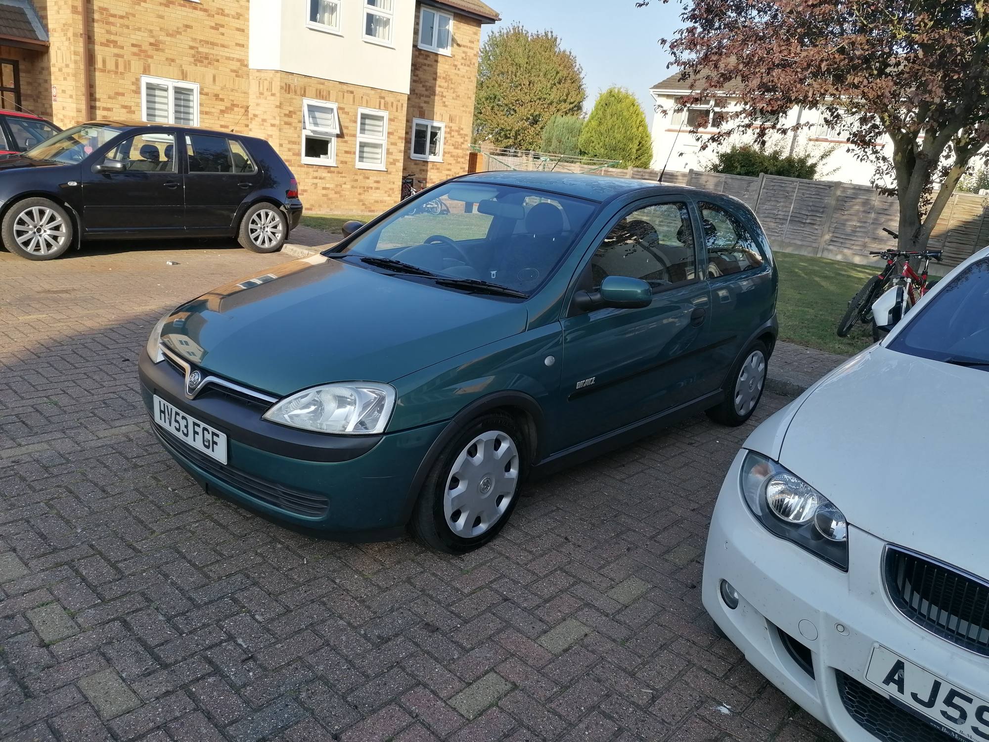

Went round with the bumper gel and did a cursory tidy of the wheel trim edges (poundland silver, what else?).  Doesn't really show.
I can safely say I don't have any affinity to this car, I'll use it for a while as efficient transportation then probably sell it on for the same price I bought it for.

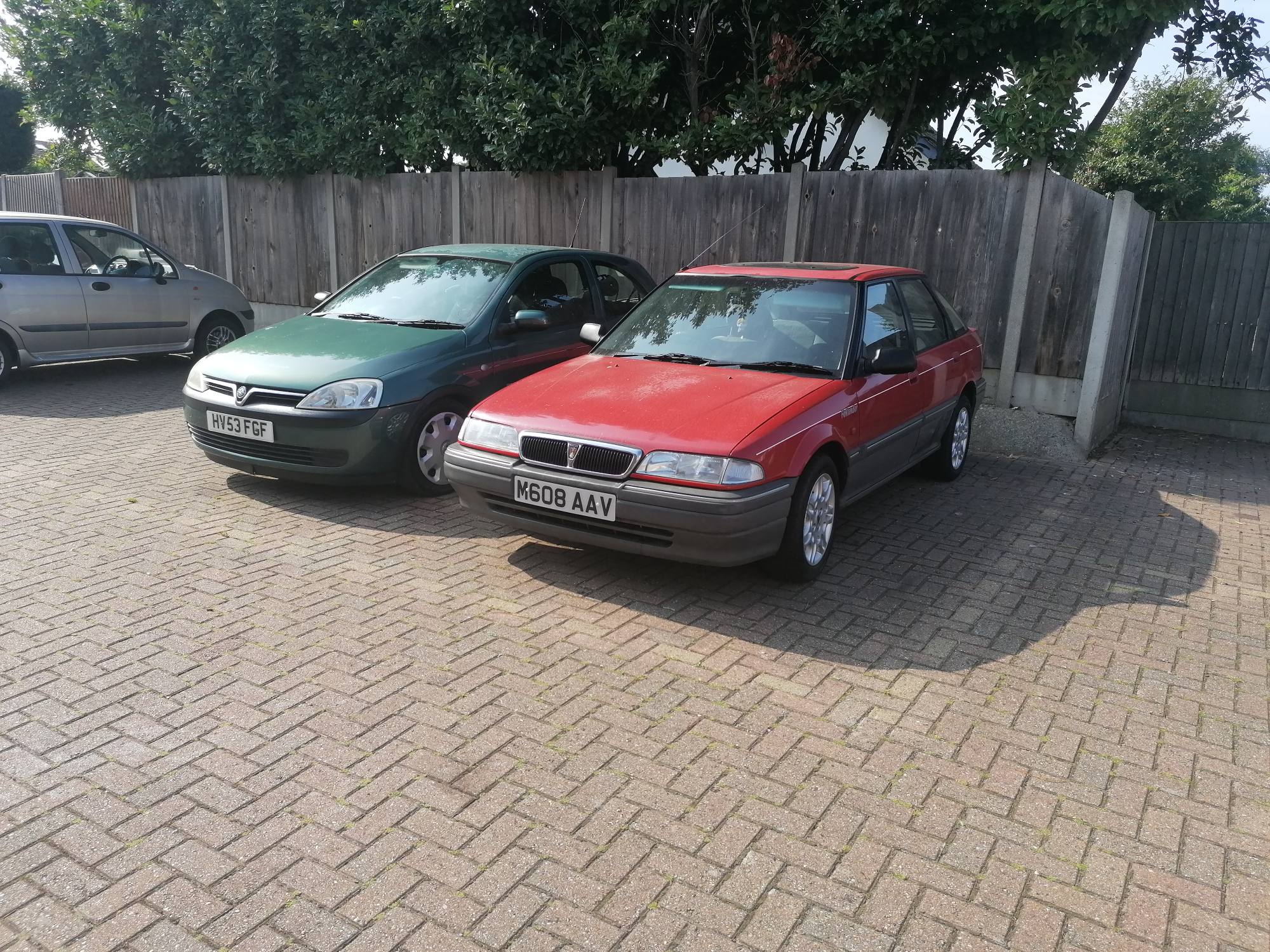

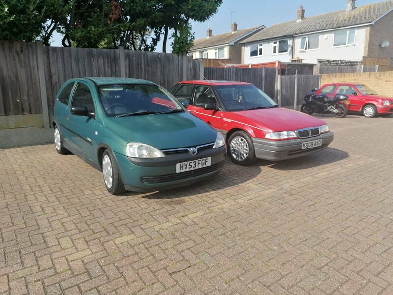

Some pictures, just because.
