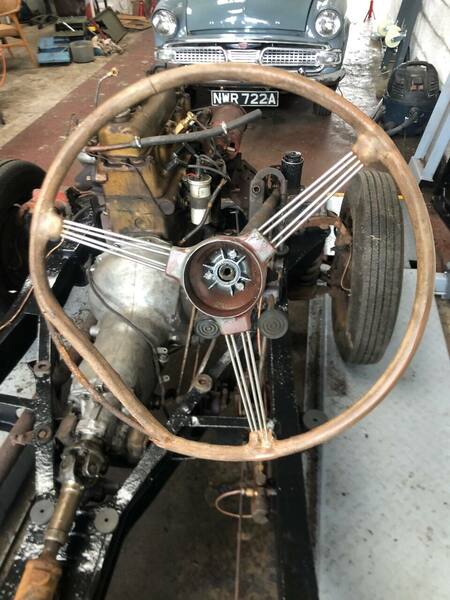

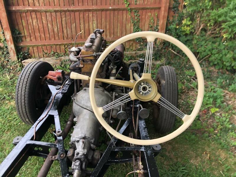

Both the steering wheel and gearknob had fallen apart with the UV light as they always do. I decided to send them off for a very expensive refurb at a place in Kent (Myrtle Ltd) that was recommended to me by a friend.

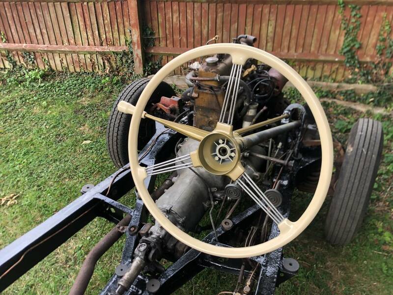

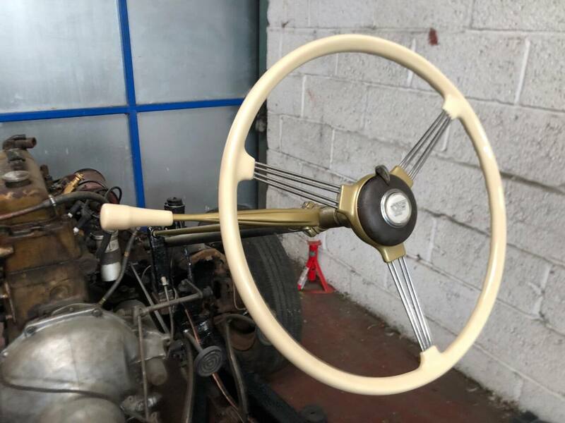

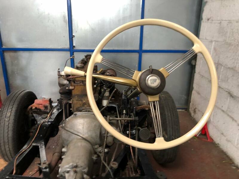

I’ve gone for a slight custom job here, they have refurbed the steering wheel in cream to match the gear knob and switches, and I’ve painted the centre and the gear lever metallic gold to match the instruments.
To be fair they did a lovely job and quick too (inside a week) and I’m over the moon with the results!
Originally all this was a dull dark brown which didn’t do the car any favours IMO (the Atlantic, which has the same dash, has a cream steering wheel).
The trafficator switch needs a bit more work, under the brown paint it’s brown Bakelite which I’m going to try cutting and polishing. But you get the idea.

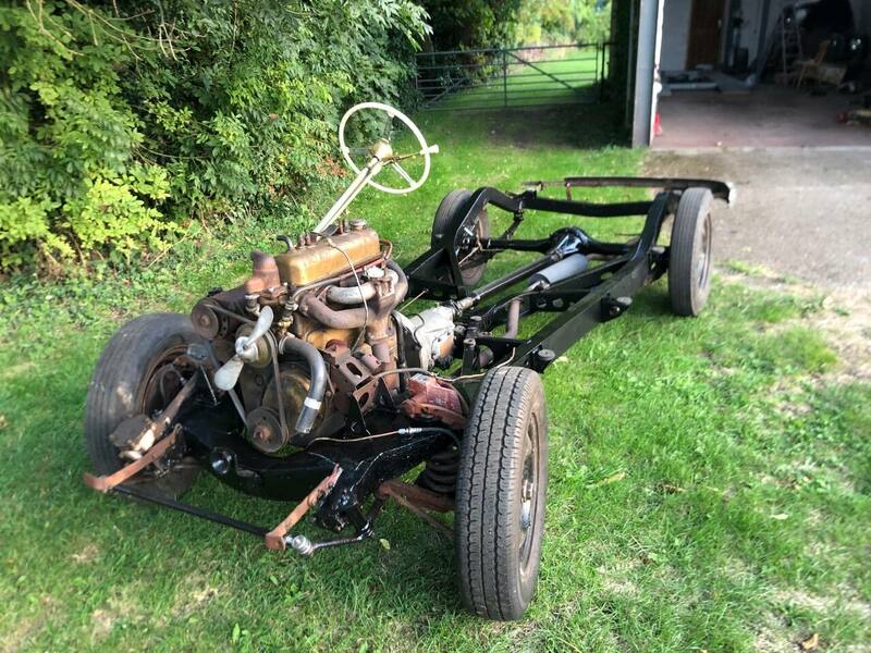

Due to space constraints I want to get the body fitted as soon as possible and connect everything back up again. So it’s not that far off being roadworthy. I’ve done a lot of this work the wrong way around so mechanically it’s all ready to go, all the brakes and cooling system are done etc, balljoints and suspension checked, greased and replaced where necessary, just need to get the rear shocks rebuilt and buy a replacement antiroll bar as this one is badly bent/twisted. Must have done some serious rolling at some point!
Still in two minds over the paint, on one hand I just want to get it back on the road and enjoy it without months of rubbing down, but there is a lot of surface rust coming through.
I’ve just fitted a new seal to the replacement steering box so that’s all ready to fit once the body is on.
