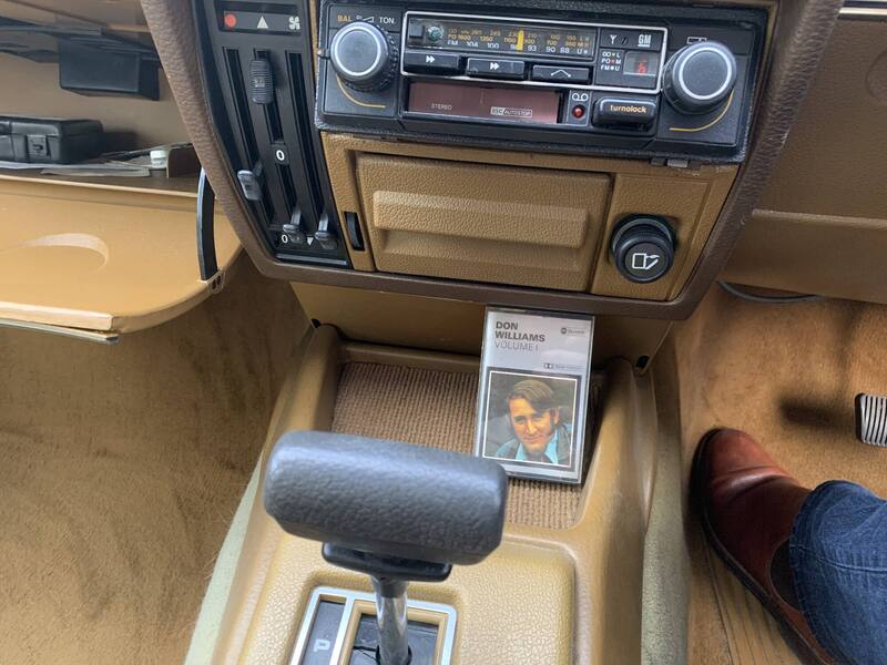

Looks fantastic, it even has a period radio which looks the same as the one in my Granada. Great colour combination too, Gold with beige velour is fantastic.
Yes, it’s the original GM-branded Philips stereo radio/cassette — with bonus glovebox tape treasure:
Fantastic, it is Philips turnolock, Ford also used them, it was £196.42 for the upgrade on the Granada, a lot of money in 1978!

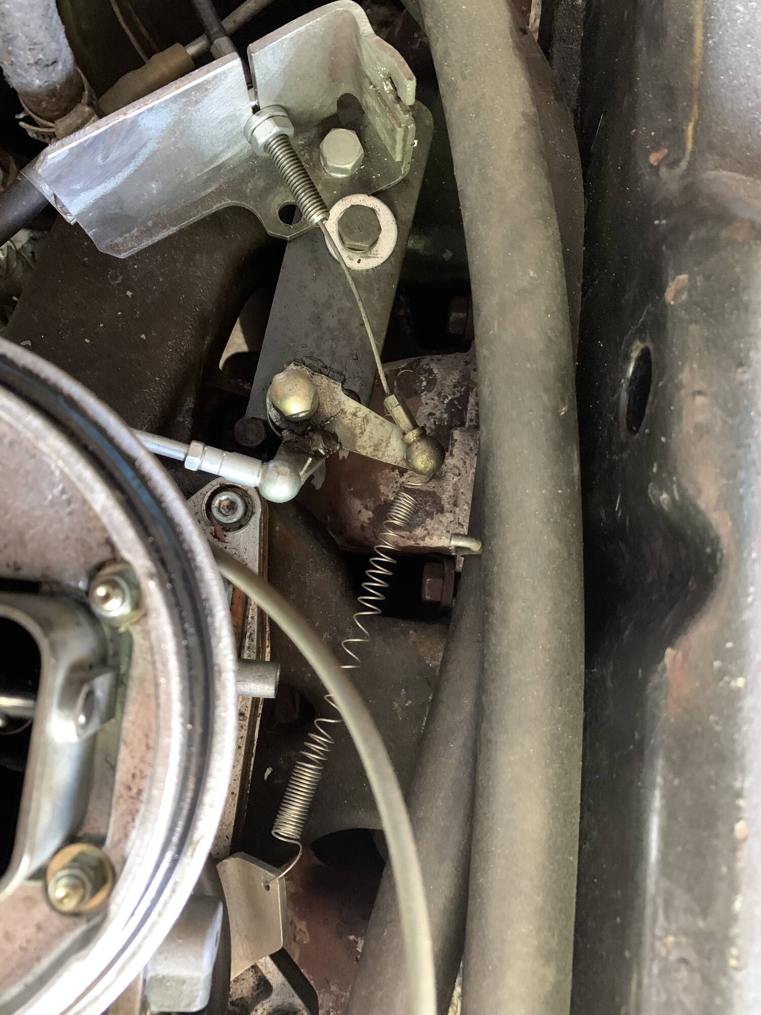

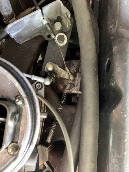

The sticky pedal will likely be one of the many linkages 'twixt pedal and throttle body needing a bit of lube or adjustment. The auto chokes on these carbs are horrible, they either stick on, come off too soon or don't work at all. They're operated by a bimetallic spring heated by coolant so make sure the little hose isn't blocked.
They can also be prone to the fuel draining out the carb if it's not used for a while leading to non starting. I would either chuck a jam jar of fuel down its throat or just sit and pump the throttle a dozen times and it would fire into life then.

My black one had the exact same radio,
When we bought ours we found a  Frankie Valli and the four seasons cassette case in the glovebox.
They are nearly the same price now-if you can find one secondhand!

The sticky throttle pedal is annoying. I will look at that tomorrow too.

A thought on the throttle pedal. Have a look behind the plastic hinged pedal itself as it's not the usual type of organ pedal throttle, the flat plastic bit pushes down on a metal arm suspended from above like a conventional pedal.
Sometimes they get crud all down the back of them and a clean and some vaseline can work wonders.

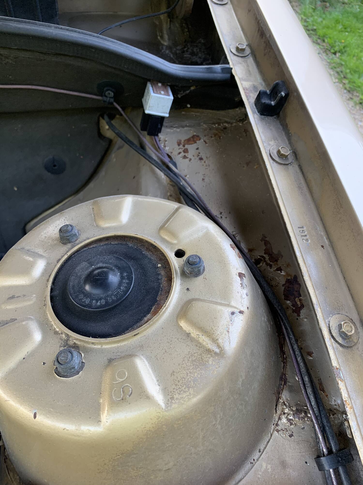

They’re not bad, but there’s a bit of bubbling starting. They seem solid. It wants attention sooner rather than later so they don’t get any worse.
Rear suspension and underneath look ok, although I haven’t has the rear seat up yet.

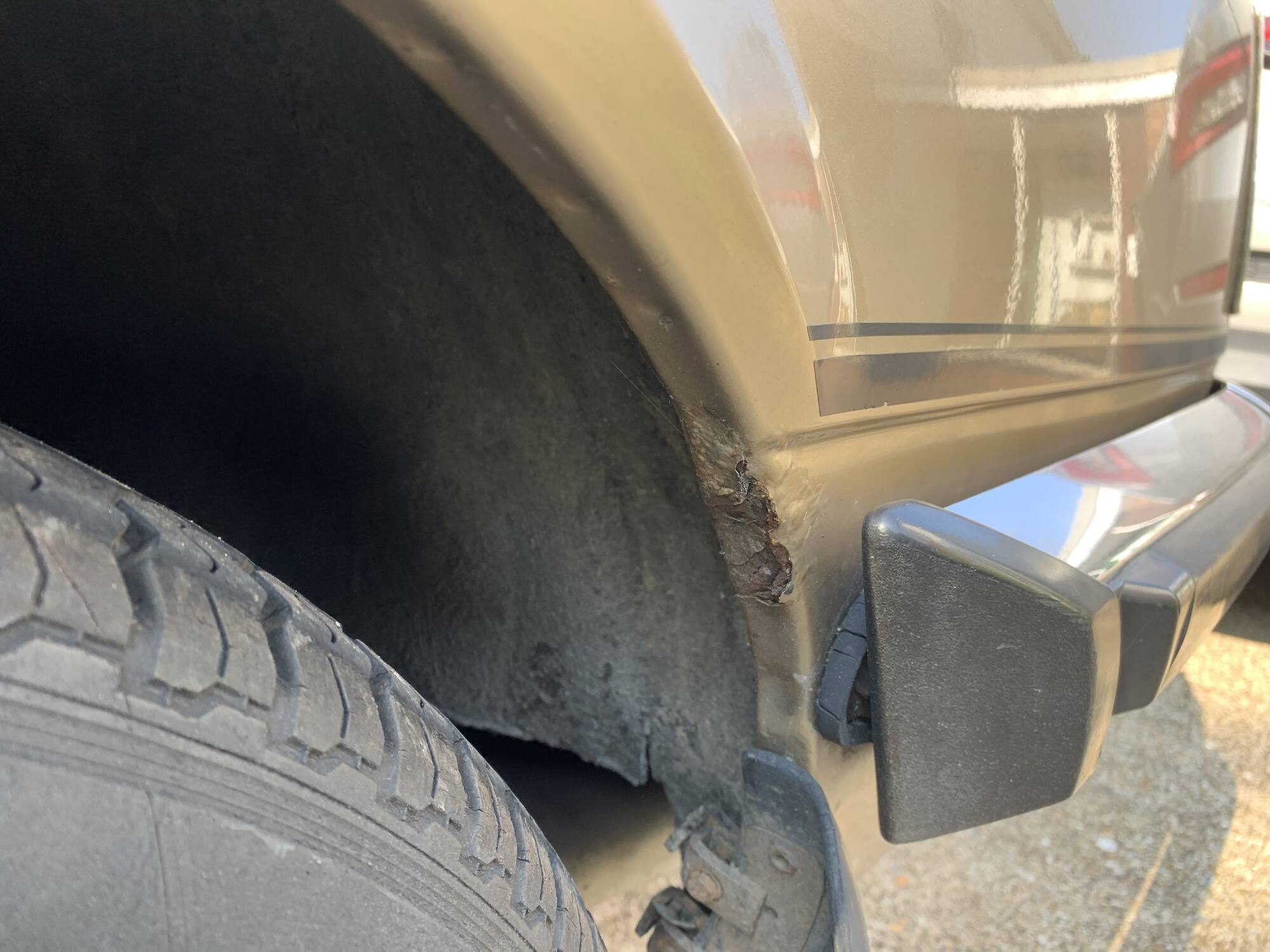

There’s a bit of surface rust on the repairs to the inner wings by the front strut turrets.  It’s thick metal and very solid though, so a quick cleanup job needed in due course.
This is the only visible grot spot — nearside rear arch.
Looks good! Get some Vactan on it and it will be all good.

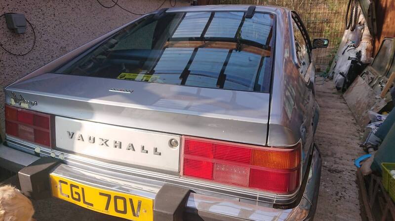

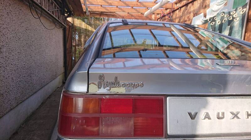

Trying to work out how to upload pictures, I hope you do not mind. If this works I will start a thread.1440607587_Royalecoupe.thumb.JPG.db2c8c9ca2b0f17c6b6371c4552cf6c8.JPG
I've only just caught up with this, you have the best taste in cars Martin! I don't think you've ever owned a car I wouldn't want to own myself and the Royale (with cheese) is no exception, that interior is to kill for!

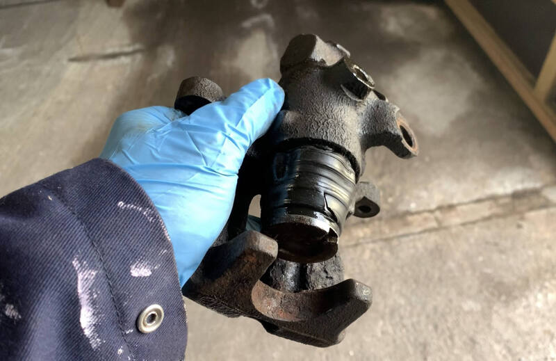

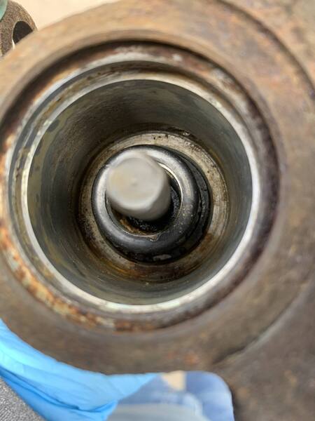

The brake pads had seized to the discs and both were (unappetising) toast.  I unceremoniously hammered them off, but being an idiot I then pumped the brake pedal at some point so the pistons have pushed out too far to wind back:
The boot has split too so a rebuild is definitely required.

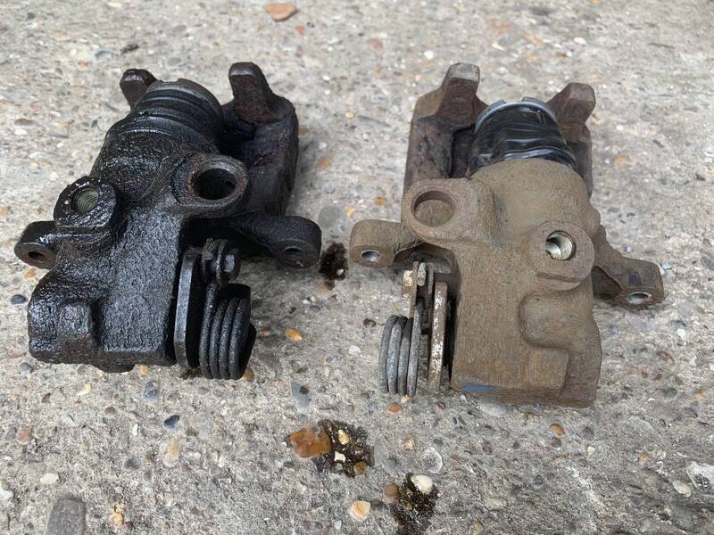

In between getting distracted by plush Vauxhalls, I have been chipping away at the problem of the Audi’s rear brakes.  They are fighting back hard at every step.
I stripped the calipers down and cleaned them up in a roughly 10% solution of POR15 degreaser in the ultrasound bath (before on the left, after on the right):
I bought a rebuild kit and replaced the various seals.

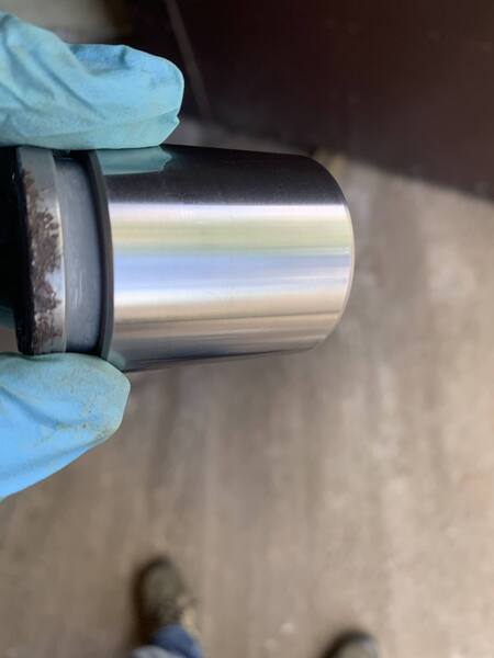

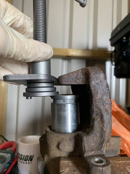

I gave the pistons and cylinders a polish with some 2000 grit:
FB4615AD-FB85-484D-9D3D-EB63643A5B35.thumb.jpeg.24ffe52a9a51c72f9a53bd2b51ccf4b9.jpegB1217D47-6DA5-401B-AA99-3E26EAD2A6A0.thumb.jpeg.208b7abaca935848b26fd409b73a2534.jpeg
The problem I’ve got is that the pistons won’t wind back in — they won’t push past the new square cut seal. I can’t fit a rewind tool between the caliper and the piston to apply enough mechanical pressure:
I’ve tried fitting the seal round the piston and trying to force it down the gap into its slot, but that’s going nowhere too.

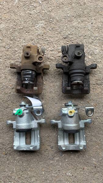

So I caved in and ordered a pair of new calipers from ECP, both left and right sides...
...can you tell what’s wrong with this picture?
