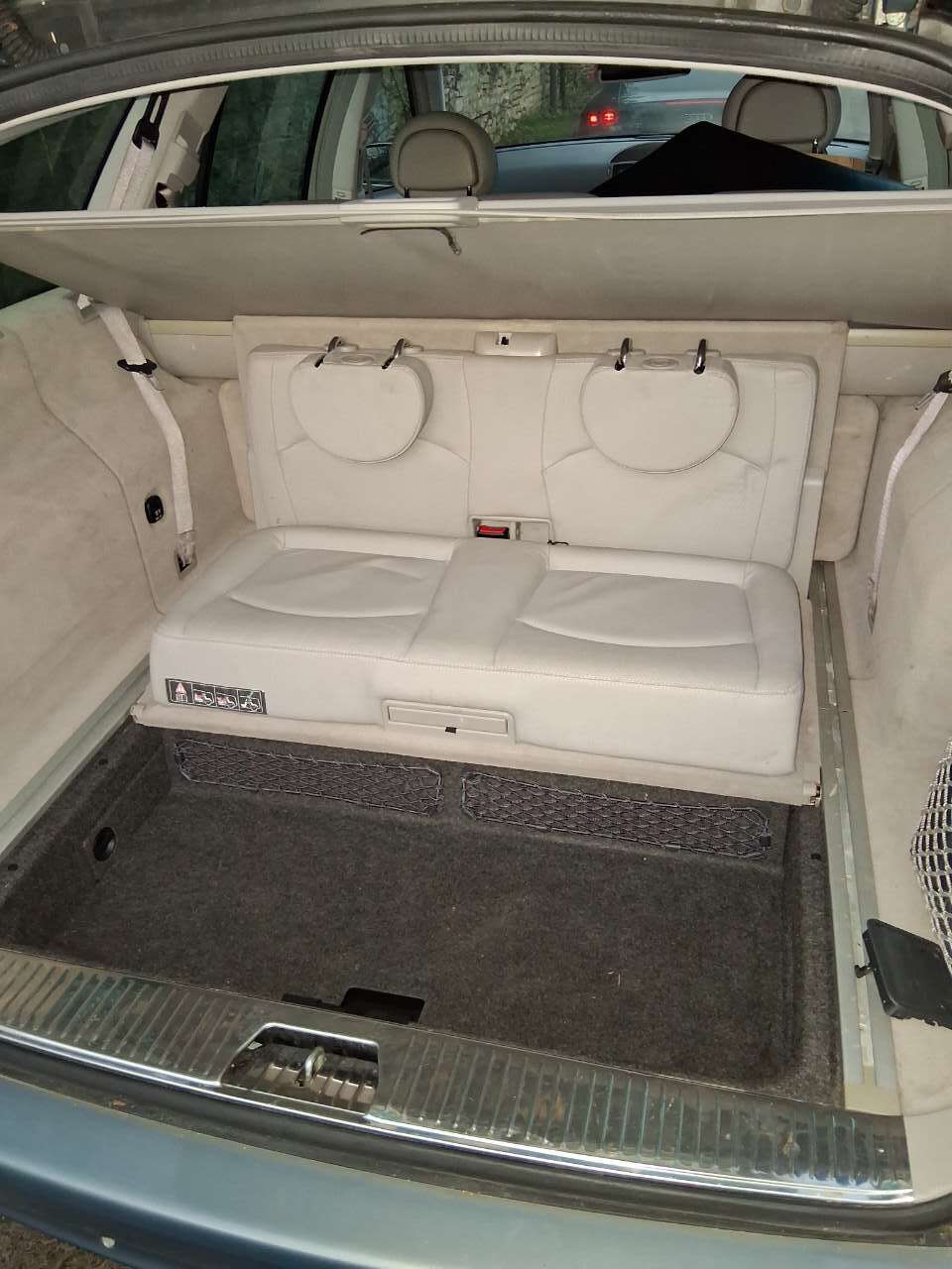

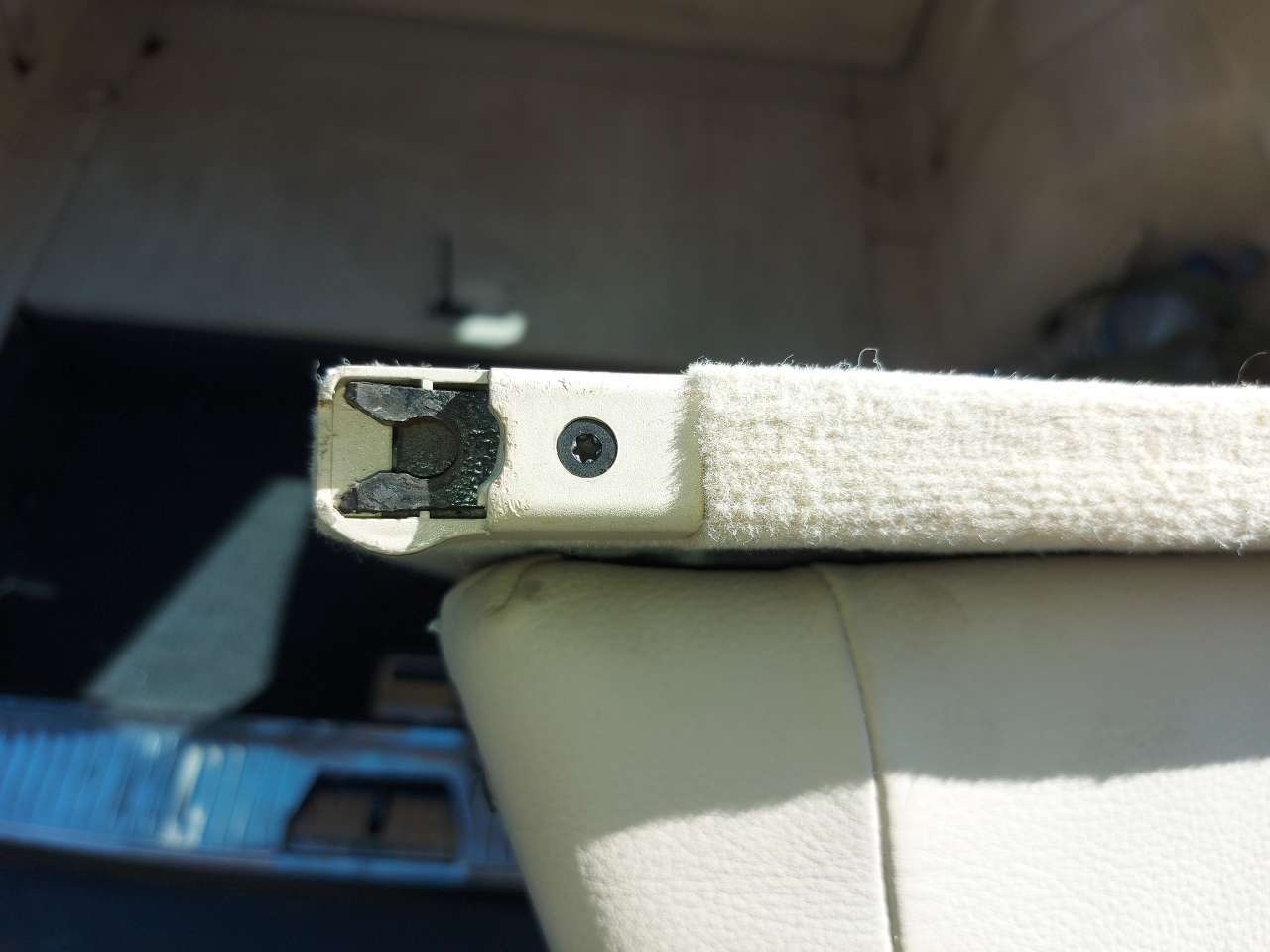

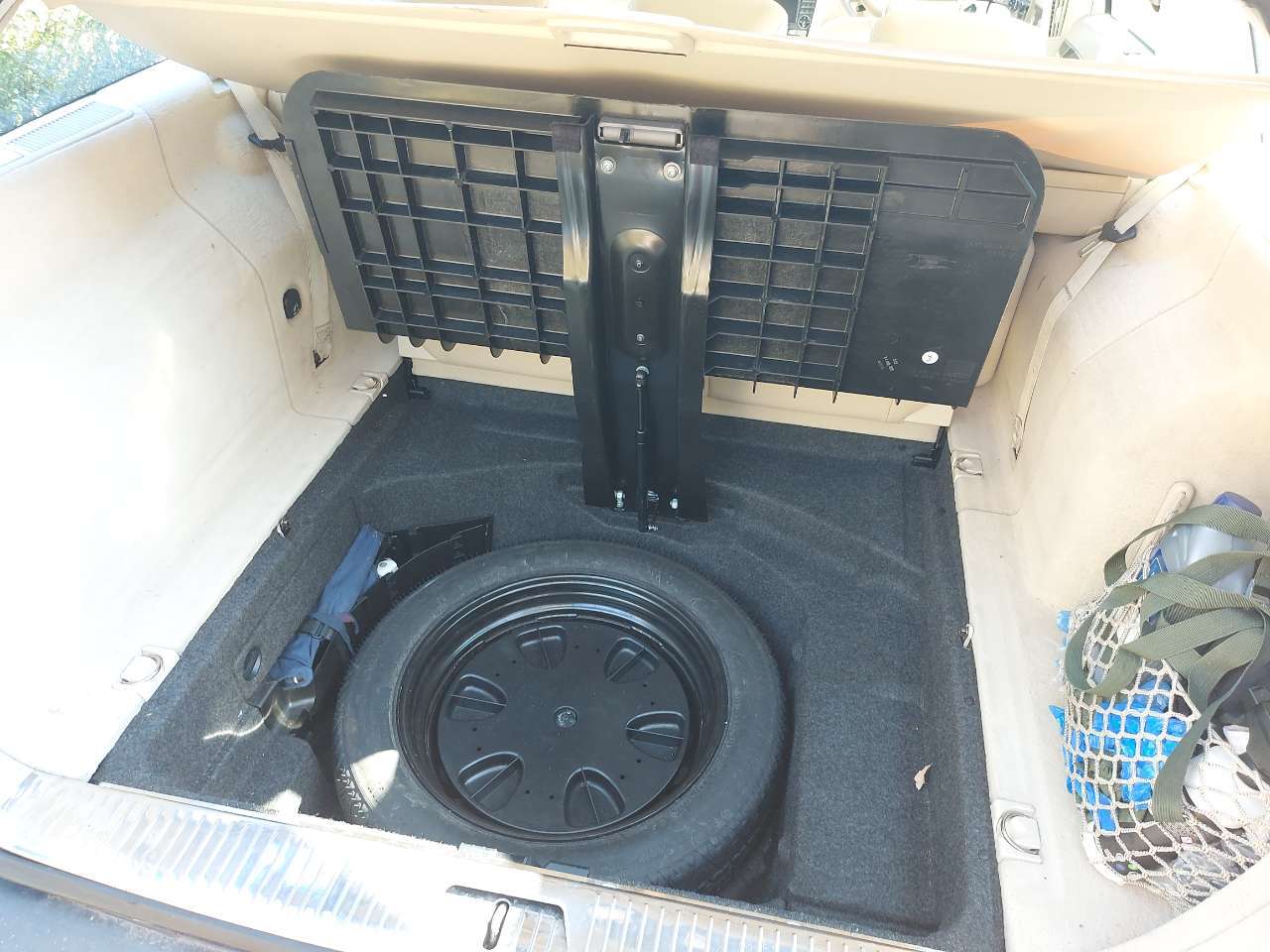

Rear seats are easy once you do it once, which handle is broken?
The one to lift the boot floor.
If you have the seven seat option there are two. Lift the rear one and fold it back, it may not stay up if you have the load cover/dog net in place. Both my cars only require the lower seat squabs lifted around 90° and pulled up to remove then there is another handle to lift the gas strut assisted cover giving access to the spare wheel. The battery is under a cover to the right.
(Any spelling mistakes are due to me being pished! Hic.)
PS the broken handles can be overcome with a screwdriver or cable tie depending how broken the mechanism.

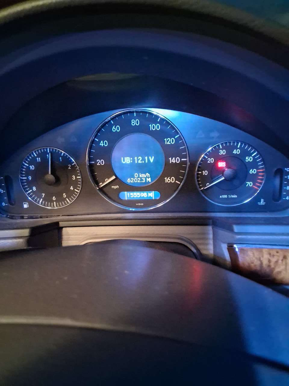

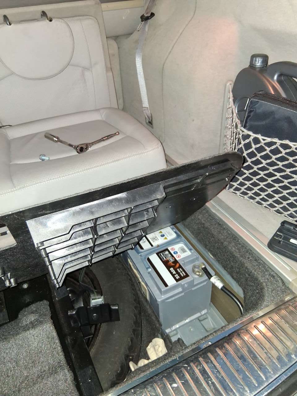

Using the car self battery check, the battery with ignition off was showing 11.3v. Less than before.

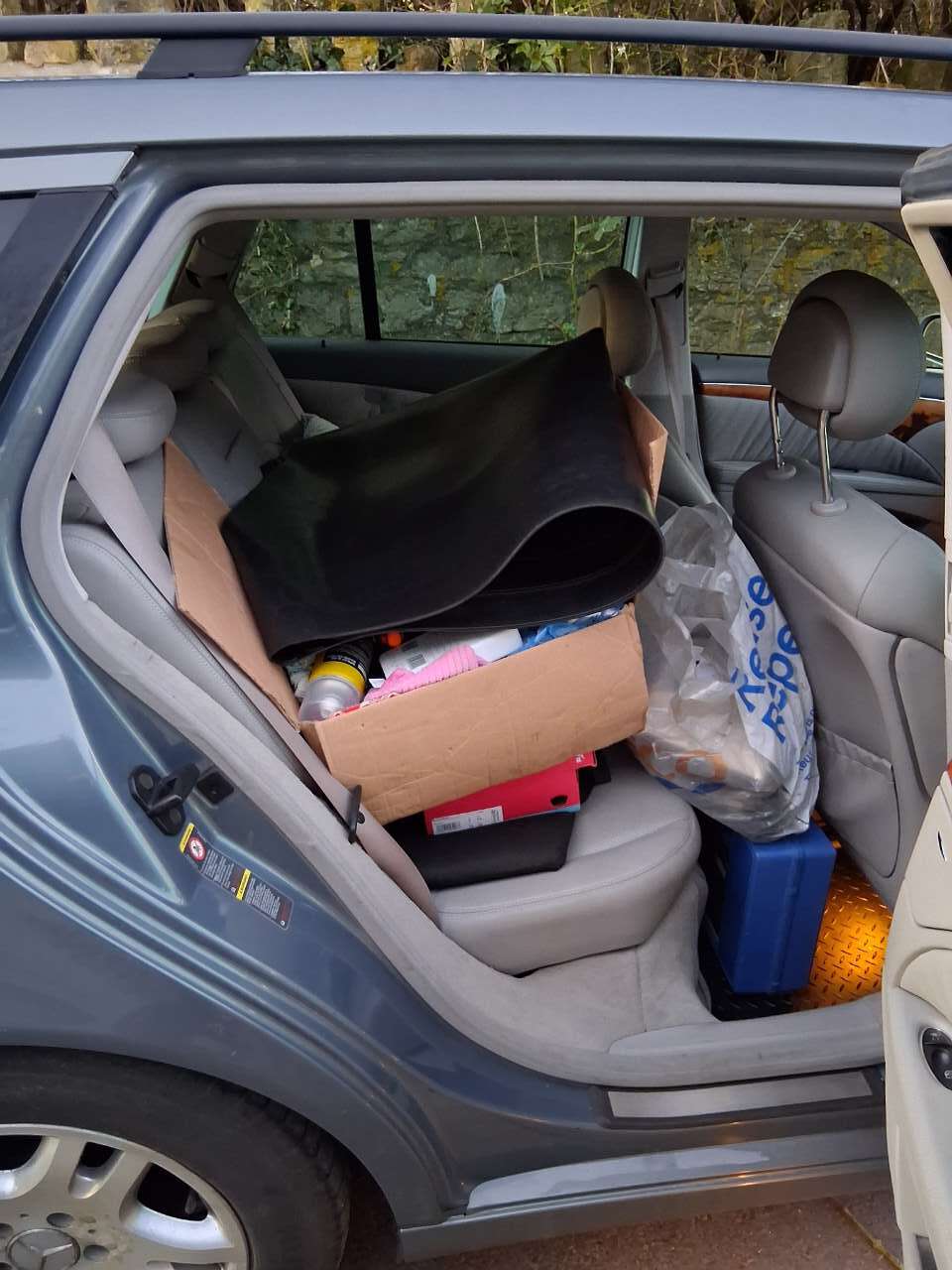

Everything out of the boot and throw it in the back seat.
Now nice and empty.
Set up the seats
The Internet says the seat base has to be unbolted.
Snake Charmer mentioned they pull out.
Either way, couldn't get the bastard out. Suspect the load tracks down each side of the boot are stopping them coming out.
So I lifted the boot floor as best I could. The car is fitted with a plastic tray on top of the boot floor. Bastard thing also wouldn't come out, but could be levered up and then held in place by my head. Removed the battery cover and bingo - hello battery.
With some waggling and an awful amount of swearing - apologies to the family that walked past, while my head was buried in the boot, while I may have repeatedly be calling the car a c*nt.

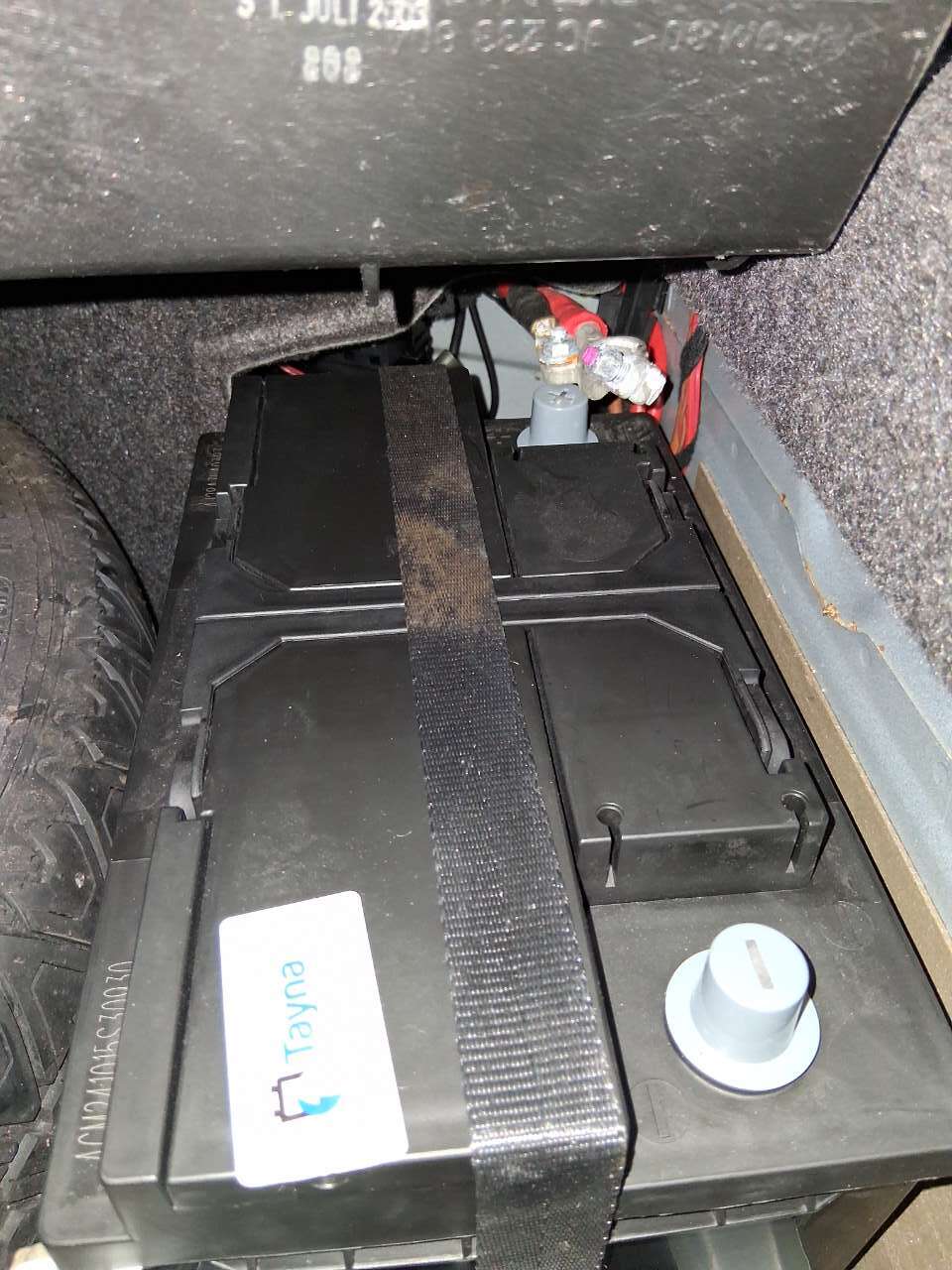

Battery out eventually.
Slight moment of panic, when I thought the replacement was larger, but it went in after a struggle.
The result. Car says battery is 12.1v at rest. Not as much as I'd hoped for, but better than the one that came out.

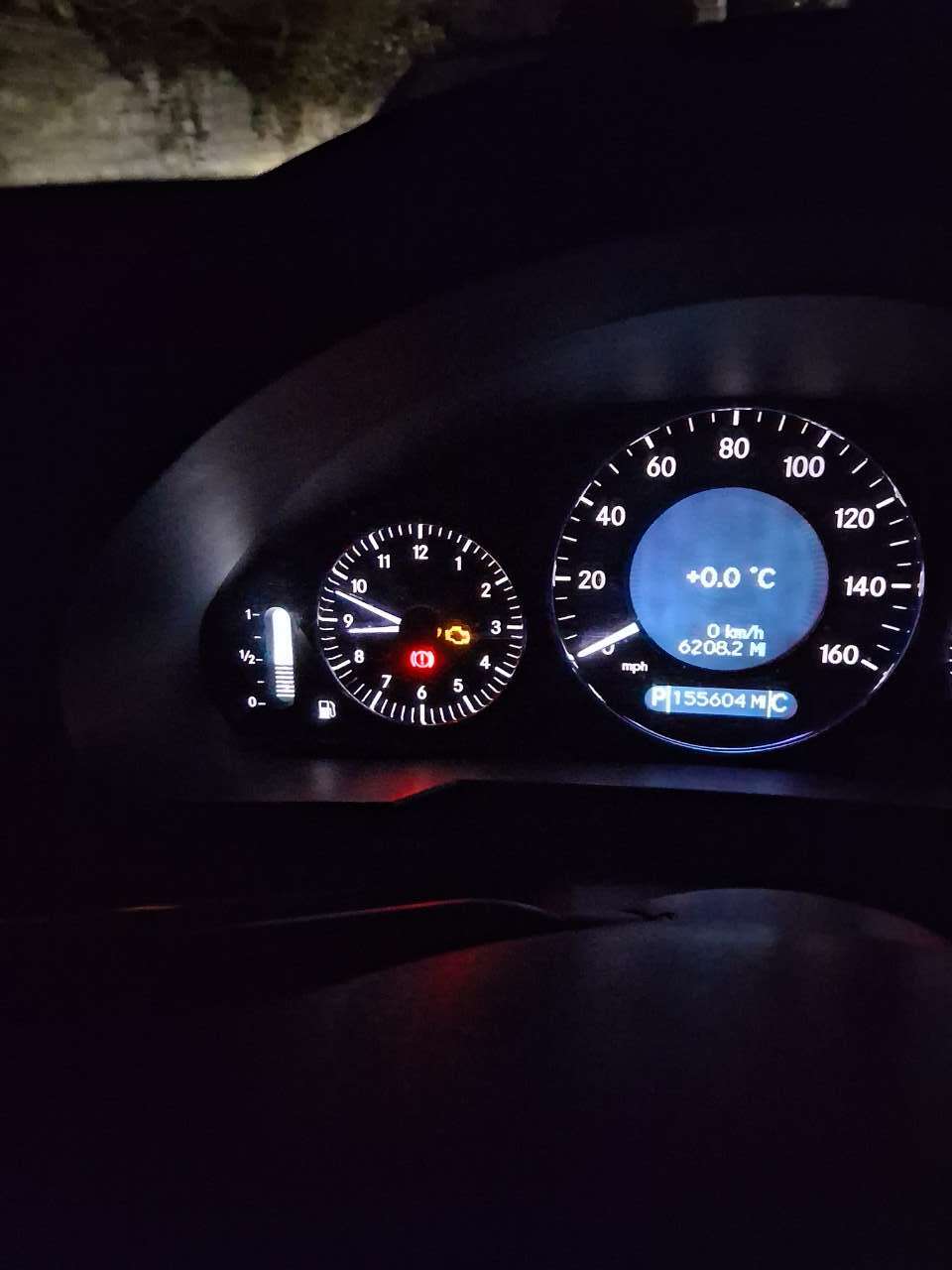

EML has gone out :)
ABS light still on
On the error screen, car still says EPS and ABS faults, but I'm hoping that it's retaining historic faults.
So BFG 1 - Cookie 1
Will give it a drive later to see if the ABS light goes out.
If not, it's code reader time.

The seats definitely do come out without tools as I did it on it once. Just need to get the right angle for it and they come out of the notch.

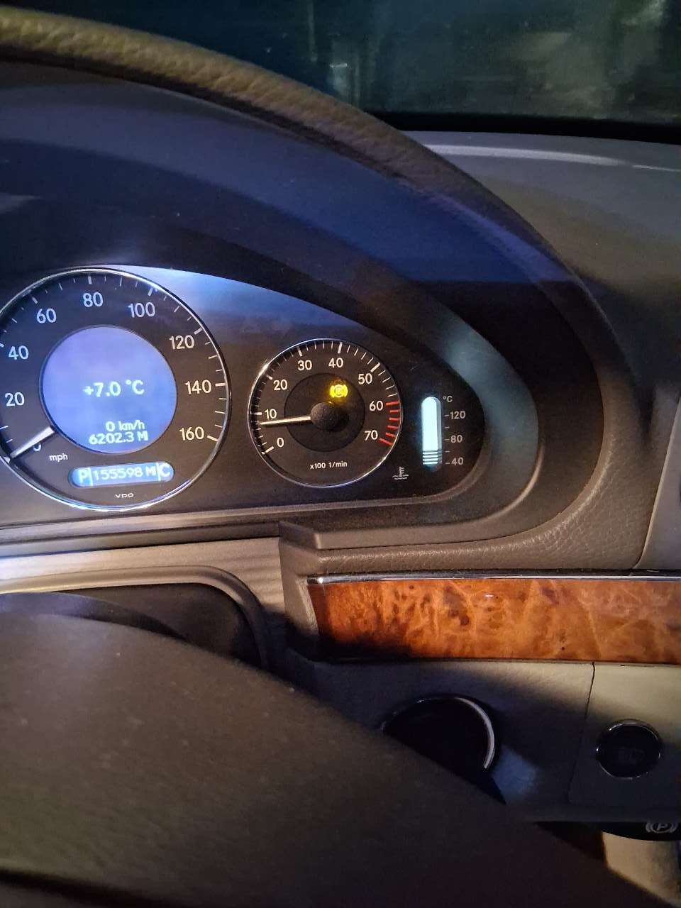

BFG given a good run.
ABS light went out :)
Then came back on :(
I will have to overcome my fear of code readers and bricking the car
On the return leg of the test drive, the EML re-appeared.
BFG 2 - Cookie 0

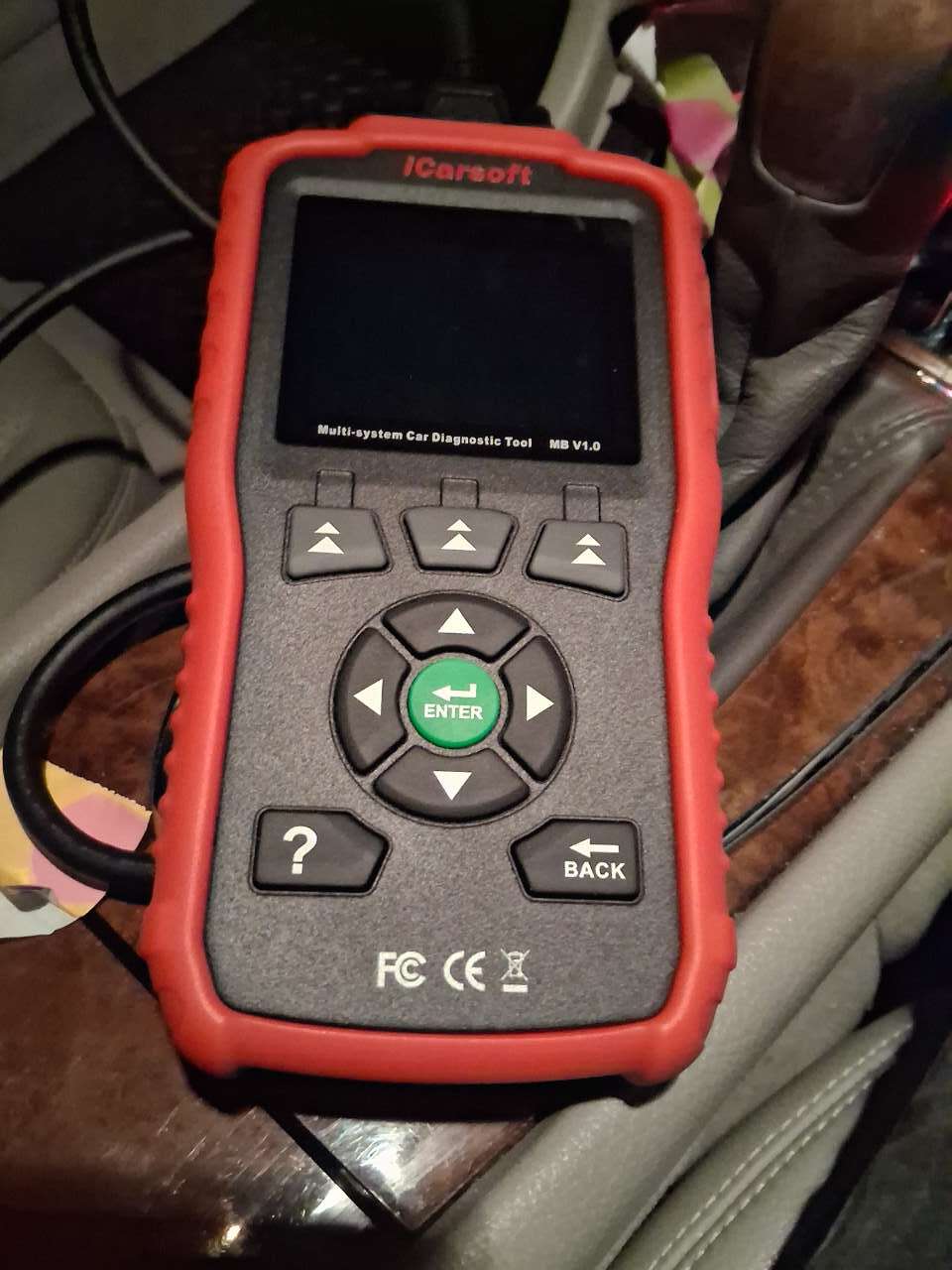

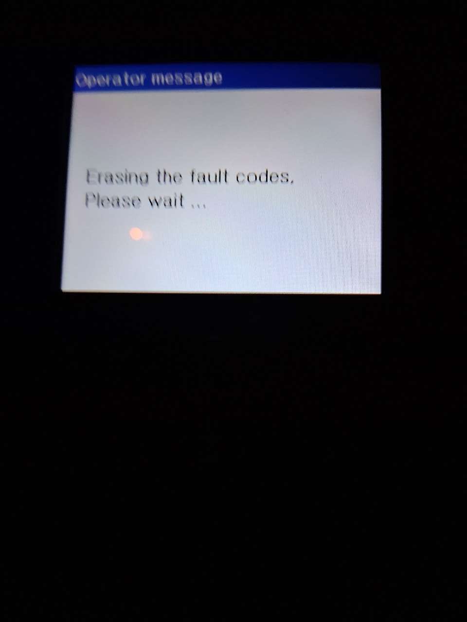

So, I actually plugged the code reader in.
And fuck me it had a lot of faults.
As an avid viewer of Salvage Rebuilds on YT, I knew exactly what to do :)
Then rescan
Unfortunately I didn't have time to get the codes, as it was 9pm and I had to sort Mrs Cookie's meds.
ABS / ESP and EML still present.
So further code read is needed tomorrow.
Arrrrrrrrrrrrr
Don't clear codes without actually noting down what the codes were!
You may find codes that don't come back but are important to decoding the problem to the puzzle.
Some of those codes will be from it going into convenience mode, some from the battery being removed, some from the wing mirror indicators being disconnected and others likely related to the abs module having a code (i.e. transmission and possibly engine)
Cheezus codes for disconnecting a wing mirror, codes for disconnecting a battery. Give me an old car any day……

Here are a few photos of my third row seats, l never really think about how to remove the base as it just comes out easily. You have to lift the base up 90° to vertical then lift, the pivot pins have two flat sides allowing removal.

Both my S211's give a low reading on the dashboard readout for voltage without the engine running compared to a mutleymeter, I suspect the load is quite high with the ignition on but reads ok once running.

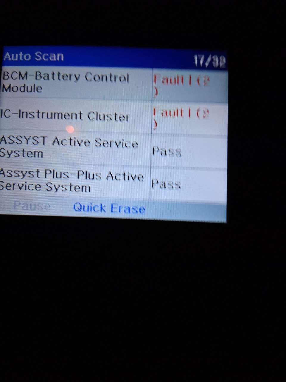

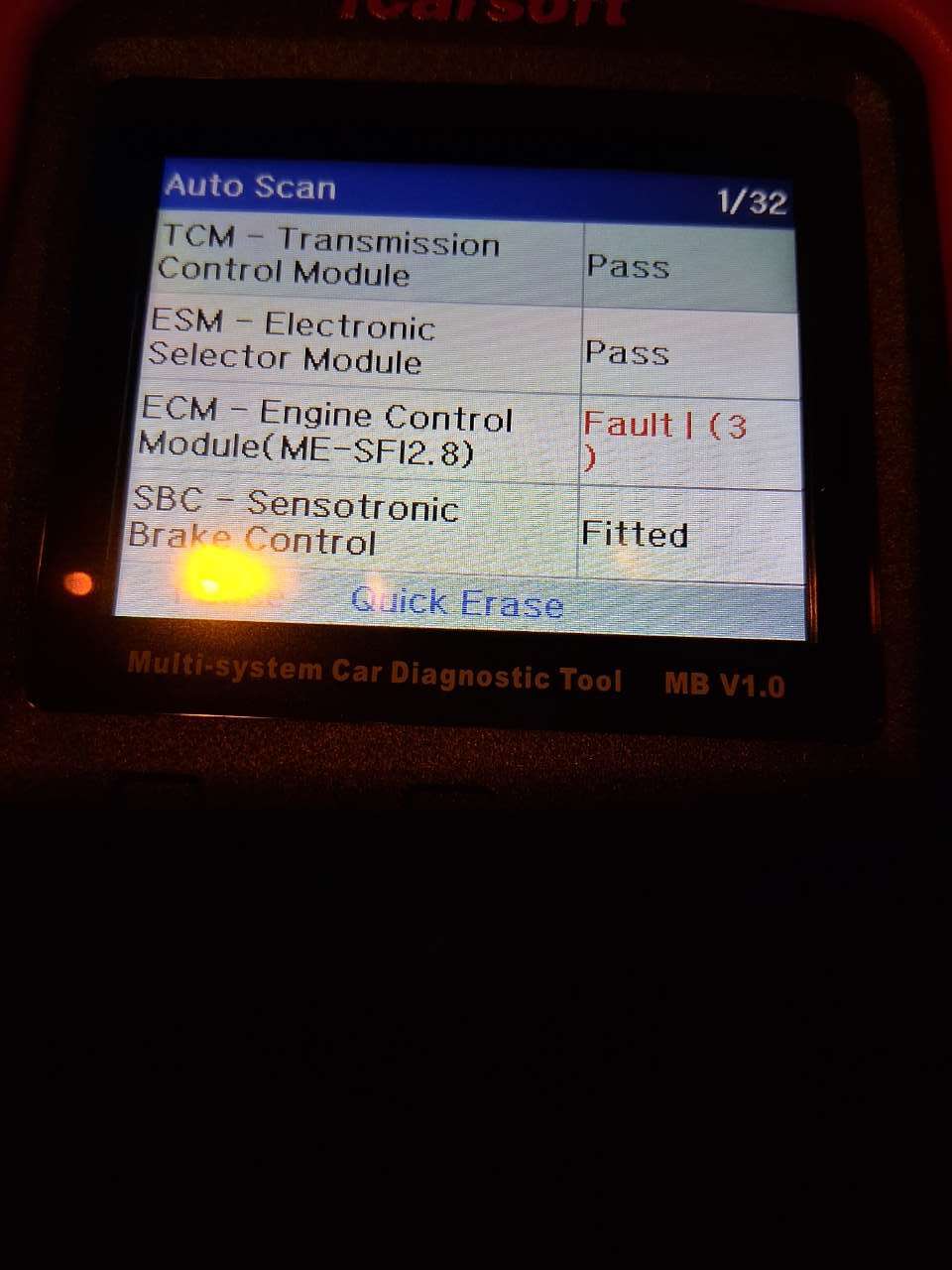

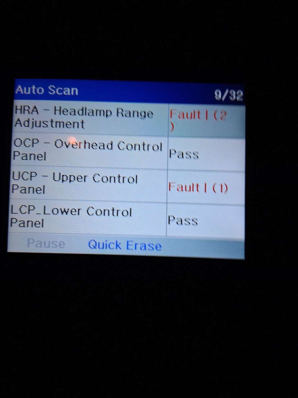

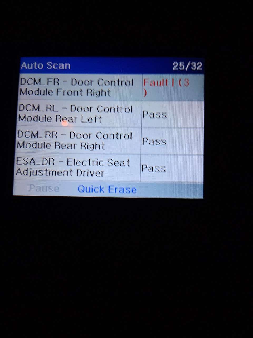

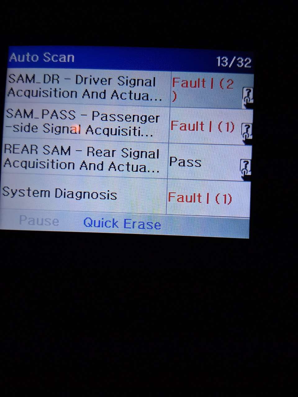

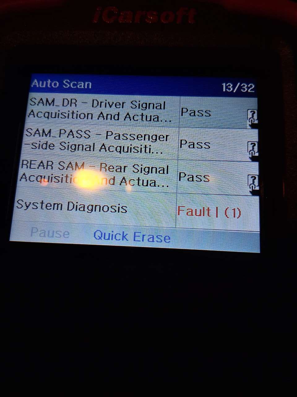

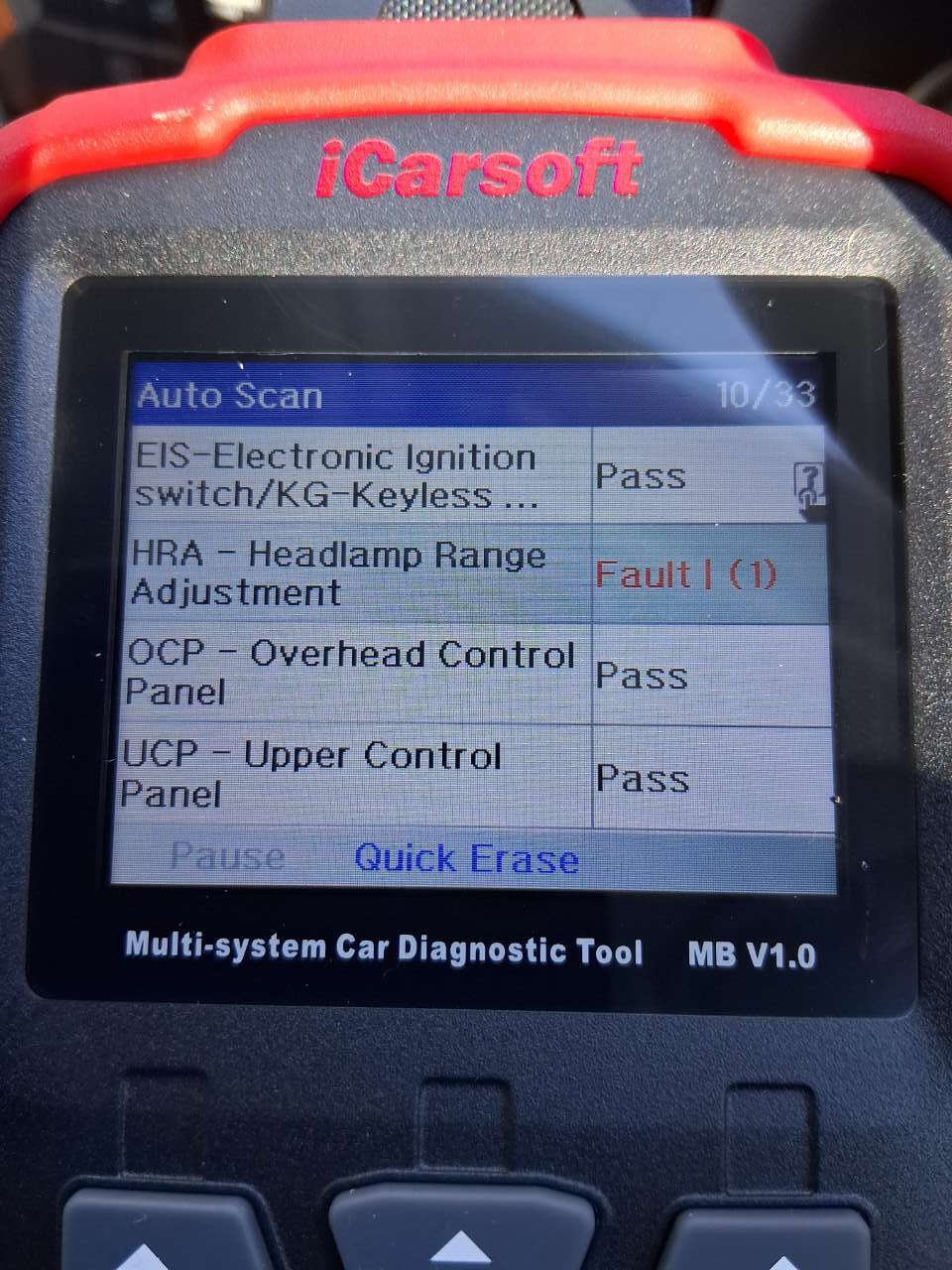

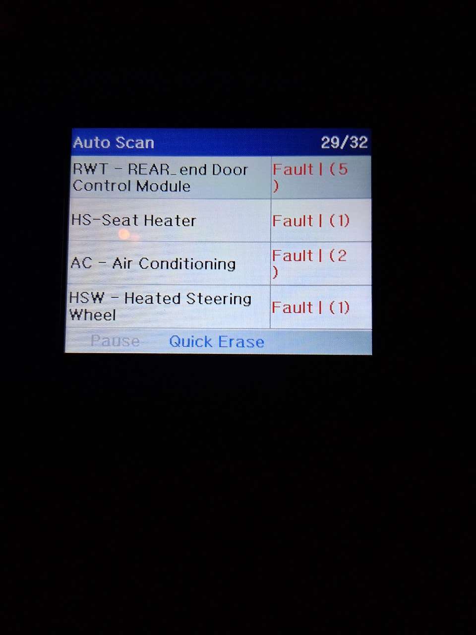

So another scan completed and as stated by @goosey above, who spookily commented while I was mid scan, code reader does not work on ABS / ESP.
I have the following system faults.
Not worried about this one.

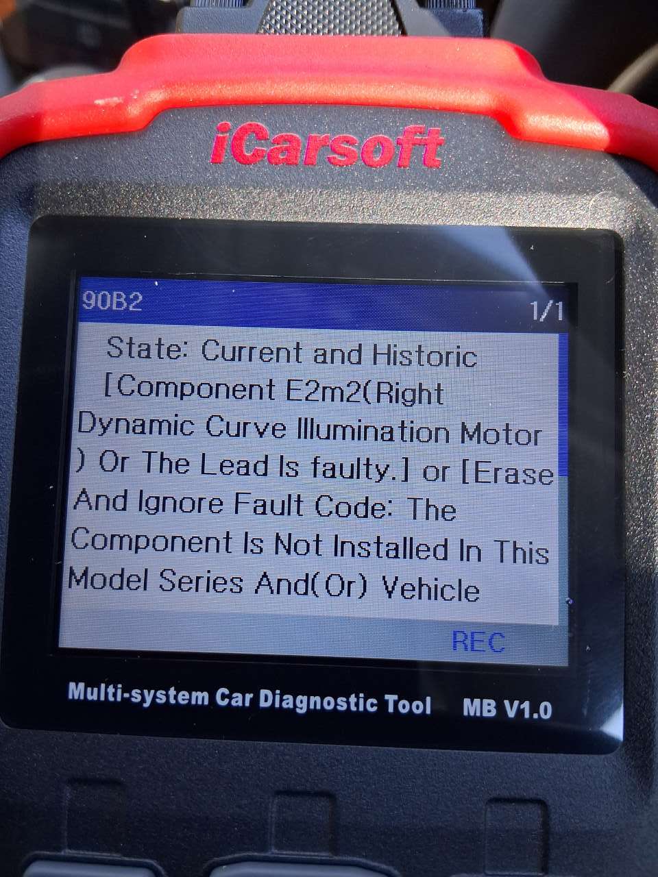

It's code is

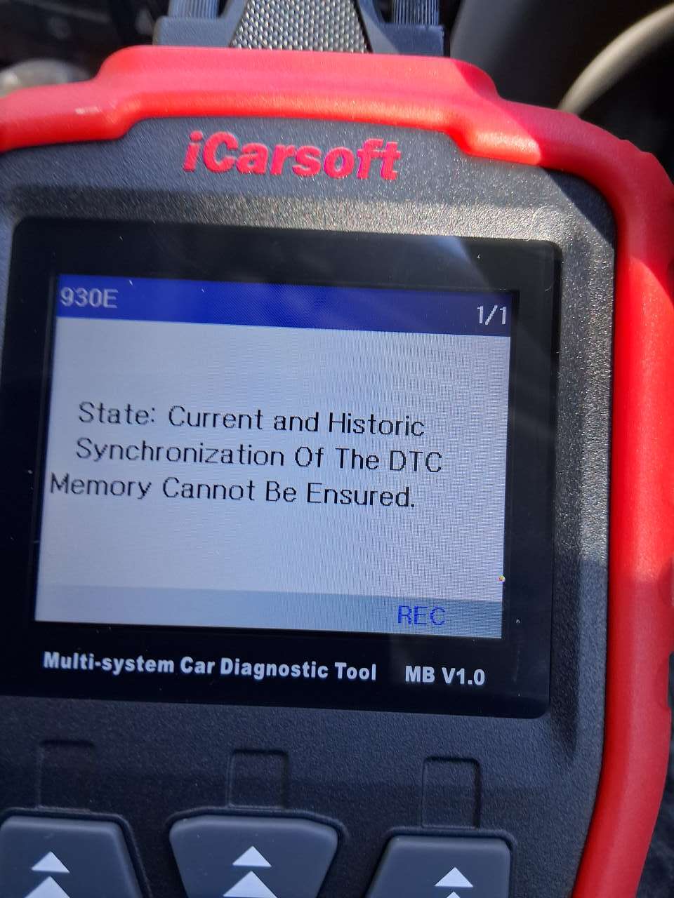

Next up is
More of a worry (if I knew what the impact of the code actually is)

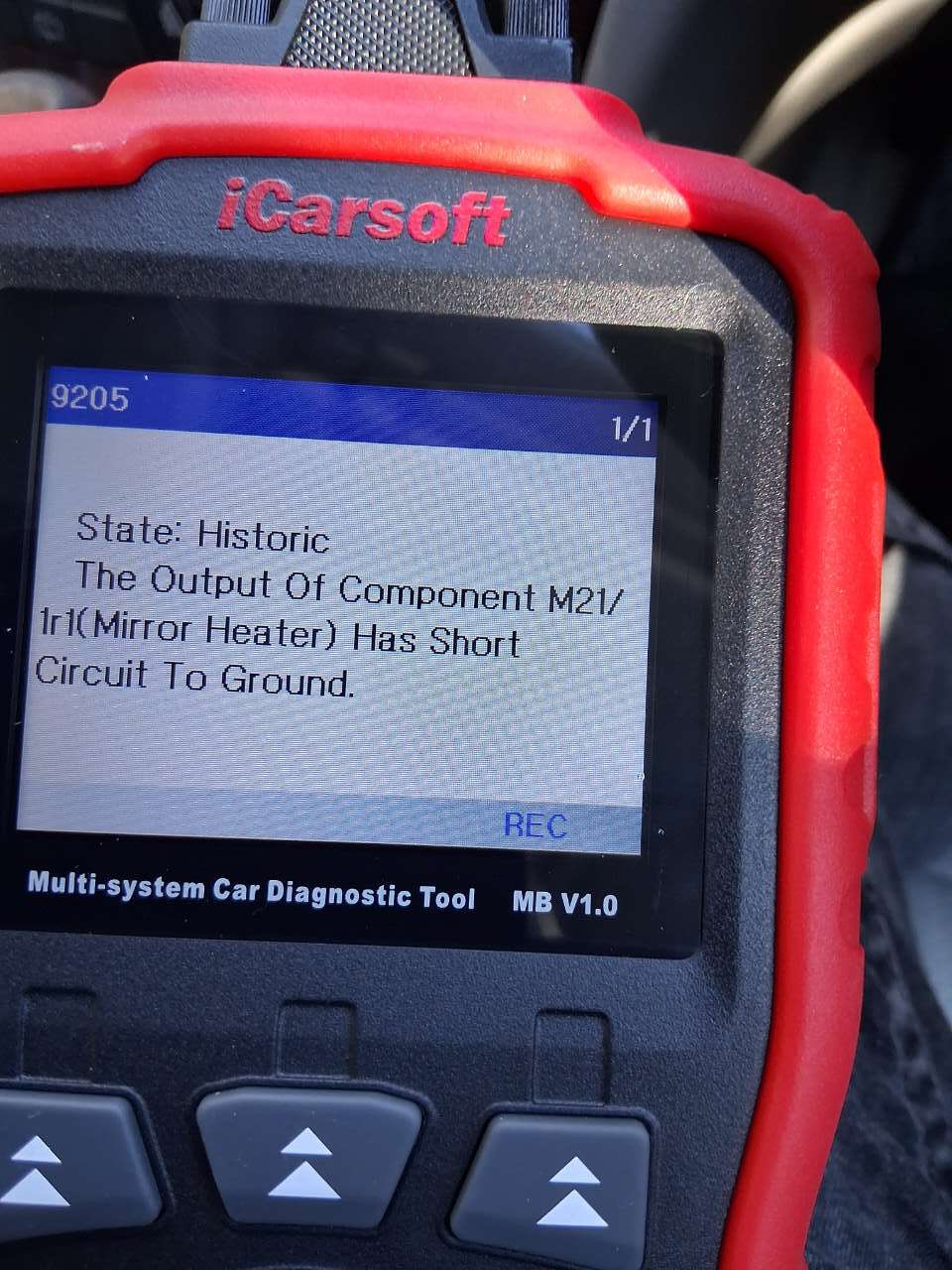

Then the following system fault
same error for both of these. Believe the heated mirror glass is missing.
But no codes for ABS or ESP.
Which is a bit shit. Going to have to either spend big money on a star clone or go beg the local garage to read the car.

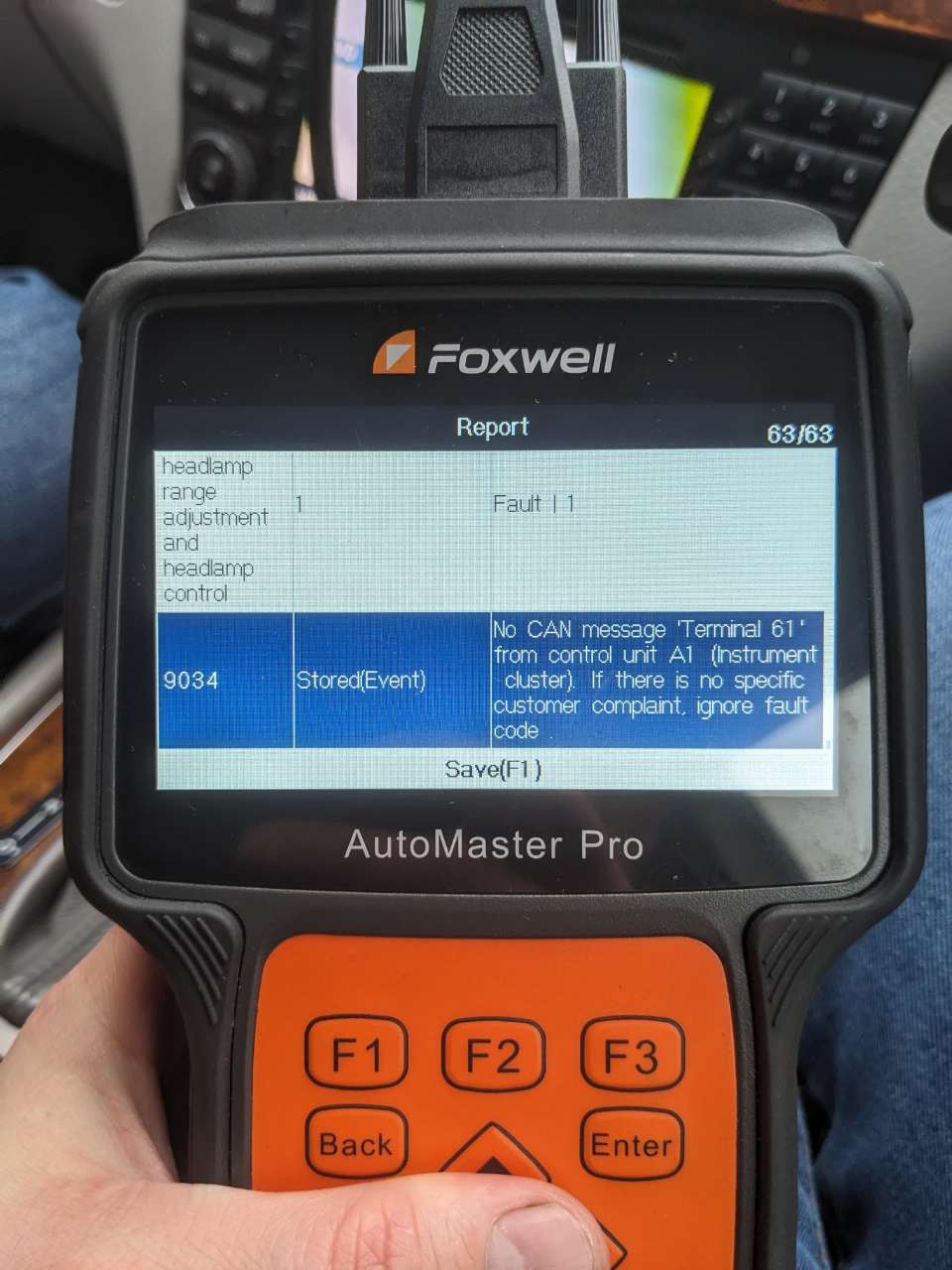

It had this when I had it. From googling around at the time basically it's an error you can ignore as it's not important nor affects anything. Just W221 weirdity of this vintage.
  • Agree 1

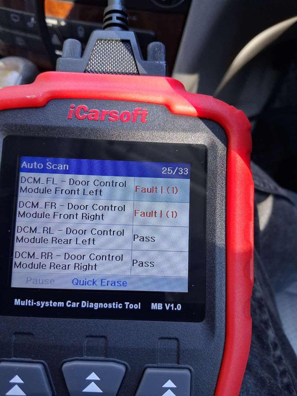

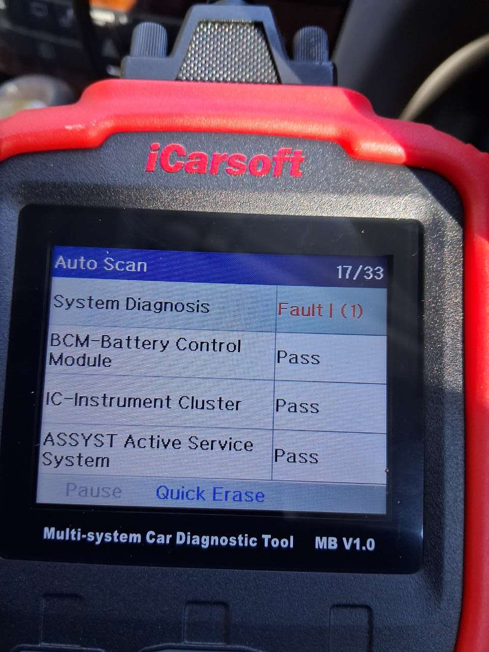

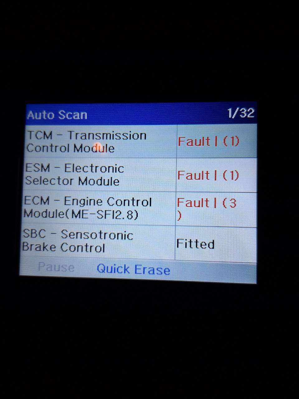

Top right corner is the number of modules scanned. It's only picked up 33 modules on that scan and there are more.
Looking at my old pictures, my Foxwell NT680Pro appeared to have picked up 63 modules.
Again you're welcome to come over for a plug-in and read.
Instead of auto scan, usually you can go in a scantool and select the module you want manually. That way you can select SBC or ABS.
Also many of these scantools can be updated by plugging into a PC. Have a look on the icarsoft website to see if there is an update.
@SiC
Thank you.
Will probably be after I return from the frozen north in a couple of weeks.
CRV will be used for the trip.
Interesting on all the modules it says PASS or FAIL, except the SBC which just gives FITTED
Try going into that module and seeing if there is a code read option.
Alternatively, go into SBC module and live data, find the wheel speed sensors in the list and go for a drive. If it's a wheel speed sensors then the dead one will read zero.
