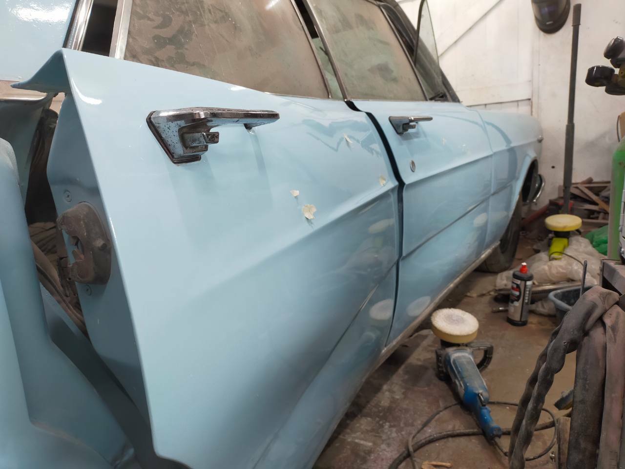

GingerNuttz Posted October 12, 2021 Posted October 12, 2021 Just finished the underside, It's been epoxied then an industrial primer that's full of zinc followed by black paint and underseal so should last many years before it needs any welding work. So I've moved on to polishing and the last job will be to fit the door cards. Once it's polished and a couple of little touch ups from building the car back together it'll be ready to go. mk2_craig, Low Horatio gearbox, Coprolalia and 19 others 22

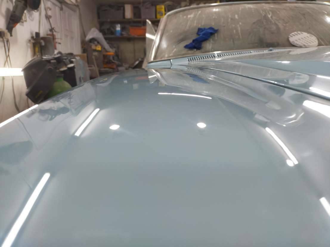

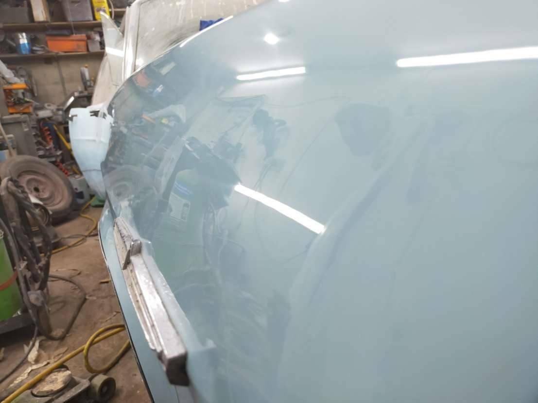

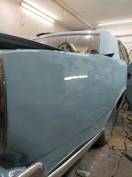

GingerNuttz Posted October 16, 2021 Posted October 16, 2021 First pass with the buff from the front to the back doors is done, got a few wee nibs I need to remove before the second pass. Arse end to polish then back to sanding all the little bits I've missed. SiC, LightBulbFun, Dick Cheeseburger and 22 others 25

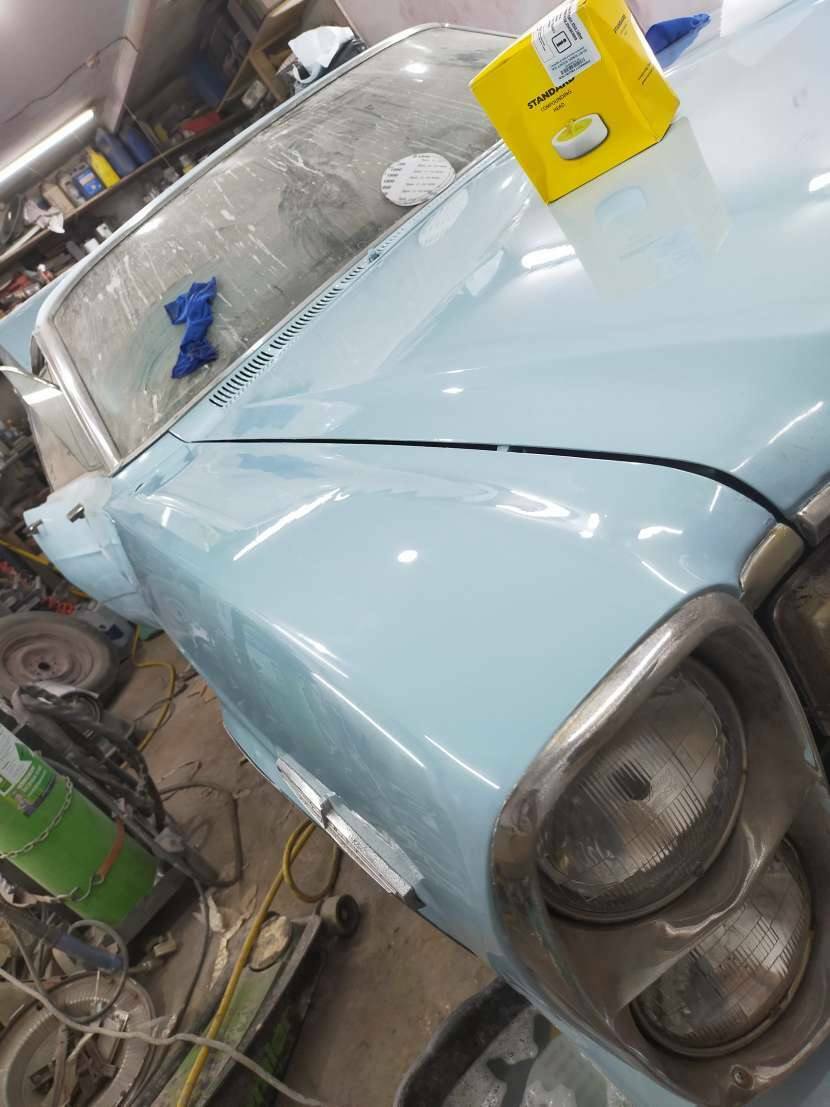

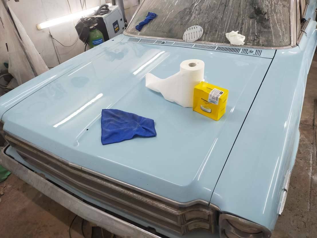

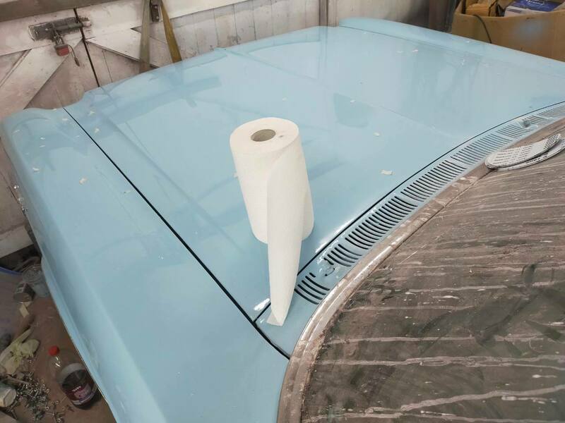

GingerNuttz Posted October 23, 2021 Posted October 23, 2021 Stage one done. Masking tape shows little bits of dust I missed because I couldn't find my paint pen. Will wash it down and scuff the little bits I've missed on Monday then it's onto g10 and go around the car again before wax. It's a big beast to polish, my back is knackered 😂 mercedade, Isopon, Low Horatio gearbox and 27 others 30
Schaefft Posted October 23, 2021 Posted October 23, 2021 This is looking fantastic, I hope you have me solidly marked in your calendar now😂 How many hours go into a paint job like this? GingerNuttz 1
GingerNuttz Posted October 24, 2021 Posted October 24, 2021 10 hours ago, Schaefft said: This is looking fantastic, I hope you have me solidly marked in your calendar now😂 How many hours go into a paint job like this? Quite a few in this one due to the state of the body, on a normal car with minimal bodywork I can knock them out in a week. Jim Bell 1

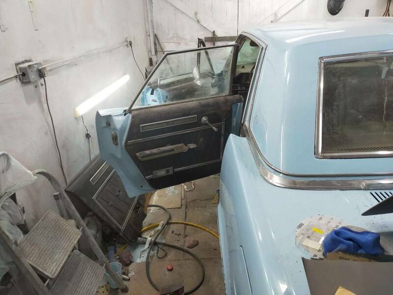

GingerNuttz Posted October 28, 2021 Posted October 28, 2021 Bleed brakes and get it running tomorrow. cort1977, Dyslexic Viking, eddyramrod and 28 others 24 1 5 1

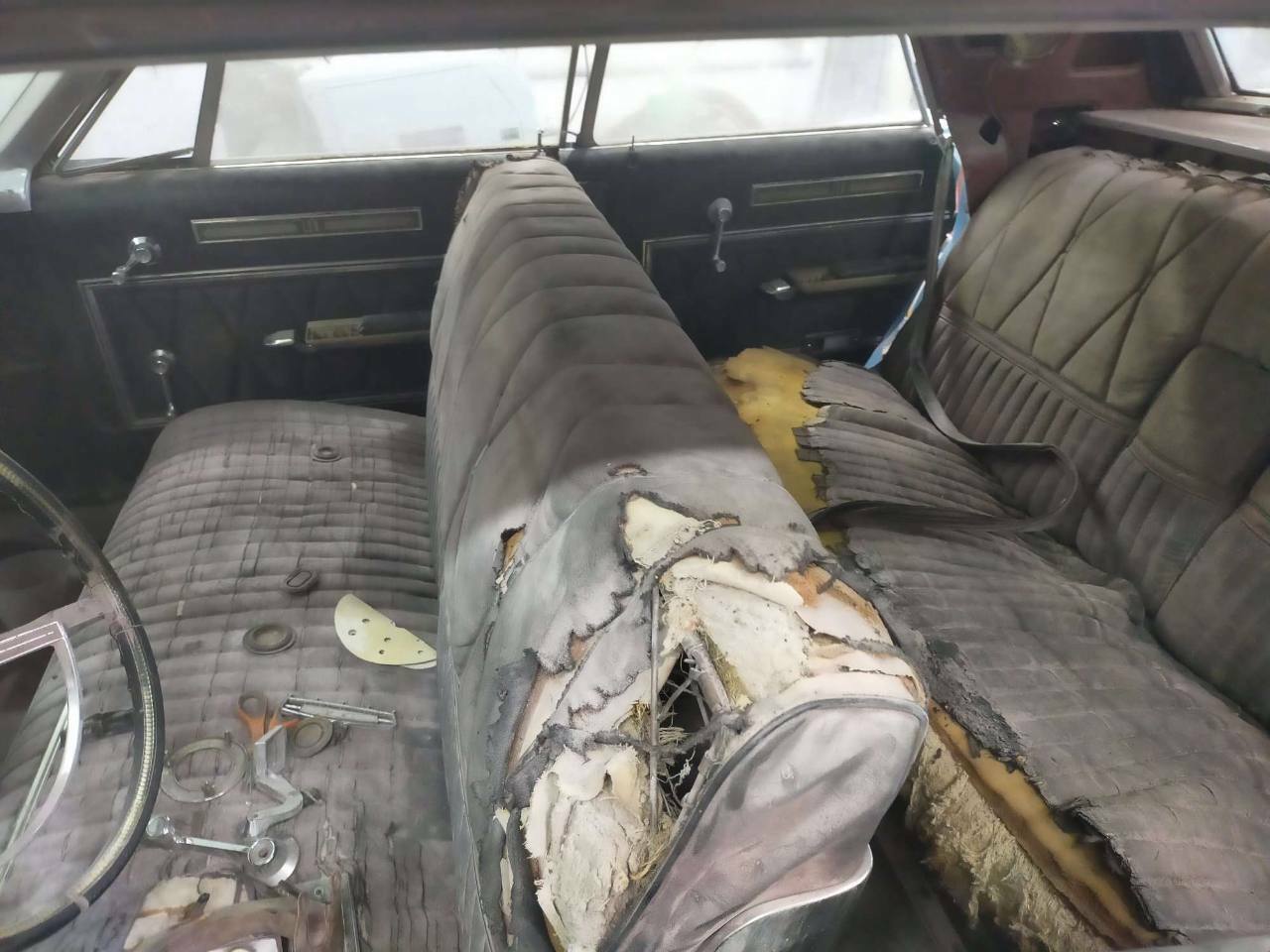

Rod/b Posted October 28, 2021 Posted October 28, 2021 I like what you’ve done with the interior G_Nutz, very shabby chic. Nice. Three Speed, loserone and Twiggy 3
GingerNuttz Posted October 28, 2021 Posted October 28, 2021 I went for that Hiroshima look, I think I nailed it tbf. Coprolalia, Split_Pin, Jim Bell and 8 others 3 8
somewhatfoolish Posted October 28, 2021 Posted October 28, 2021 A definite air of "a hobo has lived in here for several years, then had a fight with a team of ninja raccoons and lost" about it. CreepingJesus, Jim Bell, cort1977 and 3 others 6
GingerNuttz Posted October 28, 2021 Posted October 28, 2021 4 minutes ago, somewhatfoolish said: A definite air of "a hobo has lived in here for several years, then had a fight with a team of ninja racoons and lost" about it. Yep it's definitely got a hint of hepatitis about it 😂 Supernaut 1
sdkrc Posted October 28, 2021 Author Posted October 28, 2021 Those seats were mint when I dropped it off... And I had nearly £3 in change in the ashtray Jim Bell, Scruffy Bodger, blackboilersuit and 12 others 1 14
anonymous user Posted October 28, 2021 Posted October 28, 2021 1 hour ago, sdkrc said: Those seats were mint when I dropped it off... And I had nearly £3 in change in the ashtray It has an ashtray? The sheer decadence, next thing you will be saying it had carpets. (Although if I remember correctly it didn't necessarily have a floor to put it on in places)
anonymous user Posted October 28, 2021 Posted October 28, 2021 4 hours ago, somewhatfoolish said: A definite air of "a hobo has lived in here for several years, then had a fight with a team of ninja raccoons and lost" about it. Blankets, you need blankets and lots of them eddyramrod, NorfolkNWeigh and cort1977 2 1
Jim Bell Posted October 28, 2021 Posted October 28, 2021 5 hours ago, sdkrc said: Those seats were mint when I dropped it off... Mint as in they all had a big hole in the middle? Dick Cheeseburger, somewhatfoolish, Dave_Q and 1 other 1 3
cort1977 Posted October 29, 2021 Posted October 29, 2021 15 hours ago, anonymous user said: Blankets, you need blankets and lots of them Is that a Pulp Fiction allusion? "Toluca Lake. It's thirty minutes away. I'll be there in ten." eddyramrod 1

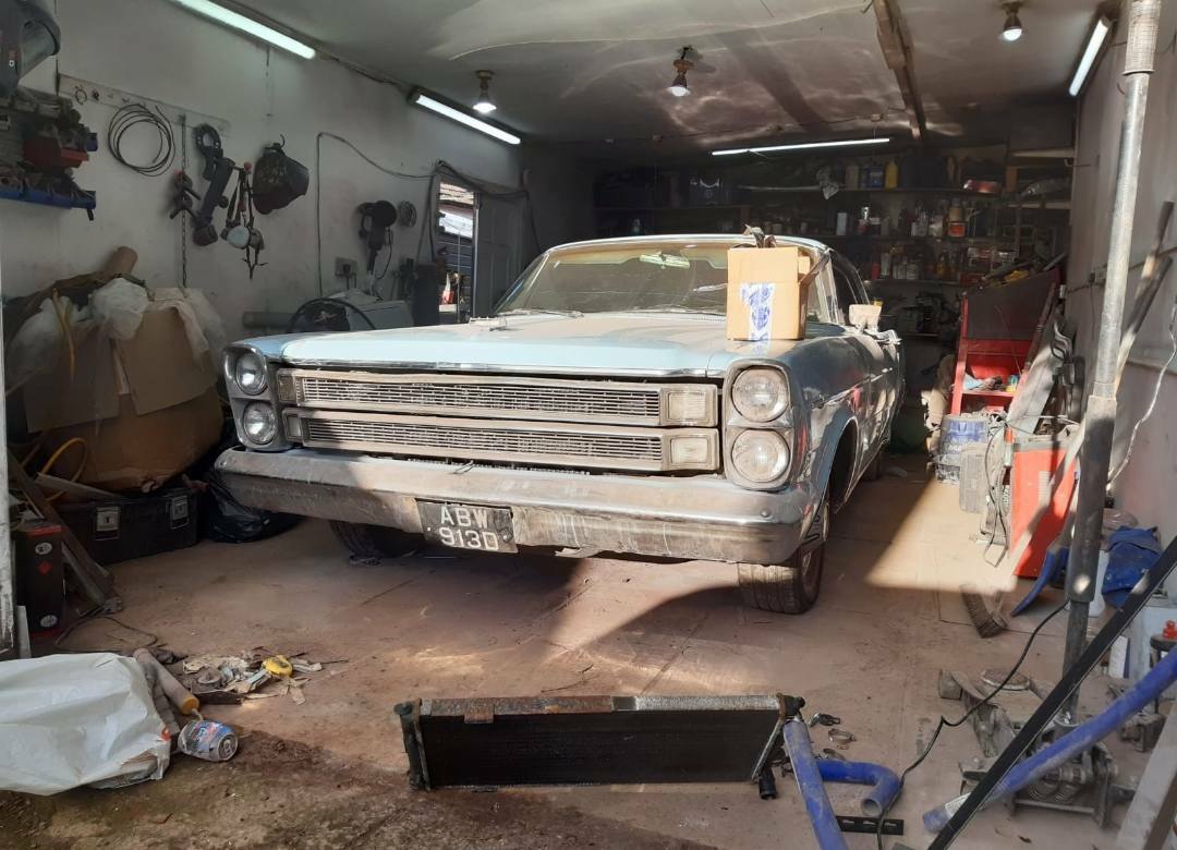

GingerNuttz Posted December 4, 2021 Posted December 4, 2021 Cold start Exhaust blowing makes it sound a bit funny through the speakers but it's fine in person Radiator shat the bed because it was leaving today It's either got stage fright or just hates me 😂 Split_Pin, sdkrc, Matty and 4 others 7
