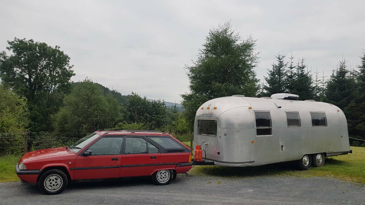

mat_the_cat Posted September 8, 2022 Author Posted September 8, 2022 That makes sense given the wheel position, and the fact that the fresh water tank was located at the front. It'll have to be the BX then! (Note the load on the rear tyres...) RayMK, Six-cylinder, Dan_ZTT and 5 others 5 2 1
Six-cylinder Posted September 8, 2022 Posted September 8, 2022 22 minutes ago, mat_the_cat said: That makes sense given the wheel position, and the fact that the fresh water tank was located at the front. It'll have to be the BX then! (Note the load on the rear tyres...) We have towed our boat with the Alfa 156 on farm roads, but I don't think it was good for it. mat_the_cat and privatewire 2

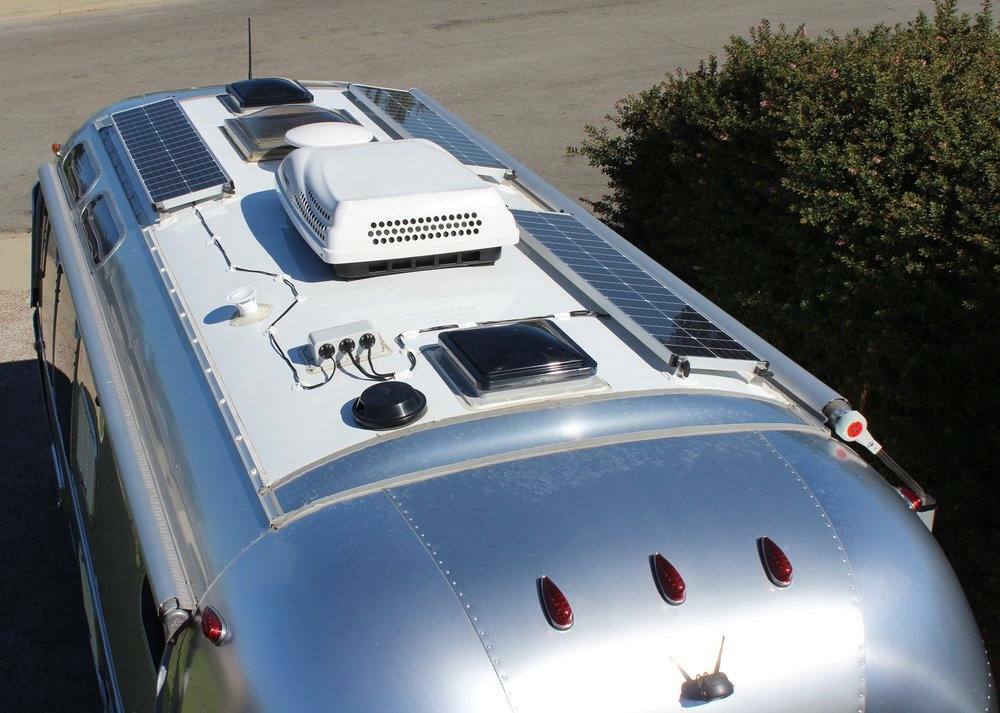

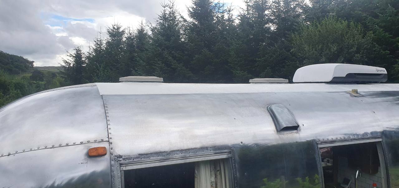

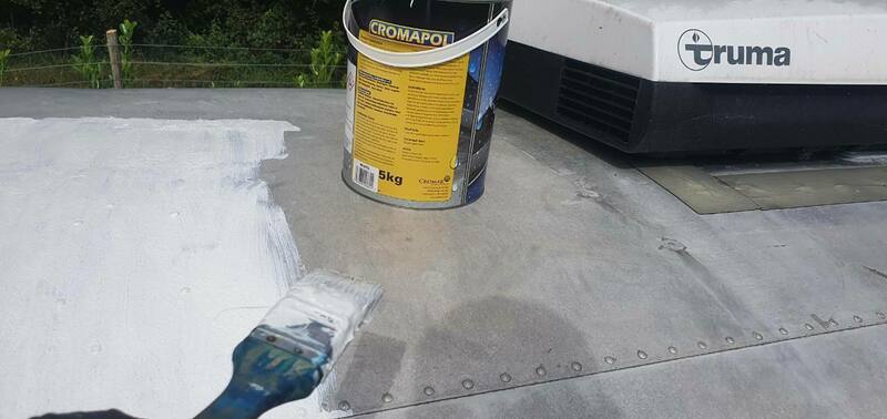

mat_the_cat Posted September 8, 2022 Author Posted September 8, 2022 6 hours ago, mat_the_cat said: have started to paint it white like a normal caravan. This was a bit misleading... Modern Airstreams have a roof coated with a solar reflective paint, and my plan is to do the same with this one. Seeing as the roof of this has been patched up in the past, even if I polished it, it would never look good. Also, there is a small leak that we've not been able to trace. Hopefully this will kill 3 birds with one stone. IMO it actually looks quite smart. I'm hoping to get the second coat on tomorrow, and then see whether it's cured the leak! Dan302, cobblers, Scruffy Bodger and 8 others 11
mat_the_cat Posted March 3, 2023 Author Posted March 3, 2023 Well yes, it did cure the leak! Although it then transpired there was a leak from the door seal, so a bit of experimenting with seal sizes to find one which would seal satisfactorily yet enable the door to be closed without excessive pressure. The last thing we want is mechanically inept guests slamming it repeatedly. Currently it's watertight in all but the worst weather so almost there - in the summer the seal will be more flexible so may enable a larger bead. The polishing was 'finished' last year, but looks like it will need going over again every year as I never got any suitable weather to protect the finish. This was late September: Next job was neatening up the decking - a fairly simple job to square off the telegraph pole supports and screw planks to them. Onto the inside and I finished the cutlery drawer. Before deciding I needed to stop the speaker panel disintegrating. I'd noticed when replacing the speakers it looked a bit fragile, and as soon as I poked it made things worse! I worked my way around the outside, injecting PVA glue wherever there was a gap, then clamping; and repeat. Solid once again it was sanded smooth and varnished, along with other interior woodwork. There used to be a roof vent fan which had long since seized up, however a PC case fan was a rather neat fit onto the original brackets rotated 90 degrees. It's just really to promote a little airflow rather than as an extractor fan; there is one of those over the hob which is both more effective and noisy. Less good news was the table which I'd re-covered - clearly the plastic was not UV stable in the slightest after only a few months, so that job had to be re-done. (Imagine it as below, but in white!) Then onto the floor. We had some leftover vinyl planks from a previous job, which are both pretty easy to lay neatly and durable. Also surprisingly realistic looking and feeling. As a complete and utterly stroke of luck there was ONE plank left over after finishing the job, and this was with using every single offcut at least once for a smaller edge piece. I was praying I didn't make a mistake but amazingly I didn't fuck up a cut at all, well at least not badly enough that I couldn't use the piece elsewhere. Other work priorities have meant that this has taken the last few months to do relatively little, but being self-employed you just can't turn down work if it's being asked for! Next job is to repair the burst pipes after an unexpected and not forecast early frost Possibly laying a path through the field to it, and getting gas/electrical services tested. Then letting the general public loose on it... Dyslexic Viking, Stinkwheel, RayMK and 20 others 23

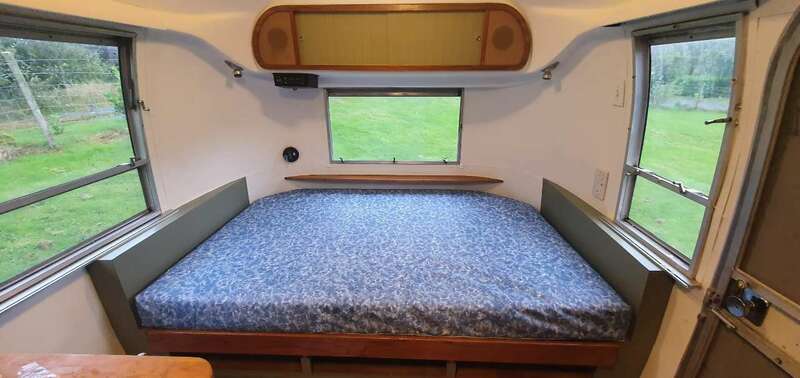

mat_the_cat Posted August 21, 2023 Author Posted August 21, 2023 Very much so in fact. Having a shower it was evident that the water pressure was too low (partially blocked pipe), the very expensive custom shaped 'premium' mattress was on the firm side of comfortable, and the curtains allowed too much morning sunlight in. Although sunlight is a rarity in North Wales, we are now fitting blackout linings to them, and have added a softer foam layer to the mattress for comfort. The water appears to be leaking in via the window hinges, which are/were toleranced tightly enough not to require any form of seal on the aluminium extrusion. After 55 years of wear the gap is now larger; fortunately still available, but as usual have to wait for US delivery. somewhatfoolish and Dick Cheeseburger 2

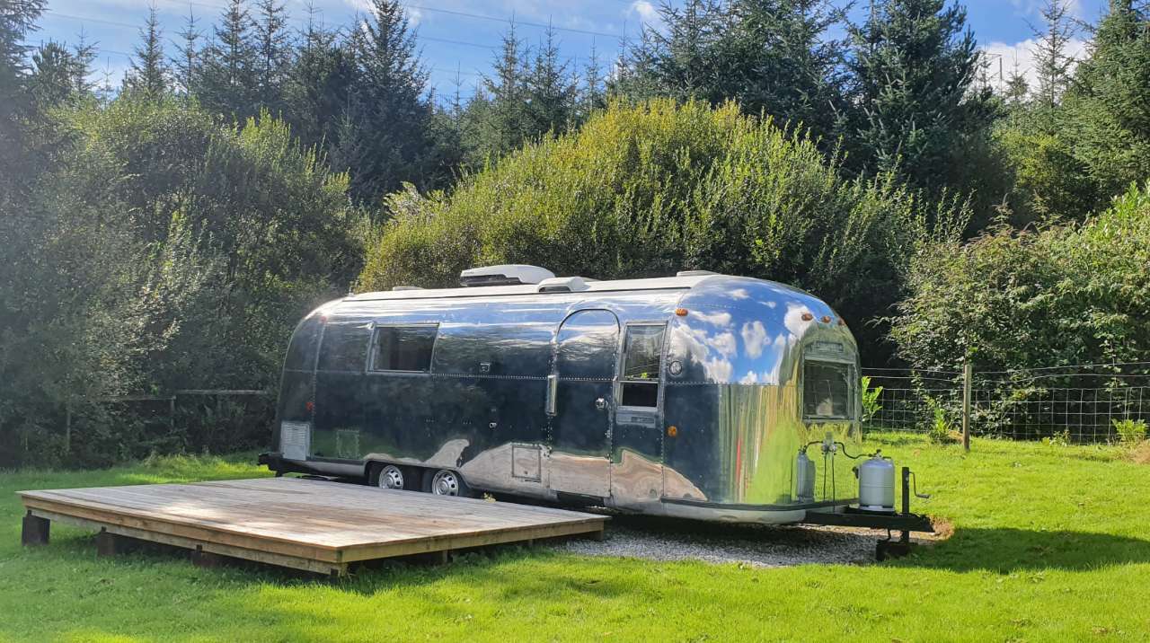

bezzabsa Posted August 22, 2023 Posted August 22, 2023 I know its an old pic, but re posted as I love a working disco Stinkwheel, Lacquer Peel and mercedade 3
bezzabsa Posted August 22, 2023 Posted August 22, 2023 are you adding solar panels to the roof?? and I reckon a switch on the inside to allow the 'running lights' to come on at night for some ambiance

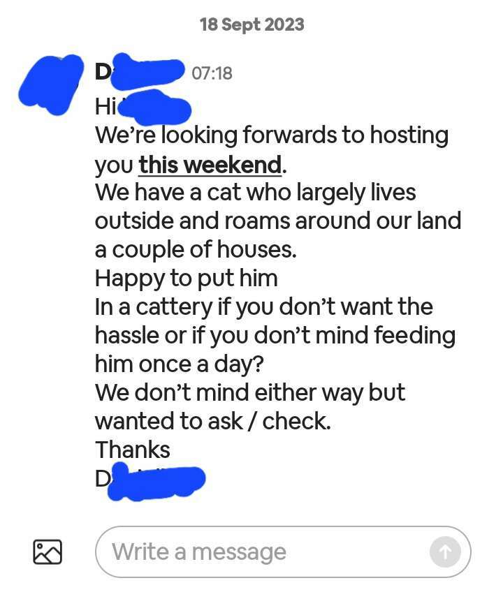

New POD Posted September 18, 2023 Posted September 18, 2023 To the hosts of holiday lets: As a customer, what should be an appropriate response to this message be. I like cats, and we hardly ever put ours in a Cattery, when we had cats, but I don't think they should be asking us to feed it. On the one hand I'm a nice person, and on the other I'm paying ££££ for a 4 bedroom cottage, for 7 people, for 2 nights. So they are cheeky fuckers.

High Jetter Posted September 18, 2023 Posted September 18, 2023 3 minutes ago, New POD said: To the hosts of holiday lets: As a customer, what should be an appropriate response to this message be. I like cats, and we hardly ever put ours in a Cattery, when we had cats, but I don't think they should be asking us to feed it. On the one hand I'm a nice person, and on the other I'm paying ££££ for a 4 bedroom cottage, for 7 people, for 2 nights. So they are cheeky fuckers. Hang on, where are the people who are hosting you going? If they're buggering off it seems a bit much to expect paying guests to look after their cat. Their grammar is not the best either.
Noel Tidybeard Posted September 18, 2023 Posted September 18, 2023 4 hours ago, New POD said: To the hosts of holiday lets: As a customer, what should be an appropriate response to this message be. I like cats, and we hardly ever put ours in a Cattery, when we had cats, but I don't think they should be asking us to feed it. On the one hand I'm a nice person, and on the other I'm paying ££££ for a 4 bedroom cottage, for 7 people, for 2 nights. So they are cheeky fuckers. i'm not sure they're cheeky fuckers seeing as they asked first- some people may not have a problem doing it at all
somewhatfoolish Posted September 18, 2023 Posted September 18, 2023 15 hours ago, New POD said: To the hosts of holiday lets: As a customer, what should be an appropriate response to this message be. I like cats, and we hardly ever put ours in a Cattery, when we had cats, but I don't think they should be asking us to feed it. On the one hand I'm a nice person, and on the other I'm paying ££££ for a 4 bedroom cottage, for 7 people, for 2 nights. So they are cheeky fuckers. If they run an Airbnb they can afford one of those electric feeder things that reveals fresh kibble once a day. Weird but not cheeky as they've given you the option of not doing it.
