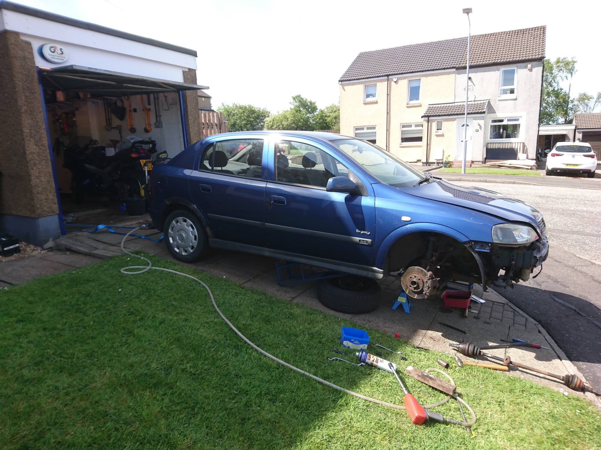

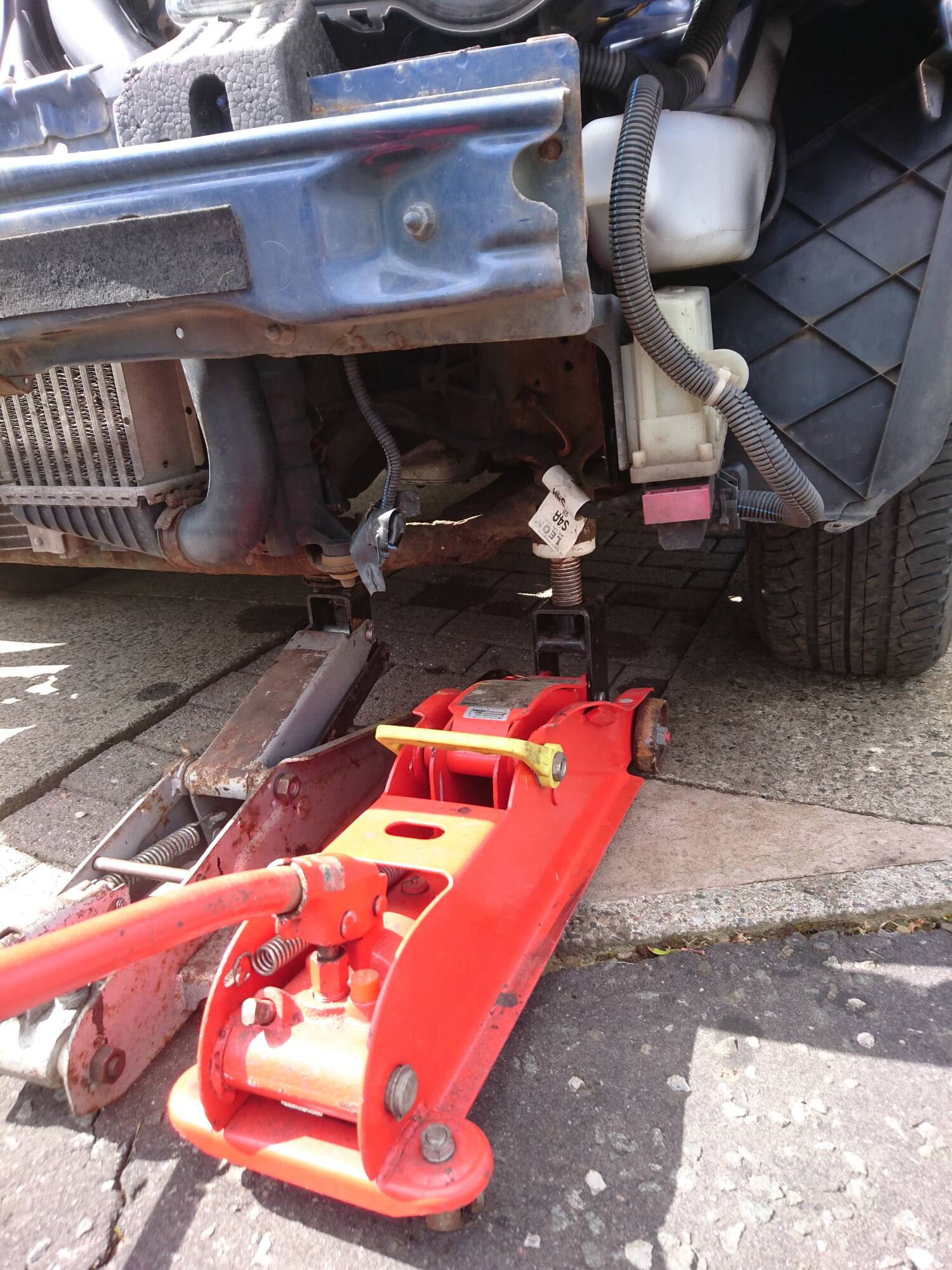

3. Figure out a way to jack up the car and gain access to the starter without moving it and (most importantly) without me meeting my maker trying to bench press a rusty old vauxhall on my drive.
Step 1
Tie the car to a ground anchor concreted into the garage floor to prevent it rolling forward if being in gear with handbrake on wasn't enough. Initially I did this with a combination of trailer straps and old climbing kit but later went to screwfix and upgraded that to a 2.5 ton rated ratchet strap.
Step 2
Remove front bumper (easy as only held on with cable ties) to get better access to the subframe. Then using a small trolley jack lift the subframe enough to get a high lift under the subframe.

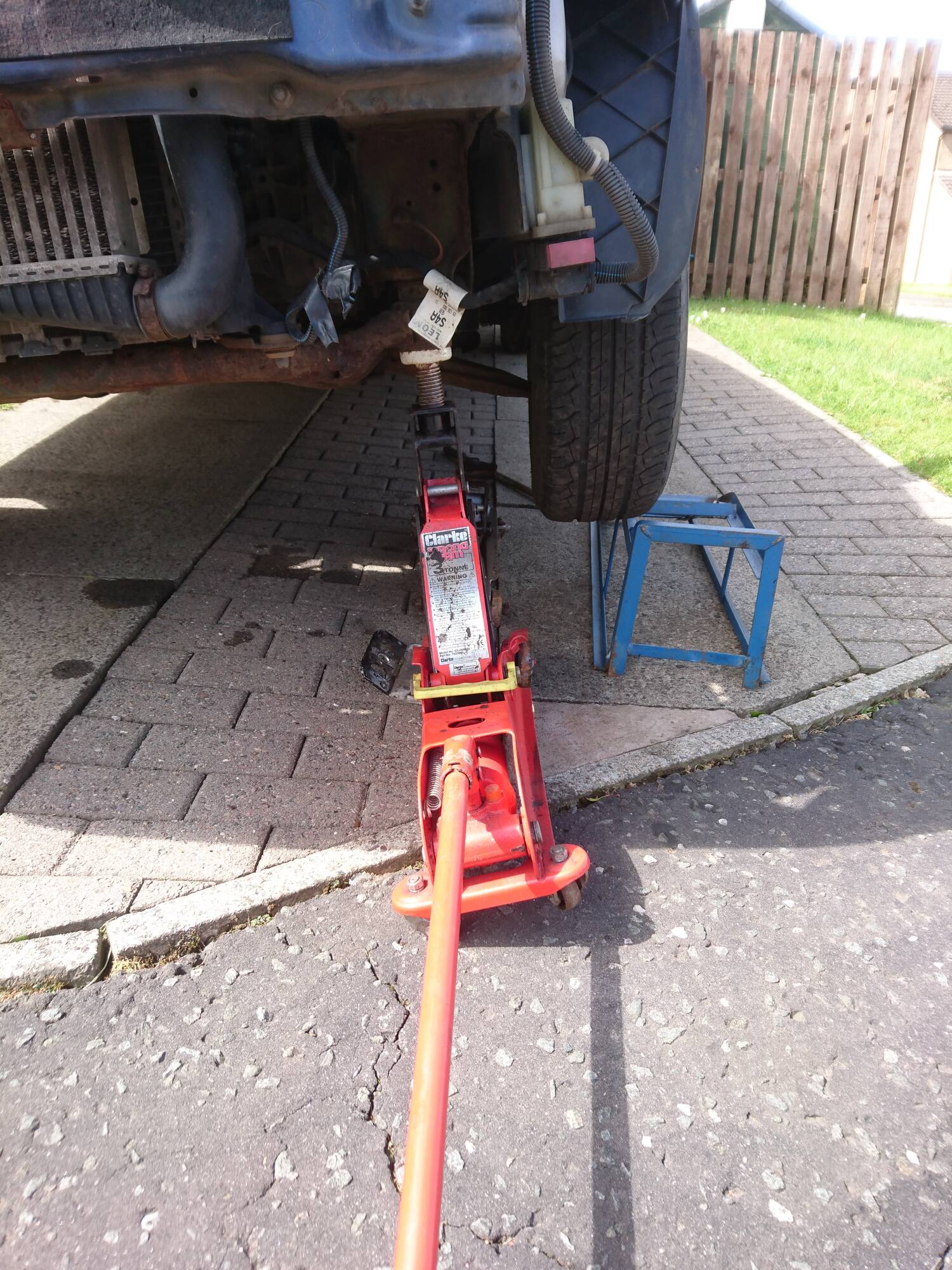

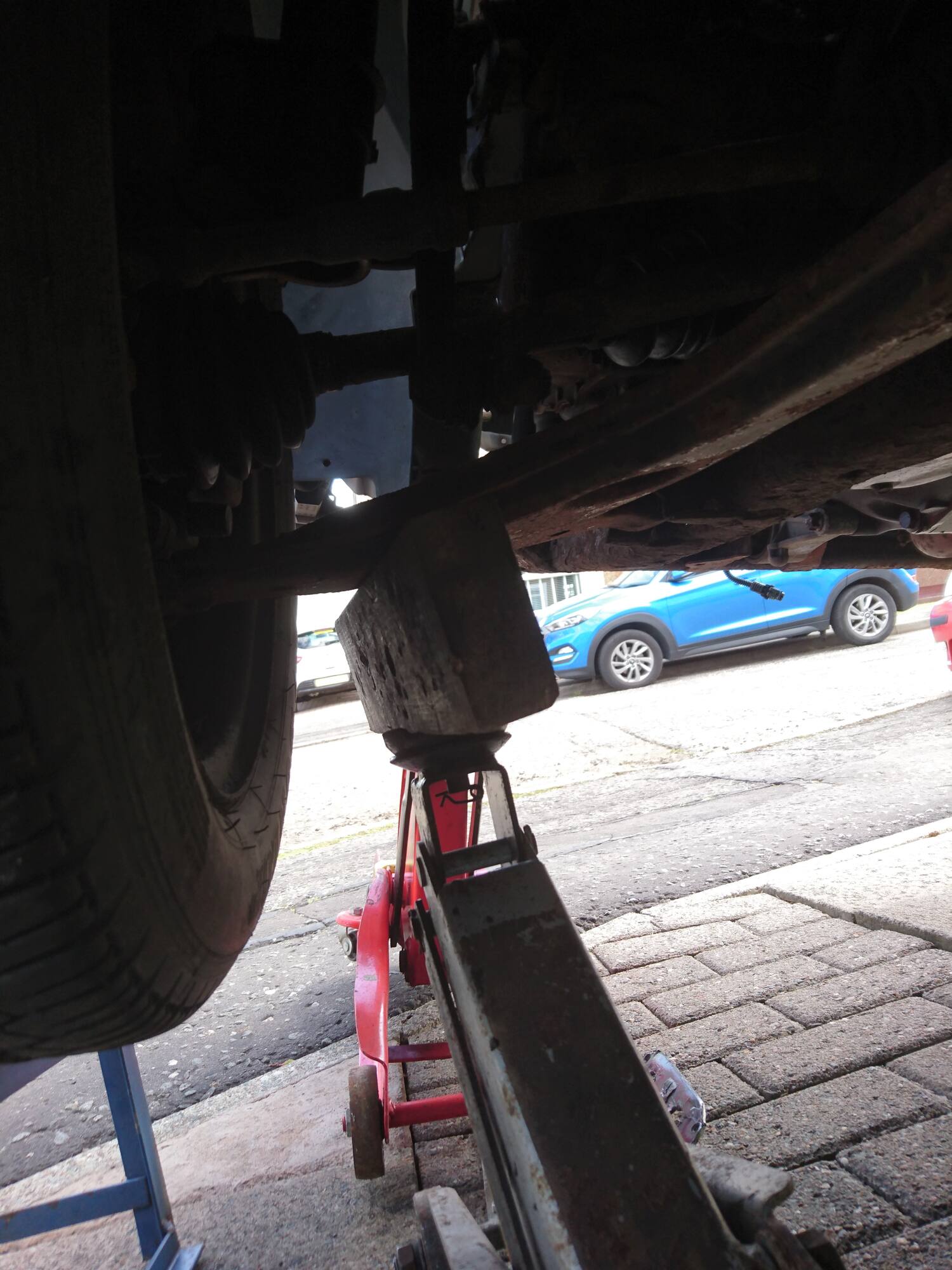

Next jack up up as high as the jack will go and try to ignore the fact that the chassis of the jack is twisting like fuck. If anybody was in need of proof that machine mart tools are just chinese shite with a big price tag then this is it!
Not quite high enough to get the ramp under the wheel so small jack and block of wood deployed under wishbone to compress suspension.
Insert ramp and lower then repeat on the other side.
Now while some of that does look sketchy as fuck I should point out that I did it in a way that if any of the jacks gave way I wouldn't get trapped under the car. As an extra precaution I also lashed the wheels onto the ramps so that even if being in gear, handbrake on and lashed to a concrete ground anchor wasn't enough the car couldn't roll off the ramps.

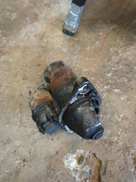

So now it's finally time to do some repairs..............
Starter out
Tested and most definitely dead. Quality used spare ordered from ebay for £19 delivered. The starter was a bit of an oily mess and investigation revealed that there was some oil seepage from the filter housing/oil cooler that sits above the starter. That lot has been removed (sorry no pics) and cleaned up. Three new o-rings and a dowty washer have been ordered for that from a vauxhall spares seller on the bay again for £19 delivered.

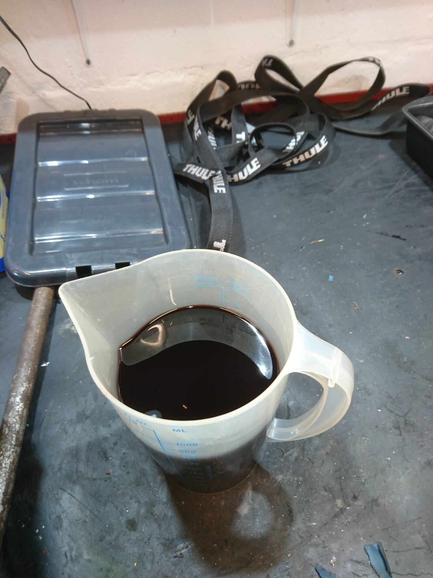

Lastly the previously washed gearbox had now revealed that only one of the driveshaft seals was leaking so one of the ramps was swapped for a stand (ramp and wheel shoved under the car as an extra safety) and the driveshaft was pulled and the seal changed.
Pretty sure gearbox oil isn't meant to look like this though...........
This makes me a little nervous, I just hope this isn't one of those times when a car explodes after its first oil change in a decade as all the sludge taking up the massive tolerances has now been removed!

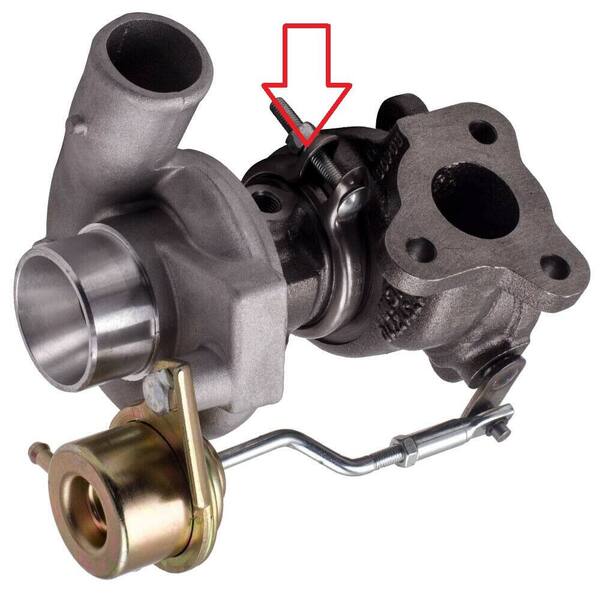

Moar Astra updates.... After a very long wait for parts that was mainly down to Vauxhall Superstore on ebay not dispatching my order rather than Covid reasons eventually everything was on hand to put the car back together.
First up was replacing the missing clamp that should have been holding the hot housing to the core on the turbo. This was a real fun(*) job that had to be done at fingertip only levels of access. It took about an hour to get the clamp on and the bolt in place. This related to picking the dropped clamp up from under the car and starting again about 200 times. Still better than the alternative which was removing the radiator to get better access. One time when under the car trying to find the dropped clamp I found the original one jammed between the cat and the block! Thankfully I didn't have a suitable bolt for the old one so the £9 spent on the new one wasn't wasted money. Looks like the bolt holding the old one on had just rotted out allowing the clamp to fall off.

The jacking and ramps look perfectly fine to me too but that Clarke jack doesn't inspire confidence.
The garage is only that well organised because smoll with many contents.The only way to get it all in is to use every last inch of wall and floor space. If I had the space you have in the unit I'm sure I'd manage to turn it into a complete midden within a week!

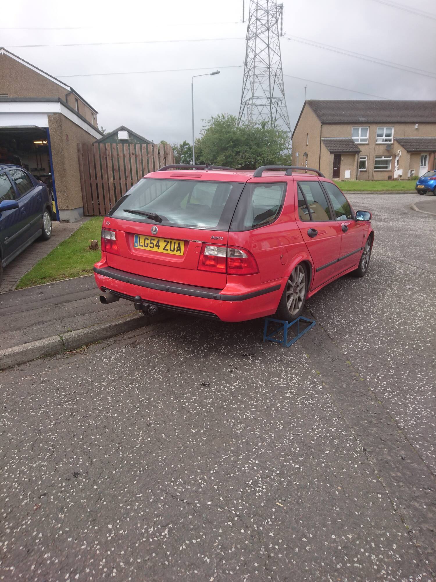

Ok so time to bring the fleet news up to date with a potted history of the Saab from purchase late last year up until the present. For those wow can't be bothered with long updates here's the summary...
9-5 aero, manual, estate, 200k, rough in (many)places, thirsty but fast as fook when you plant the right foot.
So with a little more detail.....
Bought blind from a mate in Edinburgh for cheaps because it needed a gearbox repair and he'd bought a new car. I knew it but actually hadn't seen it in over 18 months so naturally bought it blind on impulse like you do. He'd been quoted £500 for a gearbox rebuild so I agreed purchase and told him to drop it off at garage for repair. I asked them to replace the slave cylinder while it was apart and use their judgement on the clutch as the whole clutch kit is really expensive for these things. Things escalated once apart and it ended up getting a replacement box as the old one was beyond repair. This hiked the bill over £800 as boxes for these are quite rare .....OUCH! Picked it up and first thing I noticed was the clutch bite was very low, immediately got massive buyers remorse about not having driven the car before buying. Checked with mate and found out it's always been like that, never bothered him and he was so used to it didn't even register that he should have mentioned it. Fair play with him but the garage did drive it and should've said something! Giving them the benefit of the doubt though it's an old high mileage and on first impressions totally neglected so they may have just been trying to keep the bill for repairs semi-sane.
TLDR - I paid too much but it's still a fun car to drive and has a years ticket so lets just enjoy it.

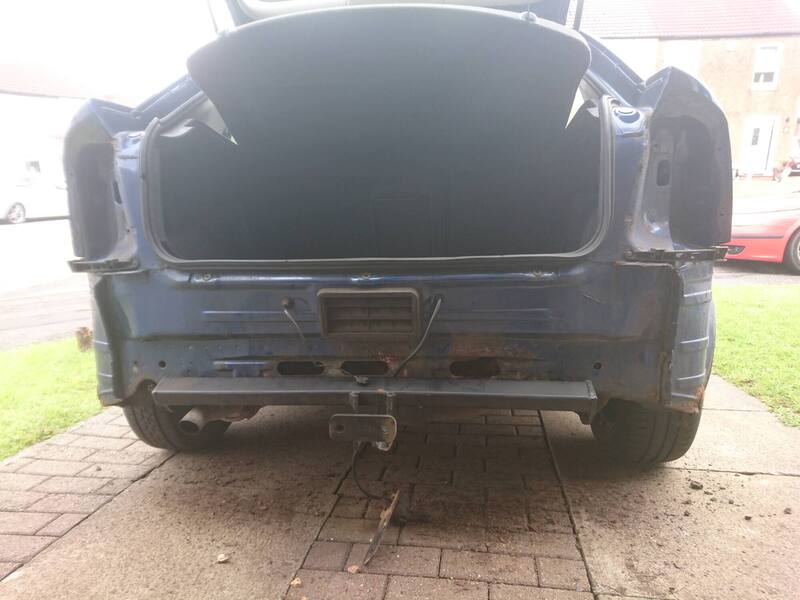

My mate has 2 kids, like the outdoors and doesn't like cleaning cars. First thing was a desperately needed hoover and wipe down inside. This and a look around revealed an interesting past life before my mate bought it. The sea of samco hoses under the bonnet and poly bushes on the suspension meant that somebody in the past was really into this car. The damaged/missing trim and paint/silicone sealer inside the boot indicated that it had also been used as a decorators wagon or by somebody doing a house renovation.
First up for tinkering was the boot interior. I ripped most of the trim out for cleaning (inside house because Scottish winter) and set about fixing the tail end neglect.
First up was a complete rewire of the (non functioning) towbar wiring and ripping out and binning the Chinese reversing sensors that were hanging out.
Much better, the holes in the bumper were filled with blanking grommets even though it looks like they aren't in the pic.

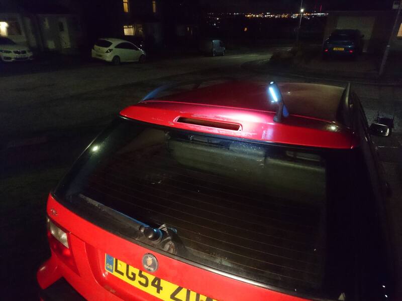

High level brake light was glued together from about 15 broken pieces then held in place with bathroom sealant. It decided to make a bid for freedom en-route to scotoshite one winters evening neccesitating an emergency stop to buy parcel tape to keep the boot from flooding. Why people do this amount of effort to repair things badly is beyond me when you can buy a fully functioning part for not much money on ebay. Ebay part fitted and happiness restored.

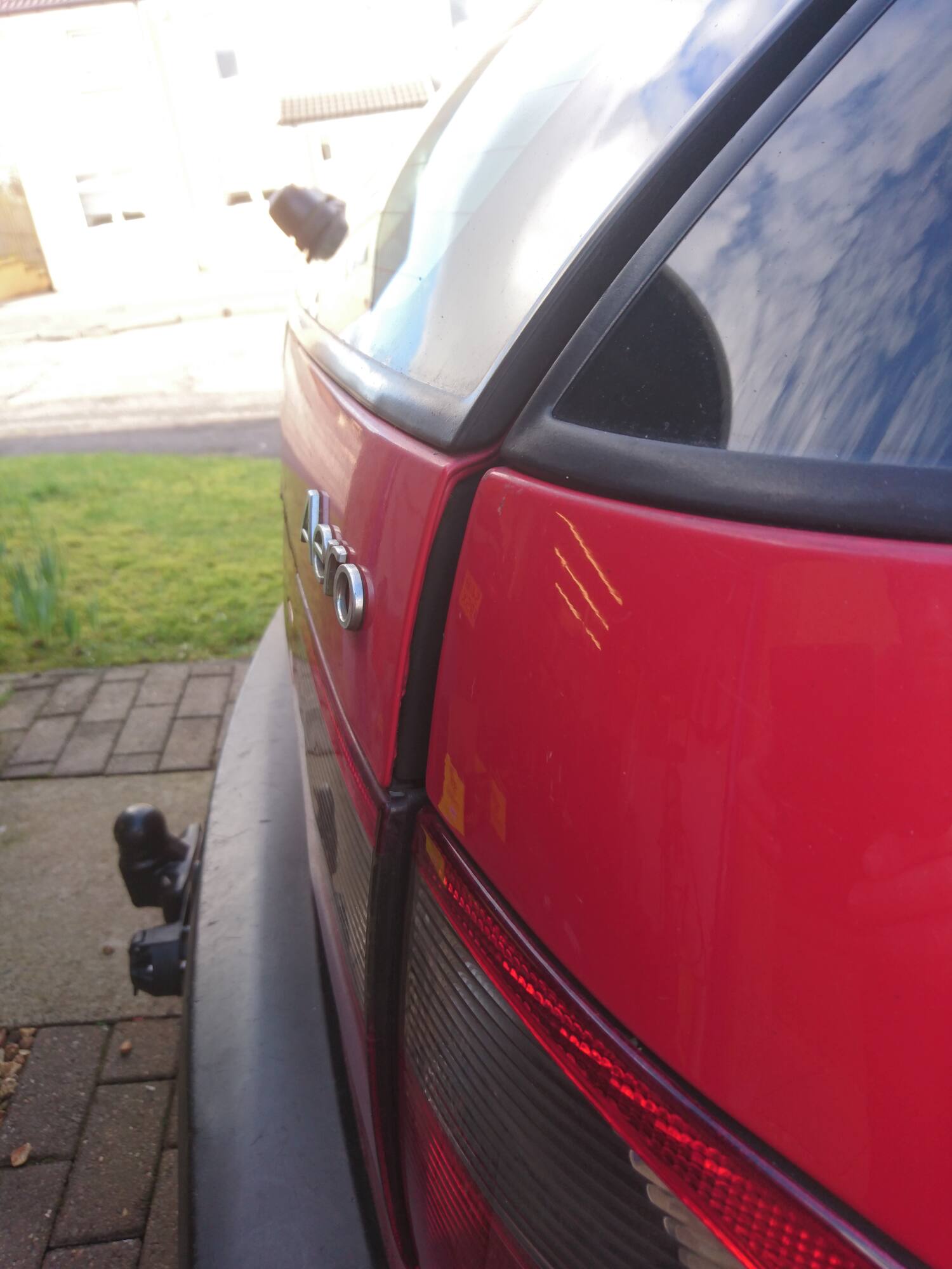

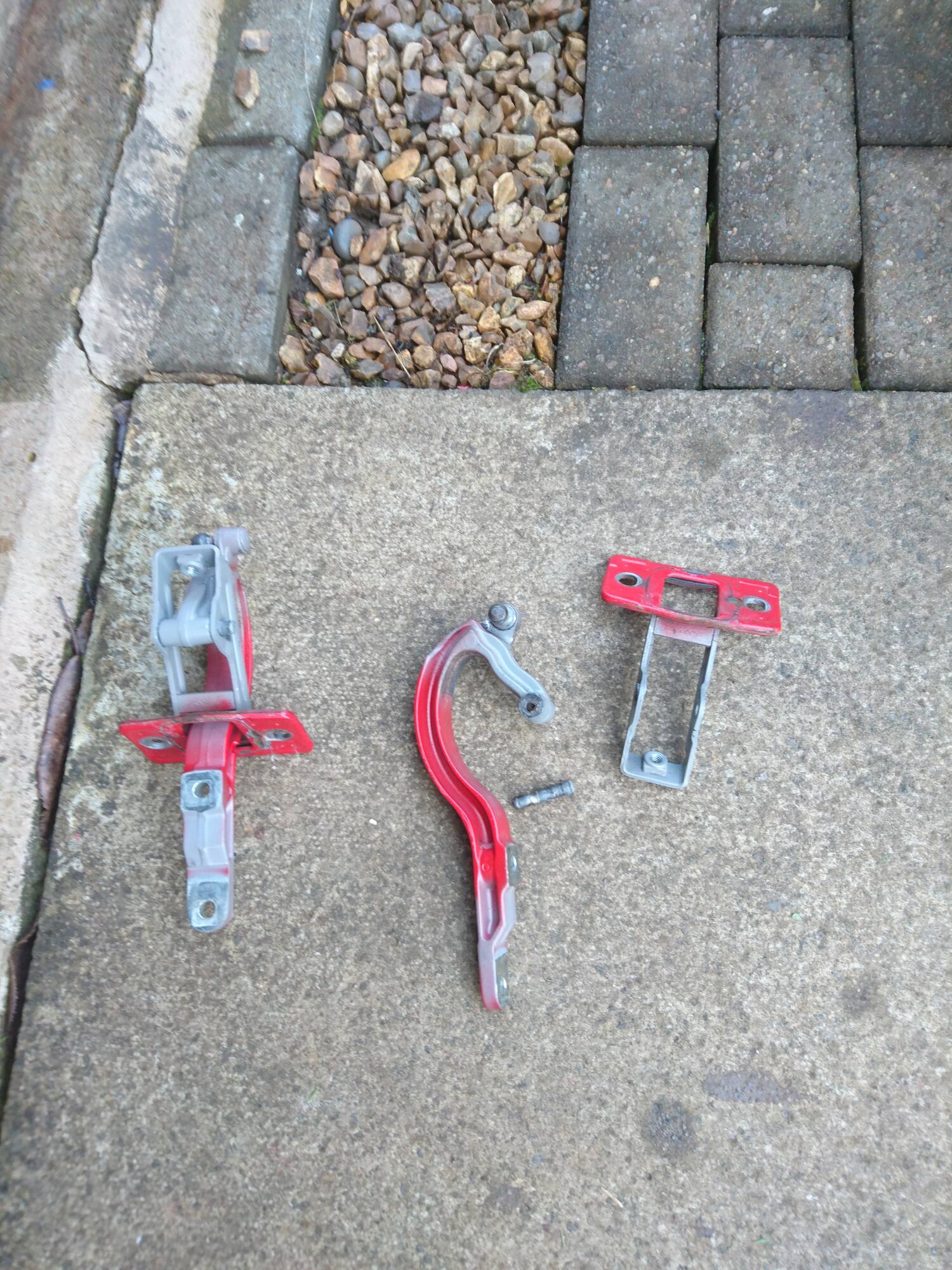

Talking of the tailgate, it never fitted properly and made all sorts of interesting noises opening and closing. Check this out for a funky level of alignment.
I was fairly certain I knew what the issue was so ordered an set of good used hinges prior to investigations. Sure enough when they were swapped out here's what the old ones looked like.
Only the pressure of the gas struts was stopping the RHS one falling apart on the car. Changing these is a complete pain as it involves dropping the headlining as the gas struts for the tailgate live up inside the roof.

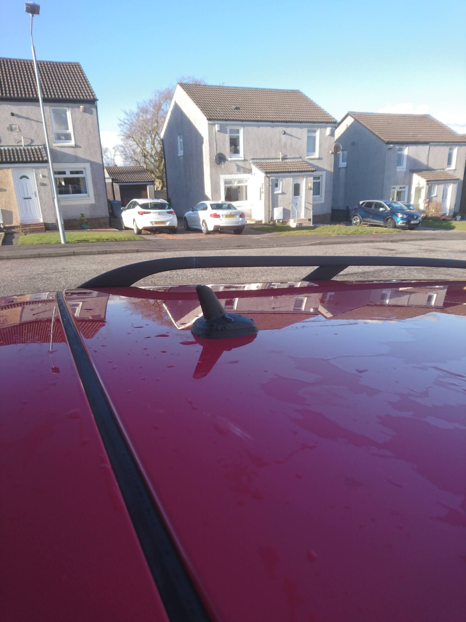

Before refitting the interior only one thing was left to do and that was fit a new sharks-fin aerial.
One of the (many) previous owners had decided that removing the original and  filling the hole left behind with duct tape and bathroom sealant was a GR9 idea. This is a cheapy of ebay and does the job of keeping rain from getting into the car.  Most importantly it was the last thing that needed doing before the interior could go back together.

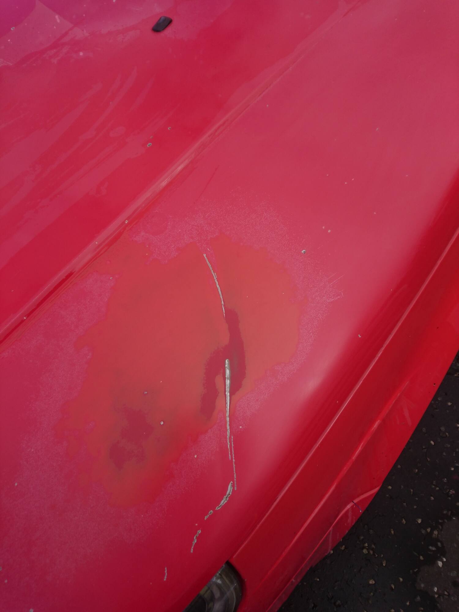

Next up was to evaluate what could be done with some of the dodgy paintwork. The front bumper and wings had dreadful lacquer peel all over them. A patio cleaning lance on the power washer actually managed to remove all the remaining lacquer in big sheets leaving an even if slightly satin paint finish. A vast improvement although I'm still undecided ast to whether I should try T-cut and polish on whats left or wet sand with 1200 and then hit it with rattle can lacquer. For now doing nothing is the preferred option.
The bonnet is totally farcked paint wise. I did try a little gentle wet sanding in the hope I could cut through the lacquer to decent paint but no chance, nothing short of a respray will sort this.
Before......
After

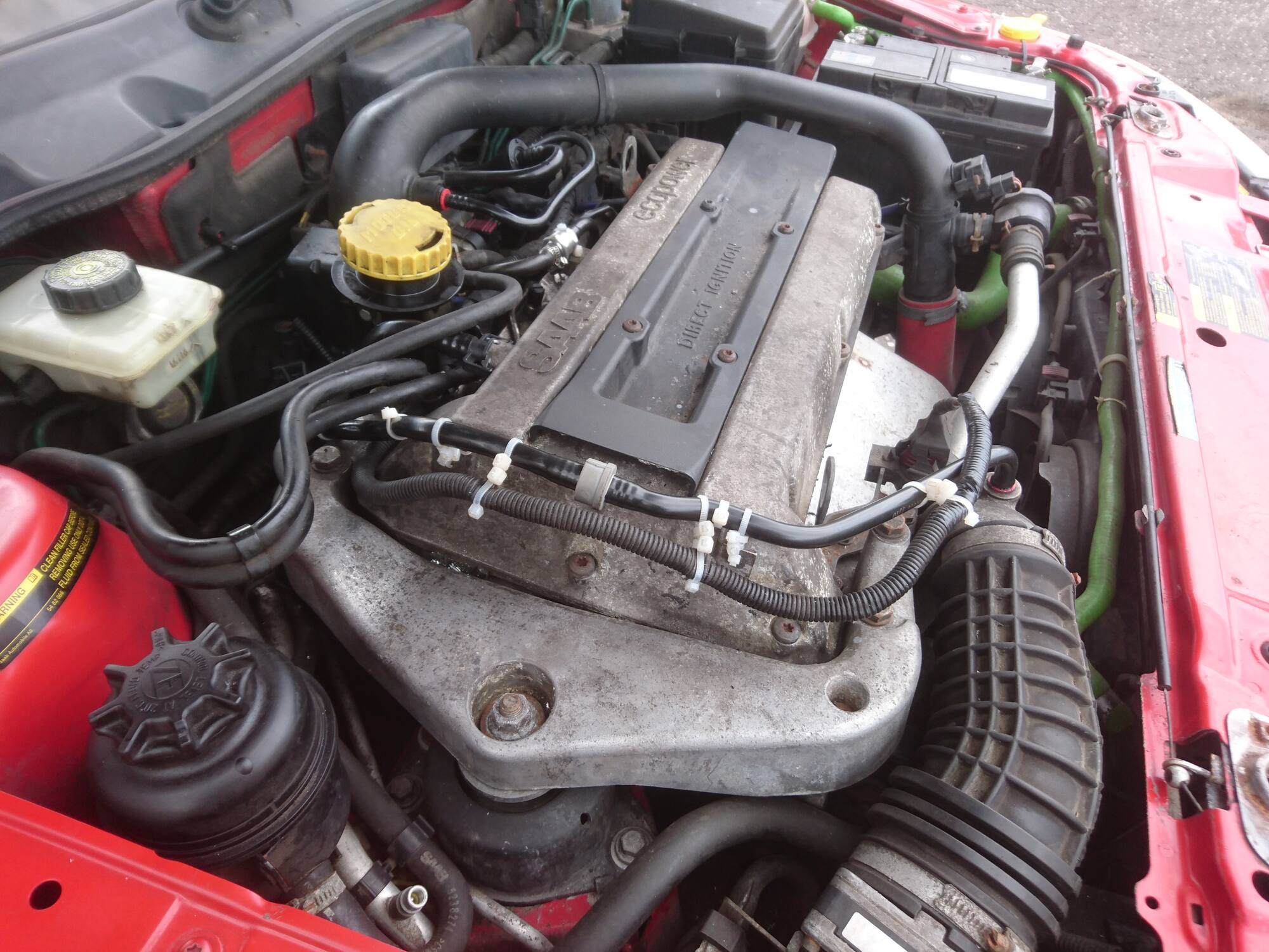

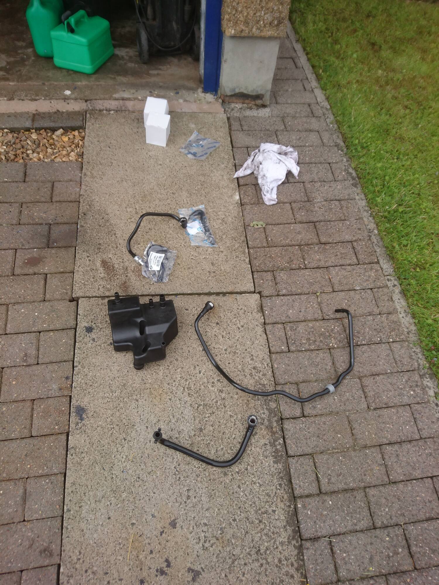

Many moons ago it was pointed out that one of the PCV lines was loose where it connected into the turbo outlet pipe and would have been a cause of a boost leak. Further inspection revealed most of the PCV pipework was a bit of a home brewed mess.
There have been so many versions of the PCV system on this engine the easiest thing to do was but the whole "final version" kit from the aptly named Parts for Saabs. £65 gets you the complete system which I think is pretty good value for 3 hard lines with valves and quick connects, 2 rubber hoses, 4 hose clips and a new seperator tank.
As the back of the engine was very oily and it used a lot of oil when thrashed I'm hoping this will take care of a few issues. First things first, get it up on the ramps for the first time in almost 9 months of ownership.
A very long low nose necessitated the use of many blocks to help clear onto the ramps.
Made it with just enough room under the car to work in. Second ramp put under the sill just to make sure I don't get squished if something went wrong.
I was really hoping to get away without changing the catch tank as its a real pain to get to but alas no. Looks like I had the second to last version of that part. Side by side you can see that the top right fitting has changed from barbed to quick connect.
Viewed from underneath here it is in situ underneath the inlet manifold between the starter and alternator.
Up top all the clips for holding the pipework in place were long gone. There are however three very useful alloy tabs on the rocker cover. Drilling a 5mm hole in each of these gave good anchor points for a slightly complicated cable tie setup that holds everything in place but also prevents anything from rubbing when the engine is running.
While it was up in the air I took the opportunity to change the oil and filter before going for a test drive.

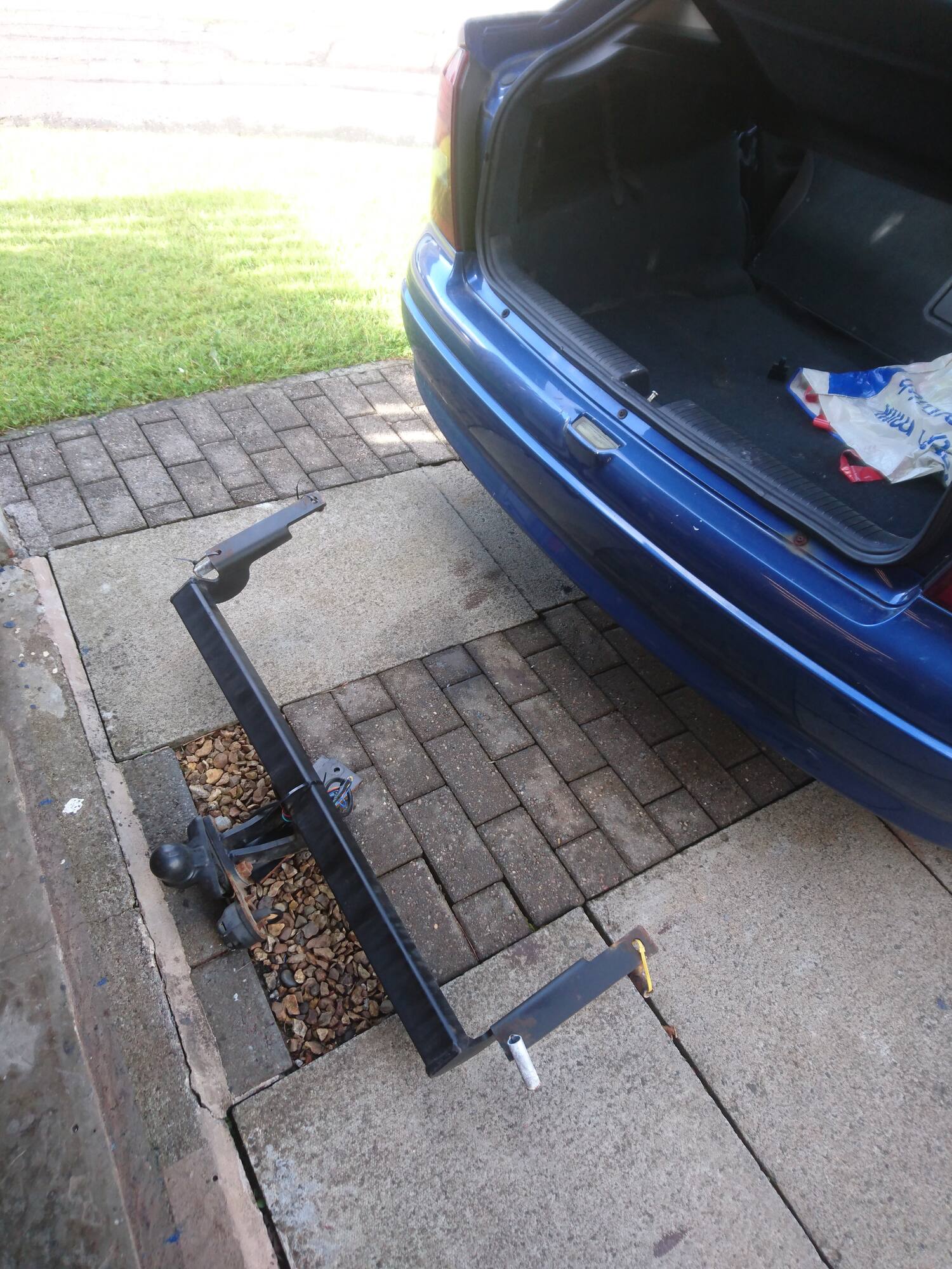

Bit of a bargain from facebook marketplace today. Complete towbar kit for the Astra for £20. Just needs 4 new bolts to fit it. Hardly any corrosion at all so it looks like it was only ever on a car for a couple of months.

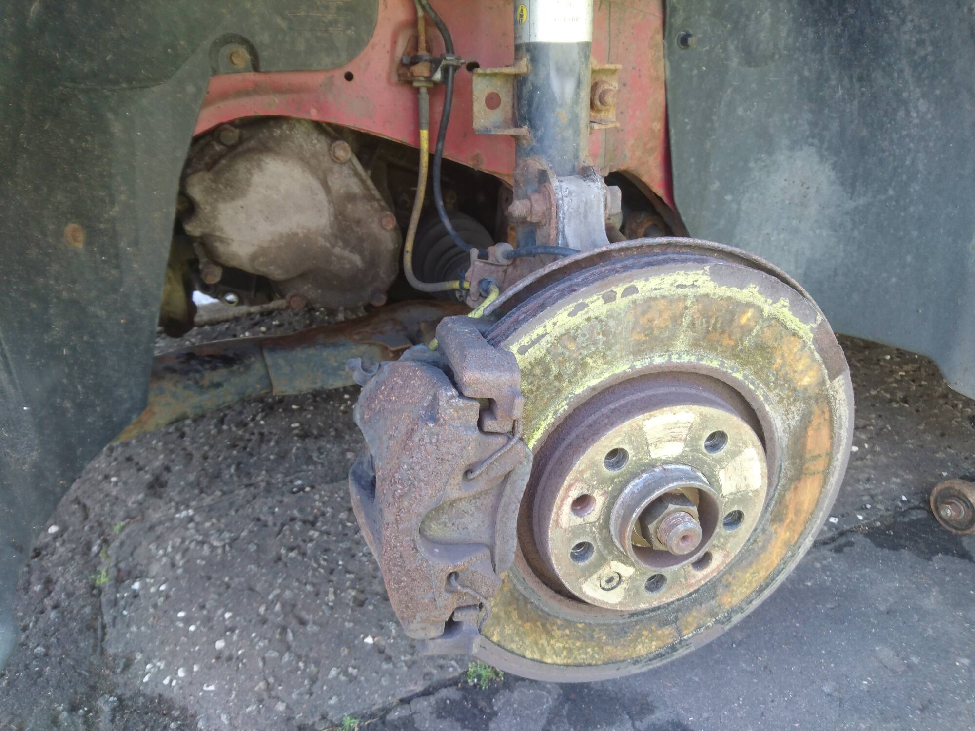

More Saab loving today, wheels off at the front to take a look at MOT advisories from before I bought the car. Front discs scored and greased brake pipes.
Yes indeed scored discs and I'll bet this was rubbed down and greased for the last ticket.
A real fall from grace for a once loved car. Braided hoses connected to rotten hard lines. It was obviously someones pride and joy at one time.
Caliper sliders and pistons were nice and free which made getting these sad looking pads up nice and easy.
A quick trip to ECP in Glasgow got a set of Eicher pads from stock for £16 with the usual DFS sale must end soon sale code.

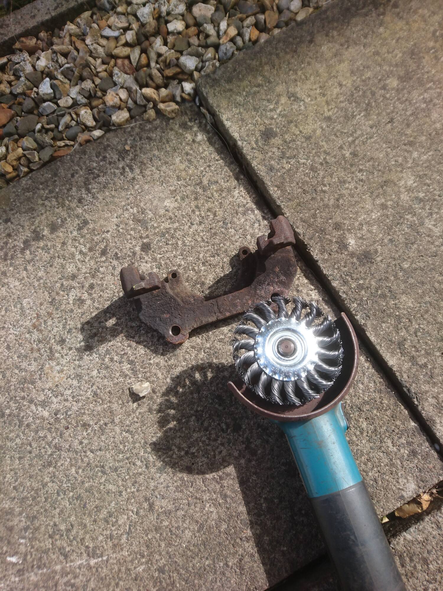

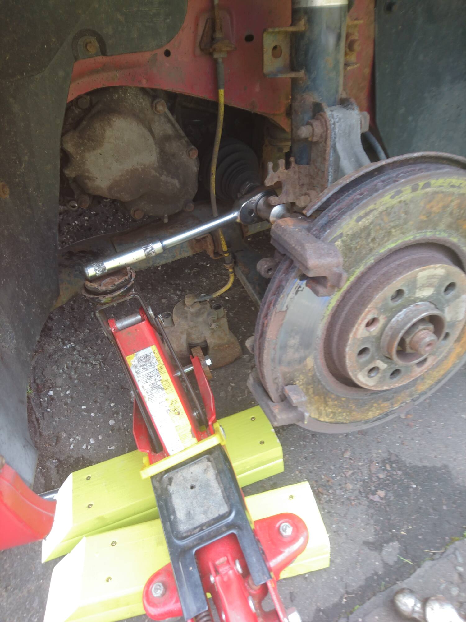

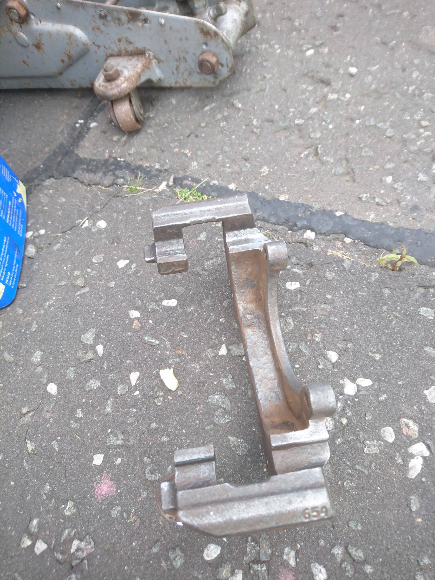

Carrier bolts were a pain with no access for the dugga dugga gun unless I dismantled half the suspension so a trolley jack was deployed to add some leverage to the ratchet to break them loose.
Carrier off and the knot wheel was deployed to turn this
Into this
Those of a nervous disposition should probably look away now...........

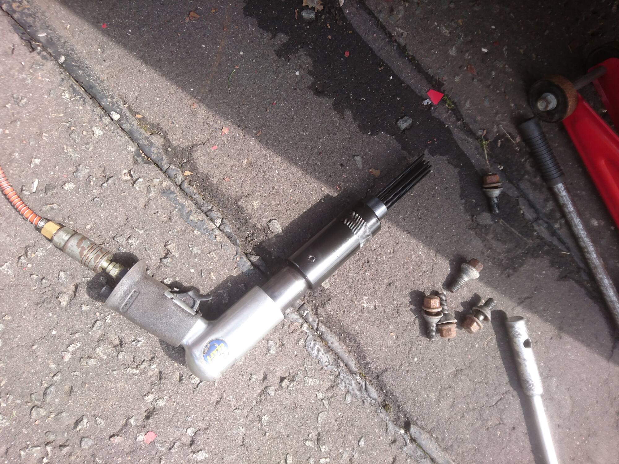

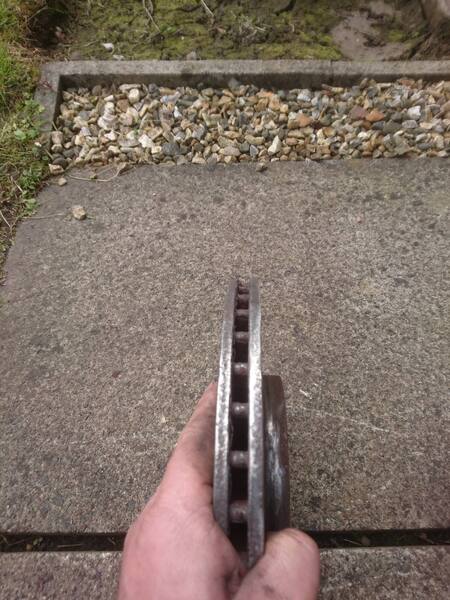

Disc off and time for some redneck disk skimming.
After knocking the flakes off with a hammer a 40 grit flap wheel will take all the loose flakey ridges back to an even surface. The flap disc is rough enough to take the flakes off but not tough enough to dig into good metal. Not quite as good as new but 100% better.
And still plenty thick enough

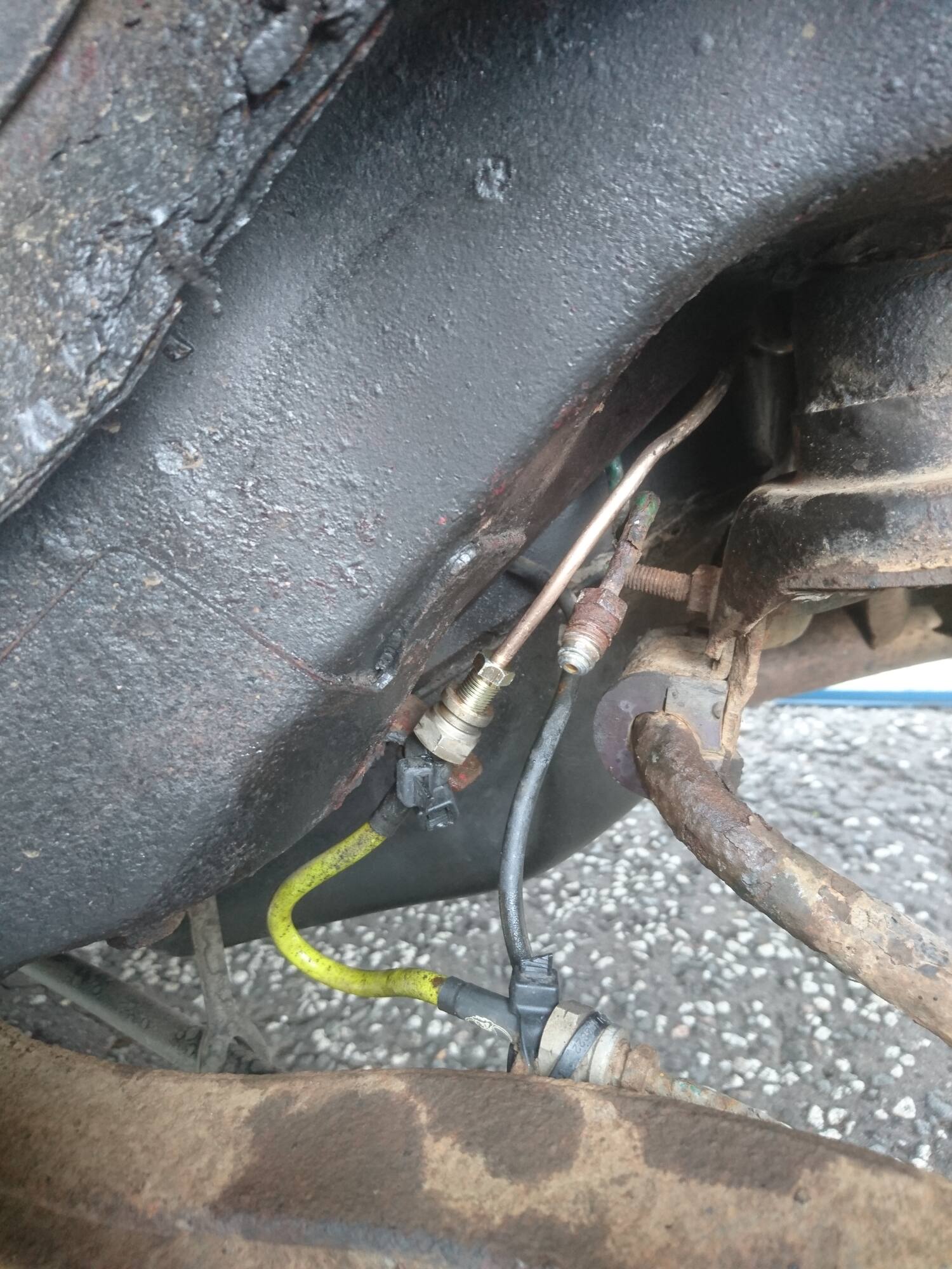

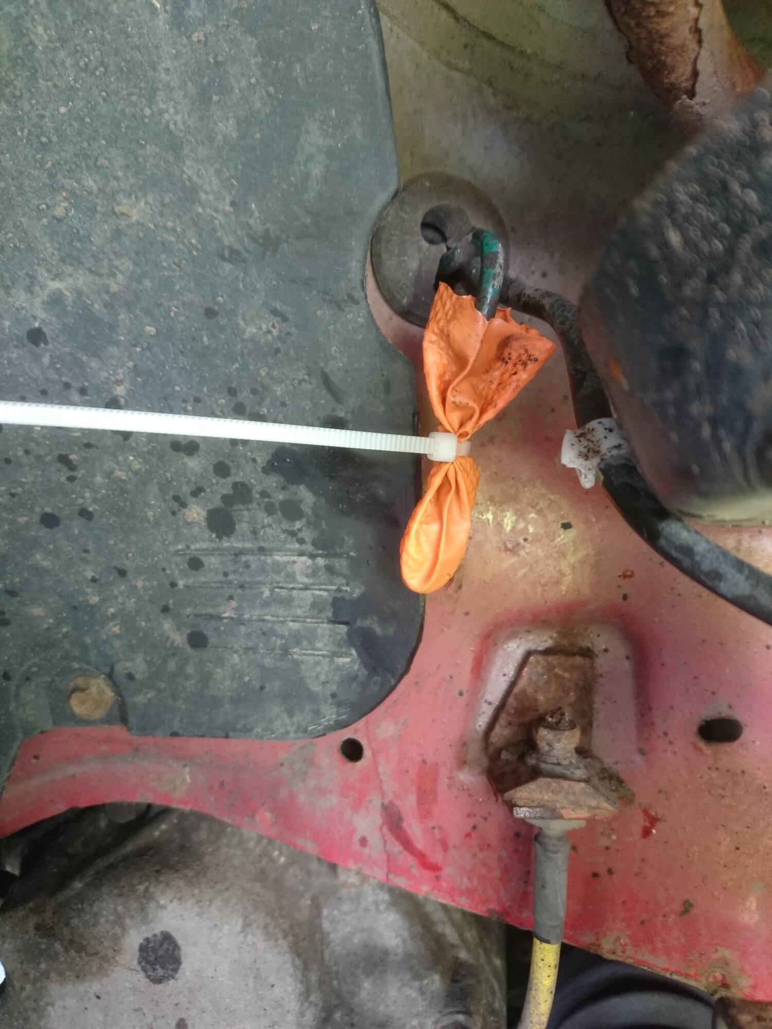

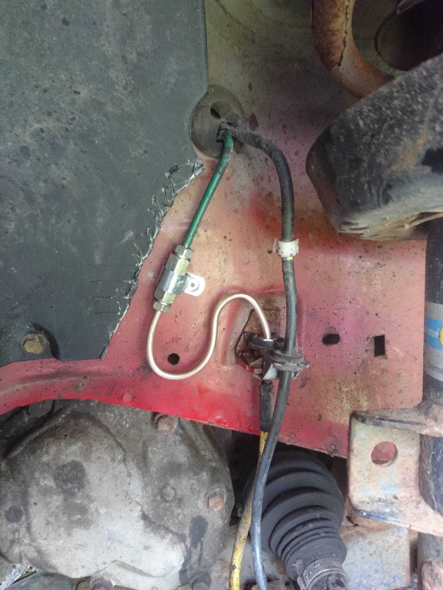

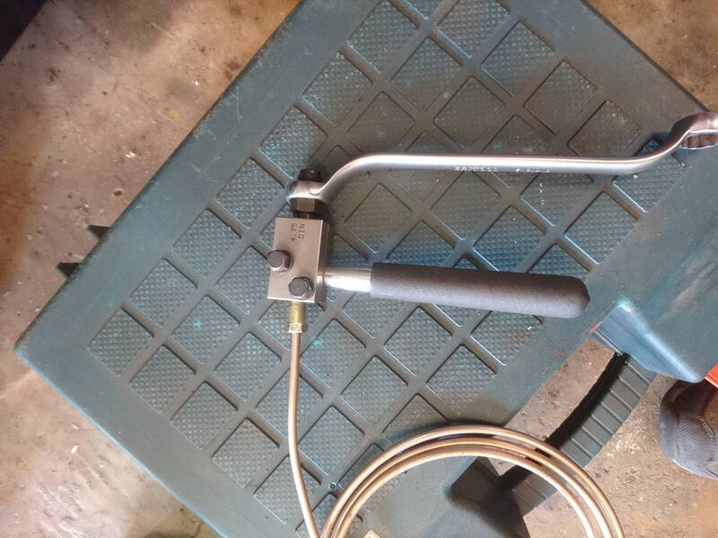

With disc and caliper back on it was time to cut the rot out the brake line and splice in a repair section.
First cut back to solid and use a glove finger and cable tie to stop fluid leaking everywhere.
Why anybody would risk damaging a rubber flexi with a line clamp when this is just as effective is a mystery to me.
Next deploy the worlds best flaring tool, without which this job would be a nightmare. Equally at home flaring steel as well as copper and can fit into relatively tight spaces on the car.
End result after trimming back the arch liner a bit so I could pop rivet a p-clip on to secure the joiner to the inner wing. Really makes that "look I really care Mr MOT tester" statement!

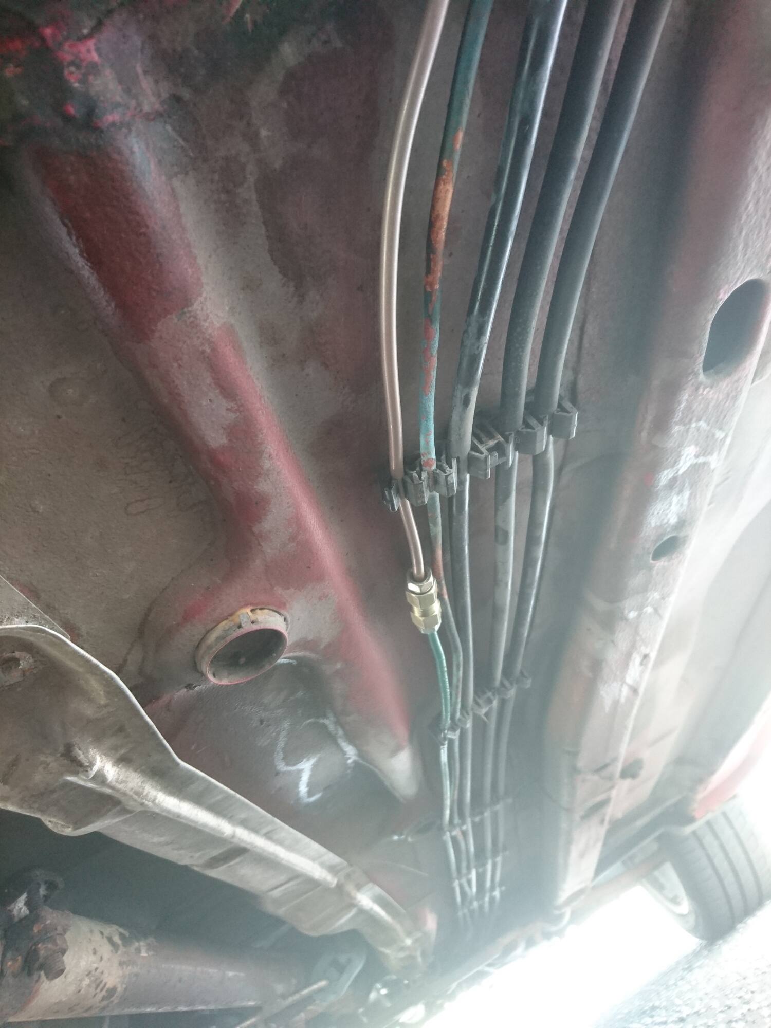

Next up is a look at the rear brakes in search of more line grot.

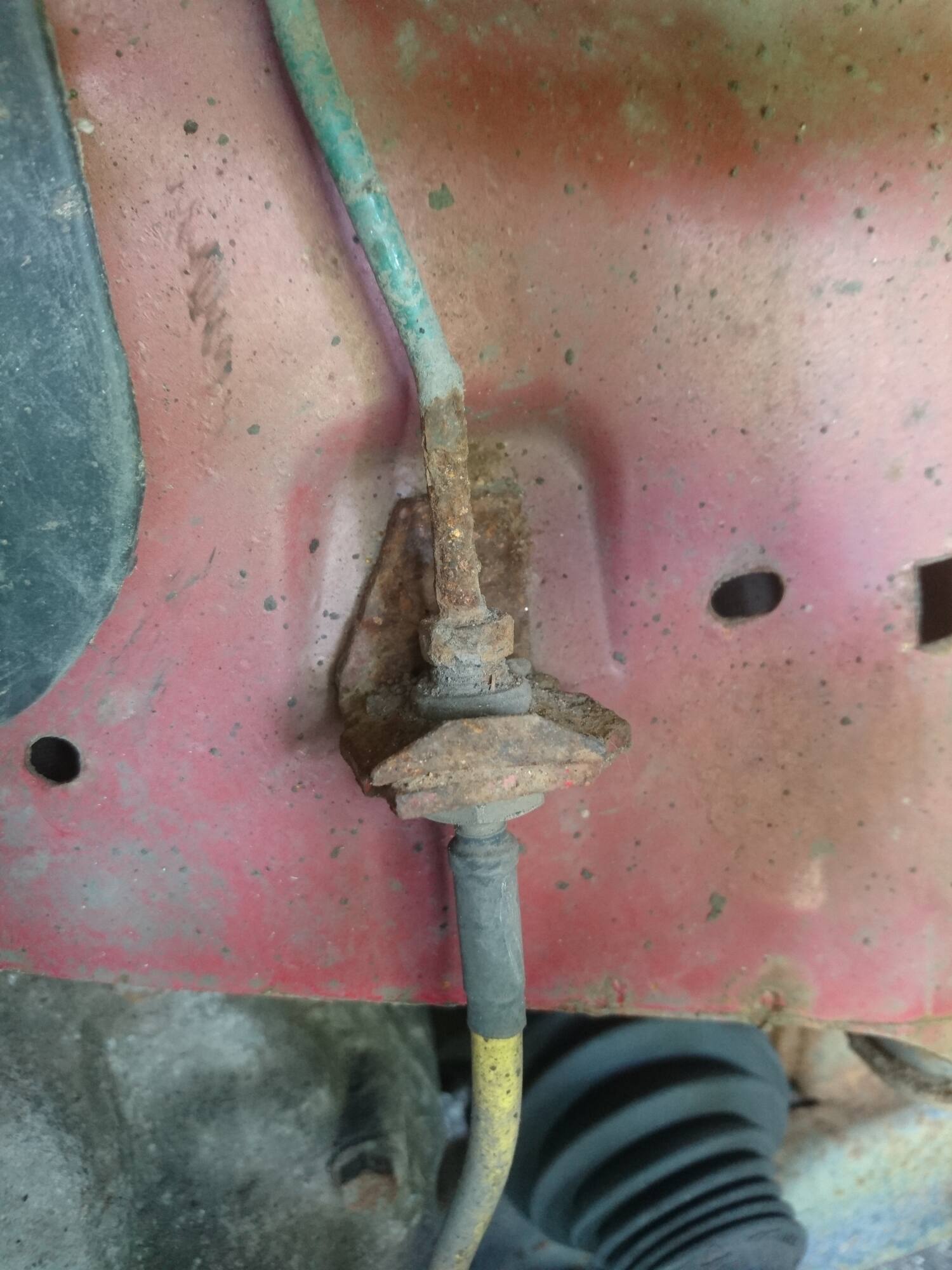

So on Thursday I took a look at the rear brakes. Discs, calipers, pads and O/S line all ok.
N/S line oh dear..........
This is a stinker as the rot extends right up to the point the line dissapears on it's journey over the top of the fuel tank! It's going to be a swine to replace as I'll meed to re-route across the subframe so there'll be lots of drilling holes and pop riveting on p-clips. Job put off as I've had to order another roll of line from ebay as nobody local had Kunifer line in  stock and I prefer that to copper.

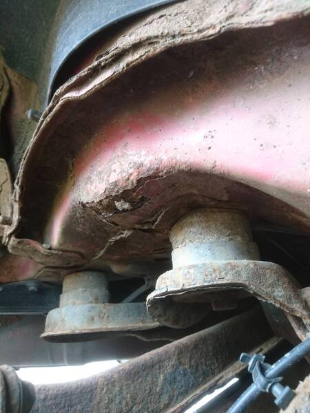

While we have the rear wheels off, whats this........?
Can't beet a bit of galloping rot around the subframe mounts to cheer up your day! In a "death or glory" moment of clarity I thought that if there's holes there I'm fucked if I'm welding them so I'll frag the old heap come MOT time. If that's the case I won't have to bother doing that brake line.
Having now convinced myself I was actually in a win-win situation I broke out the heavy artiliary and shouting Banzai, pulled the trigger on the needle gun and thrust it towards the rot for all I was worth.

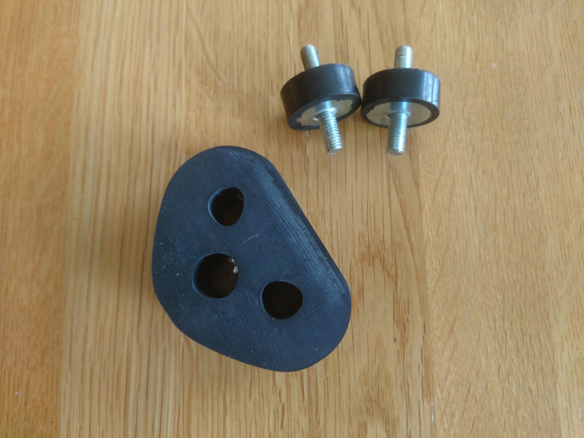

Exhaust mount to replace the misding one on the downpipe and two universal cotton reel mounts to replace the snapped ones on the power steering cooler.
This made me question my own levels of OCD. I'm not sure what annoyed me more. The fact that somebody couldn't be bothered to buy a pair of £5 mounts to do the job properly or the fact that when they tied it all back together with a dozen cable ties they couldn't even be arsed to cut the tails off the ties!
Now waiting on delivery of new line before the final push towards the end of MOT prep on the old barge.

Just noticed the pic without any comment......
The last pic is one of my quality*  ebay ramp extensions. Now in the scrap pile after becoming a banana when used as instructed. Going back to using blocks of wood, much safer indeed!
Another good update, shame about the brake line but at least the scabby bit didn't turn into a hole, always a quick win!
In terms of the brake pipes here is a terrible picture which shows the replacement pipes on my car where it runs past the petrol filter. The pipe to the n/s runs along and is clipped to the bottom lip of the subframe.
Yesterday I had a spare afternoon so decided to stick the newly aquired towbar on the astra.
First of all was the hardest part of the whole job, getting the bumper off. Some of the rusty 16 year old fasteners put up a bit of a fight. DSC_9453.thumb.JPG.f5bf46cb93971219c091ab3d193ced70.JPG
Closing panel was a bit crispy but after cleaning up that and the back end of the chassis legs with the needle scaler to allow the towbar to sit flat there was still enough metal there to satisfy an MOT tester so it was left as is.
Holes were drilled in the boot floor and then the bar was bolted up into position.
Before the garage collection of assorted self tappers and trim clips was raided to assist to secure the bumper back in place.

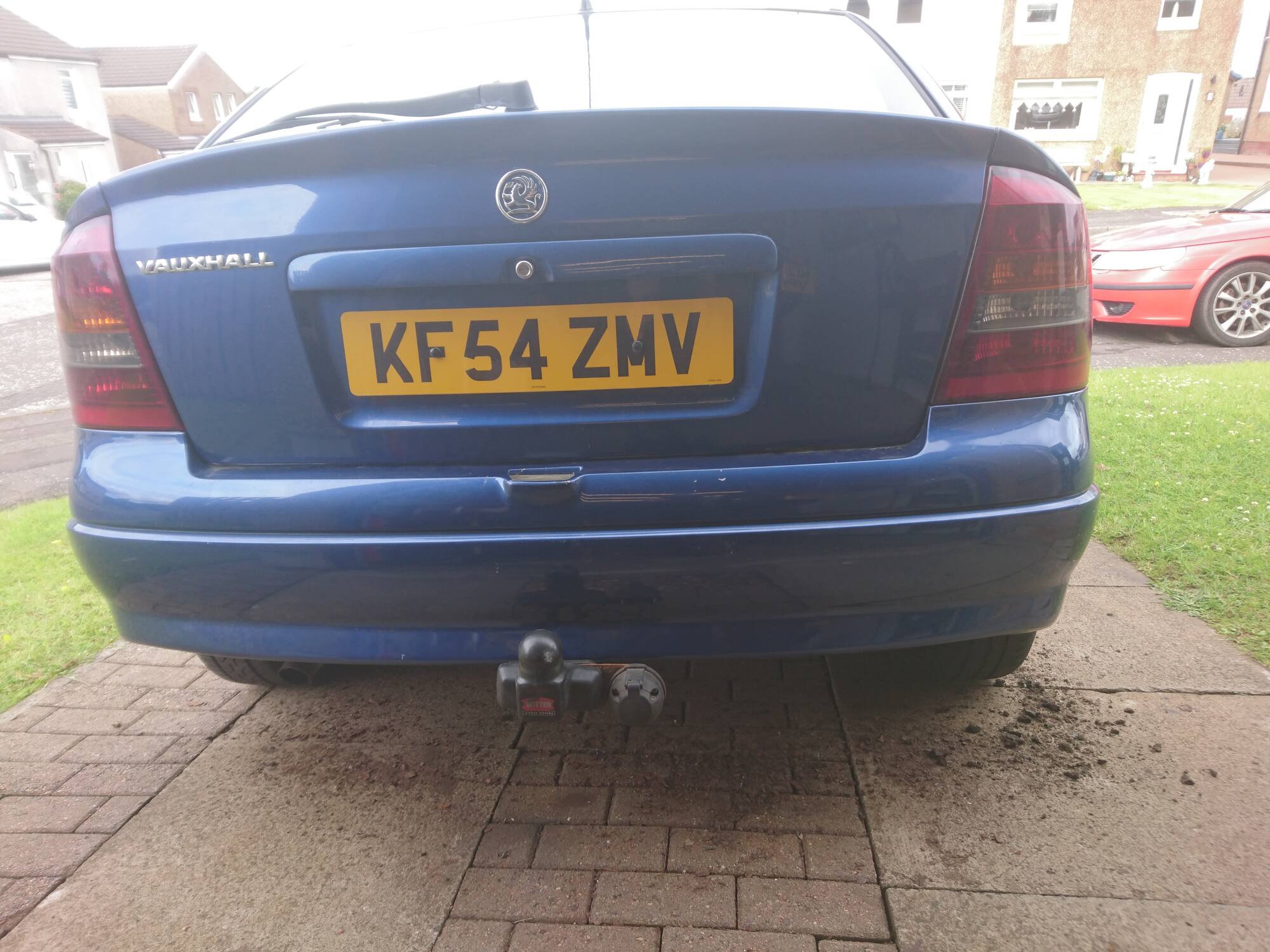

Just the wiring to do but I'm waiting on an indicator buzzer to be delivered before I can do that.
One last job for the day was to get the power washer out to clean this little lot off the drive!

Bit of work on the Saab again yesterday. Clearance at the back is a bit better than the front and a ramp will fit under the back bumper with 1/4" clearance which avoids the need to build a ramp extension out of wood to get the car in the air. Not much clearance underneath but enough to get the job done.
First order of the day was to replace the NSR brake line. Closer inspection revealed that the line didn't run above the fuel tank but above the subframe. This made it a whole lot easier than expected to get the new pipe in place. Cut back the line and spliced into good steel line here...
Then round the top of the subframe following the old line to here...
The old line was left in place but the ends trimmed back which allowed me to cable tie the new line to the old to keep it secure where access was really bad above the subframe. Bled that corner and we're good to go again.

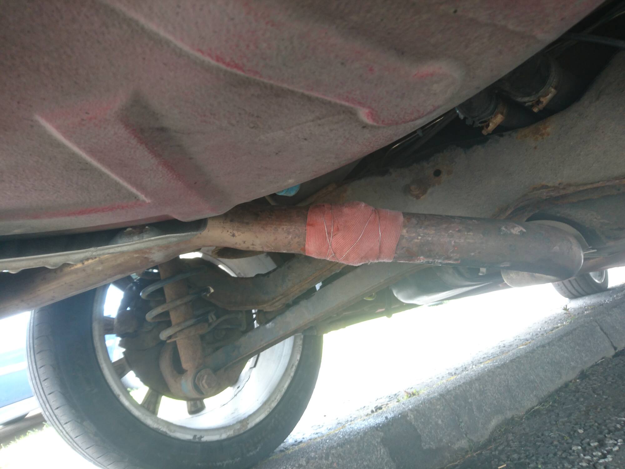

While under the car I had a look at another item off the last MOT advisory list, minor leak from exhaust.
Sure enough, pin holes in the welded join in the home made exhaust. It's structurally solid but the welding looks like somebody has launched pigeon shit at the general area with a catapult. The thought of lying on my back trying to seal up that mess 6" from my face with the welder didn't have my heart racing with anticipation if I'm honest. Instead I forked out £2.99 on a product I've not used in about 25 years.
One exhaust bandage later and we're good to go.
I did find one other exhaust mounting rubber that was perished and will be replaced when the £2.50 replacement arrives in the post but generally that concludes the cars pre MOT once over.
Don't hold your breath though it's 10 weeks till the due date so it'll likely be 6 weeks before it gets done at the start of the 13 month window.
Good progress. Hope this car sees a few more MOTs. I think rot killed my old one in the end?
I could see that being the case. As well as the crispy bits shown above the back end of both sills are really thick with surface rust even though other parts of the underside are pristine. I'm pretty certain everything is solid but I'm leaving things as is for now just in case the tester spots something that I've missed. It's unlikely but I'd rather not be scraping off fresh stonechip in 6 weeks time just to weld on a small patch!
