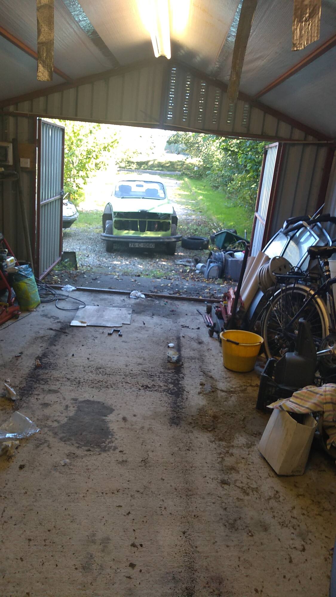

The first time the car has moved out of the shed for about 3 years,and it was last on the road about 2010.I removed and stripped the front wings last year,and put a coat of primer on them,but then lost momentum.
After a couple of hours the car looked like this.I removed the rest of the lights,both bumpers,the boot lock and handle and the front panel.Next,both back wings have to come off and the rest of the trims and badges.After a few welding repairs hopefully it can be painted so that all the body is the same colour again.

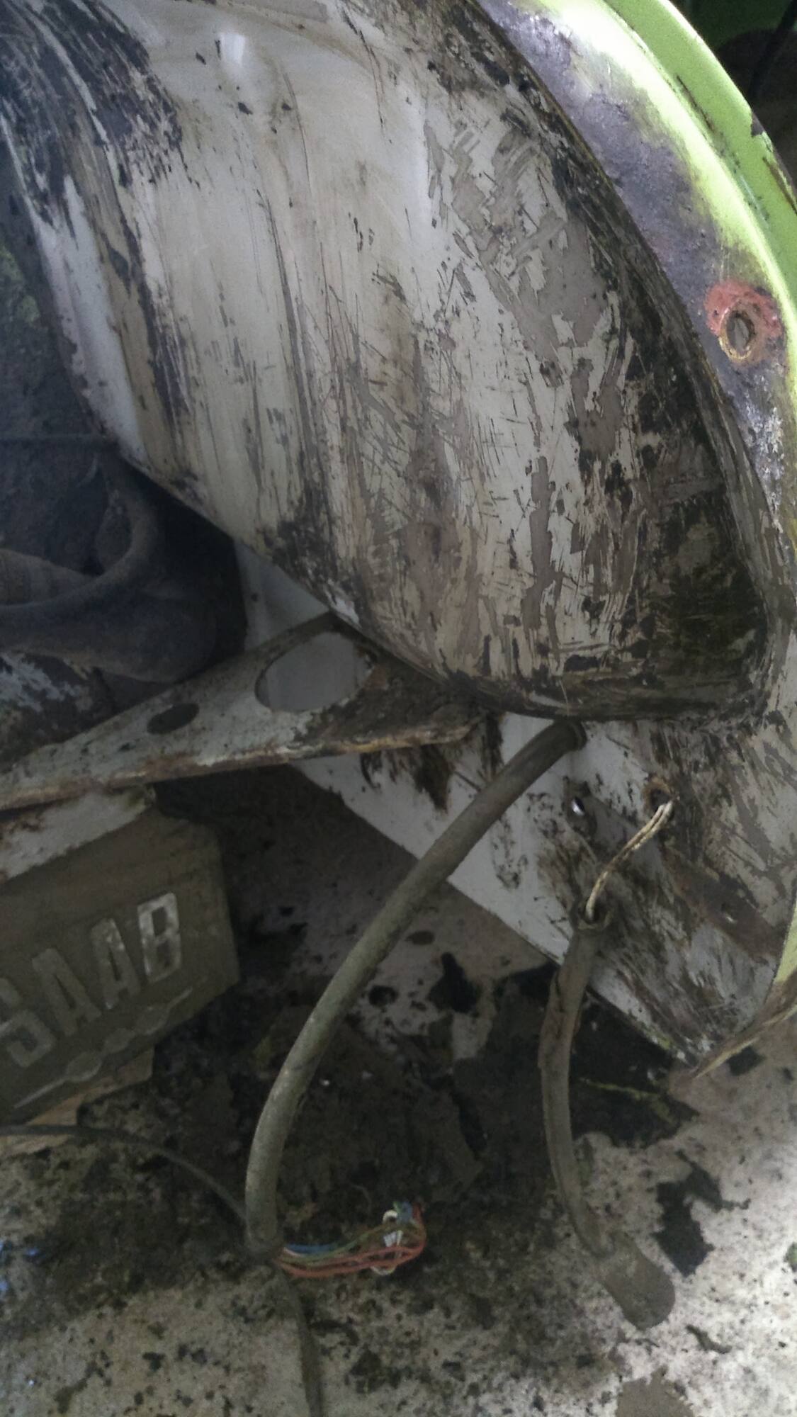

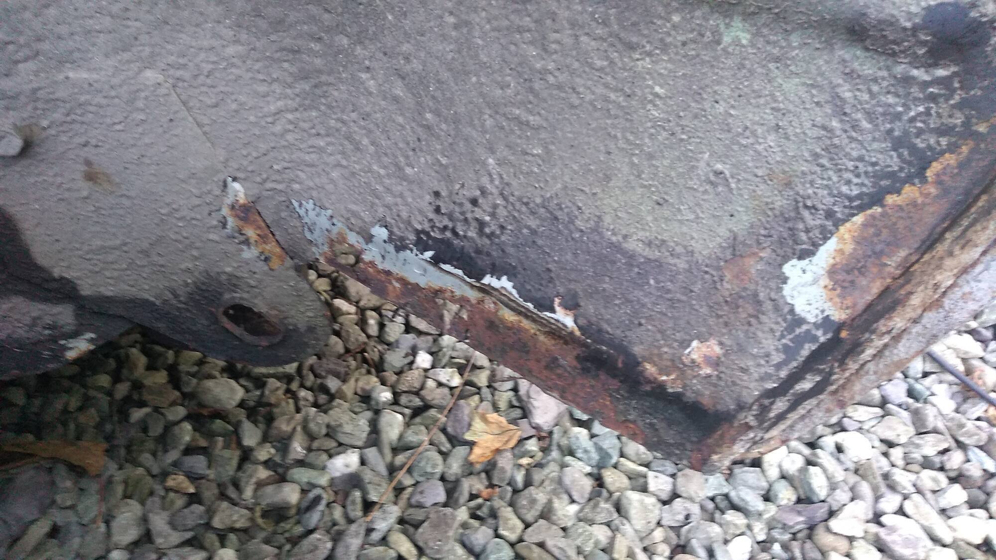

The underneath looked fairly awful with lots of flaking underseal and surface rust.Amazingly though,it seems to be all solid,except for a strip on the bottom of the r/h inner wing,and the area in the second photo,which is the bottom of the rear quarter panel.Also,there are some small areas of rust on the boot surround,and the two brackets that hold the small mud flaps in front of the back wheels need replacing.

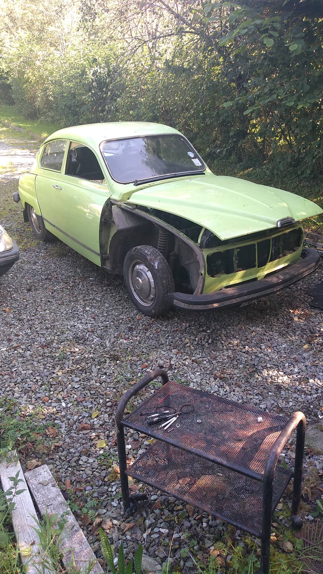

So that's it for now.I'll leave you with this pic of the front end as it is now.

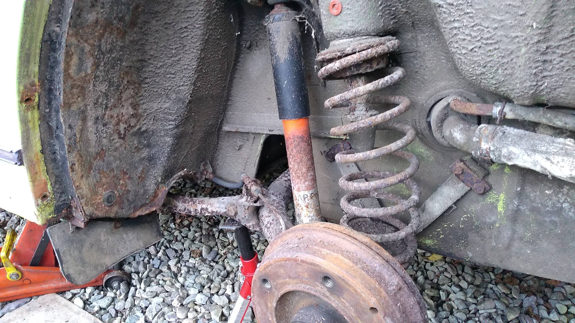

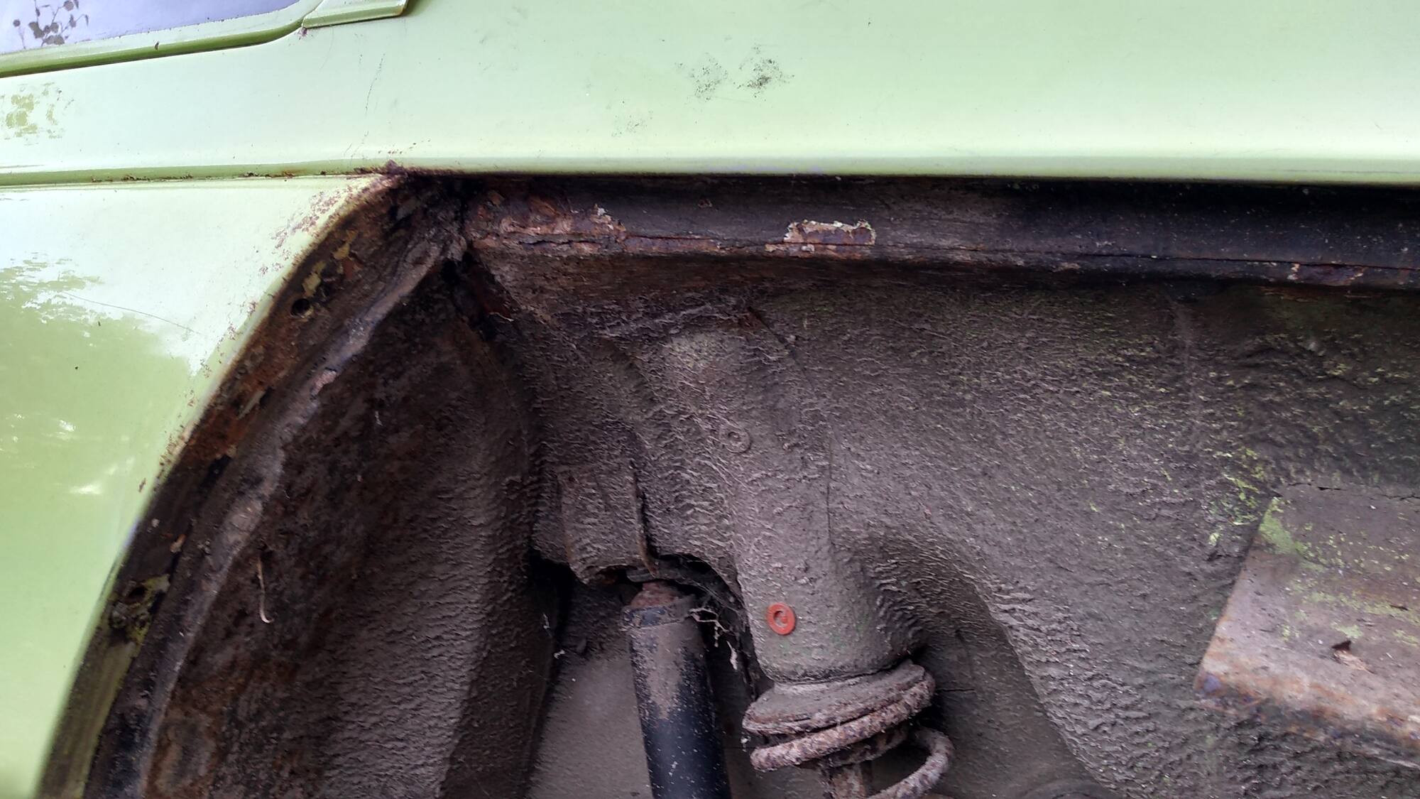

I had a spare couple of hours today,so I carefully removed one rear wing.This car is really solid.I only found one tiny hole that I wasn't expecting.Graham McDonald said it was a good one when I bought it off him,but that was 11 years ago,and it's been sitting in my shed for the past 8 years.Also ,I only paid  him £900 for it,which wasn't a huge amount for a roadworthy 96 even then.
L/H rear wing off today.This corner is even more solid  than the other side.Next thing is to power wash the four inner wings then strip back , weld and rustproof the four corners in turn.
