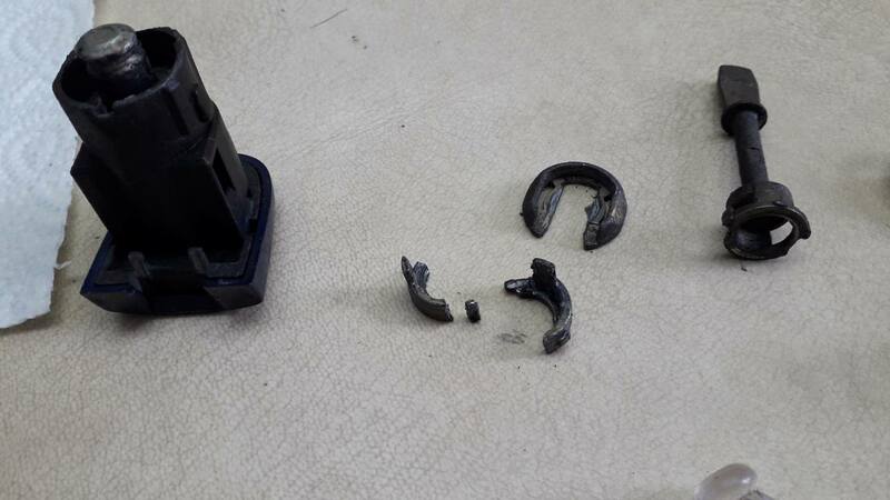

Barrel repair kit arrived, as expected the cam is broken
.and after half an hour of breaking my nails rebuilding it, it still doesn't work. Now locks but won't unlock...

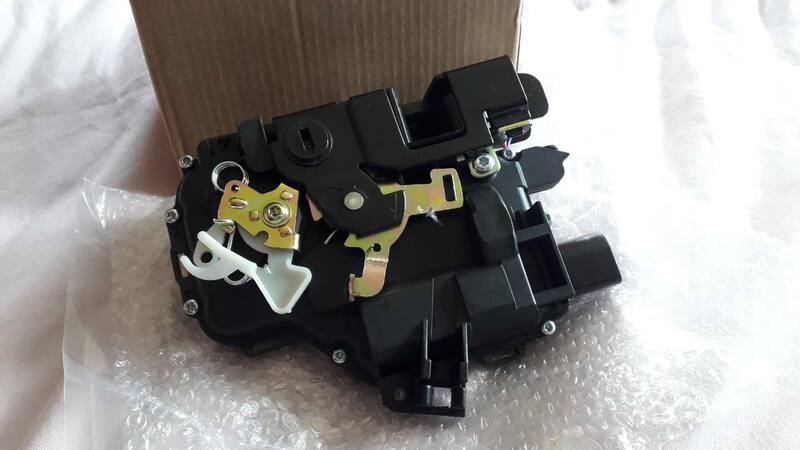

Well the lock's here. Chances of fitting it this month are slim

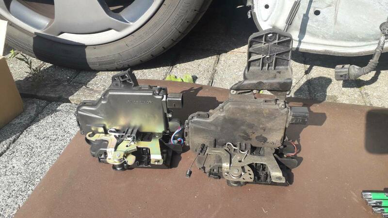

Well after rather too long driving around with no door card on due to life being too hectic to fit the lock, I got up early and bit the bullet. Wasn't as bad as I was expecting, having taken the door carrier off the front door previously I had an idea what to expect
Old and new locks - a few bits to swap over, luckily my rivet gun was at home
20210720_090944.thumb.jpg.7585a07f9adae954318b0441bc44d876.jpg20210720_091332.thumb.jpg.3f0079f7ccf1536c25a361acdcb6c958.jpgPop it back in place, connect up wires and cables
Then fight with the various cables and window glass retainer, find the door card (didn't lose any screws either), remember to test everything BEFORE closing the door unlike the last time...and done

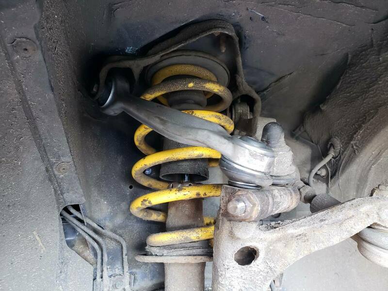

Despite it being cold and windy, I thought I'd use a free day to tackle some jobs. Got the OS track rod end changed
20220212_111636.thumb.jpg.c06c364bf2633ce91784549c30b64dbb.jpg20220212_120452.thumb.jpg.15105337aa50eb6e03c0c83092d5a0bd.jpg
Didn't seem a lot wrong with it other than the boot had come out from the retaining ring, but it keeps the MoT man happy.
Took the pads out and gave everything a clean up and copper grease just for peace of mind, then went onto the main events - NS CV boot and suspension arm.

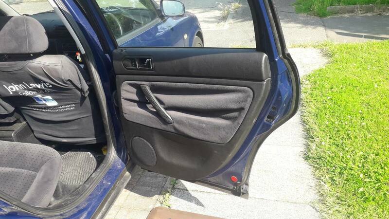

I also had the OSR window regulator fail, probably just broken clips as it's happened before on one of the windows, but I've been having to remember not to open it or use the key function that unlocks all the doors and drops all four windows.
Then last night I helped out a young couple by jump starting their 1 Series. Very odd situation but I got them on their way - I'd only pulled into the industrial area so my mate could drive slowly and brake so I could listen to the clonk/tap noise that's started coming from the OSF recently. He then couldn't open the door from the inside even though all had been well when I got out moments before! Felt like the release cable was frayed and caught up.
Went out this morning and the driver's door wasn't locked. Wouldn't lock from the remote so I used the blade, felt really stiff but it worked - but then on unlocking it wouldn't open from the handle. Argh.
Opened the window and managed to get the top of the door trim off enough to get a hook inside and free the cable from the inner handle. As suspected it was frayed and jammed up. Got it pushed back in enough to allow the outer handle to work again

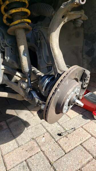

Had the wheels off looking for the mystery click that happens when braking. Discovered the N/S CV boot has sprung a leak - appears that the inner clamp has chewed a hole in it. I only replaced it a year ago and can't see what I could have done differently, but for now I've glued the split, cleaned up the mess and hammered the pinched part of the clamp flatter

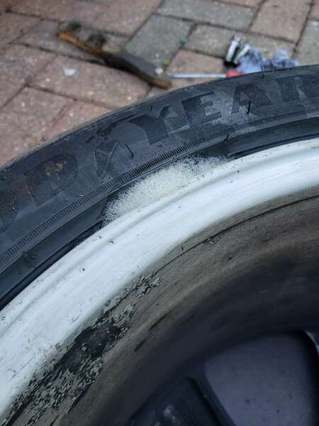

Having cleaned the grease off the inside of the wheel, the reason the NSF tyre has been going down revealed itself
As I was there I took the pads out and gave everything a clean and copper grease as appropriate, and as a long shot nipped up the suspension top mounting bolts under the bonnet.

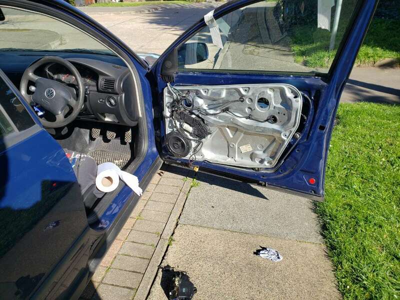

First jobs, replace the door release cable and fit a new lock - it's only a microswitch that fails but it's a lot more messing about to change it - new locks are £15-20 off eBay
A couple of bits need swapping over
That went rather smoothly, I now have the luxury of opening the door from the inside!
I lubed all the handle pivots too as it was always a bit stiff(!)
Works beautifully now.

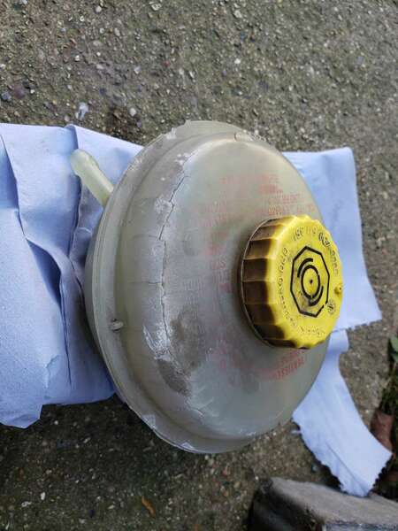

The reason for changing those was so I could replace the brake fluid reservoir, which has been the victim of a quarter of a century's worth of UV damage
20230407_140406.thumb.jpg.a20c329a24a5b8d6a74e8b0c8db78a12.jpg20230407_133709.thumb.jpg.0b75366ed320d7180665f7b547e4badf.jpg
Great success, I was pleased to find that reservoir as most are designed for LHD and incompatible with mine.
