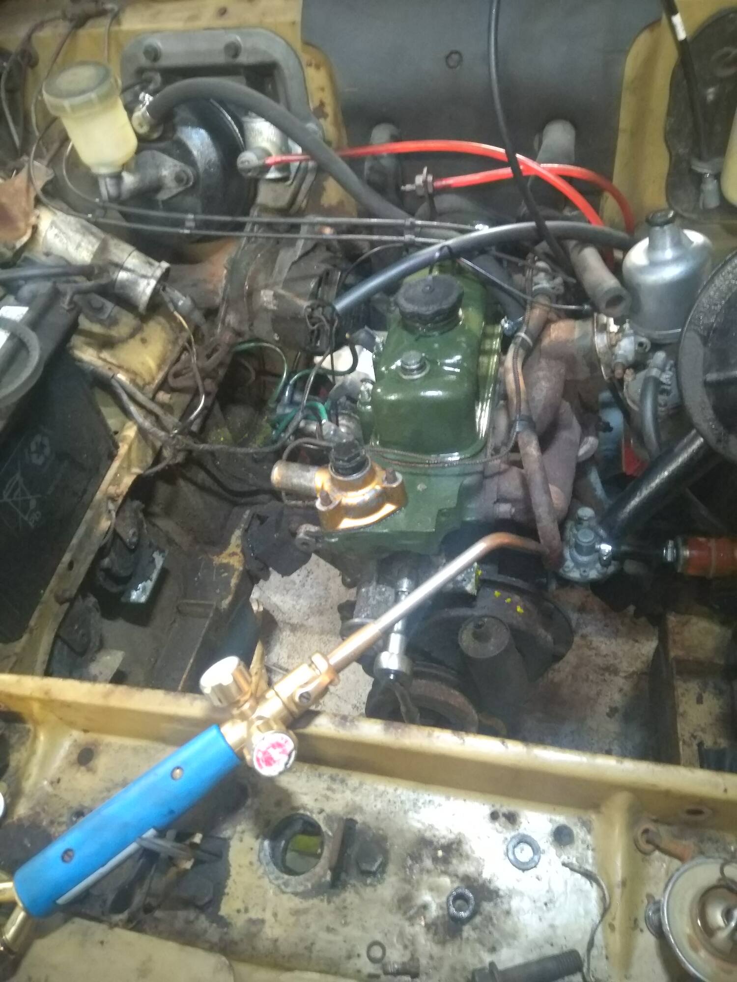

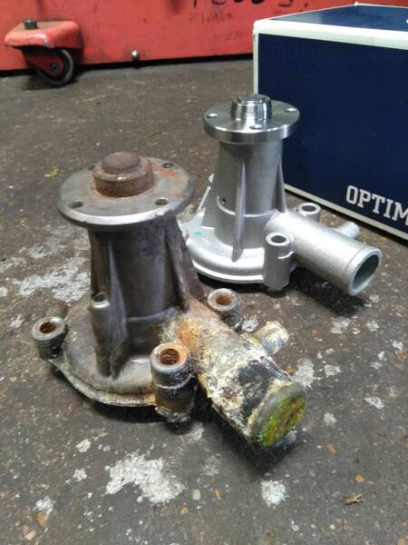

The water pump bolts required the use of the hot spanner.
New pump, Optimal brand made in Europe. I've never heard of them but the pump looks decent.

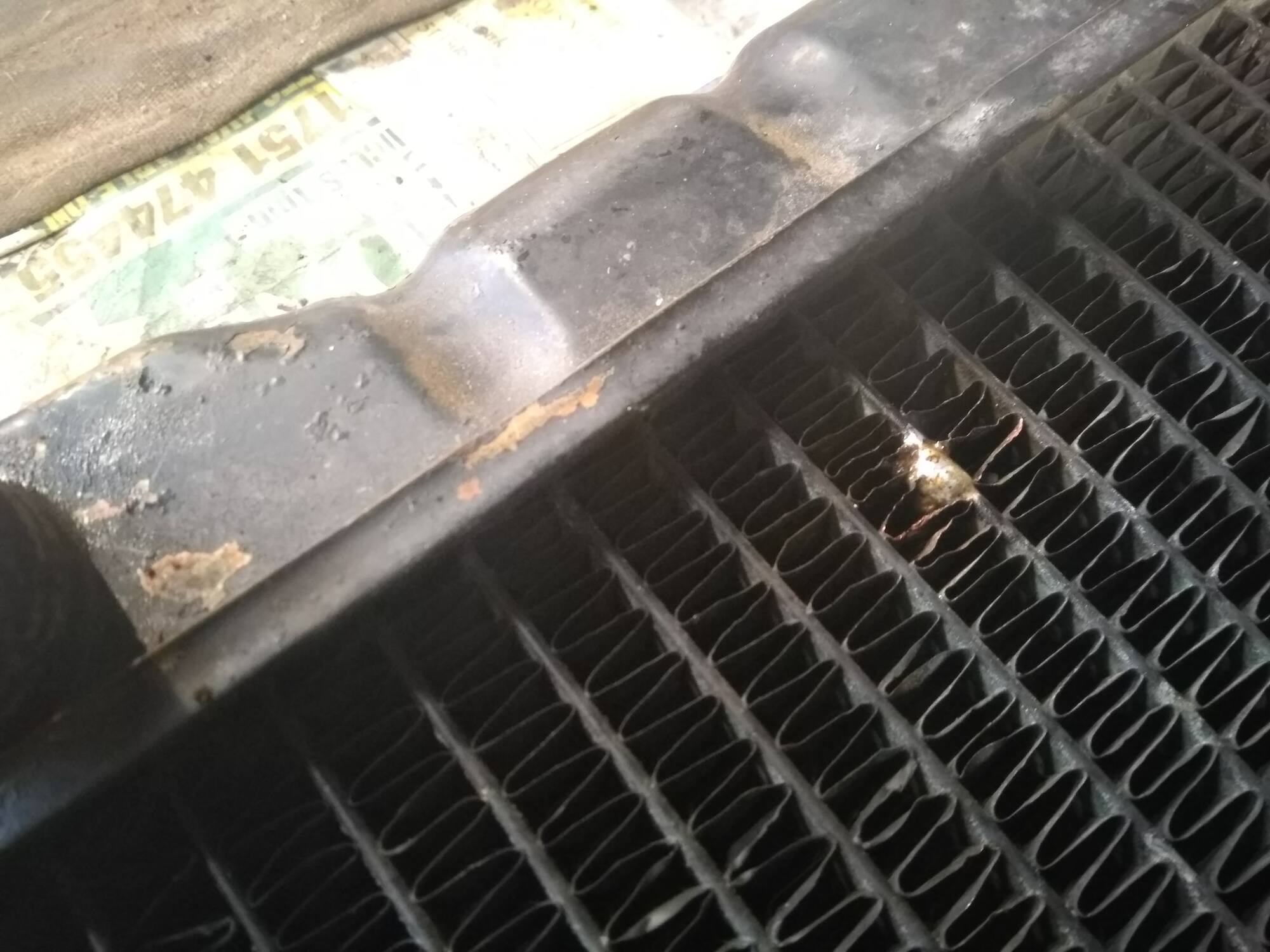

And the rad has sprung a leak! So out with the rad again and a little bit of careful soldering and it's good to go again.

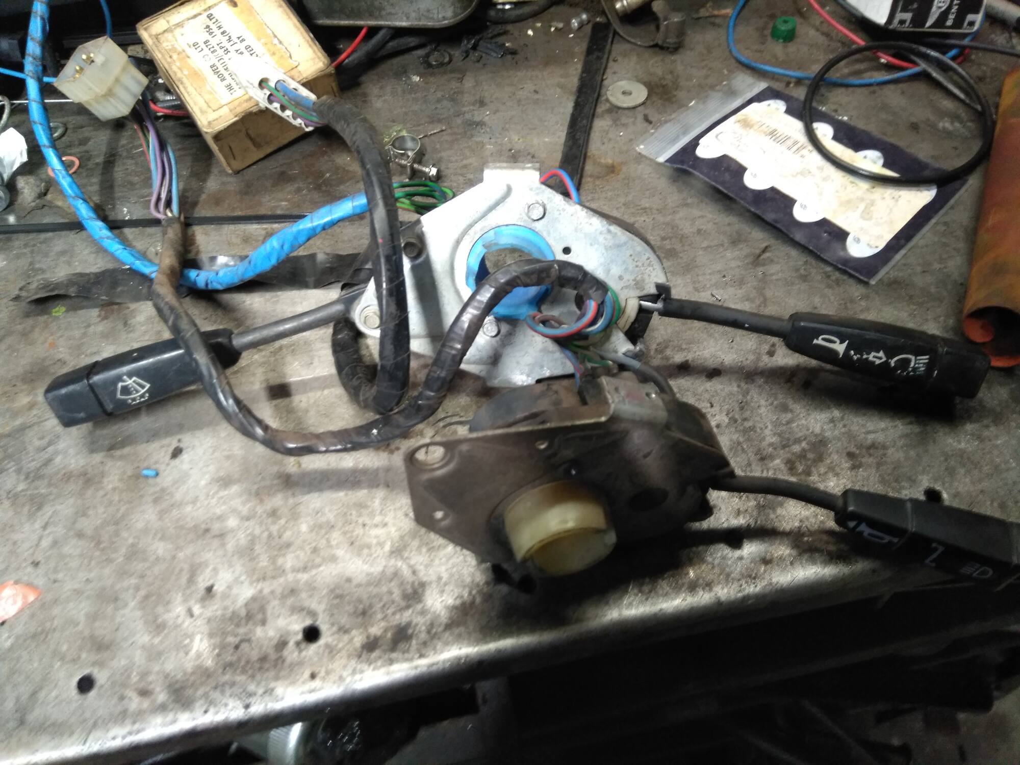

Indicator stalk seems to have disintegrated internally and is flopping about loose.
So off with the steering wheel and the stalk
I found some spare stalks in the back of the van, which must be from a later model and the stalk is on the left side (wrong side!)
So I pulled both stalks appart and made one out of 2

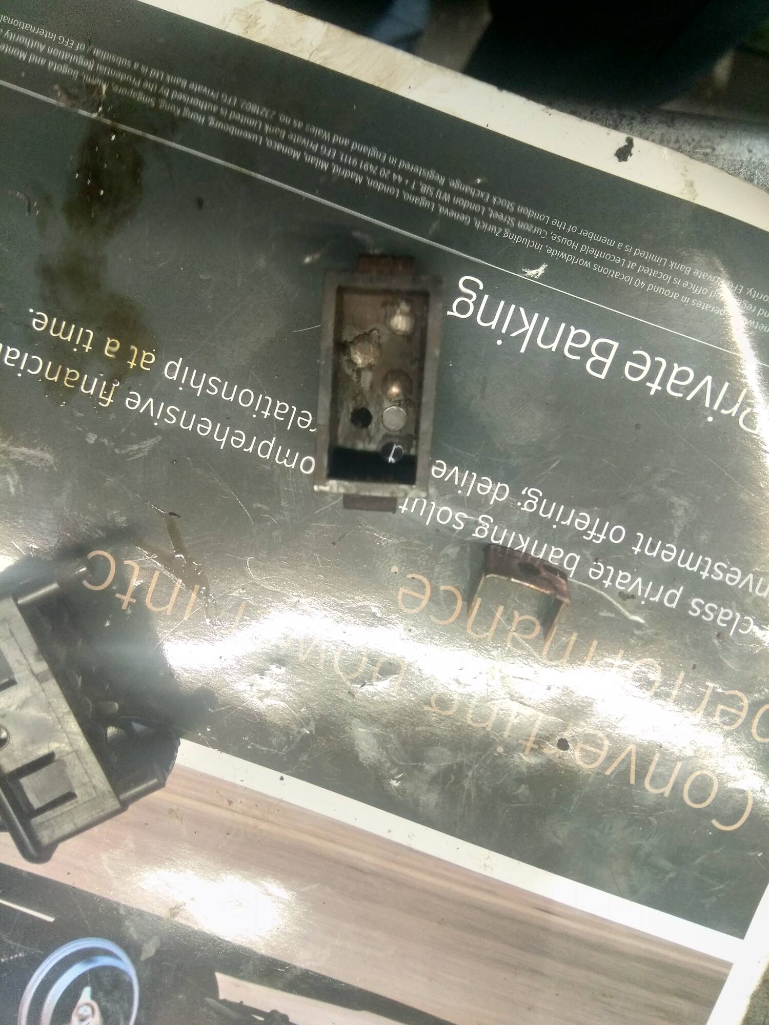

Headlight switch also needed some attention now all fitted and back together and I have fully functional lights.
at least all the switchs can come appart to be repaired/serviced. I think I will add a couple of relays for the headlights and some of the switch gear doesn't really look like it's up to the job!

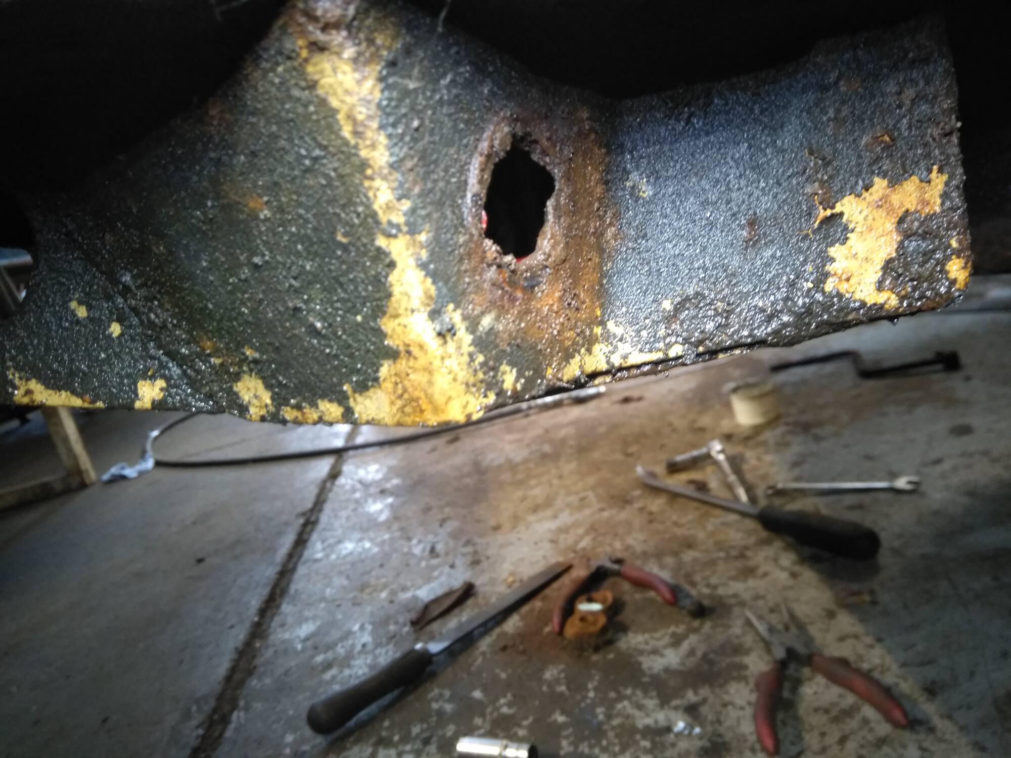

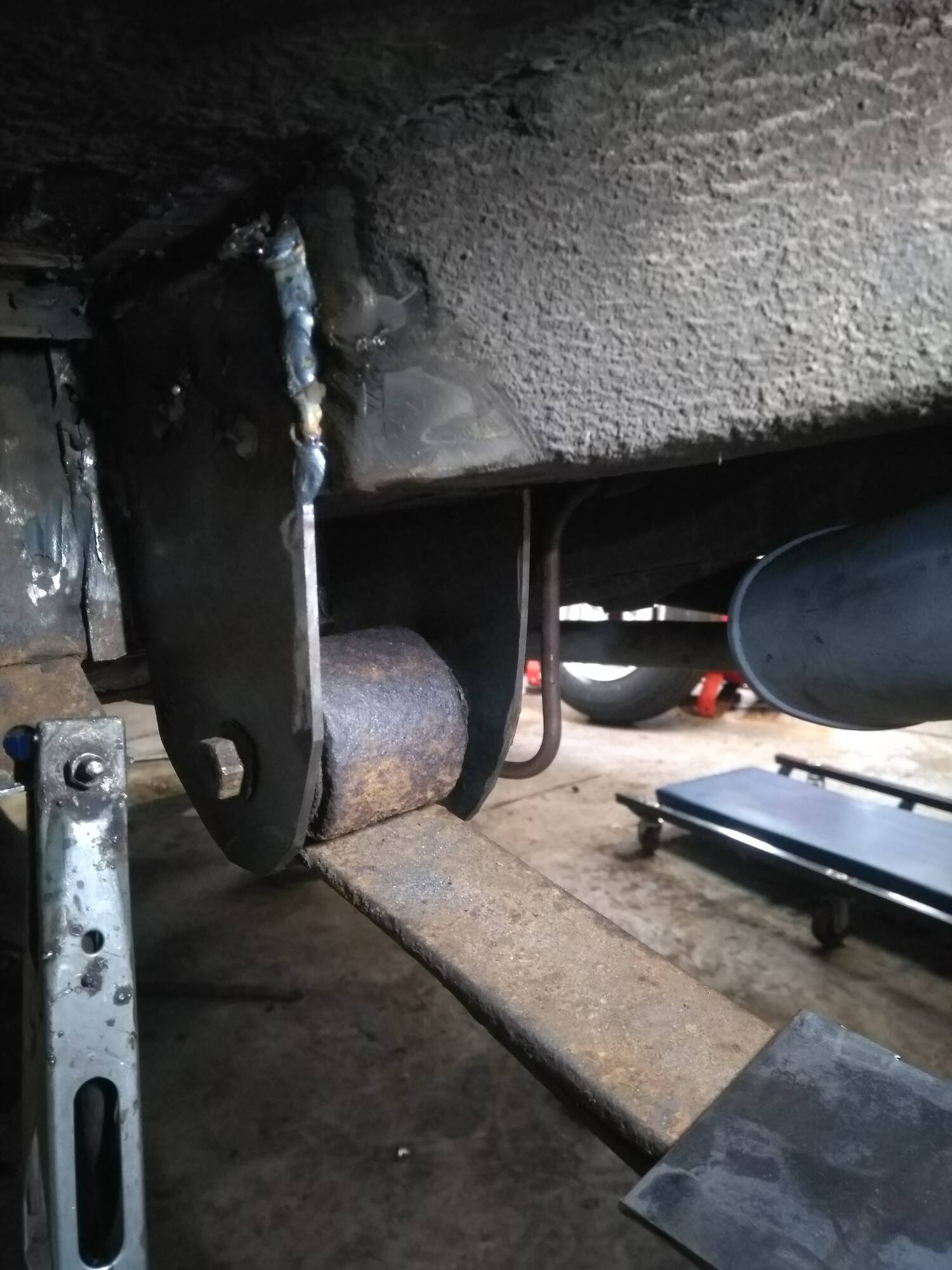

Had to do some welding today, before the van goes to the body shop we thought we should attend to the NS spring hanger, before the spring made a bid for freedom.
Pretty crusty
Choppy choppy

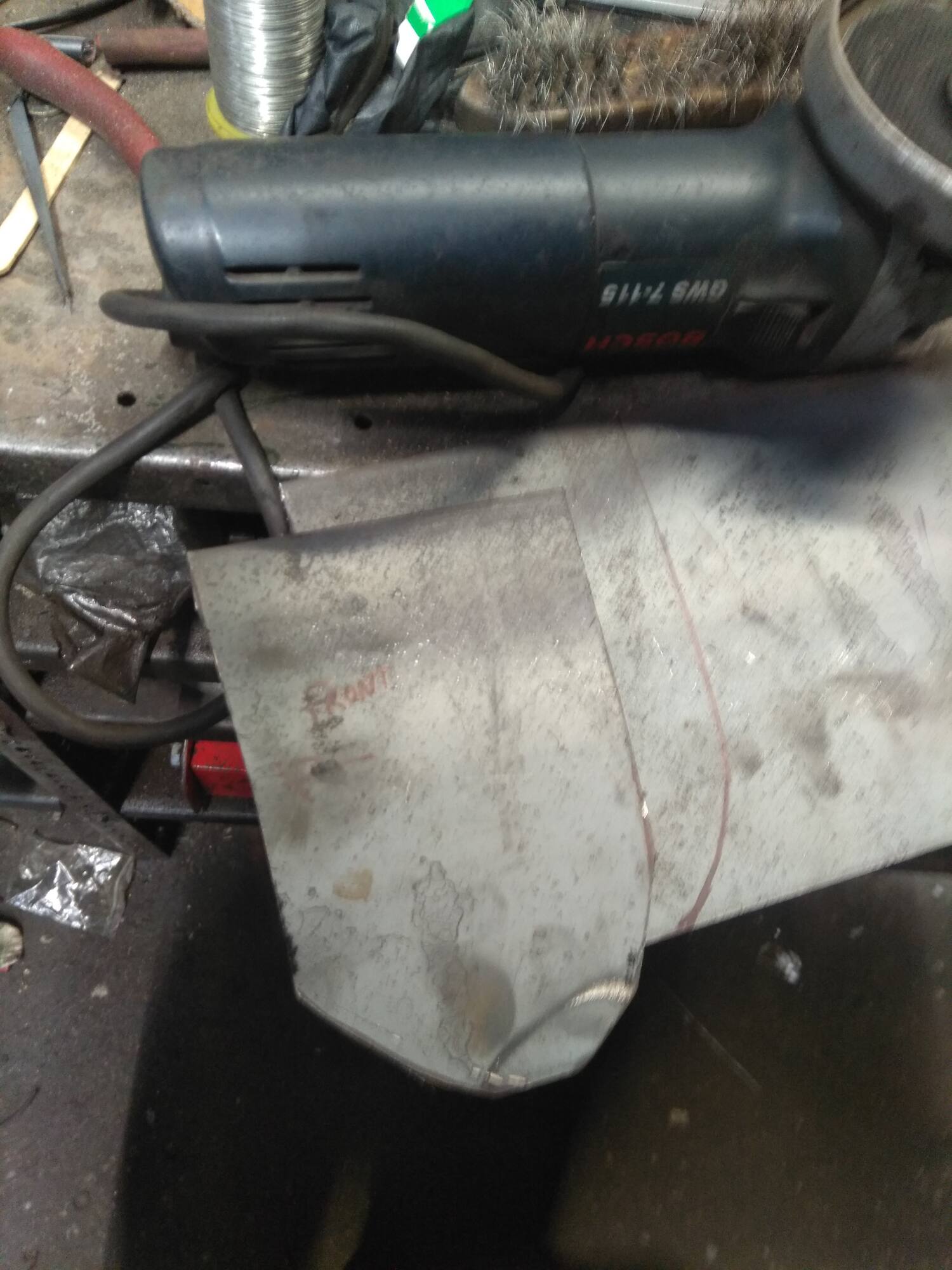

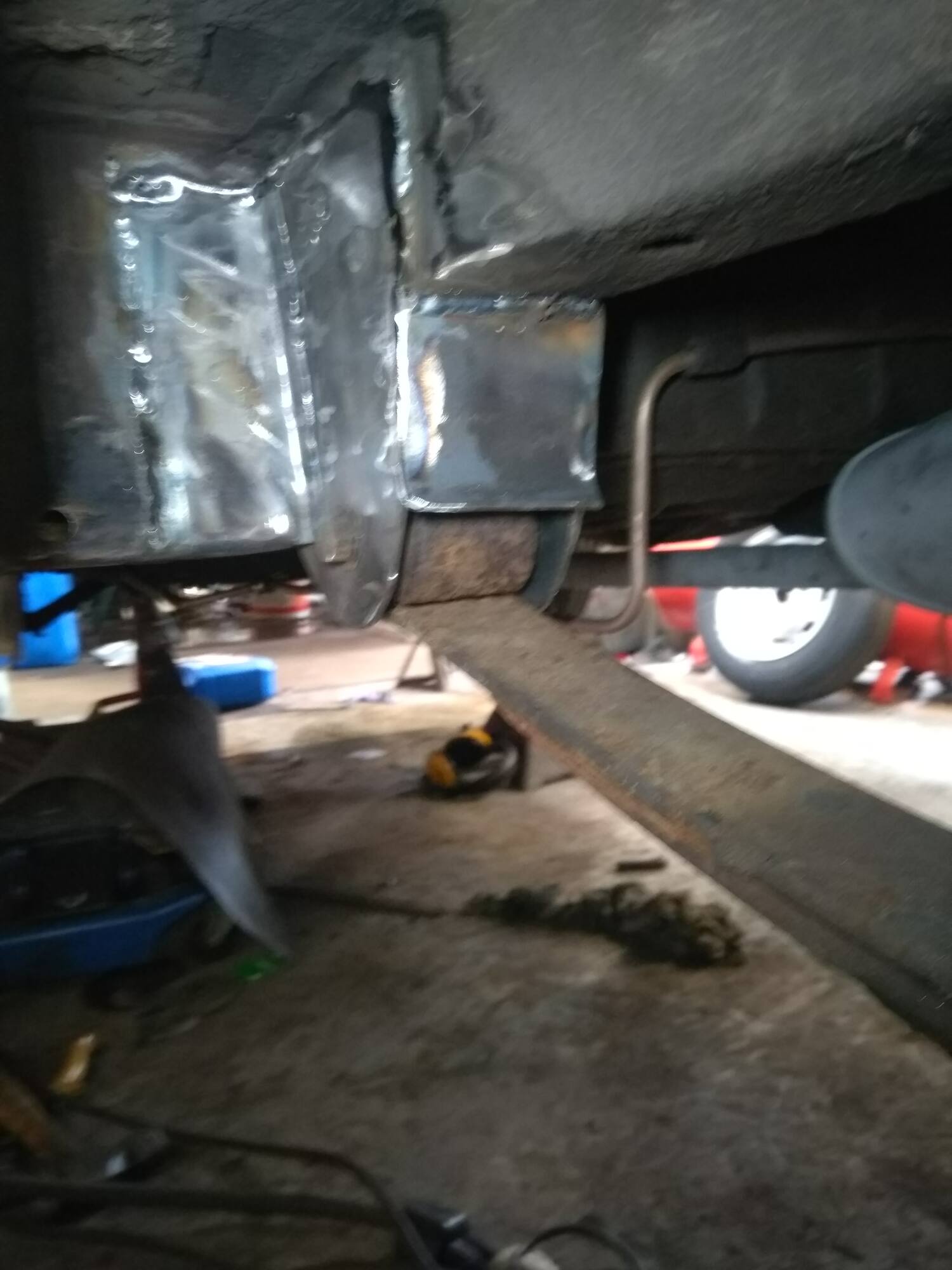

Made some repair sections out of 3mm thick steel, the original spring hangers are made out of a sandwich of thin layers, I cant be bothered with that so went extra thick instead!. I had to repair the chassis leg first.IMG_20191031_110410.thumb.jpg.21466f6b08a5360b736eb26ff5b1f35d.jpg
Looks about right, I welded one side on leaving the other as a datum point then cut that off and used the new bit as the datum.
The spring fits and the bolt goes through the hole.IMG_20191031_124120.thumb.jpg.8cf23963ebc183dfcceac2b9c9e84dc8.jpg
Boxed the sides in and made an attempt to make it look factory!

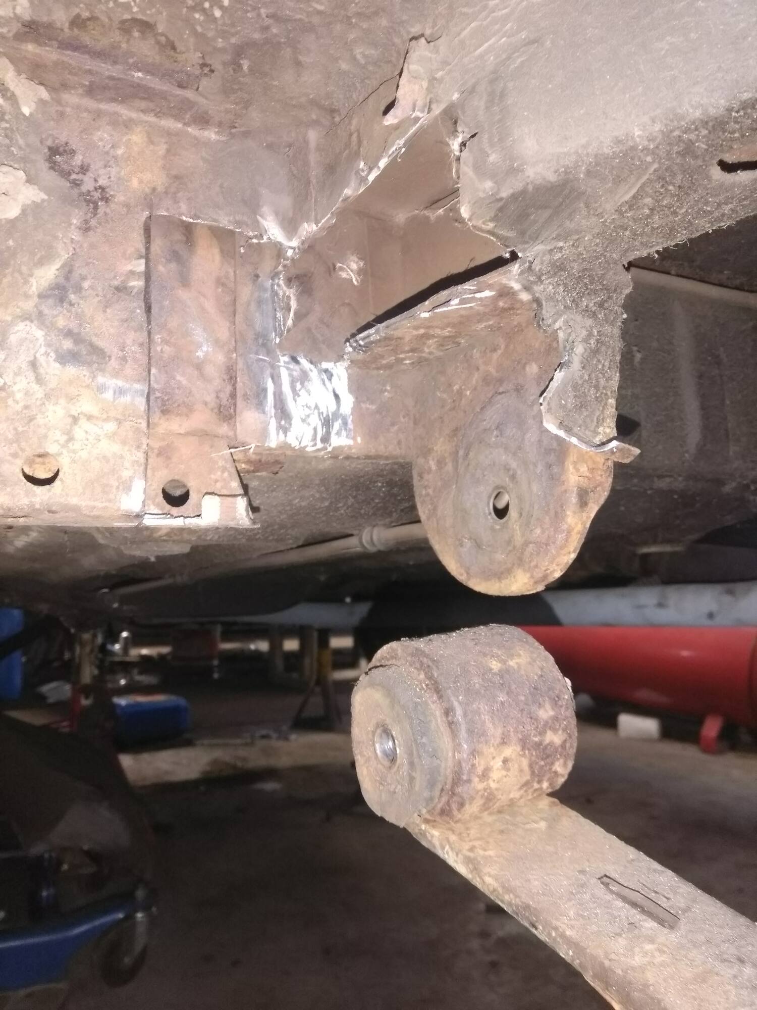

To replace the front tie bar bushes which look like this:IMG_20191105_095016.thumb.jpg.ba8389fb7069dad2c0b3a4b130006fb3.jpg
I fitted the o/s no problems, but when it came to the n/s I realized the the cups in the chassis legs that hold the bushes had disintegrated.
I welded two RR Silver Shadow shock bush washers in place of the missing ones
Seems to work ok!

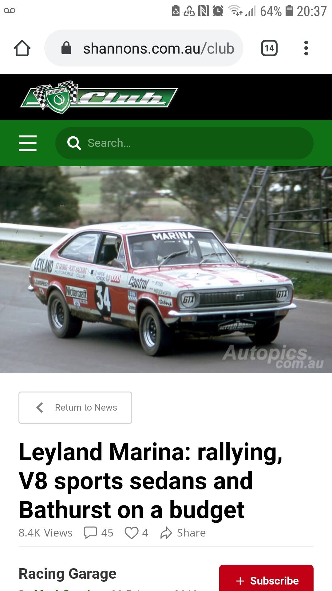

British Leyland special tuning did build a V8 marina pickup. I believe they let the motoring journalists do laps of a track in it. Ended up being used as a factory hack
