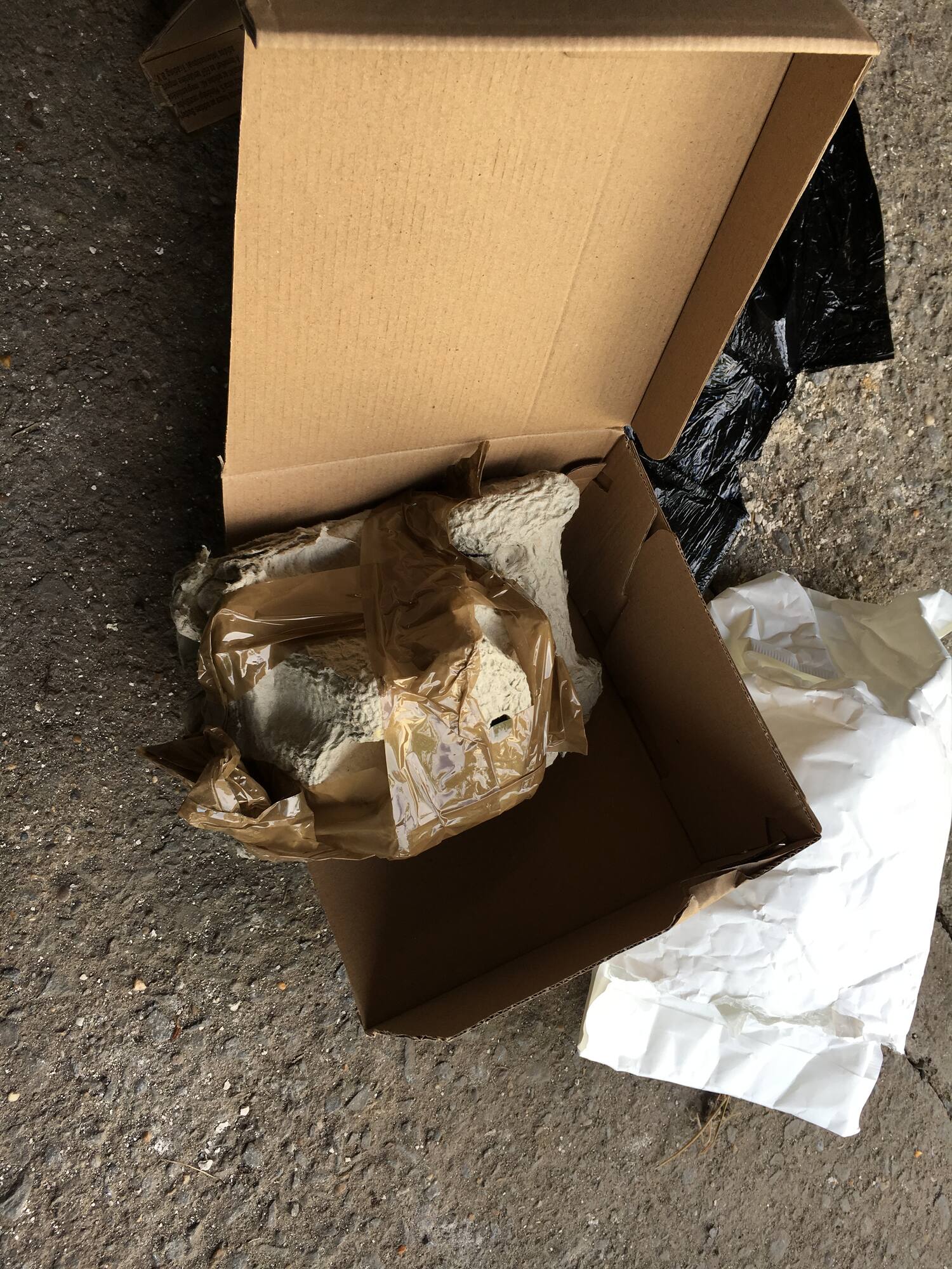

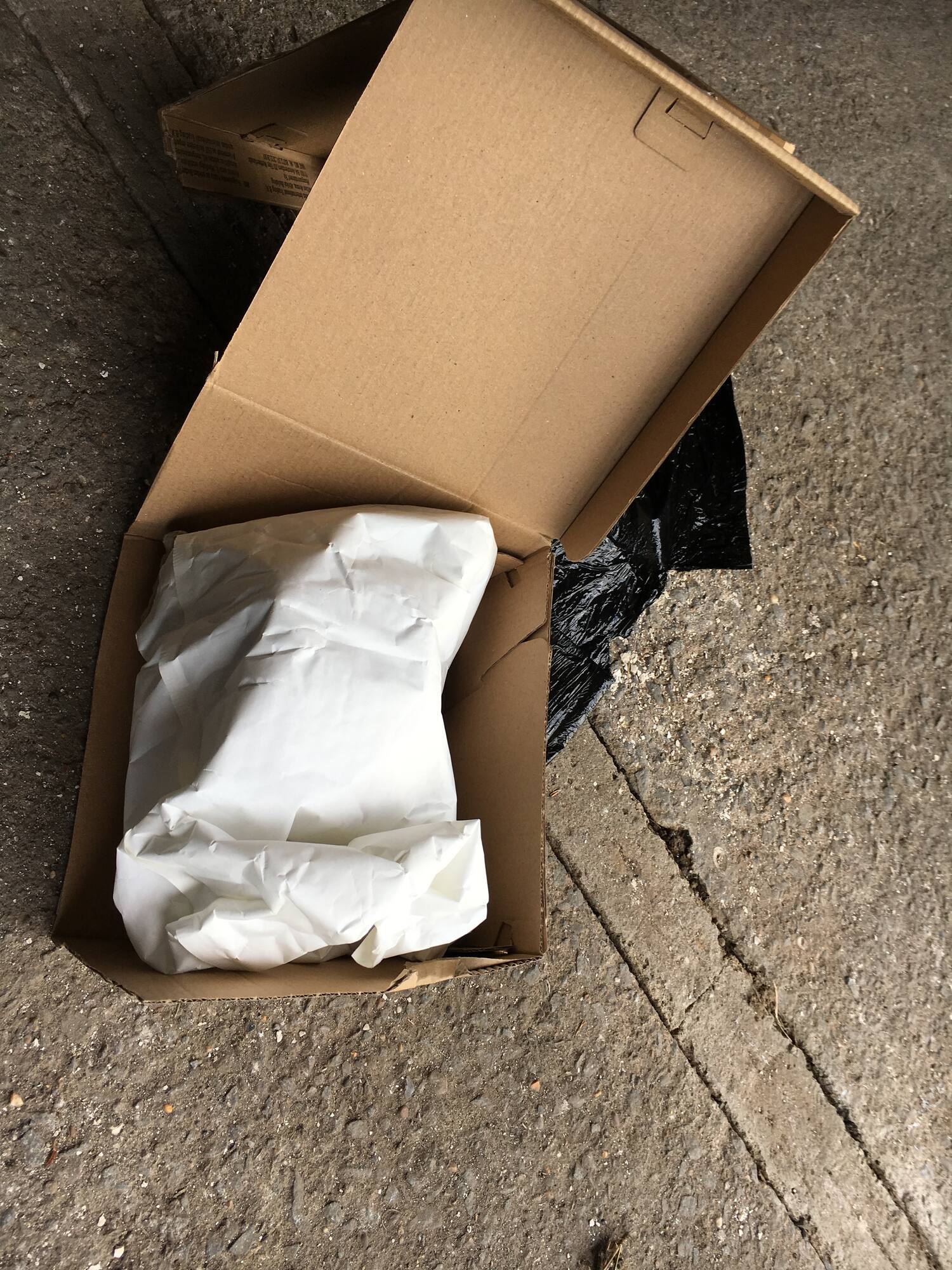

Windscreen wiper functionality has been restored on the E30 thanks to a new Wisch-Wasch  control relay (yes that’s really what it’s called) from eBay.
It came in the most packaging ever: waterproof plastic wrap around a box
which contained a jiffy bag
in which was a carboard egg box type thing all taped up
inside which was a bundle made out of sponges
enclosing the relay.
It took eight times as long to unwrap as it did to fit.  But it was certainly not damaged in transit, and works.

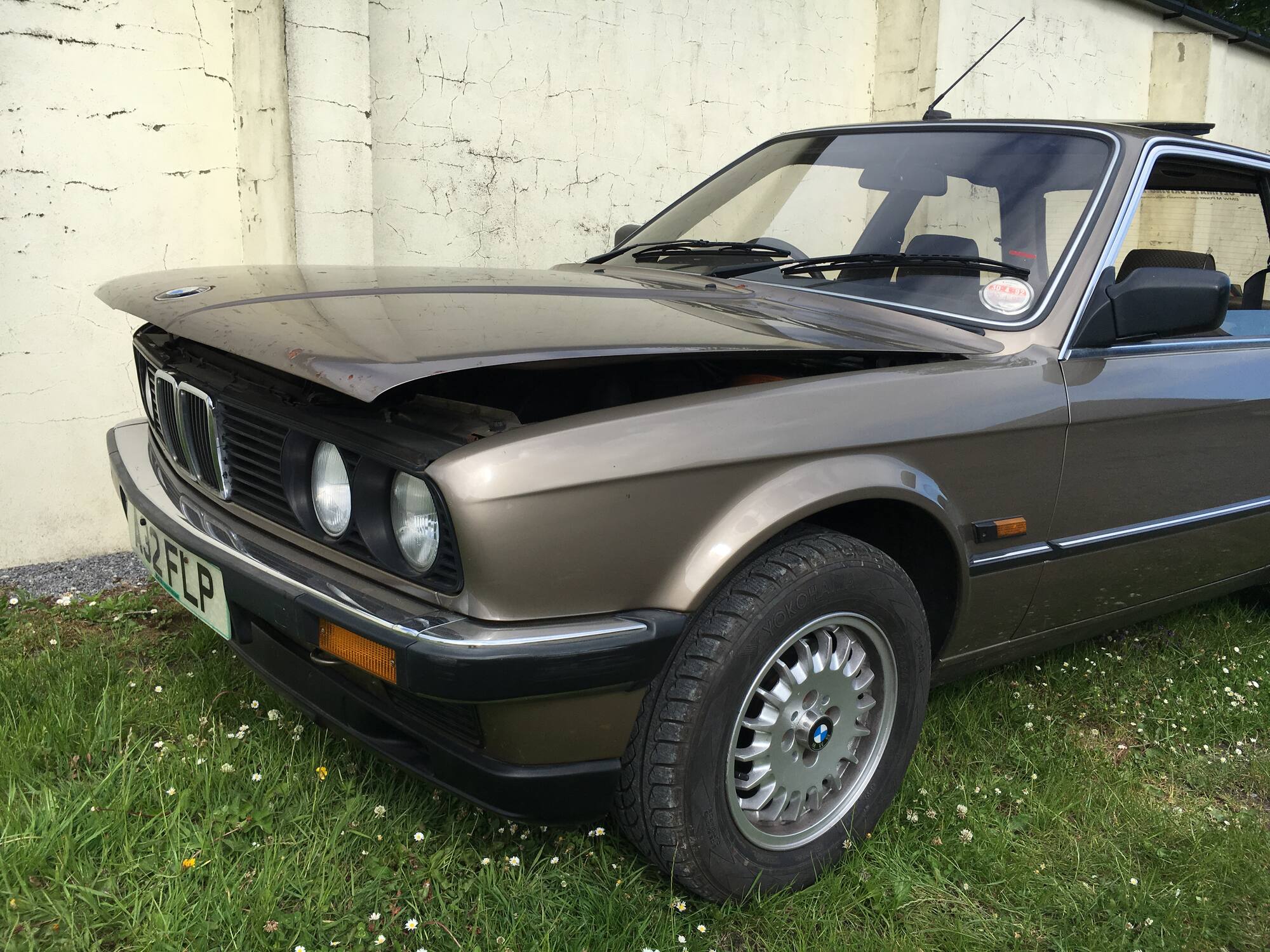

These also have that cool bonnet opening don't they.  The front raises up and the bonnet tilts back  (not the way it looks like its going to go)
On 6/18/2019 at 10:47 PM, Split_Pin said:
The 1/36 Corgi model also correctly replicates the bonnet action!
Hot bonnet action action:
Stage 1 - ah, looks like it’s rear hinged...
Stage 2 - ...surprise! It isn’t.
Yeah but you’d have moaned if it turned up smashed! Can’t blame the guy for making absolutely sure!
Oh don’t get me wrong, I’m not complaining! Just entertained by the pass-the-parcel / matrioshka doll experience. I left very good feedback.
And I’ll use the sponges, too.

I’ve had a few off eBay with the worlds supply of tape holding it all together. I suspect they only did it to piss me off and slow me down as much as possible getting into it! I’ve never had sponges though!
I bought some ready mix sand and cement from screw fix. It came in a box which was in a bag and the cement was in a bucket.
My old Saab 96 had a similar arrangement, but covered the front of the car even more!  Sadly I have no photos of this wonder, but here's a library pic taken earlier... ?
