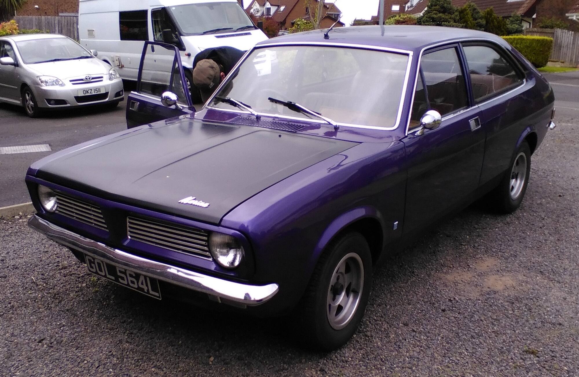

Wow, an American Marina! It looks so different with those massive bumpers and the indicators in the grille. Interesting looking trailer it came home on too, I doubt that would be legal in the UK.

Glad to see this made it into good hands though. I've never seen a Marina here. Don't think they sold well at all down south. Doubt you'd be bothered by the cops, it's a shiny classic that's being carefully maneuvered by some non-hooligans.

I rather like the look of the Coupe Marina. The only thing that maybe compromises it a bit is that (I think) Leyland used saloon doors to keep costs down so they perhaps look a bit short. Still looks good though ;)
Are the U.S. interiors any different to U.K. ones apart from the wheel being on the other side ?

US spec really adds another level of ugly to European cars - looks like a 70s Chevy Nova from the front.
Hope the wheels are staying because they're great!

Yeah, I've been getting a lot of "just what is that" questions, since it has kind of the same generic front end as American econoboxes from the era(Nova, Gremlin, Pinto).
I really like the wheels also. The seller offered me a choice of those or the standard disk wheels, and I'm glad I opted for the turbines!

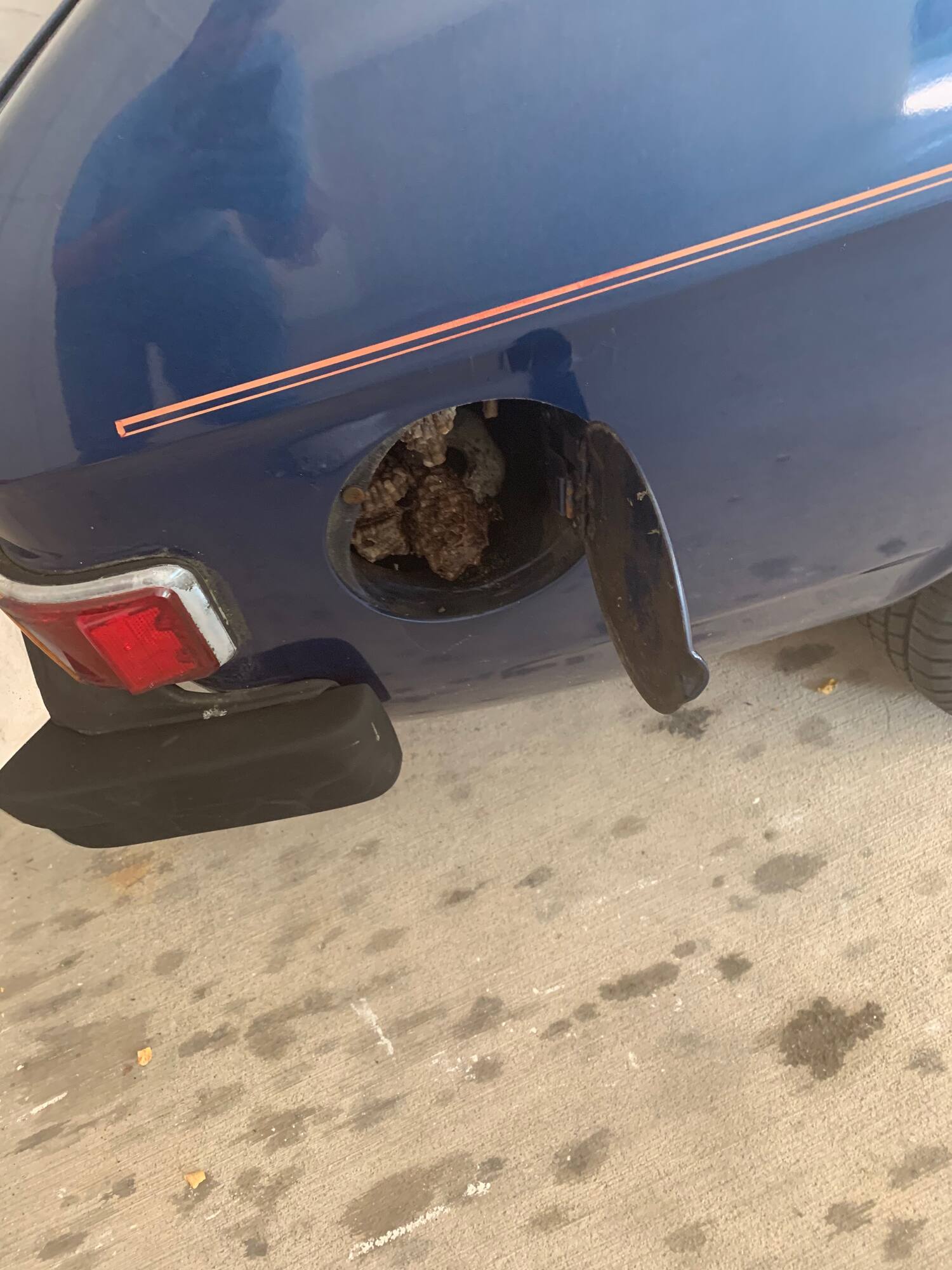

This nice surprise was waiting for me behind the fuel filler door...fortunately there were no signs of life from it, and a screwdriver had things good and clear.
Yeah, we get those here too.
I have had to remove some squatters from the Pontiac also. Never fun when they are all in there looking angry....
