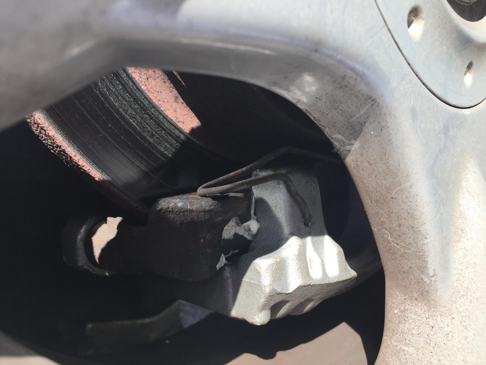

Sticking Caliper maybe?
I had new rear pads and a caliper fitted the other day on my Bini as I noticed the pads were down on one side and on the journey home I did notice the kind of whirring noise you normally associate with either a sticky brake or a wheel bearing and can kind of feel a little bit of vibration through the pedal when braking (the same as before the caliper was done)
I did the commute to work this morning and when I arrived I could smell that horrible brake smell coming from the newly fitted caliper area and the disk was hotter than the others and was just wondering is it a case of me taking it off again for a look or can I ignore and hope it goes away lol as I was thinking it might be a slightly warped rear disk.

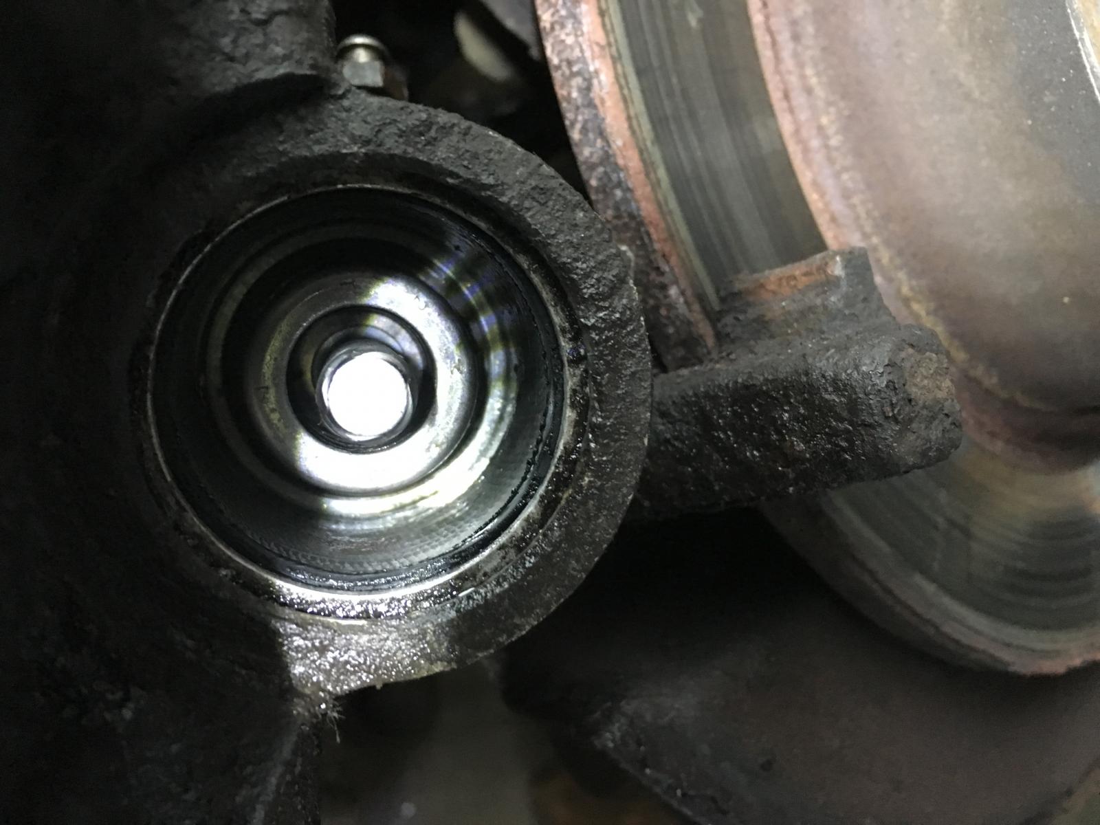

As Dave said above remove the slider pins and grease with a rubber safe grease (not copper slip!). Whilst you have the caliper removed have someone sit in the car and gently pump the brakes until you piston is sticking out but not too much it falls out. Pull the rubber seal back and check if the piston is filthy or not. This is a sticking Audi caliper I recently sorted for a friend, the piston was filthy
It was so bad I actually removed it to clean it up
The actual cause of the sticking was a layer of aluminium corrosion behind the piston seal in the caliper. I gently removed the seal and cleaned out the groove it sits.
Once all back together no more sticking caliper

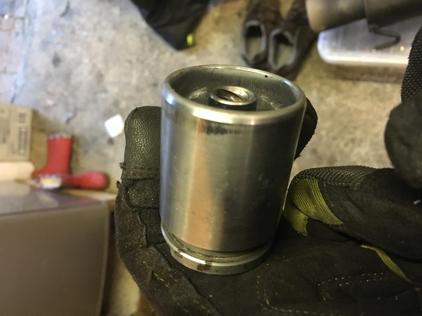

Ditto to the above. It likely won't cure itself without overhauling/replacing the caliper. I wrestled with mine, making sure the pads and pins slide freely, but only replacing the pistons and the piston bore seal ring got rid of the sticky brakes.
It only needs slight pitting in the plating, and rust and grime start to form on it. Here's an example of sticking pistons from my Nubira rear brakes.
