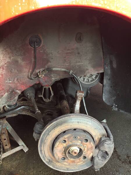

Some progress made. Working in the cold, dark and rain is not so nice. Anyway the Lupo is once again mobile. A new breaker bar, Plusgas and a 18 mm impact socket made short work of getting the front strut off (like 2 mins). At this point I had a full set of coilovers ready to go (specifically coilovers at the front, and somewhat adjustable rear springs and new rear shocks sitting in a box). However I didn't have the time and the tools to do that big job properly so for a few quid I made a quick run to UPullit and found a tidy replacement used strut. That went on withing a few minutes. I tidied the brake disc up as best as I could and buttoned the car up for a test drive. All well within reason. Sitting hasn't harmed it at all. Tomorrow I should check the other side and replace the drop link. While I was at it I found why the driver's side rear had a small intermittent leak. There is a nail in the tyre. It's very central so I'll have a go doing a puncture repair, but it will get a new driver's side front tyre anyway. In short, it's usable once again. I might sell the suspension kit I got. It was on offer which pushed me over the edge to buy, but I just need the Lupo reliably on the road right now what with so many things going wrong. While we are on the topic of things going wrong...

I could be miles out on this but IIRC the 1.7 SDI had different springs up front when compared with petrol variants to accommodate the 1.7 boat anchor so depending on what model that strut came from, if you notice any pulling to one side or odd handling look there. The main thing is it's up, running, use-able and providing 50+mpg £30 PA tax transport. The Jaaaag looks great in that colour as mentioned, I actually can see the appeal of them now but they still strike me as being a proper brass ring piece job in terms of liability, perhaps one day when I'm older/richer/don't have to put money aside to buy shoes for the bairn etc.
My thoughts exactly as regards the front strut on the Lupo. Amazingly though the strut from a petrol donor car (a 1.4 I think because it was an automatic) was an exact match. Same part number and everything. There was a 1.0 Seat Arosa in the yard and again it was exactly the same. Tracking is dead straight after the job which is nice and the car sits level as far as I can tell. It makes no sense the different models all have the same springs and shocks, but it seems to be the case. It would explain why the SDI has so much body roll perhaps if it’s on suspension designed for a 1.0 petrol presumably.
Part number is the same for the dampers on the petrol variants, the part number for the coil springs is the bit that's different as they're stiffer(As mentioned this is purely based on memory)
Either way, if it sits ok and drives acceptably then who cares.

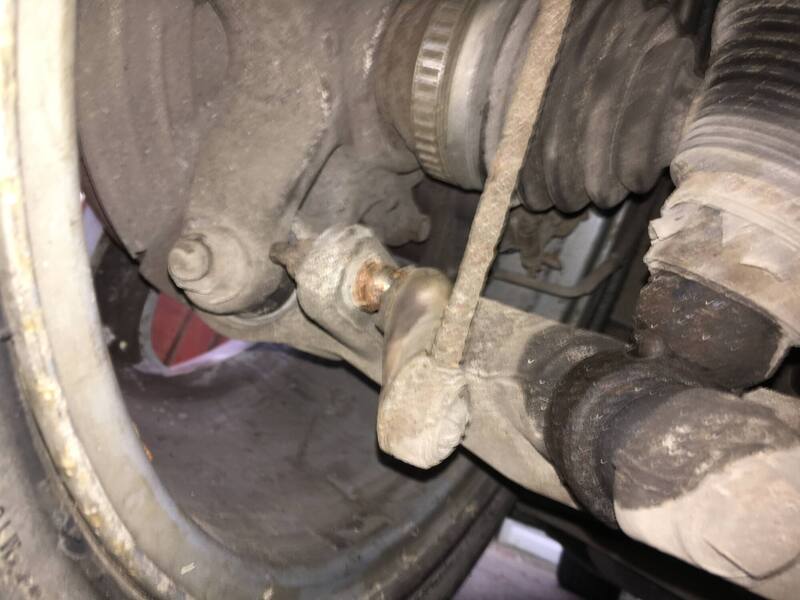

So final jobs of the weekend were do a puncture repair on the Lupo rear tyre (went really rather well) and replace passenger side drop link. The old one had pulled clean through the bottom washer. Replacement was very easy though. Lets hope the Lupo can cope with WBOD duties now (can't see why not). As a parting shot I doused the brake bias valve thingy with plusgas as it like to go PING!
