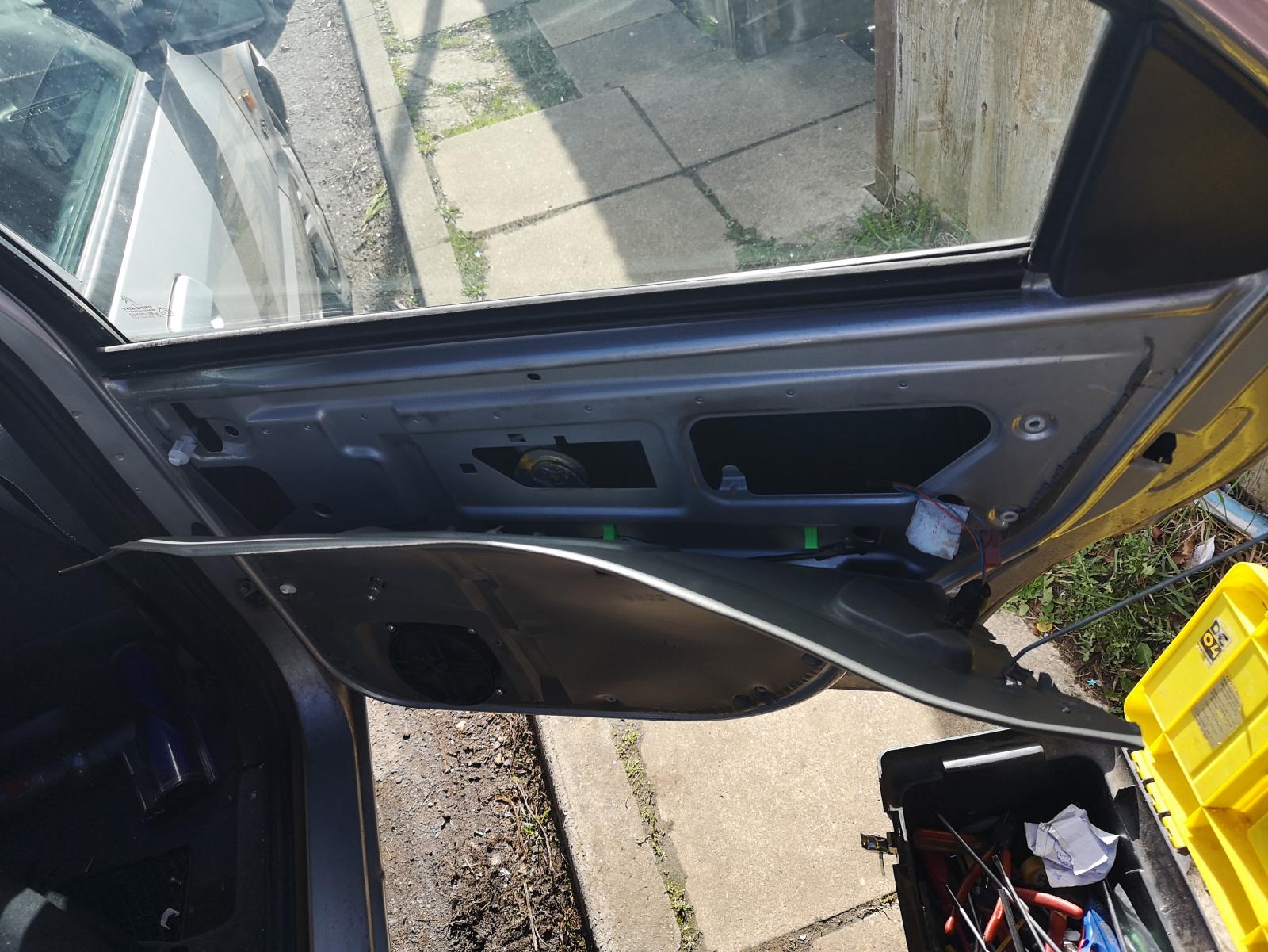

First up was the rear door. As much as it's only ever me in the car, this is the door I use to put my coat and lunchbag on the back seat to go to work... The 406 had a non working checkstrap here, and that annoyed me, this was the same. So, some broken trim clips later, and some faffering I had the door latch in my hand
A god blast with brake cleaner, 5 minutes in the sun then a good blast with plusgas, a good shake then a liberal squirt of spray grease had it moving a treat again! All back together
and a test run confirms the door shuts like a dream again!
VID_20190309_135552.mp4
Next job required the speaker to come out for access and yep, all 4 are like this, this will sound gr-33 when I fit my Pioneer tomorrow... need to turn the bass right down until I buy some new speakers next month
The bit of the check strap that bolts to the door had been ripped out and was handily lying in the bottom of the door...
Luckily it was all there but siezed so more brake cleaner, plusgas and grease had it moving like new, so a re-assemble and some washers I found in the box of random shit to pack out the ripped out mounting holes and it fitted perfectly and worked as it should! Window mech and hinges were given a good dose of grease too and the rear drivers side door is done!

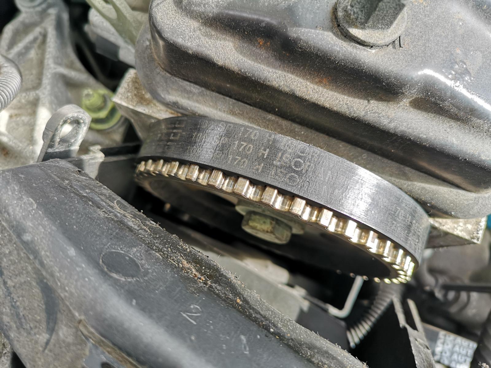

Hey ho, I then whipped the cambelt over off to just check I wasnt going to see bits of rubber and string and I was happy to see an cambelt in OK order (I will replace this, it seems easy and with no history on this car it probably needs doing, although I can't imagine it's from 1997...)
