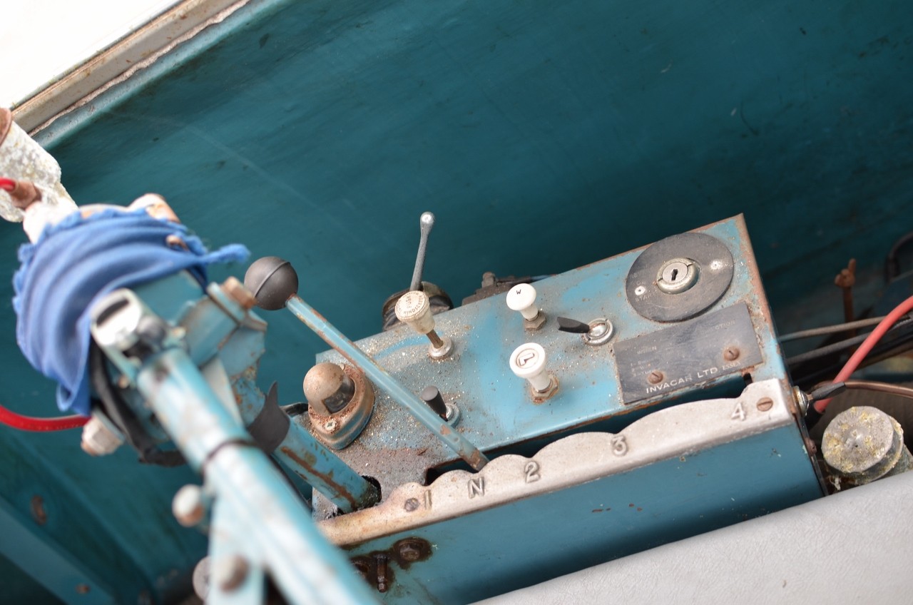

came across this and figured it might help :)
a picture of a slightly less faded/worn set of controls in a Mk12, with some of the markings still legible :)
(I noticed the cool little courtesy lamp, looks like a Lightbulb in some sort of steam punk suit of armour :mrgreen: )
It's like a Lucas L534 number plate lamp, but with more shrouding.

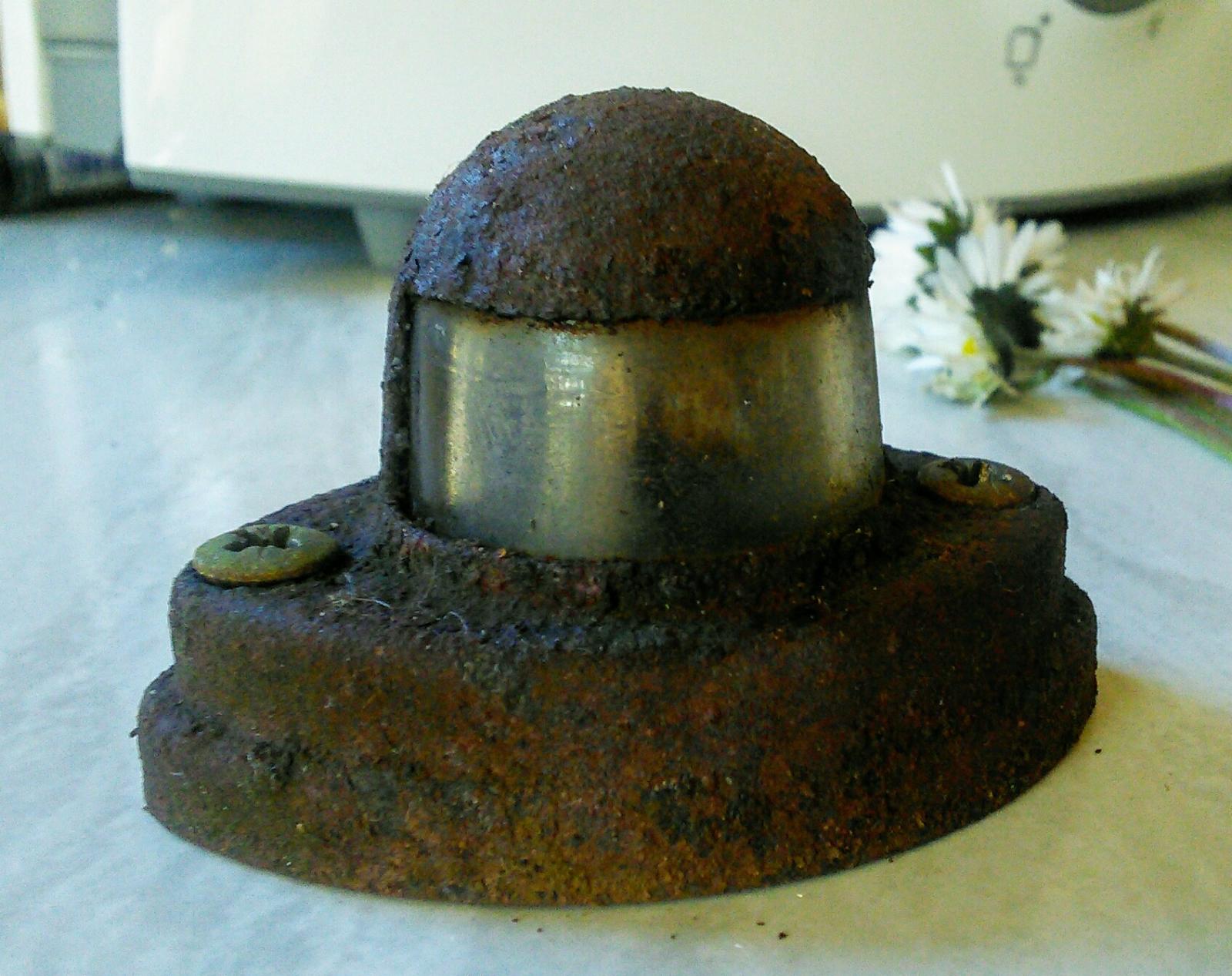

Thanks, I'll try and unbolt the little light for cleaning next time I'm over there.

On the controls I noticed your Mk12c has an extra slidable knob thingy thats not in the picture I shared, I wonder what its for...

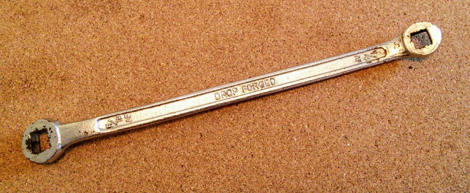

This brake adjustment tool for the rear shoes has just arrived in the last few minutes too...
I bought one of those wrenches(albeit new made-in-China from Moss) to adjust the brakes on the MG.
It's one of those tools that I did without for a long time, mostly using a 1/4" open-end wrench to adjust them. Even though mine are free and I run them in and out a couple of times a year to keep them that way, I feel a LOT better doing it with a proper wrench.
Nice of the vendor to pre-rust it for you.
I totally didn't spend about 15 minutes trying to get the offside rear wheel back on TP the day I got the new tyres because I'd left the spanner on the brake adjuster...turns out it just stops the wheel going on...
Eventually I remembered adjusting the brakes earlier in the day and realised my idiocy.
Good work. With the brake shoe adjusters, be sure to remove the adjuster and slap plenty of grease/copper slip on the screw threads. Loads of cars used them and they like to seize up, I had this trouble on the Allegro but a little attention has kept them free.
The good news is that the adjuster tool fits, the bad news is that if I apply any kind of pressure it will just snap. So more lubricant added, and will try again another day.
Maybe I just need to take the wheel off. And amazingly, all the wheel nuts on this side loosened quite easily*, so next time I'm over there, will jack up somehow and remove this wheel.

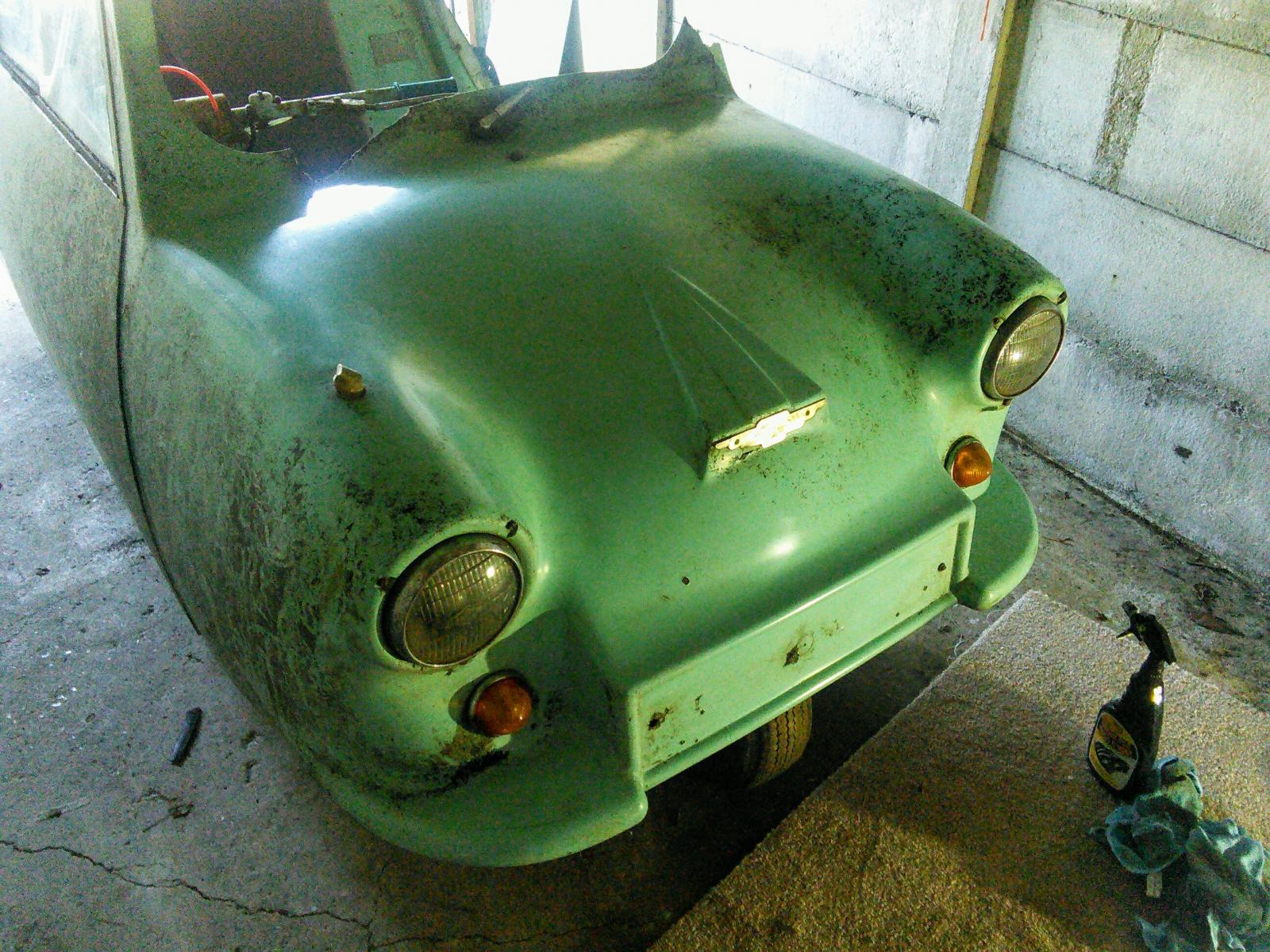

No other fasteners would give me the time of day, so cosmetic time, and an hour with G101 and waterless cleaner, saw a big improvement.
This is how it arrived, so progress there

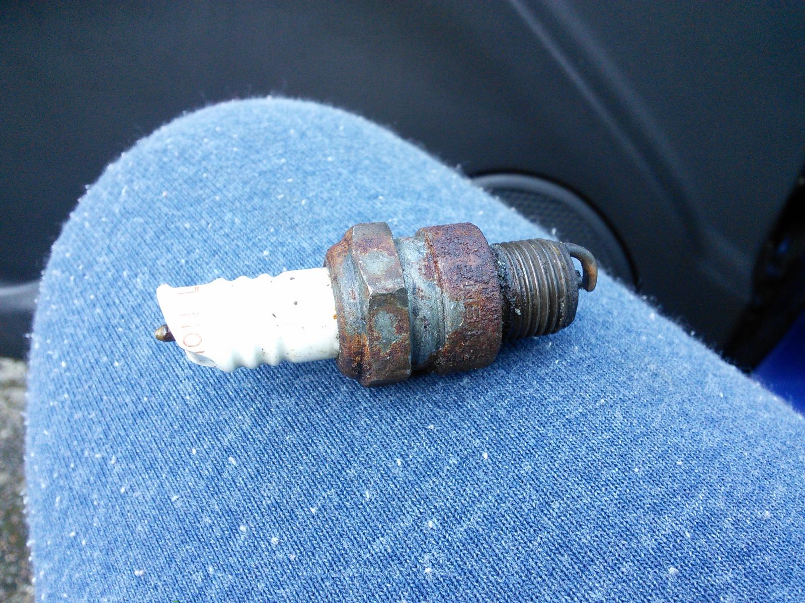

Was just going to give up and go home, but thought I'd give the plug another try....hooray!

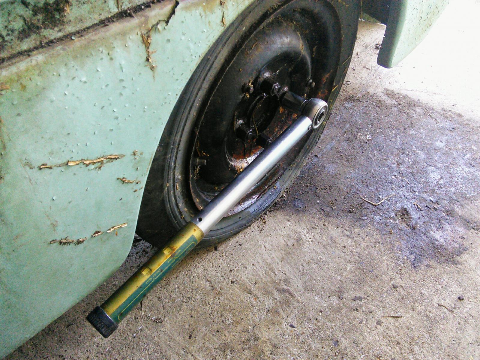

Er, why are you using a torque wrench as a breaker bar?
Cos I don't have anything better!

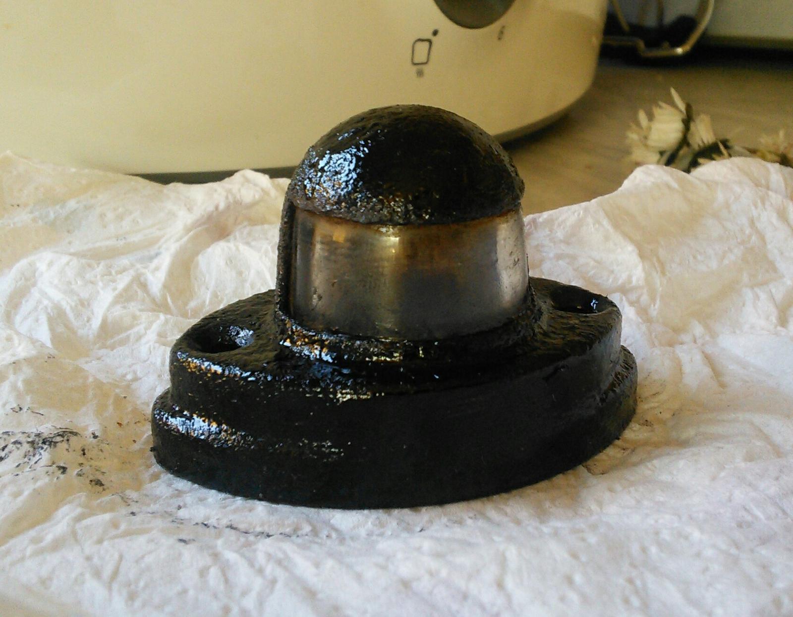

Remember the little spaceman courtesy light that LBF noted? Well he's come home with me for a rub down and some Hammerite...
Very cool stuff! glad you where able to get the spark plug out!, hope you stuffed something in the hole so crap cant fall into the engine? :)
also happy to see she is cleaning up nicely :)
I hope this torque wrench isn't been used to undo the nuts!? :o:?
Unless you don't care about that one being accurate anymore?
Yup, I did.
I'm afraid it has. It's old, cost a few pounds, the head always falls out and I had it set on 100.  I have a newer low range one (useful for many Zetec bits) that I would not do this to!
It's only an old  Invacar ..it doesn't need to be that accurate .... :P
I tested mine (an old Norbar)  against my mates new Snap On  one and it was clicking off exactly the same time!!
I have to say I’m a huge advocate and fan of using tools beyond their original design remit.
Yes, it’d be lovely to have an anally arranged full compliment of tools; laid out to clearly identify your place on the spectrum - but there’s very little more satisfying than doing something with a cross headed screwdriver that was supposed to be done with a knife. (!)
Anyway, dreadful choice of car. They terrified me then and confuse me now. Again - this is what I come here for. Well done!
I also have one of those torque wrenches.
For a breaker bar. use a normal socket driver and a metal tube over the ratchet bar. Thus  aids the leverage force you want to put of said stuck nut.
Use a T-bar with an extension for tuff nuts, using an extension tube on a ratchet will result in a broken ratchet fairly quickly - all the force will be going through those tiny teeth on the ratchet.
