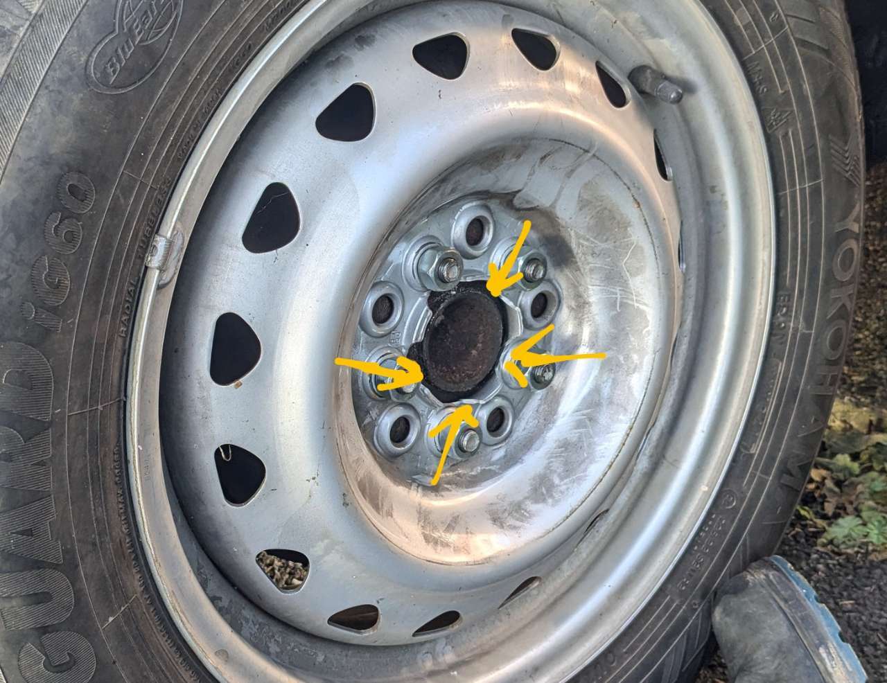

Thanks man. As soon as I saw they existed I decided I must have some. Unfortunately the centre caps are so brittle that one has already snapped a bit. Not sure how long they'll last.
I have had a search and center caps for steel rims like yours look almost impossible to find even in the common 4x100 that my Hyundai has.
That makes me sad.
That makes me sad.
Thanks man. That's very kind. These ones are super specific with deep tabs that snap into the recesses in the wheel centre. They hold REALY firm, which causes them to crack when you have to remove them to nip the nuts up.
Would it be possible to 3d print new ones?
I suppose anything is possible. Definitely worth looking into further. I hadn't considered that as an option. Might have to do it as two pieces, but might well work.

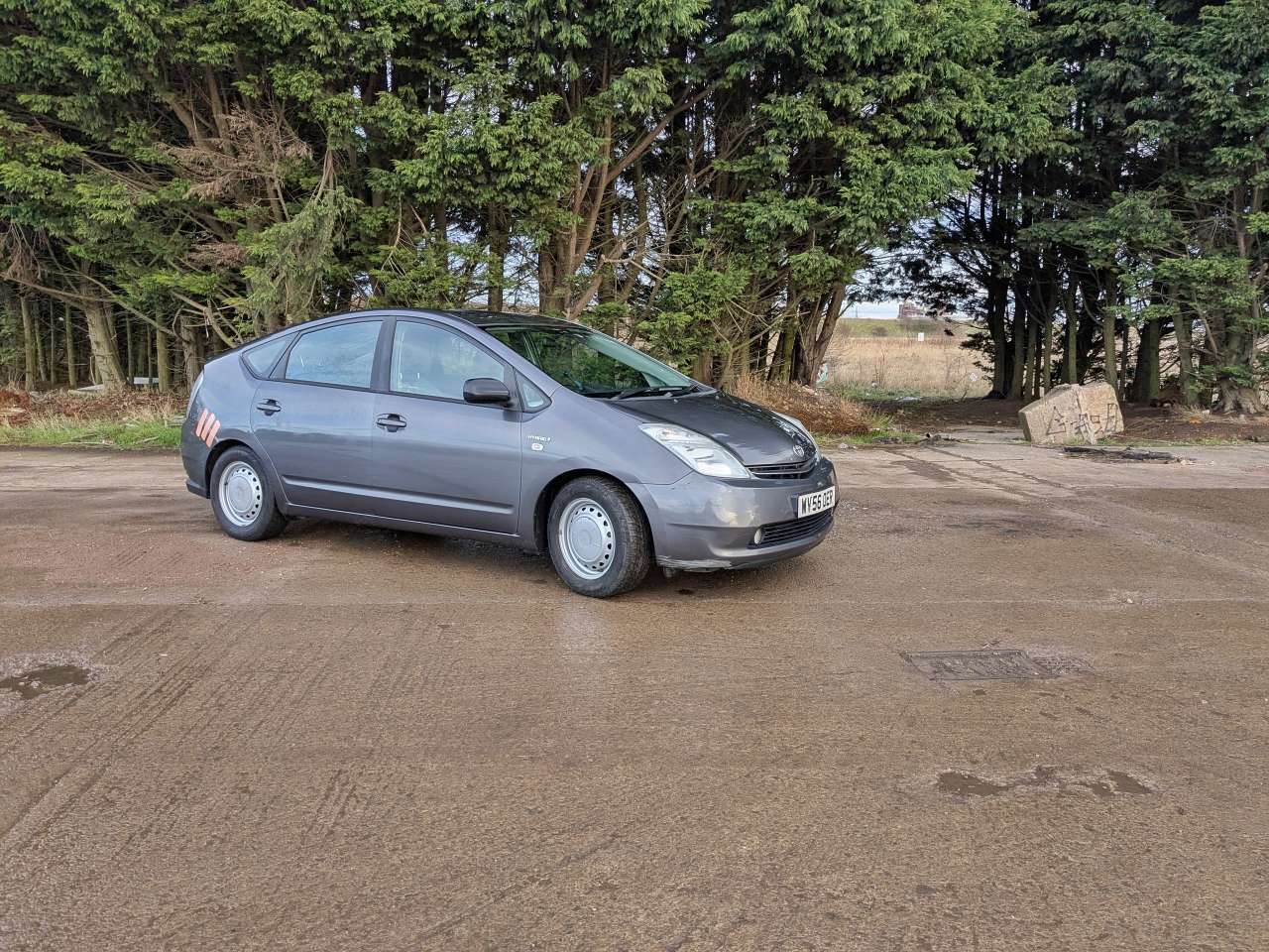

Artist's* rendition:
Can't believe Toyota didn't do it.

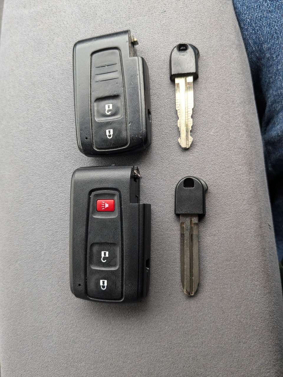

Top work on the keys, that kind of advanced level electronics / software/ witchcraft would give me the fear of both bricking an entire car and simultaneously being deleted from the grid and having to live like Gene Hackman in Enemy of the State.

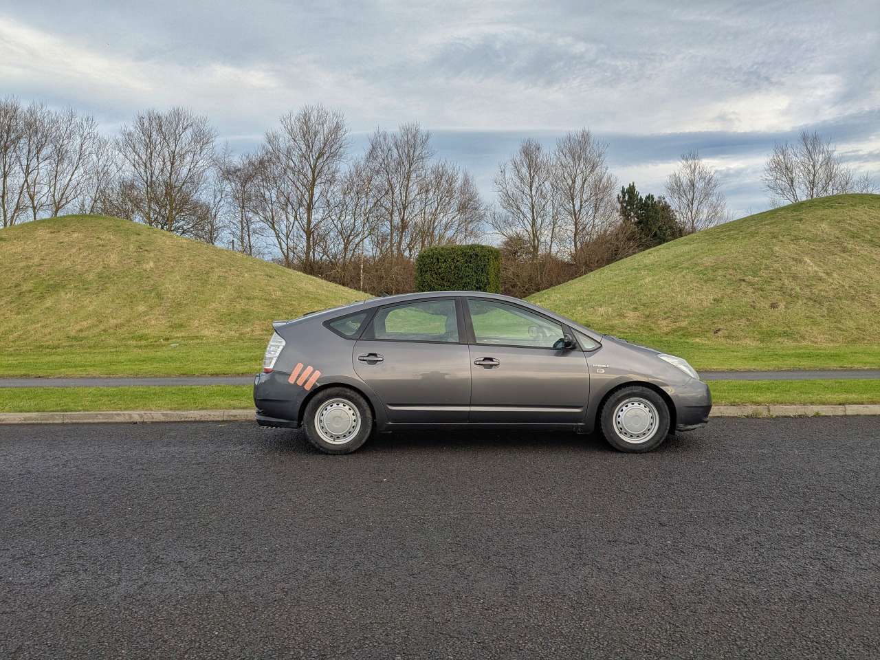

There is absolutely nothing to report with the Prius, other than I bought a new cd to pop in the six disc dashboard changer* and had it professionally washed by eager industrious men from across the sea.
Cleaned up, the steel wheels really shine. BUT DONT TAKE MY WORD FOR IT. LOOK AT THE PHONTOGRANPHS

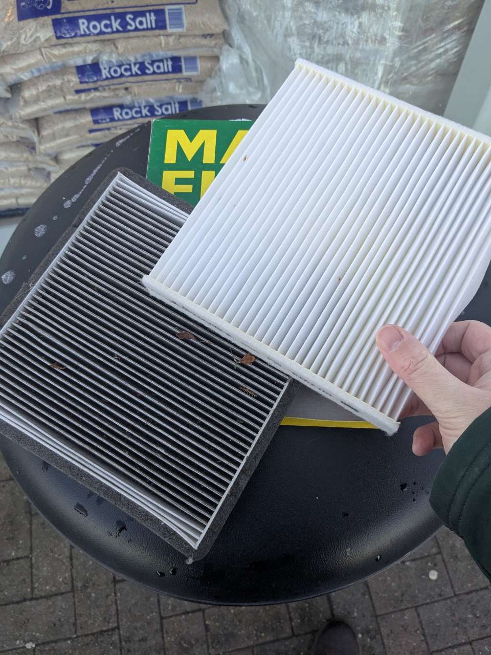

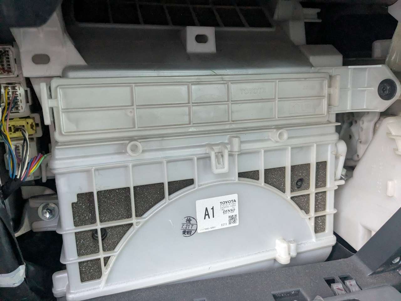

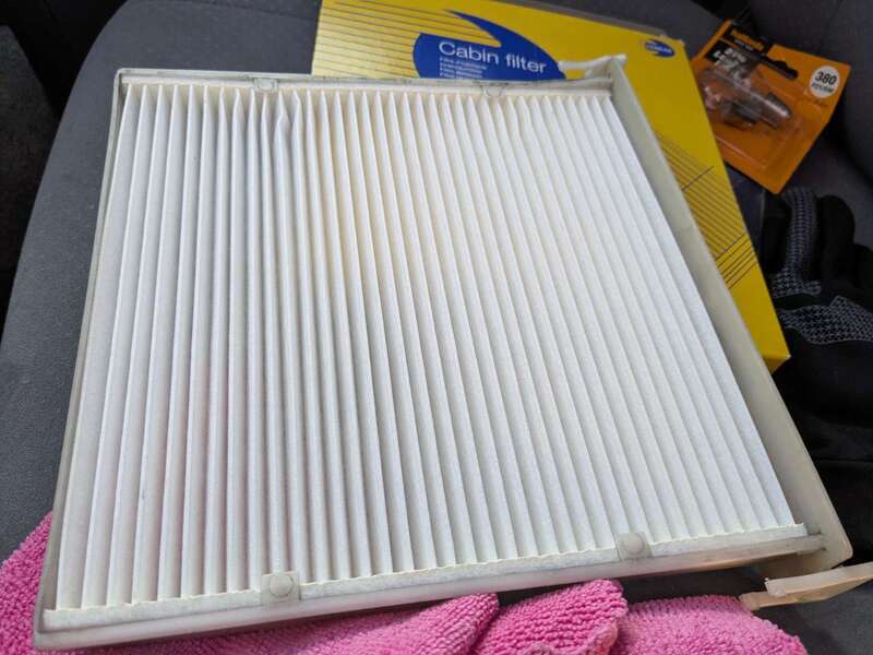

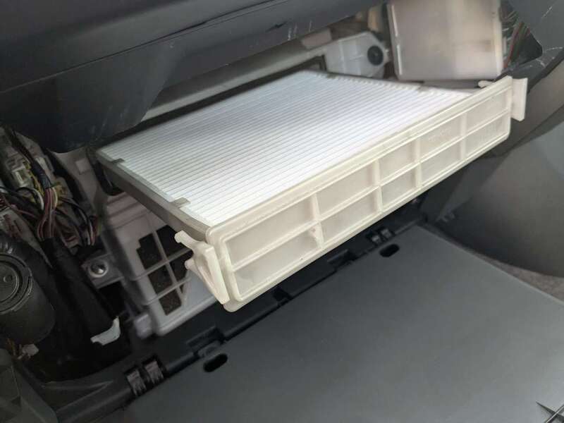

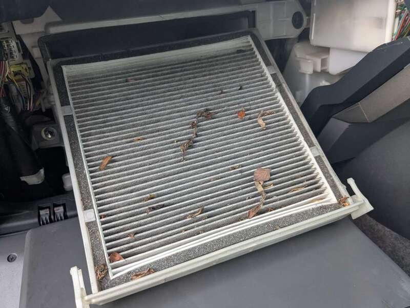

The car misted a bit in the wet so I checked my 1967 Almanac Of Car Home Maintenance, chapter 5, verse 2, which suggested changing the cabin filter.
To eBay! For a replacement that will definitely fit.
Toyotas being Toyotaey, the process required no tools and only about 4 minutes of your busy life.
We start in here. Move all your trip hop CDs or they'll fall on the floor.
Lift he tab, pull and win a prize.

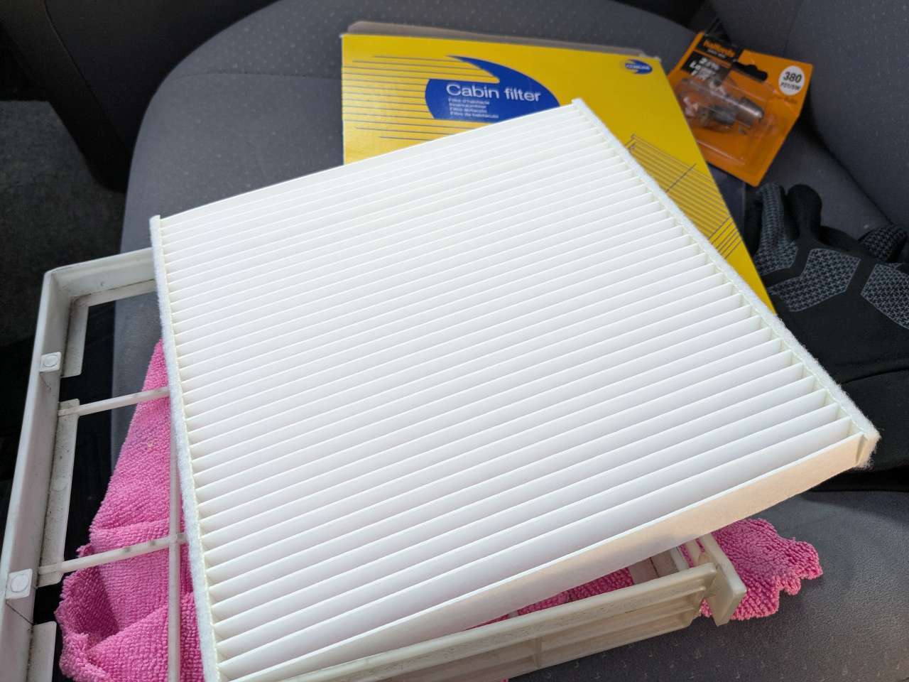

Wow I won an sycamore helicopter seed!
Old and new.
Hmmm. One of these things is not like the other. Wrong size. eBay fail.
Try using the actual part number on Autodoc.
This looks more promising.
In.
More in.
Sorted!

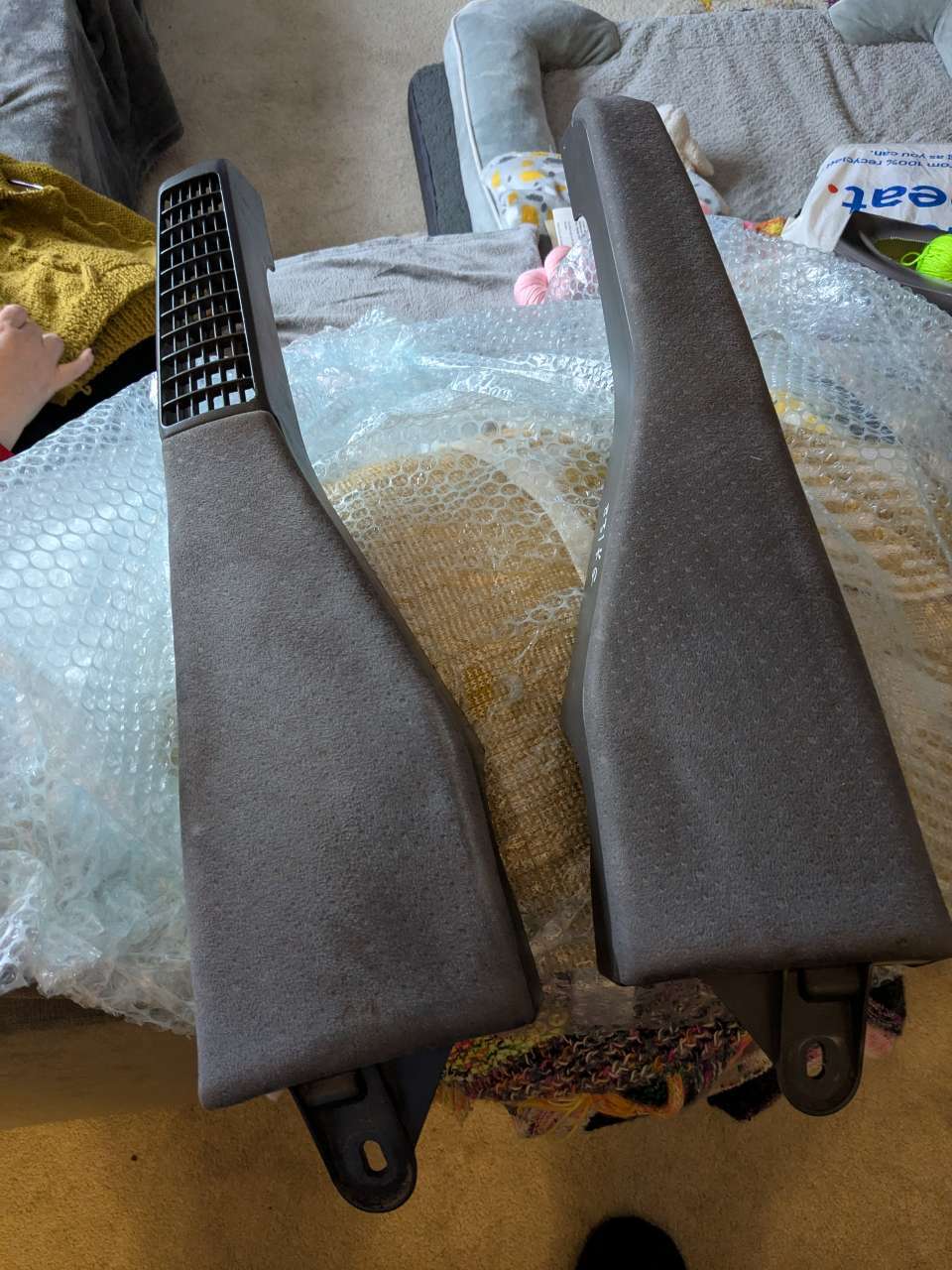

Next up is a shipment hot in from the former eastern bloc. All the way from sunny Lithuania.
None of the breakers in the UK could even be bothered to respond to me so I just went worldwide and flew shit bits across the continent.

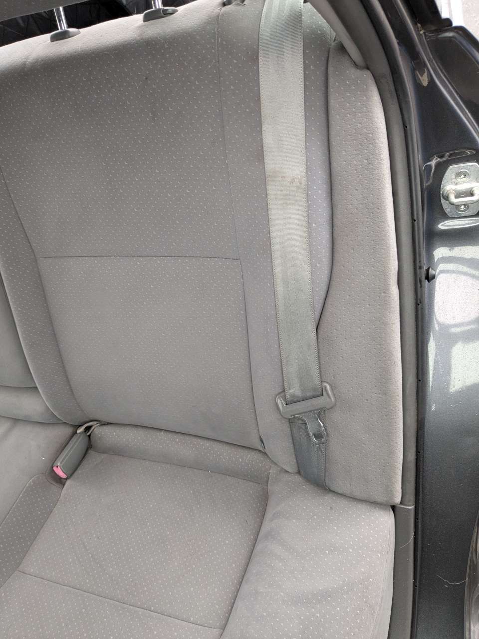

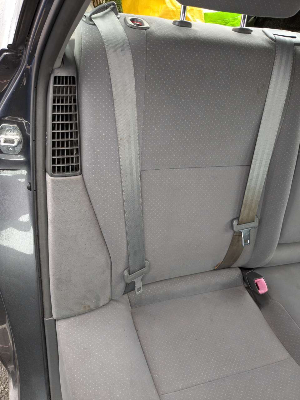

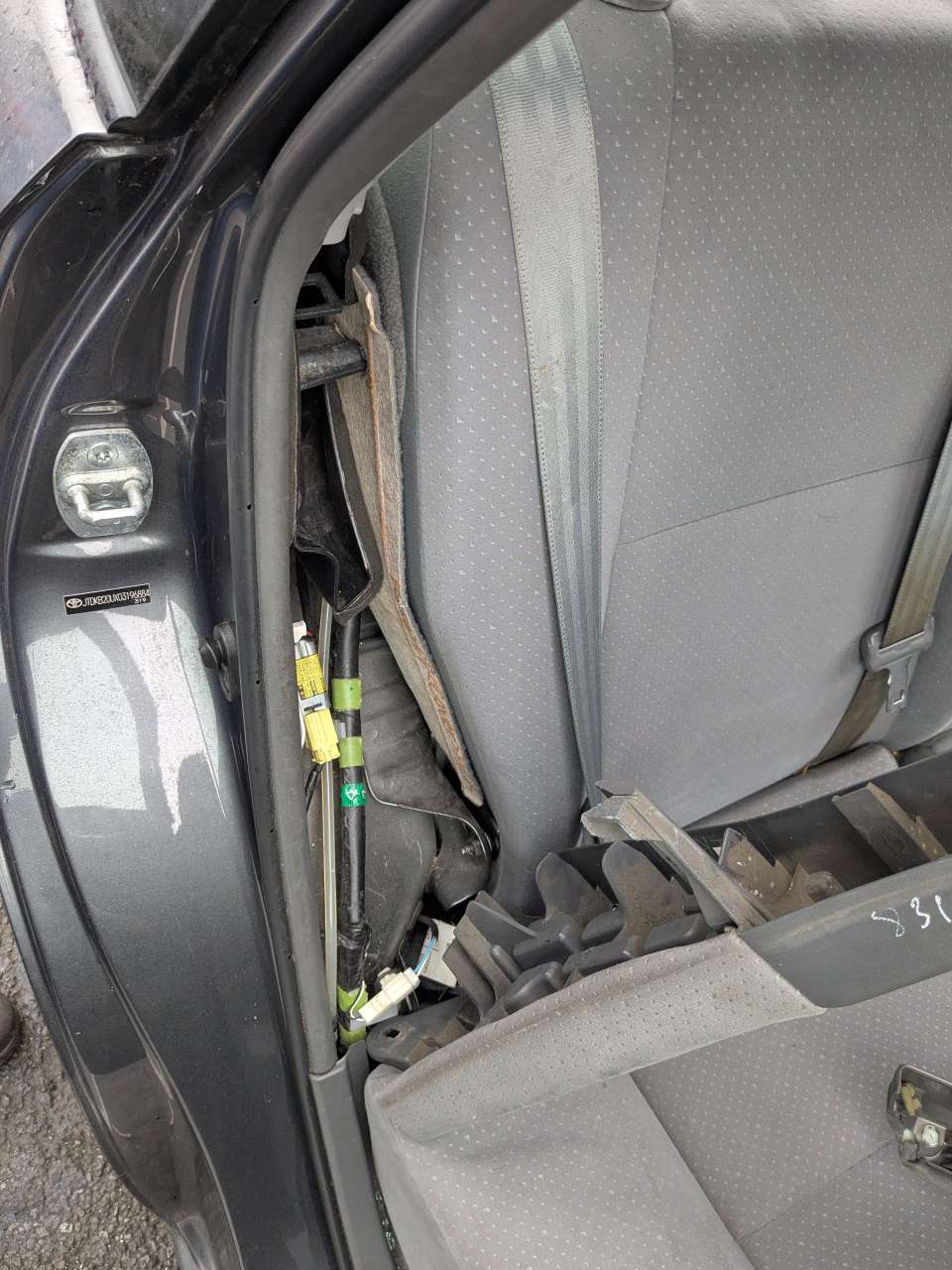

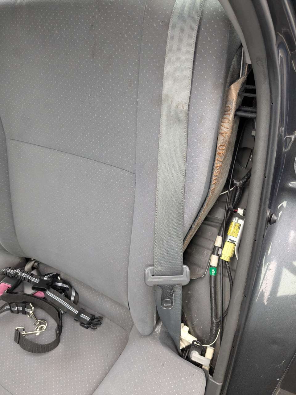

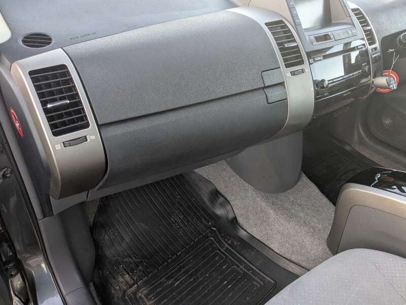

There are panels which go either side of the rear seatback and one side has a wee vent to keep the battery cool. They were missing whence I took pilotship of the car and I was worried that the dog might snag a toe-bean on a wire or pipe when hopping in or out so decision was made to make good.
Toe-beans for reference.
Before. Sad holes.
After. Fabric even almost matches. What are the odds?

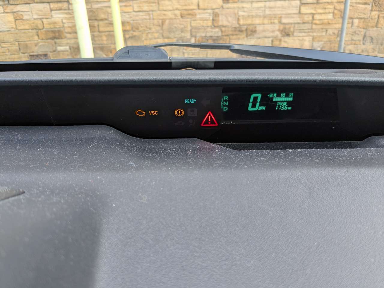

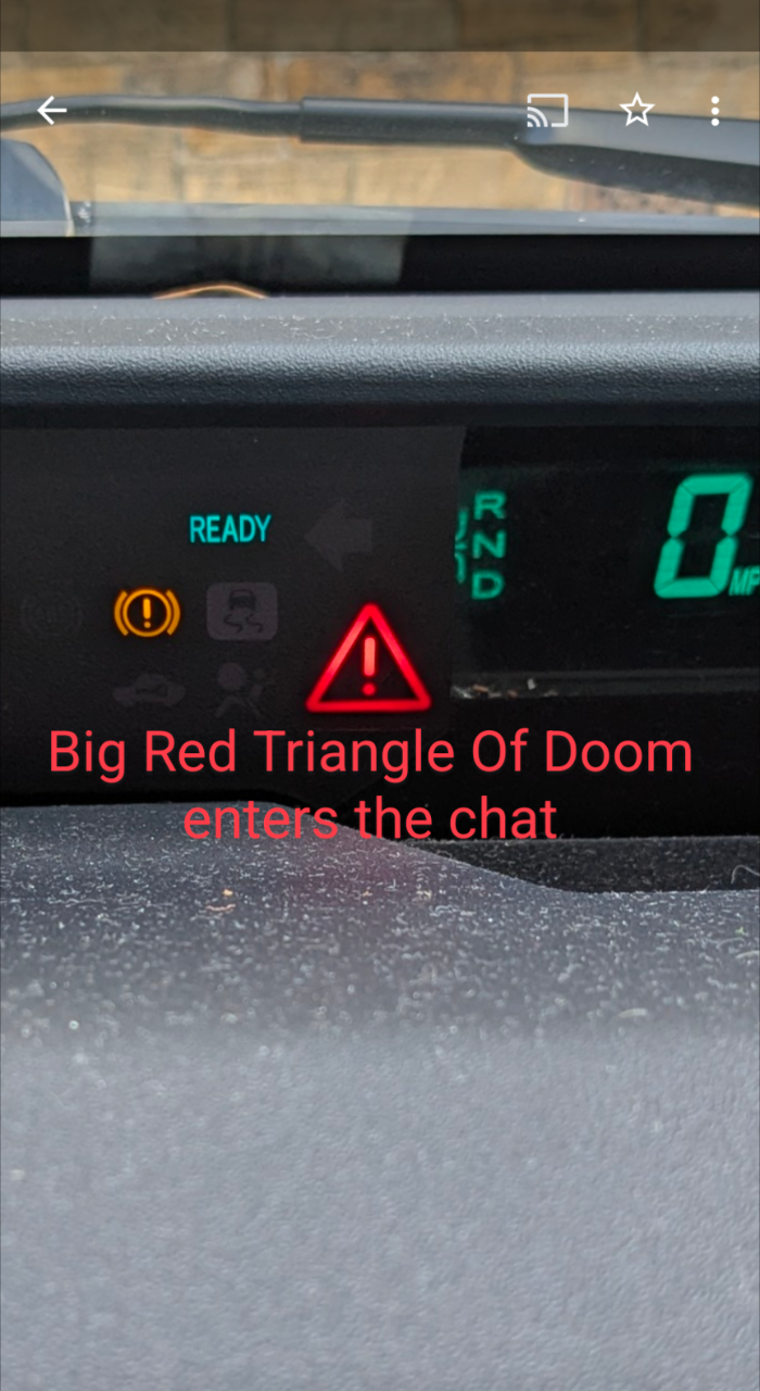

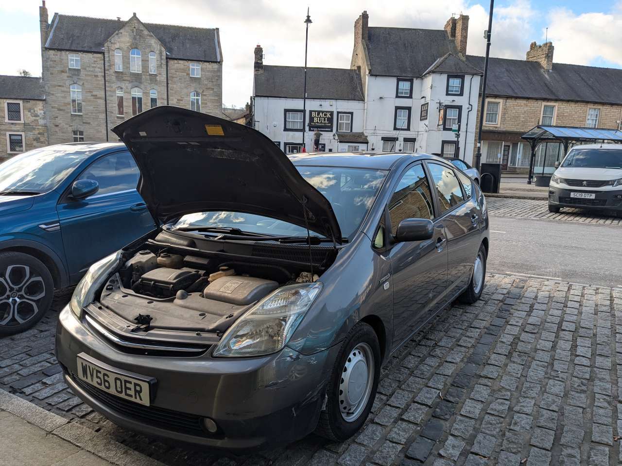

Well after 1500 trouble free miles, we have an issue.
Got most of the way to Twixfest today and the Prius dumped it's hybrid battery voltage and cut out when I pulled into a parking bay in Stanhope.
After visiting the local conveniences for a big long but thin panic poo, I went and try and restart it.
Well that's not good. Better check there's oil in it.
There is.

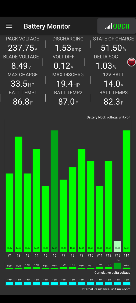

Scanned for codes and got a hat trick.
Looks like one of the cells has gone bad and put the pack out of balance. So much for the professionally refurbished battery then.
It runs but the hybrid system shuts down and it runs the battery fan super high as a precaution (packs not getting hot though)
Voltage difference is clear. Anything over 0.10v is bad.
Not sure where to go from here. ALL MODRINS ARE SHIT.

There are various outfits offering refurbished* prius batteries on FB for like £250-400, given the price I just assumed they stuck a better one in out of a scrapper.
Things like this make it sound within the capabilities of the DIYer or non-shit garage to swap a cell, and it seems like they're cheap enough on eBay:
https://www.reddit.com/r/prius/s/cr1AGTKLaO
https://www.ebay.co.uk/itm/395657954915
Hope you can get it sorted man. The problem is we're at the real cutting edge of shitin' here with elderly Priuseses and electrics so it's not like there are too many people out there doing high voltage lithium danger DIY to copy off.
8 minutes ago, Dave_Q said:
Super sad times man.
Yeah, you're echoing my own thoughts really.
I think I'm gonna have to buy something else in a panicky, shaking my fist at the sky king of fashion, then have a go at changing a cell, or the pack on the cheap.
I've got too much money in it to just bail it. And it's such a decent appliance when it's on a happy volt balance.

Didn't @jonny69 do this with his insight not so long ago. That and a mates lad having a shop sort out his electric asbo bike battery is about all i know on the subject though gonna stick my neck out and say its definitely doable.
7 minutes ago, Jenson Velcro said:
Sorry to hear of the problems but glad you will get it fixed. I’m very interested to learn what can be done to fix this sort of technology . I hope it’s not too ruinous financially.
I'm pretty sure it's just change one of the cells in the battery pack. They're all modular and the cells lift out. It's probably far more complex than that but in theory the main thing to worry about is shooting 50,000 volts across your heart and exploding your head like a raw egg in a microwave.
It's about methodical testing and documenting, but mostly patience to charge and discharge and document individual parts.
