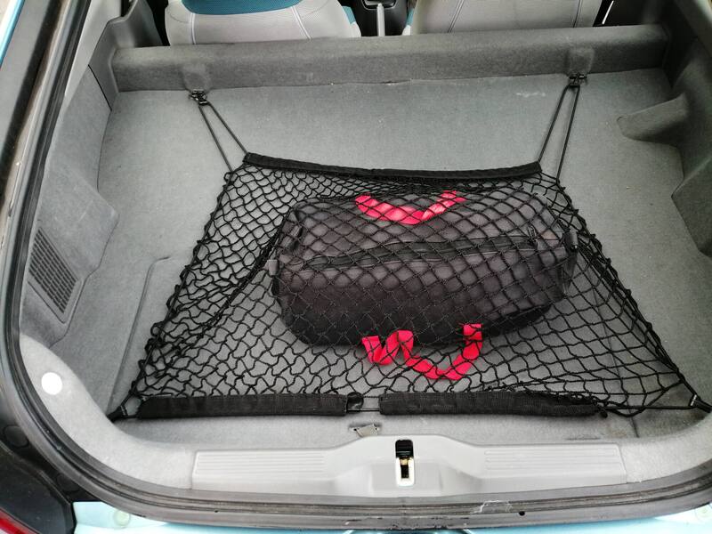

Super handy tie down net.
I hope that isn't your dog under that net.
It's a kit bag full of 45lbs of mashed up Dundee cake and Toblerone.

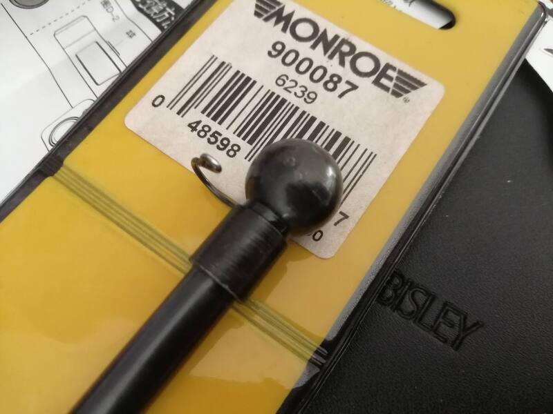

One of the areas available for improvement on the Insight included the rear hatch struts.
The hatch closing on your head is only funny the first 20 or 30 times. I cannot spare the reduction of intelligence that continued head trauma can cause so I got on the internet's and looked for some appropriate parts for a Gen1 Honda Insight.
*Alexa, can you find me some hatch struts for a Gen1 Honda Insight?*
More searching occured.
Then eventually, all the way from the land of the rising cholesterol, arrived:
With FREE FRIG MAGNET
There is a place in Derby that ‘makes’ the struts (I bet they just import from China). I found I had to ring them a couple of times to get a helpful bod who was happy to check my dimensions against what they do but got the 205 sorted, being the drop top they are different and I couldn’t find them anywhere. If you are struggling I can try and dig out the details.
Inside was some PREMIUM BRAND POKEY BOIS.

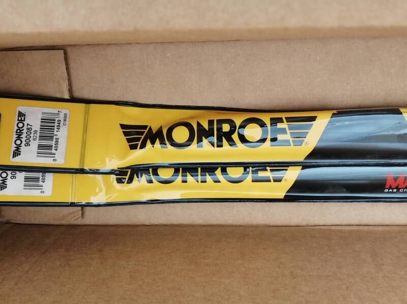

How much lift?
MAX. THATS HOW MUCH LIFT. FUCKING MAX.  YOU CANT GET MORE THAN THAT.

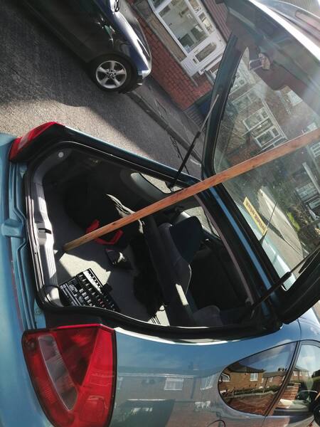

It's blowing a gale and I'm hung over so I guess let's get in on like naked ping-pong.
HALF OF ONE SPANNER HBOL RATING.
Real mechanics please look away now.
Prop.
Assemble toolery.
Crack 14 orf at the bottom end.

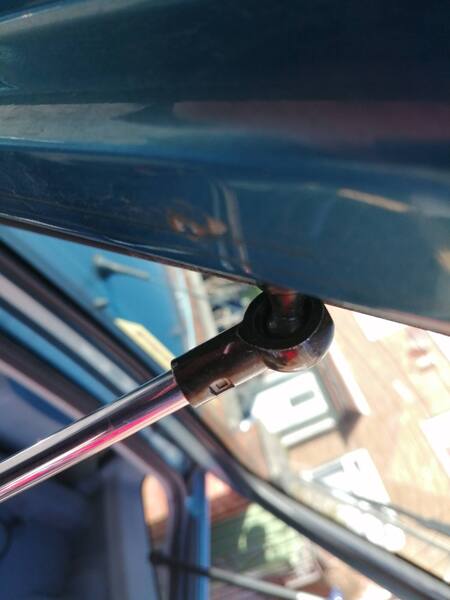

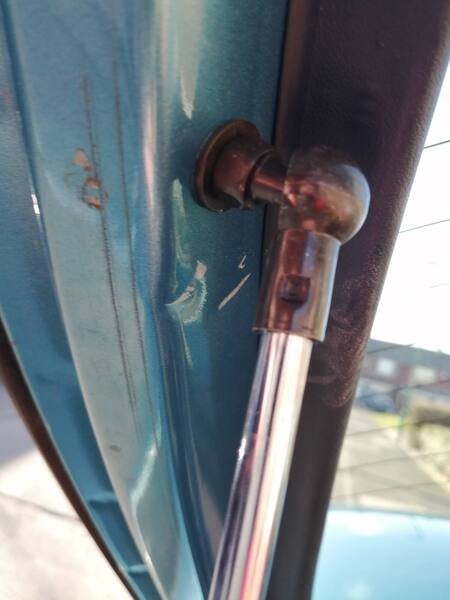

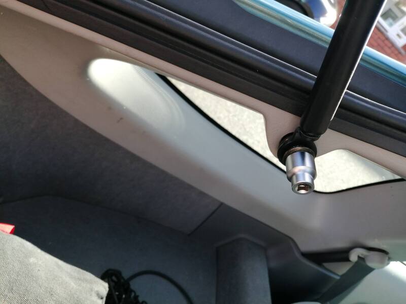

Then I got stuck. How can you get stuck changing hatch struts?! Well I can. Because I'm an idiot.
I couldn't loose the ball joint on the other end. And prying it just damaged the surrounding area.
Further brute force was considered, then I asked someone on the internet.

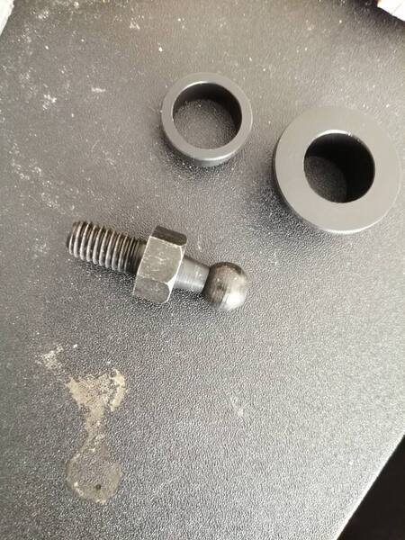

Turns out you must wind out the bolt the ball joint is attached to in order to release it from the car.
Ah. Now this bit on the replacement makes sense.

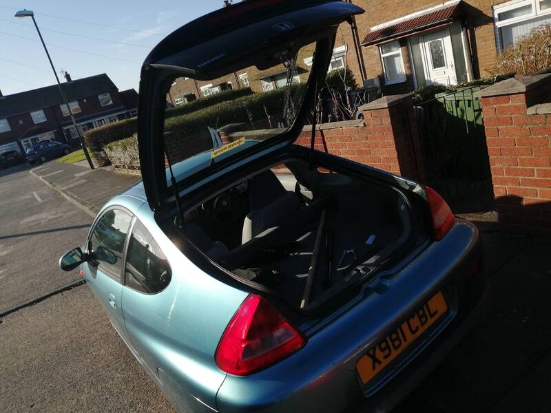

Wound out fine and whanged the new ones in.
Ta-da!
Now yawns fine under its own strength.
Only got stuck once too.  Not bragging or owt though.

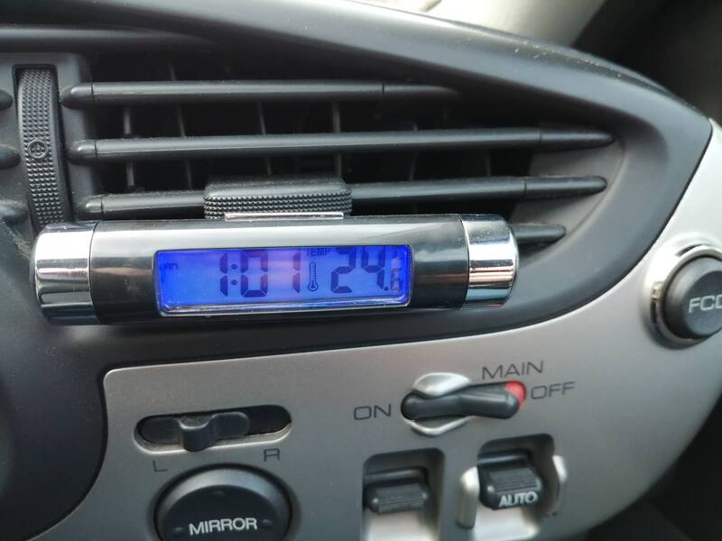

The one thing that the interior lacks (somehow) is a clock. There's not even one on the radio.
Fortunately the Chinese are a fantastic bunch of lads and they sorted me out in a matter of weeks.
Threw in an ambient temp gauge too.
Now I know exactly how late for work I am and how cold it is outside.
Are the hatch struts ok and not too strong?
When I replaced the struts on my Sera with shiny new ones they were so powerful it flung the lid up ferociously , so I ended up fitting one new one instead of two.
I fitted one and it still dropped in the wind so put both on. They are strong (MAX LIFT), but catching it on the way up is second nature to me for some reason. I'm happy enough with the balance of them for what they cost, compared to what Honda would want for something with an OEM part number.

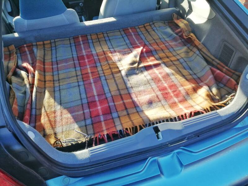

Also added a bit of colour to the load area. I've always wanted a proper giffer style car blanket but never had a car that one looked right in. They just look stupid on a hatchback parcel shelf.
I do love this look though.
