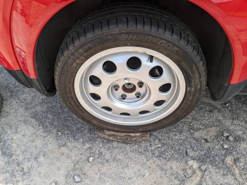

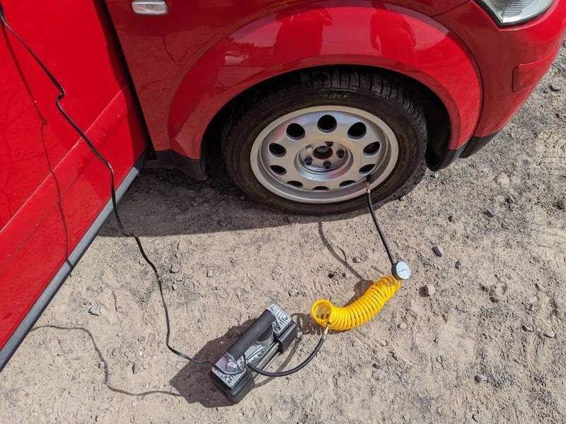

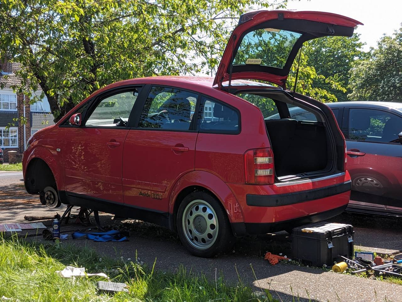

While we were there, me and @320touring had a roll about in the gravel in the scorching summer heat and swapped the wheels for 15 lightweight pepperpots.
The jack was too tall to fit under the car so some stones were employed under the wheel to give a little clearance.
Stuck some air in and job jobbed.

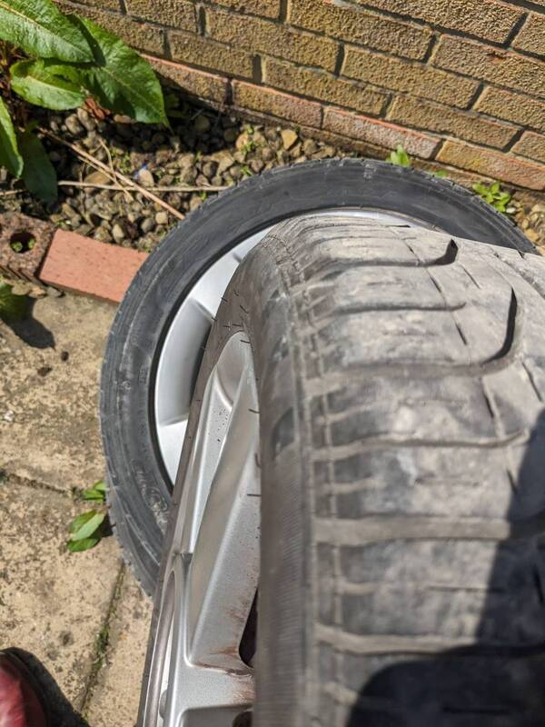

All in all, very pleased with the results. One of the tyres that came off was bulged all the way round the sidewall so a lucky escape! (foreshadowing)
Hard to tell in the pic maybe.
Looks much improved I think.

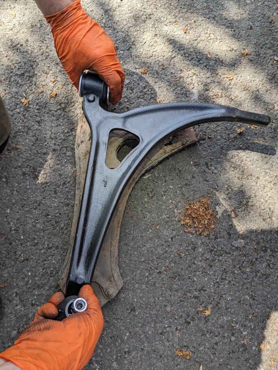

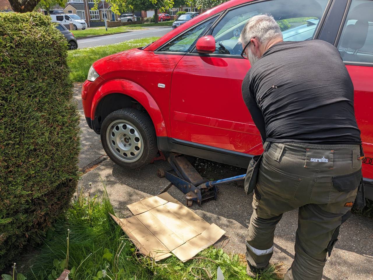

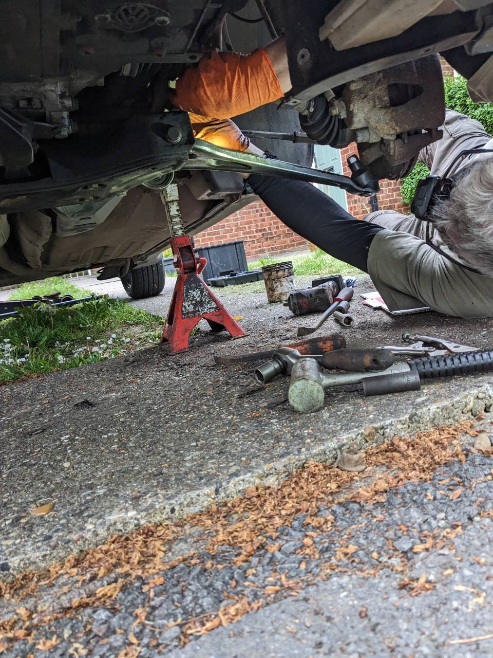

A plan was duly devised to make this rig roadable. Not by me mind, but by car fixery legend @Jimbob McGregor .
The "have tools, will travel" hero volunteered to have a good go at getting the homicidal, suicidal, genocidal Audi A2 in fit enough shape to drive to the garage.

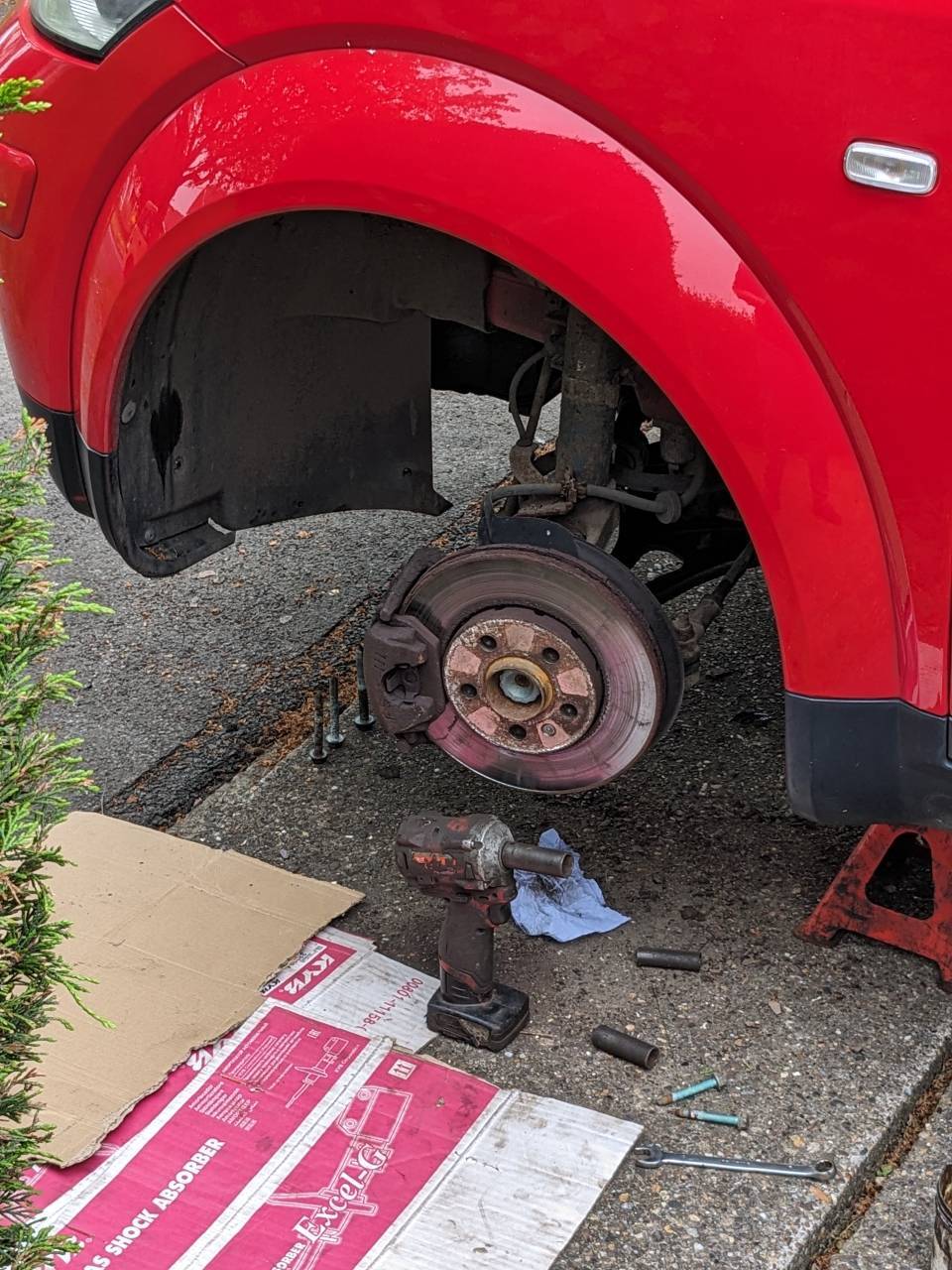

That meant getting the arms off.
A man of great taste and endeavour ariveth.
Hup!
Decent arse. 8/10.
That's not good
Actually that isn't even attached at all.
It came out easy. Well, this bit did.
This bit decided it would prefer to remain attached to the car.
Oft you fuck then, you absolute wishbone-end.
Wow. What's it like on the other side?
Have a listen to this gem by Doves, which was specifically written about Audi A2 front arms.
Out with the old, in with the new.
New ones are cast, rather than pressed like the originals, so they should see us all out.

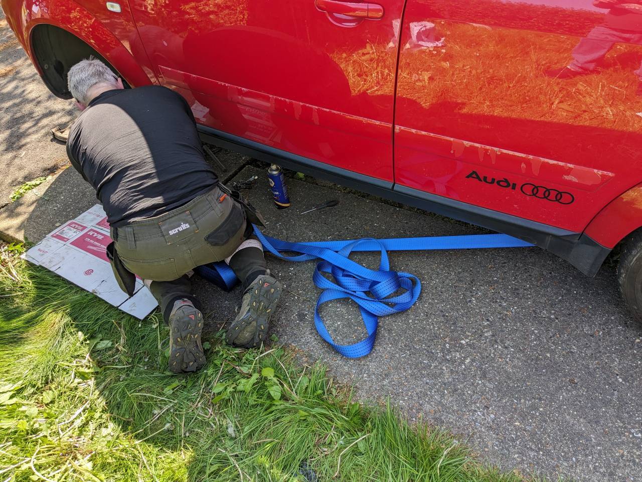

Unfortunately at this point, the new arm became reluctant to push into the bush.
Ever helpfull I suggested pulling it in with a ratchet strap.
"Great idea. Do you have one?"
Me: no.
So. We hopped in the veg munching puglet and headed for the nearest trading estate.
Wood knob
Summer Strap shopping.
Attempts were made to pull it home from a couple of angles but to no avail.
So we paused for a pie break and a think.
Emboldened by my earlier idea, I suggested pushing it into the nearest sea. A man not to be beaten, @Jimbob McGregor suggested taking the aluminum mounting console door dah off, then fucking it home in the press. Which is in his garage, an hour away.

It looks similar, but not failed yet. Definitely needs changed on the other side too.
The ball joint didn't want to play on the drives side so the plan was to get the passenger side done, so it's drivable, then drive it to Jimbobs garage and do the rest there. The press will be needed for sure.
