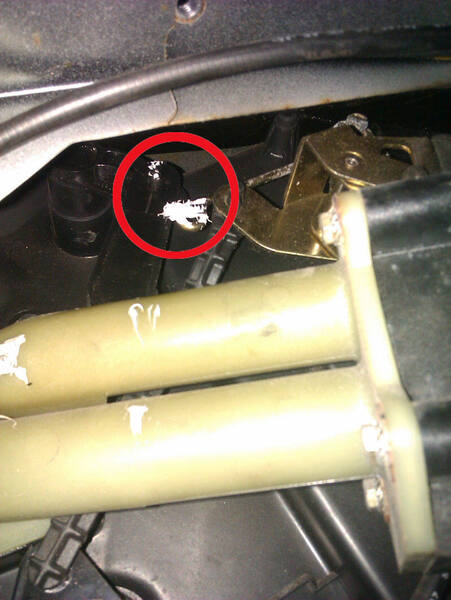

It does make a good click when urned to full, and clicks when turned back to regular.  There's air coming out the vents at all speeds, and in the correct locations as selected, it's just a bit asthmatic.  Since all the settings are actually working, I didn't think there'd be any point doing the mod as mentioned above, also my circuit board as you'll have seen from the above shots, is of a different design to the one in the tutorial so I'd have to figure out how to apply that particular mod to my particular board if I did go that route.  I guess I just have a weak blower fan in this car, not a huge problem since I've got windows that open.
If it clicks then it sounds like your board does actuate the relay anyway. Windows open it is then, or find the rare twin blower setup from an air con BX!
Not that I’m an expert, but mine had a dribble of air coming out of it when I first brought it, even with the fan on full speed. I found that the  cable that opens the flap in the air box had not been connected  to the fan switch, so it was not opening as the fan speed increased. It now has a really good flow of air now. You’ve probably checked this any way.
No blocked pollen filter or is the BX blower just shit?
It's worth checking the flap under the heater motor is opening. If this doesn't open it significantly reduces the air flow. It's connected to the heater blender controls and can seize or the control rod fails.
No pollen filter, and I've never considered the blowers to be shit. I hadn't thought of the flap that others mention, so a good shout!
Hadn't thought to check the heater flap, perhaps it's that.  The fresh air flaps are all working as they should, checked those while everything was apart.  Am I going to have to dismantle the dashboard again, or do you think I can get to that by removing the centre console instead?  Hopefully I can get to it via the centre console since I want to pull that out for a deep clean anyway.
You can check if the flap is working by lifting the heater motor up under the bonnet iirc. If it's become disconnected I'd just jam it open somehow as the rod connection to the heater unit is down by the clutch pedal and virtually inaccessible.
Had a free five minutes to have another look, managed to unbolt the heater box and move it just enough to get access to the flap without removing the wiper arm or scuttle panel.  The flap is very floppy, no resistance at all, so it seems likely it's not connected after all.  I set the flap to the open position, bolted the heater box back down, and the blower output was much improved, steadily weakening as the flap returned to the off position on its own thanks to things like physics and gravity.  Problem found, at least, I'll try and fettle it when I've a little more time.

The flap should be connected to the middle dial on the heater controls. It opens proportional to the fan..
It is connected at the dial end.  It doesn't seem to be connected at the flap end, so something between the two has either come off, or has broken.
Great success!  I located and fixed the issue with the blower fan flap operation, thanks to the helpful hint from Dean about having to fight for space with the pedals in the footwell.  If you stick your head right in the footwell and look down the side of the centre console where Citroen didn't bother to put a trim panel, you can see a bunch of Stuff, part of which is a small black plastic peg and a short metal rod with an eye on one end.  Now, it looks like someone has had this issue before and tried to resolve it with a blob of sealant but, due to the nature of the operation of this part, that's only worked for so long before popping off so I'll be using a push-fit spring clip fixing, like you use on emblem pegs, to hold this all together when I'm in the same place as the clips.  I've circled the two bits that need to be connected, this was a faff because I couldn't actually see what I was taking a photo of because you get in your own way and to replace this you need to do it blind, which is just super.
Before I got started, I manually operated the rod to see if it did what was expected and, when I found it did, after a bit of blind fumbling about, I got the peg in the hole.  Stop it.
Happily, full air flow now reinstated and the blower fan can get air all the way to my face properly now.  A relief that it was such a straightforward fix really and nice that I shan't need to dismantle bits of car.  By the time I'd done this it was getting dark so I got to see what the centre console actually looked like for the first time since redoing all that.  Looks like the cigarette lighter bulb has either blown, or the connector for it has come adrift, I'll pop the oddment tray out of the top of the dashboard and have a broggle when I've some light to work with, I bet the plug has come adrift a bit when I was putting everything back together.

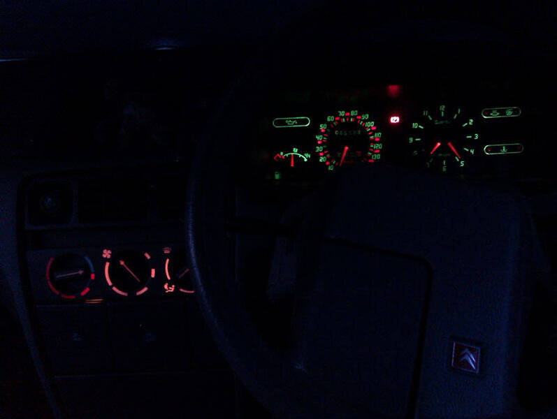

Rheostat affects the centre console as well as the instrument binnacle, which I didn't know, since I've never been in a BX where all the interior lights actually work.

Must be a common issue as I fixed Shonky's last year.
Should there be something on the end of that peg, do you know?  I imagine my old estate had this same issue, you know, because the blowers in that were rubbish in the same way.  Wish I'd known it was this simple a fix, not that it would have mattered with what else that car needed, poor thing.
I used one of those black aerated washers that push on and stay on, it's still holding good. I need to finish welding the c15 van then get shonky over for his head gasket change. I'm missing driving old French cars

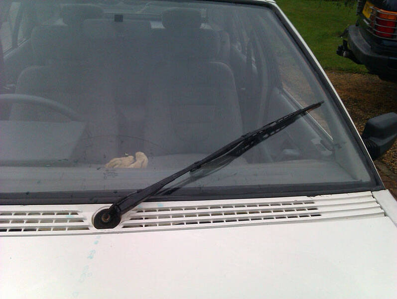

Wiper arm was dry enough to handle properly so that went back on and there are few things more satisfying than putting freshly painted wiper arms on a car.  You can see here the bit of tape that's repairing something on the washer pipe too, I haven't removed the tape since it's doing the job it needs to do, but I will need to replace that pipe anyway.  Ideas one what to get and where to get it from for this job are welcome, I was considering using just a length of rubber or silicone hose and stabbing some holes in it.
Chevronics do an aluminium replacement. I have a spare somewhere in the garage, if you can wait  until I get back from holiday at the end of the month.
I'm not in a rush, the thing works fine as it is.  Aluminium option sounds interesting.

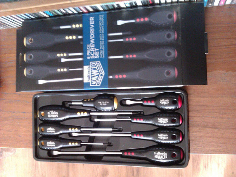

Finally bought myself a set of proper screwdrivers today, rather than relying on the set I've got that has bits you stick in a ratchet handle.  For years, I've just been borrowing everyone else's proper screwdrivers, and when a set like this is only £12.50 in an actual shop where I can go and buy them without waiting on a courier, it's hard to see why I didn't buy my own sooner.
Bit of an impulse purchase really since I was buying paint and the screwdrivers were right there next to the paint.  Tried them out when I got home by removing the rear reflective panel on the BX.  I like the BX both with and without the reflective panel so I'll keep the panel back for now unless someone desperately wants it or I decide it's getting in the way and I don't want to refit it to the car.  I'm seriously considering getting the tools and materials to exactly replicate the original number plates on the car, as per the one on the rear, because I'm loathe to put a modern generic plate on or an anachronistic older style plate.  You can also see the chrome pen I used on the badges has worn off the Citroen badge almost completely while the BX badge remains pretty much unscathed, not really sure why that would be, so I'll be trying again with these another day and using some sealant on top to prevent the paint rubbing off.
