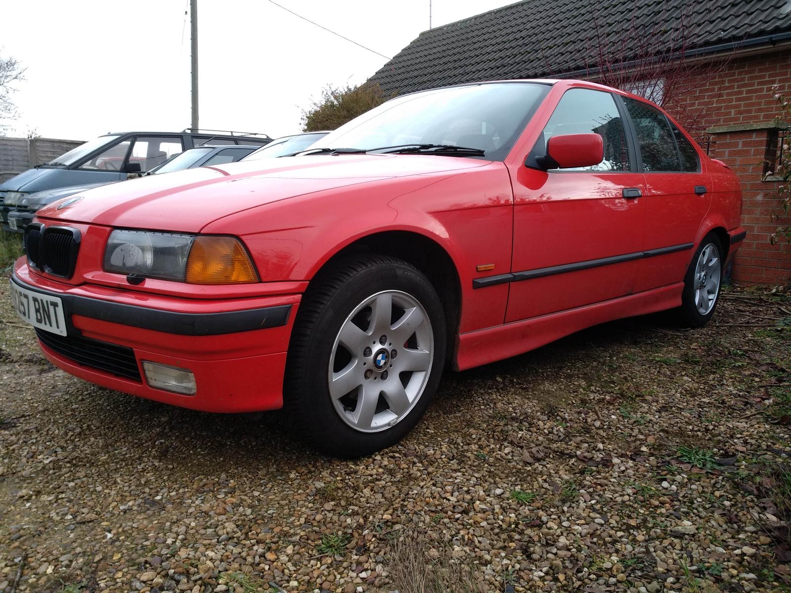

The original task is now complete, last night I collected 5x e46 wheels with winter tyres, 4x Continental winter contact with 8mm and 1x Goodyear with 6mm. I like having a full size spare with a usable tyre.
I'm not a fan of the wheels but they're inoffensive and I bought them for the tyres.
There's a slight difference in size from the originals, but not much, the originals were 205/60/15 these are 205/55/16
I might have to get the tracking looked at. The fronts I took off were wearing on the outer edge and the rears were wearing on the inner edges. Swapping front to back when I put the old wheels back on should sort those out ;)

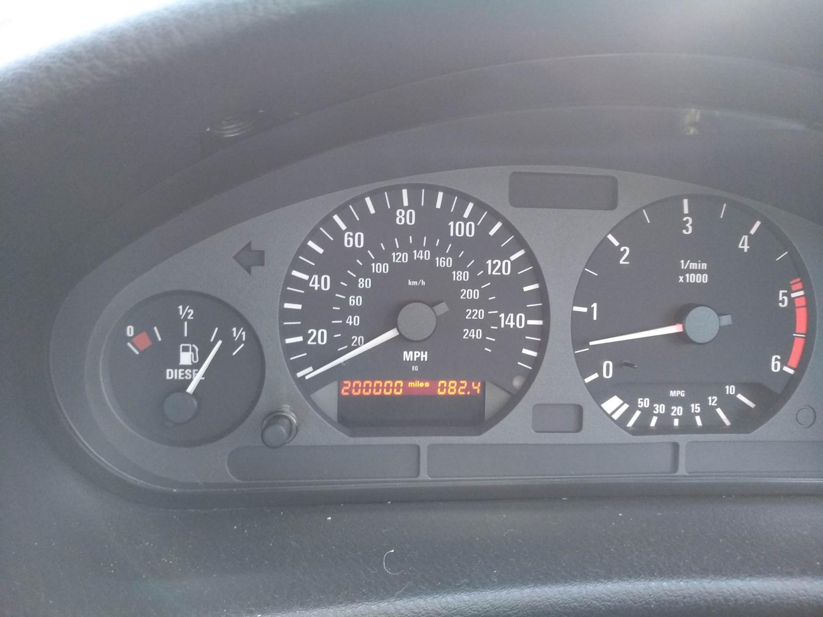

On the way home this happened:
post-4715-0-00682100-1545490281_thumb.jpg post-4715-0-08227800-1545490323_thumb.jpg

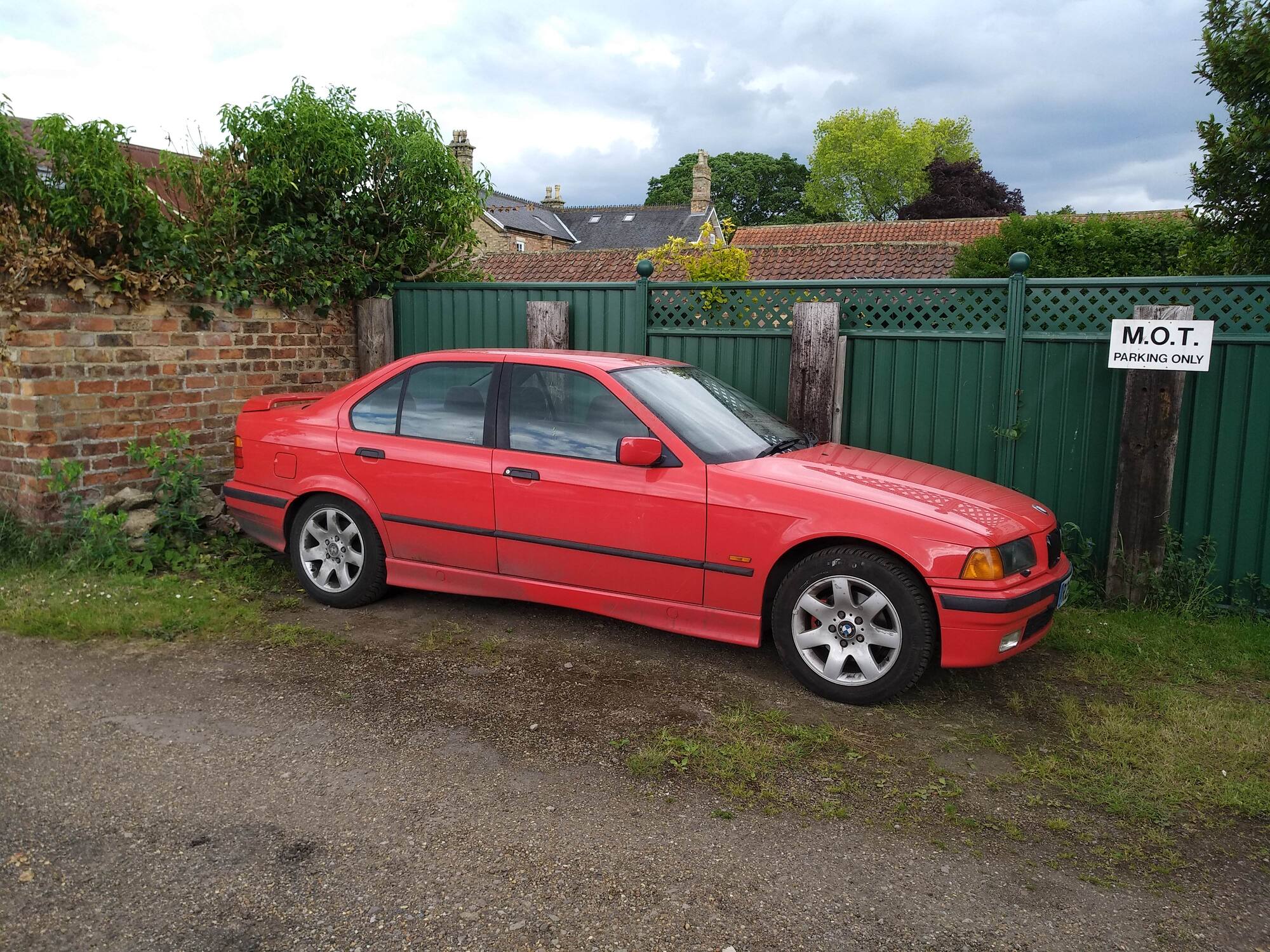

Update time :
It's now on 203k so 5k or so done since purchase.
I took this over to Germany in February and clocked up a couple of thousand miles in it before returning home in minor disgrace.
Whilst it was on the continent the brake judder got very bad, especially on the autobahn when doing 100mph+. It also started losing coolant, it never over heated massively and got me home without assistance, so it wasn't too bad. One thing I did learn is that e36s don't have a low coolant warning light. I don't know why, I just assumed all cars did. Anyhoo it's loosing coolant, not gushing, but it lost over 0.5l between Cologne and Lincolnshire.
Today we tried to rectify some things, I'd say partial success.
Find and fix coolant escape.
Brake judder - New discs and pads bought from ECP for £50
MOT - This expired last month, I wasn't aware of anything that would be a definite fail.
1. We ran the car up to temp but couldn't see anywhere that coolant has been escaping, so slight fail.
New expansion cap has been ordered as the thought is the seal could be gone in there. 5l Container full of water left in boot.
2. We changed the front discs and pads, this went relatively ok, but the nsf piston had some surface rust.
New piston and rebuild kit has been ordered.
3. MOT  -  PASS, yay!
Some slightly crusty brake pipes at the rear were discovered these have been added to the "to do list"
To do list; NSF caliper rebuild, brake pipes at back of car and gearbox filter and fluid change, and refit summer wheels/tyres.
