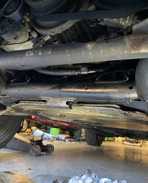

Got a bit tired of this leaving oil in its wake everywhere it goes so whipped the undertray off to have a look
It’s absolutely covered in oil everywhere. Don’t have high enough axle stands and cba with the mess so I’ve booked it in to a specialist next week!

Bottom pully?
Clean the undertray off and put one of those oil absorbing pads on there. Someone had done that on a T5 I bought and it took 4 months before I noticed the fairly massive oil leak.

I feel your pain.
Just been through this with my Forester. Wallet took a bit of a beating but there's no way in reality I could have (or would have) tackled it.
Mine was the sump gasket and while it was off the engine mounting was shot so that was replaced as well.
Good luck on the diagnosis.

How much did that cost? I gather it’s not a small job.
It was an involved job. I let my local indy BMW specialist tackle it. It was a day's work IIRC and around the £300 mark.
That’s not too bad really. Hoping that BMW specialists are more affordable than Porsche ones :D

It’ll be the oil filter housing, the sump or both.
My massive leak a couple of years back on the v6 omega was the oil filter housing.  As luck would have it, earlier versions had a screw on oil filter, so with the correct adaptor, which was maybe £8, I was able to junk.the oil filter housing altogether.
Hoping you have it as easy as I had it.
That's a shanner about the oil leak(s). Is the oil filter housing a bugger to get to on these?
To remove it and replace the gasket, yeah it’s a bit of a job. Not as bad as the sump mind.
Bumhats. The entire front had to come off our Mini just to replace a £5 oil filter housing gasket, inevitable labour charges ensued.

Looks like it’s the OFH gasket. Will be a good 2-3 hours labour including the time to clean it up!
Huh. Oh well, at least it's fixable, shame it will have to dent your wallet.
