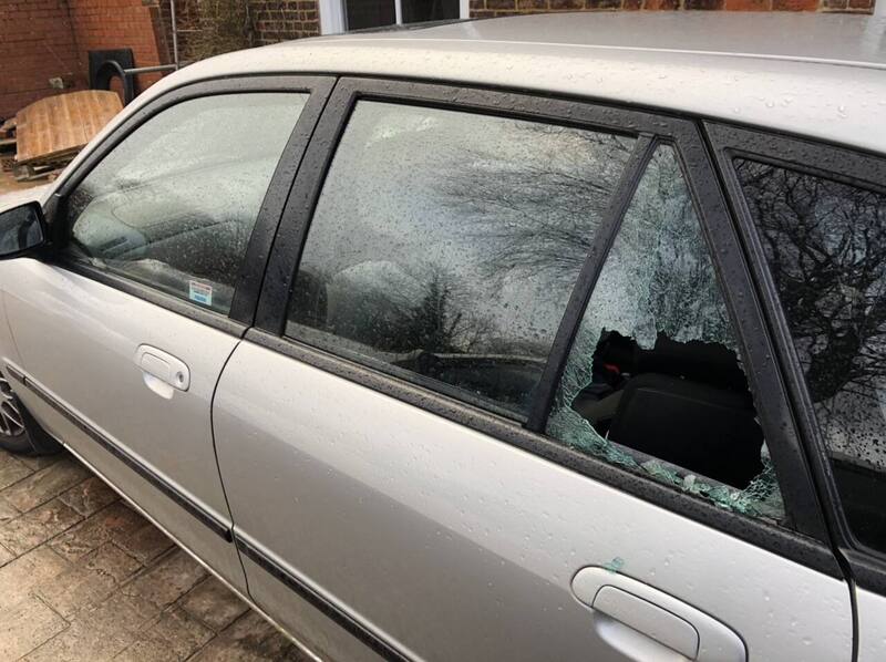

£27 pounds and three days later, this arrived.
So as the weather seemed pretty mild* this afternoon I figured I’d get out there and get the whole window situation resolved.
Also an excuse to test my absurd quantity of Aldi birthday screwdrivers, collapsy front seat makes excellent bench.
First  job was actually pushing and steering the ungrateful bastard into a position so I could get proper access to the door as a week and bit of doing nothing had drained the battery so it wouldn’t start.

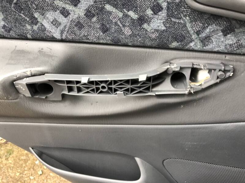

Once done, sniffing around the door a few screws and studs were spotted but the arm required YouTube and a lot of swearing, its a spring to pop off the top but it was stiff as and required lots of shouting and screaming and I nicked the vinyl :( as it finally came out.

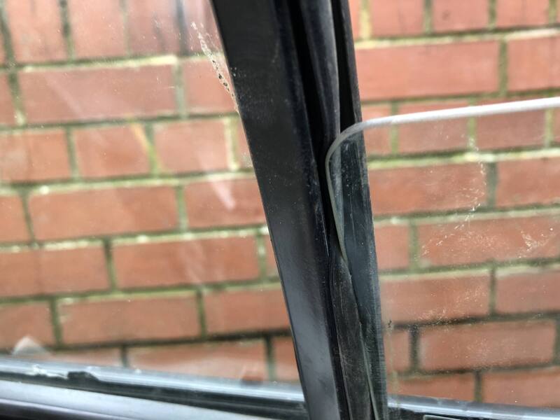

Door off and a bit of head scratching, then decided to unbolt the window guide and lever it over so I could the quarter light in.
Pulling down the bar a bit didn’t give me enough room so I pulled more and revealed a random screw hole with no screw in it and found the screw under the door seal.
Unconcerned* it was turning into one of those ‘it’s going to get a lot worse before it gets better’ jobs, I rolled down the window more and twisted the bar out of the way to get the window in and then just had to get the main window back into the guides.
Took a bit of brute force to get enough of it back in and then wind it down to guide the rest in. Total fluke I left the window halfway down and not at the bottom or that would have been a twat and meant doing it again.
Found a gap on the outside and after looking around, found a random little clip on the floor, required a bit of persuading to fit back in, should have added it before the windows but hey ho.

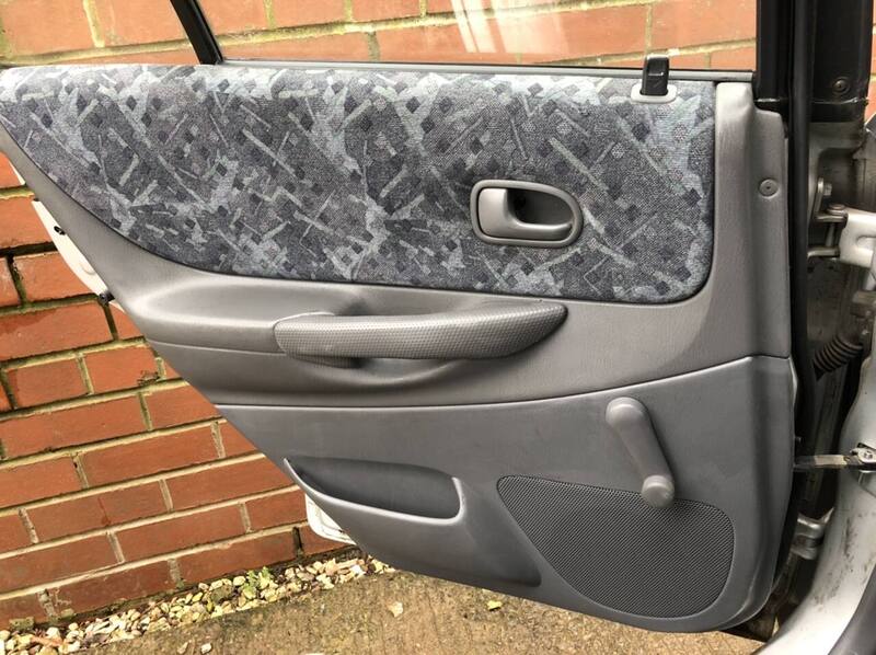

Assembly reverse of taking apart, minus swearing, etc. Amazingly for such an old beater, it didn’t even snap a single door clip.
Picked out the nick in the vinyl and dabbed over with a spot of superglue to stop it getting any worse and then cleaned the scrappers marker off the window.
Buoyed by success, I took the White Mazda remote apart, tested the contacts with a screwdriver to lock/unlock and used some professional contact cleaner (ok it was a baby wipe) to clean the contacts and now the remote is fully functioning so double victory today, assuming it restarts when the battery has finished charging of course...
