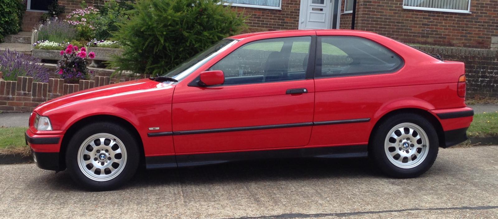

I’ve got an appointment at hospital early Monday so the car has to go in early at 8am but I might take it for a quick drive first if I can but it will be great if they sort it as it never felt as quick or pulled as well as my Z3 and both have the same M44 engine and done approximately 60000 each.
I’ve got to admit though after jumping into it after all that time it really is a nice car to drive and is in fantastic condition and doubt I would ever be able to afford another Ti in that condition again if I could find another one.
